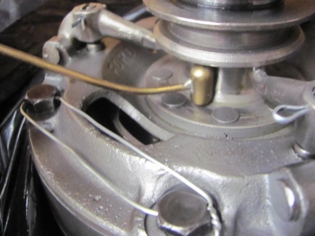

Just a note on adjusting the clutch screws. Before pulling the cotter pin, put a string through the head so you can't drop it. I learned this the hard way and it took forever to get the dropped cotter pin out of the transmission.

I believe you're taking your 13/16 measurement in the wrong place. While the trans in neutral, you measure between the tip of the clutch fingers and the sliding collar that the high speed clutch spring pushes against.
If you're measuring in the correct place it's impossible for a clockwise turn of the screw to increase the gap.
Also, look for breaks in your clutch spring while you're "in there".

Re: Clutch adjustment - slipping
Maybe want to rethink that advice Jerry
Photo courtesy of: Dan Treace
- Posts: 4391
Damn it! I realized I was wrong and rushed back to delete my post, hoping nobody would catch me. Too late....Scott_Conger wrote: ↑Wed Oct 21, 2020 6:49 pmMaybe want to rethink that advice Jerry
Yup, do what Scott shows to do...

Last saturday I saw this operation done by the side of a rural Michigan road on a '25 coupe. The clutch was slipping and I could smell it although I was three cars behind the coupe. Scott Steelman and Brian Dowell came to the rescue and they were able to adjust the clutch well enough that the owner was able to complete the 40 remaining miles of the tour. They went thru a bunch of dental floss tying off the cotter pins to keep them out of the tranny
