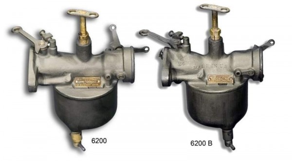

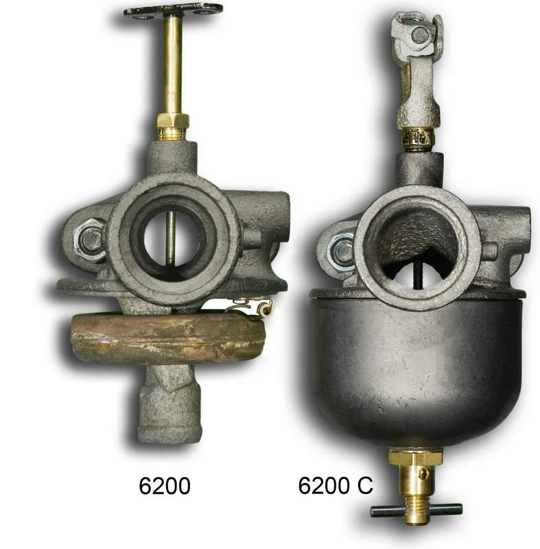

- Posts: 6714
Re: How to Identify a Straight Through NH carb?
Straight through on left for both pictures:

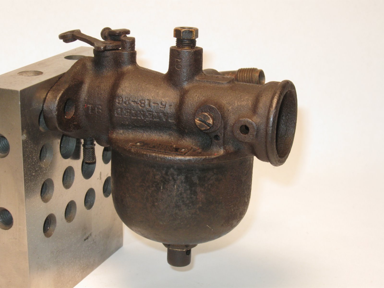

Well I guess I am selling mine on eBay, I didn't realize it was a straight through NH. If you want a nice solid complete one- take a peek.
Thanks for the help ID'ing them, I had no idea how to tell them apart.
Pep C Strebeck
- Posts: 634
- First Name: Joseph
- Last Name: M
- Location: MI

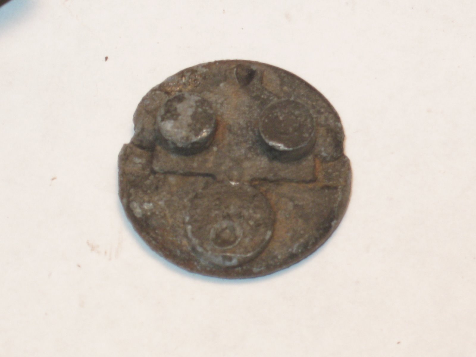

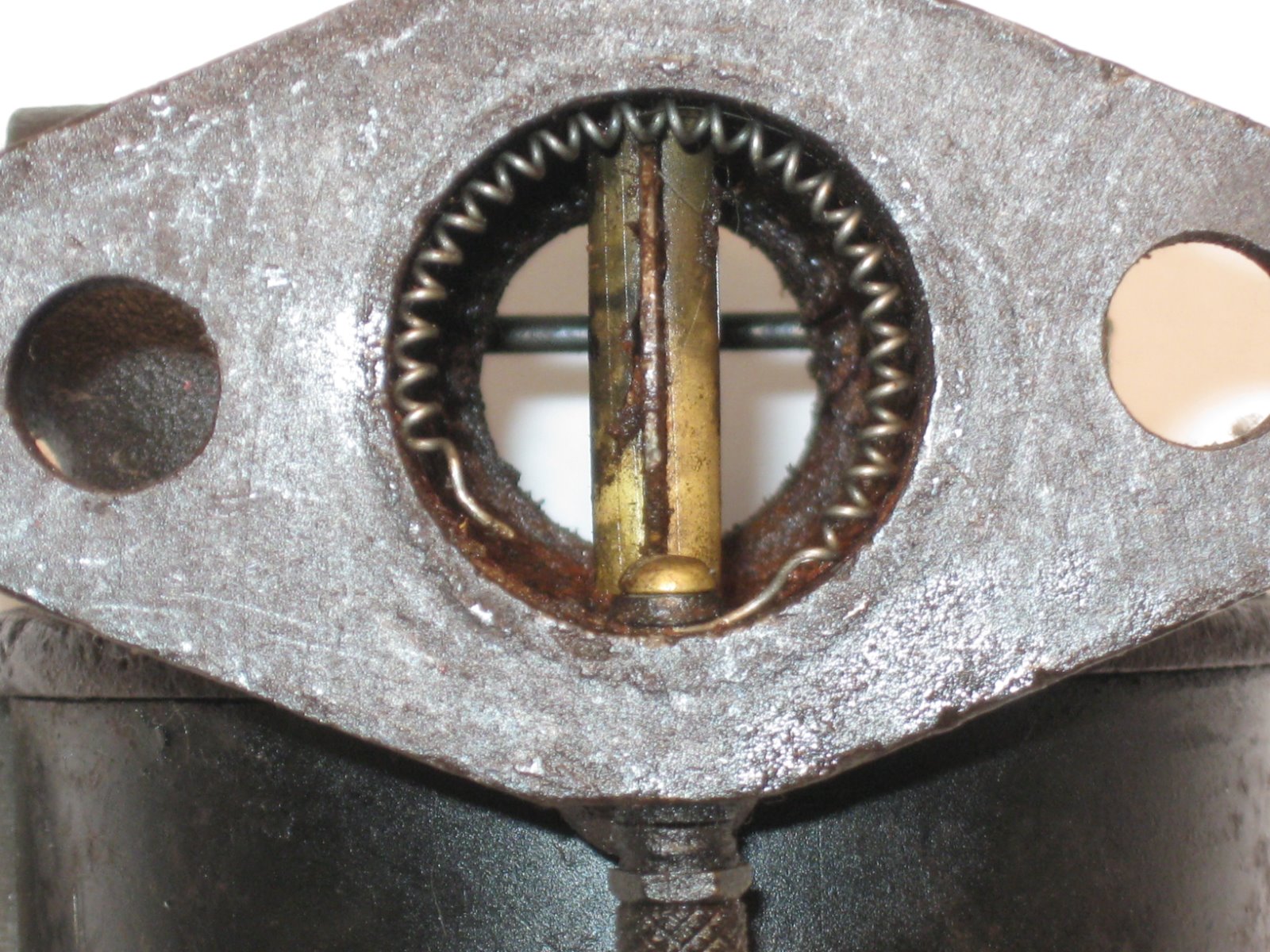

The one that you have listed on Ebay is not an NH, a straight-thru carburetor yes, but not an NH and not made by Holley. Either a Western Auto or Simmons Super-Power, both aftermarket. There would have been a wire heating element where the brass screw is filling in the hole. Does the carburetor that you have in the listing have the small pot metal flapper in it?
Fozz71
Topic author - Posts: 280
- Joined: Wed Jan 16, 2019 11:38 am
- Last Name: Chochole
- Location: Oswego, Illinois
- Board Member Since: 2003
Where would this pot metal flapper be located at? Both butterflys are the standard steel and brass type so potmetal is gone, no wire has survived.

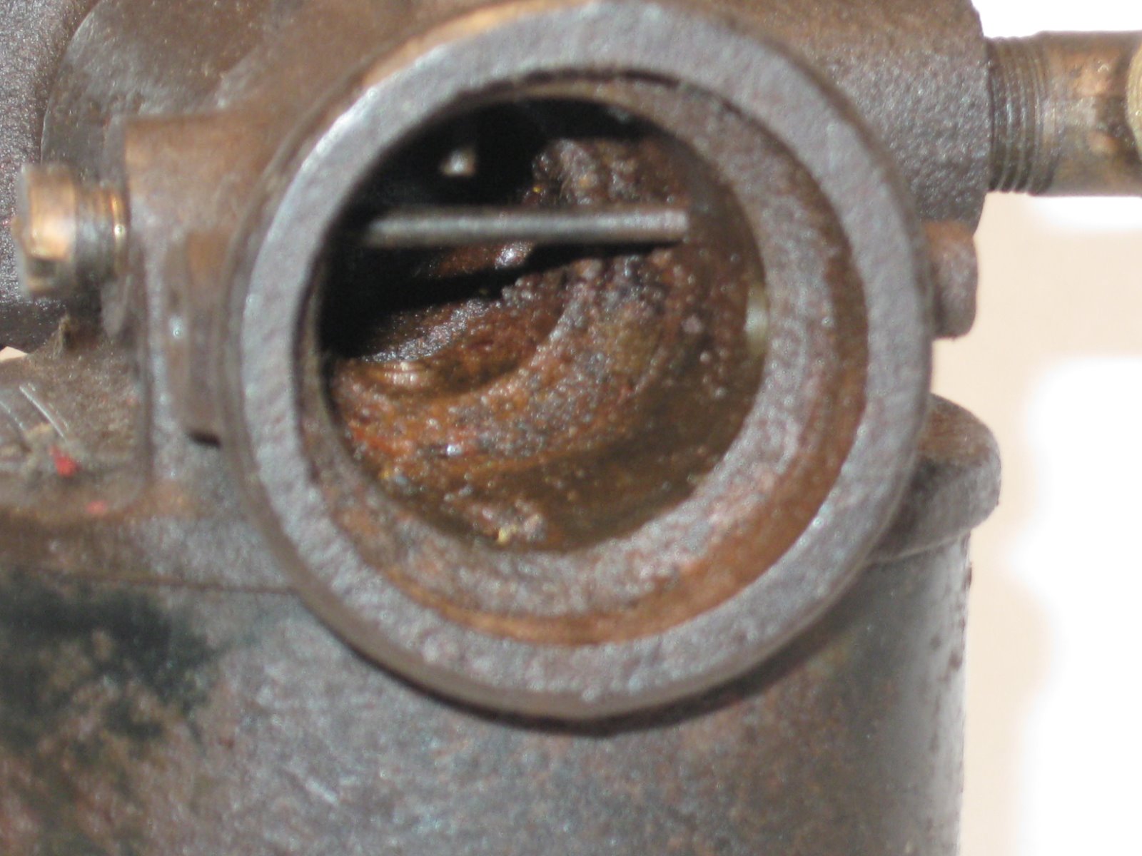

The flapper would be located behind the choke butterfly and would mount/pivot on the small rod attached to the brass screw that can be seen in the photo below:
You can see the small rod (horizontal) in this photo. This would normally be behind the choke butterfly but that has been removed in this photo.
The flapper is supposed to help with low speed idle and make the carburetor run/operate smoother.
