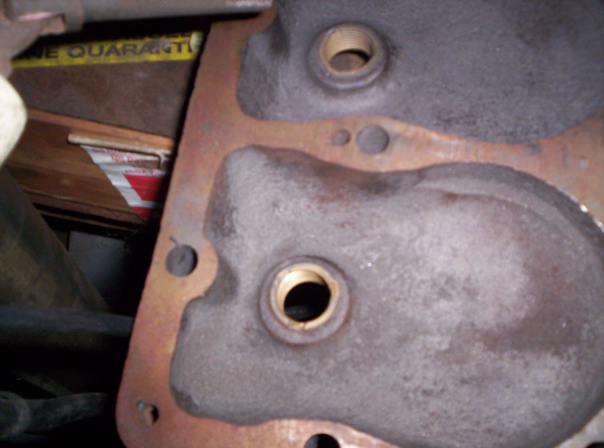

Thanks for the responses. I erroneously assumed the cast date was month year and that confused the heck out of me. The helicoil idea is one I have thought of but the kit is several hundred bucks. However, I will keep that in mind now knowing I have a usable head that only needs surfacing. Lang's Model T Parts (Don Lang) gave me contact information for a guy in Mass. that repairs heads using stitching. He has a picture of the crack and will let me know if he thinks it can be fixed. Also said he could repair the spark plug hole using a bushing. So, if the cracked head can be repaired and the spark plug hole repaired I will have two spare low heads of which I only need to keep one.

There are exceptions of course. However, most spark plug holes I have seen that were damaged, whether by water/rust, or forcing in a wrong or damaged spark plug? Were reparable by simply running a correct tapered pipe thread tap in. Never go any farther than absolutely necessary to make the hole work with a good spark plug. If a plug threads in too far, it could lead to problems. It is amazing how little it sometimes takes to correct a bad area of thread. Of course, if the treaded area is completely gone due to rust? And I have seen one that was that bad. It may even be beyond a threaded bushing repair?

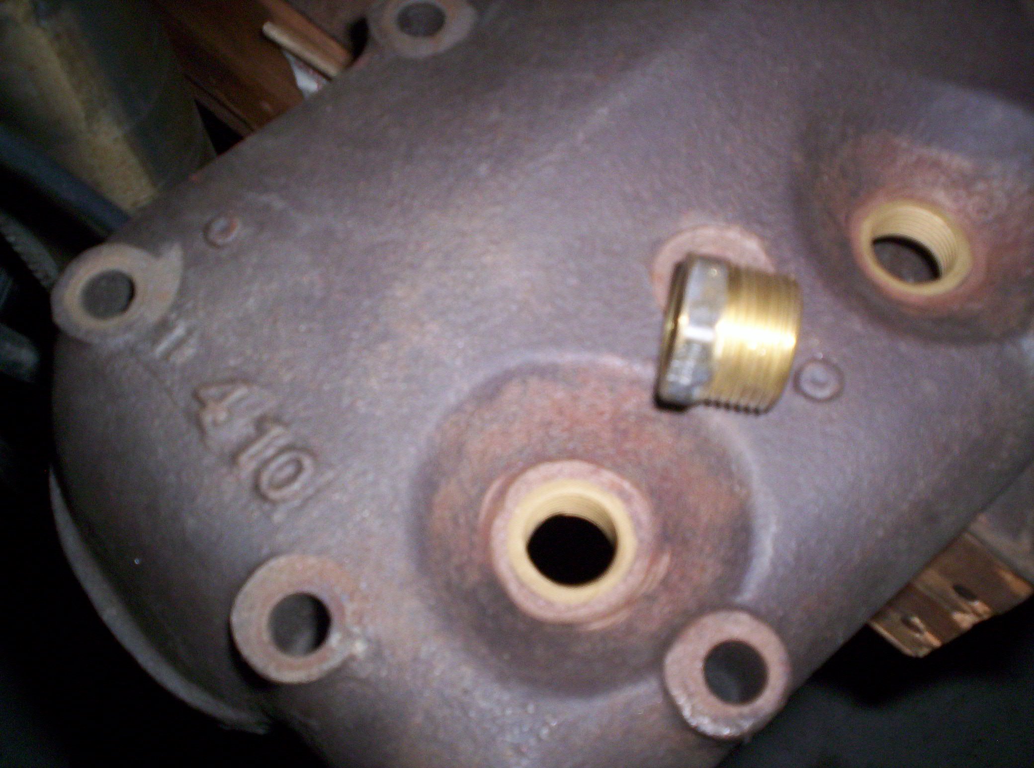

What I do is an easy fix, tap to 3/4" pipe, fit a brass plumber 1/2"-3/4" adaptor, knock 3 spots on the inside then mill off the nut of the top.

That's a perfect fix for my head. One set of threads are gone. Another, the spark plug goes all the way in by fingers, so 2 are in need of repairing. I had thought of doing something similar, but wasn't convinced it would work. Obviously it's a good repair. Thank you for taking the time to post your results.

An update on head repairs: I priced a 3/4" NPT tap at $20, so tapping and installing bushings using Franks repair method will be inexpensive. Once again, thank you Frank for your response. I also checked on having the cracked head stitch repaired by a gentleman in MASS. The crack is a stress crack per him and he said it would be about $80 plus shipping. I have one low head ready to go to the machine shop for surfacing. And I will have 2 good spares available.
