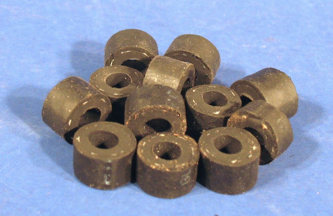

Post by Steve Jelf » Sat Oct 24, 2020 10:54 pm
What Norm said. Ditch the felt and use little bits of hose.

What Steve and Norm said, ditch the felts. A no brainer as far as I'm concerned, the rubber fuel line replacement "gaskets" are available and the the cut off ones that Steve describes are great too. Why mess with the felts. JMHO Dave
