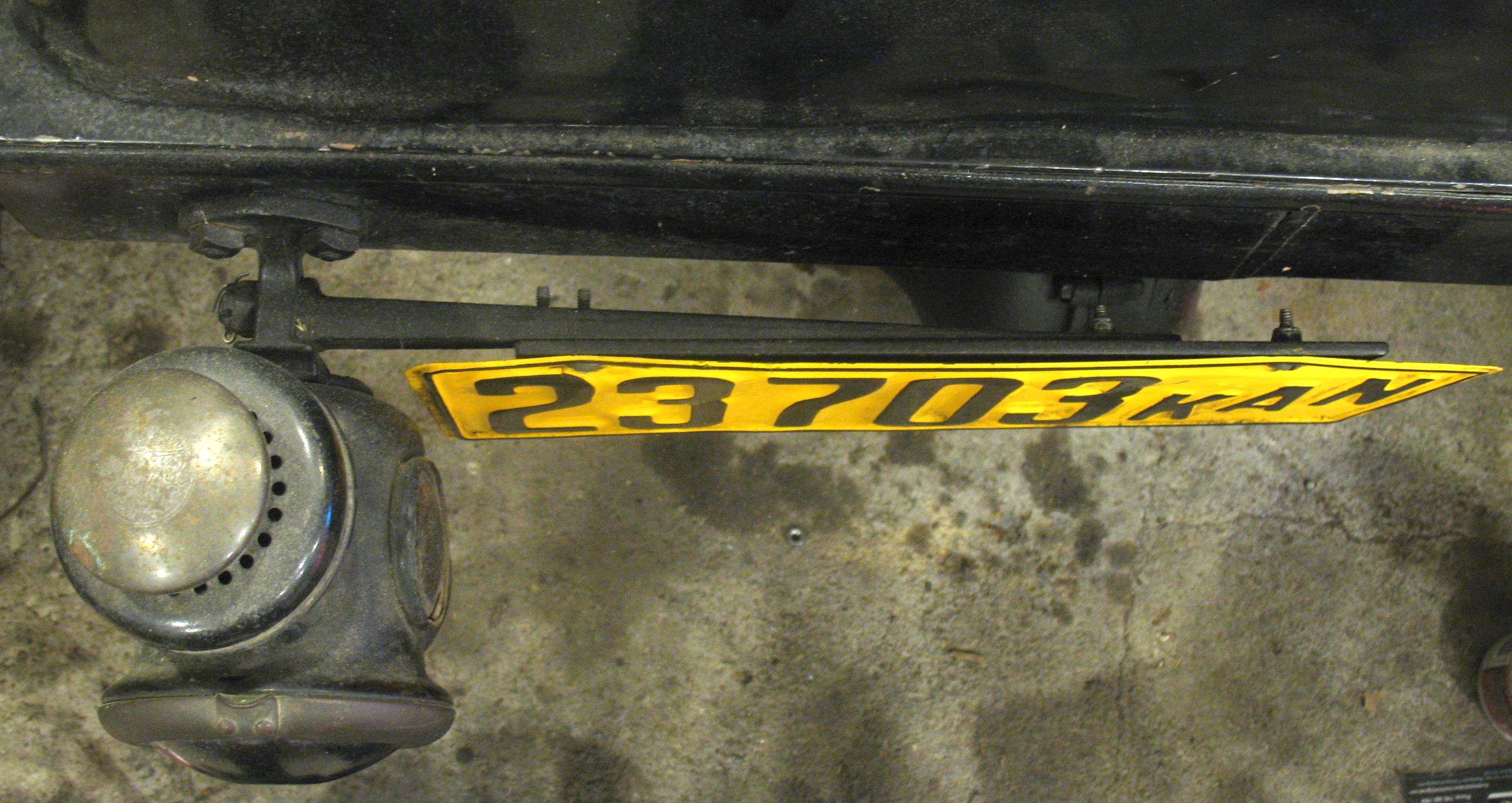

I guess the runabout and touring brackets are different. This is on my runabout.

Touring mounts under the rear of the body.

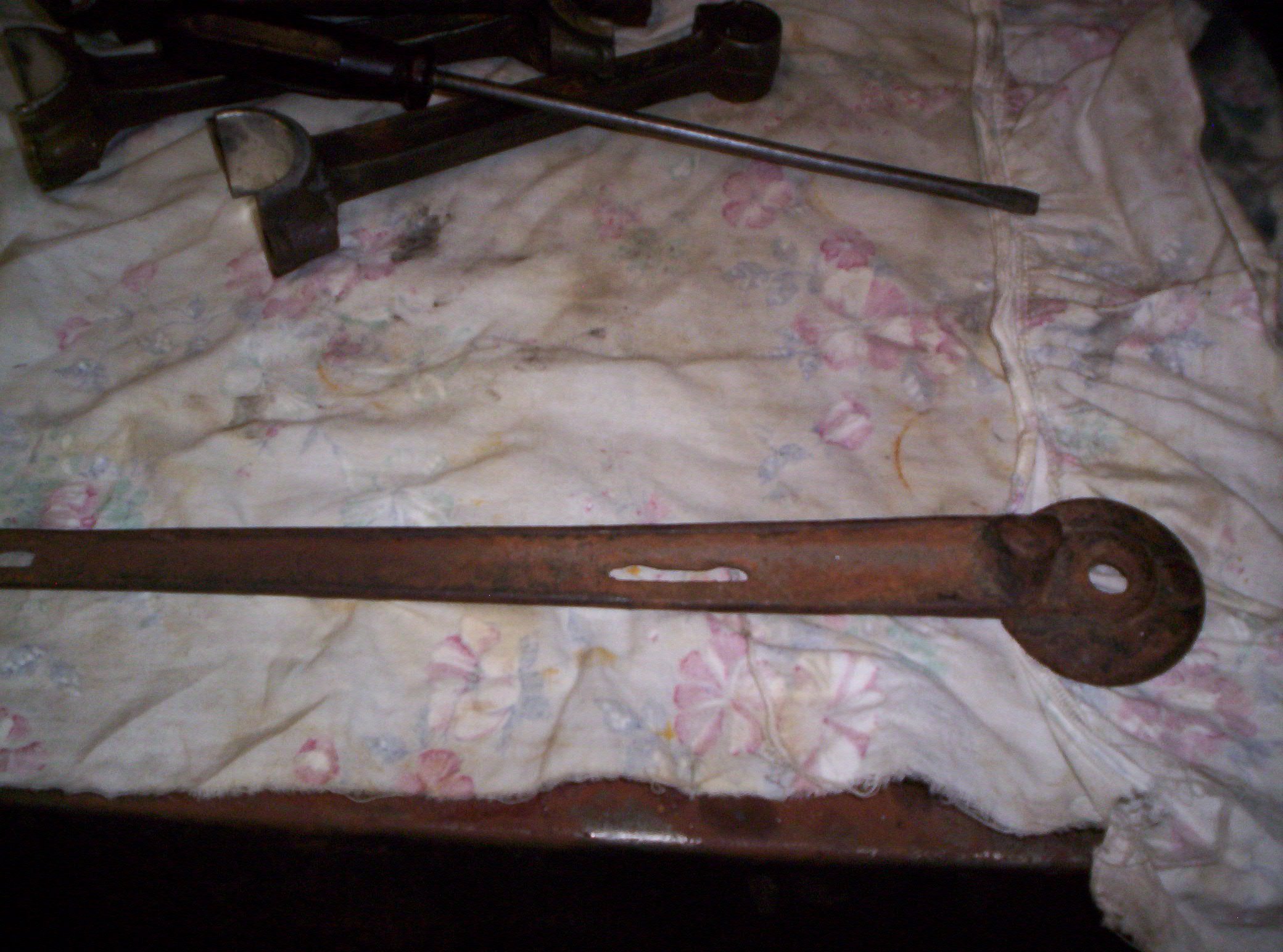

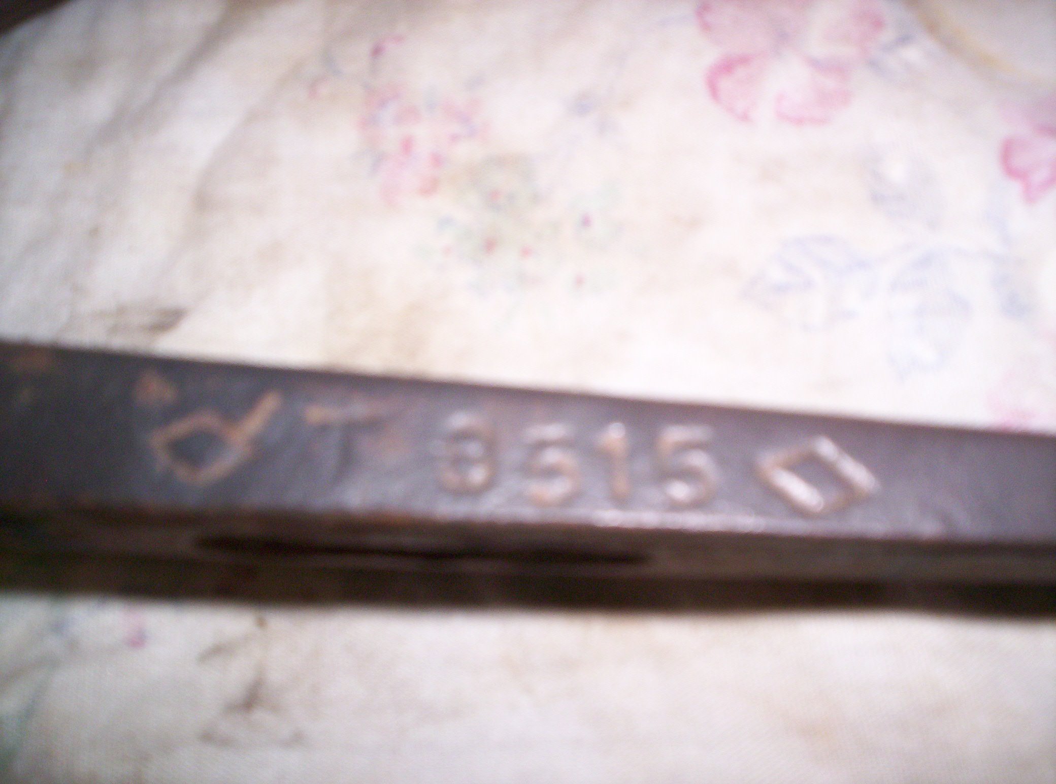

I found this in my parts pile, some one as written 15/16 on it, nothing has been cut off it so could this have been added to the 14 /15 to add the licence plate? it can go left or right.

Frank - how would one attach your bracket ? I believe the body mount has been removed on that bracket.

I checked out my 16 tail light and is of the same type of set up, the body bracket is the early tongue type of mount and the bolt of the light go's through the number plate mount and the tongue, making it mountable left or right, maybe just a Canadian thing.

Thank you for the explanation !

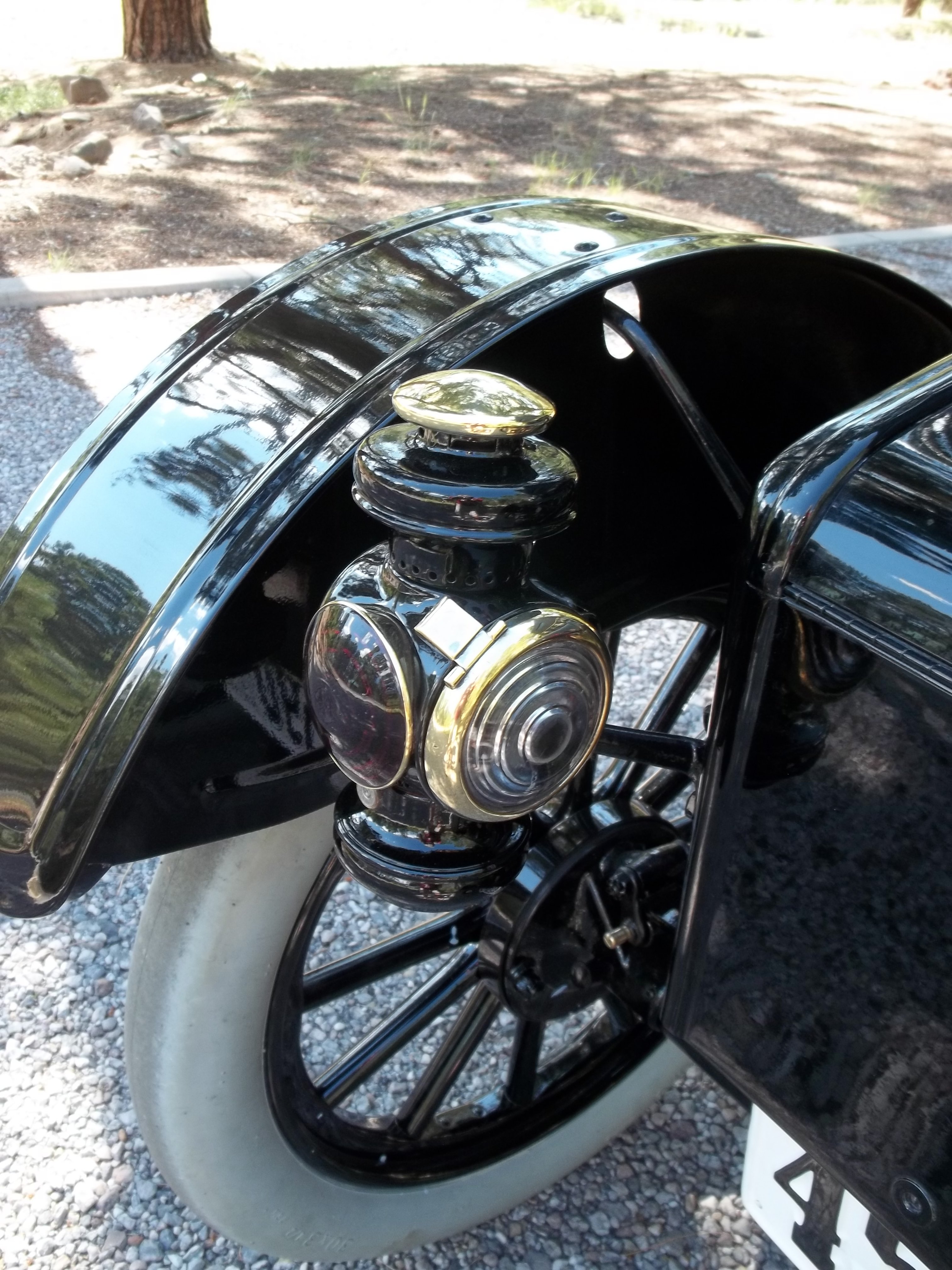

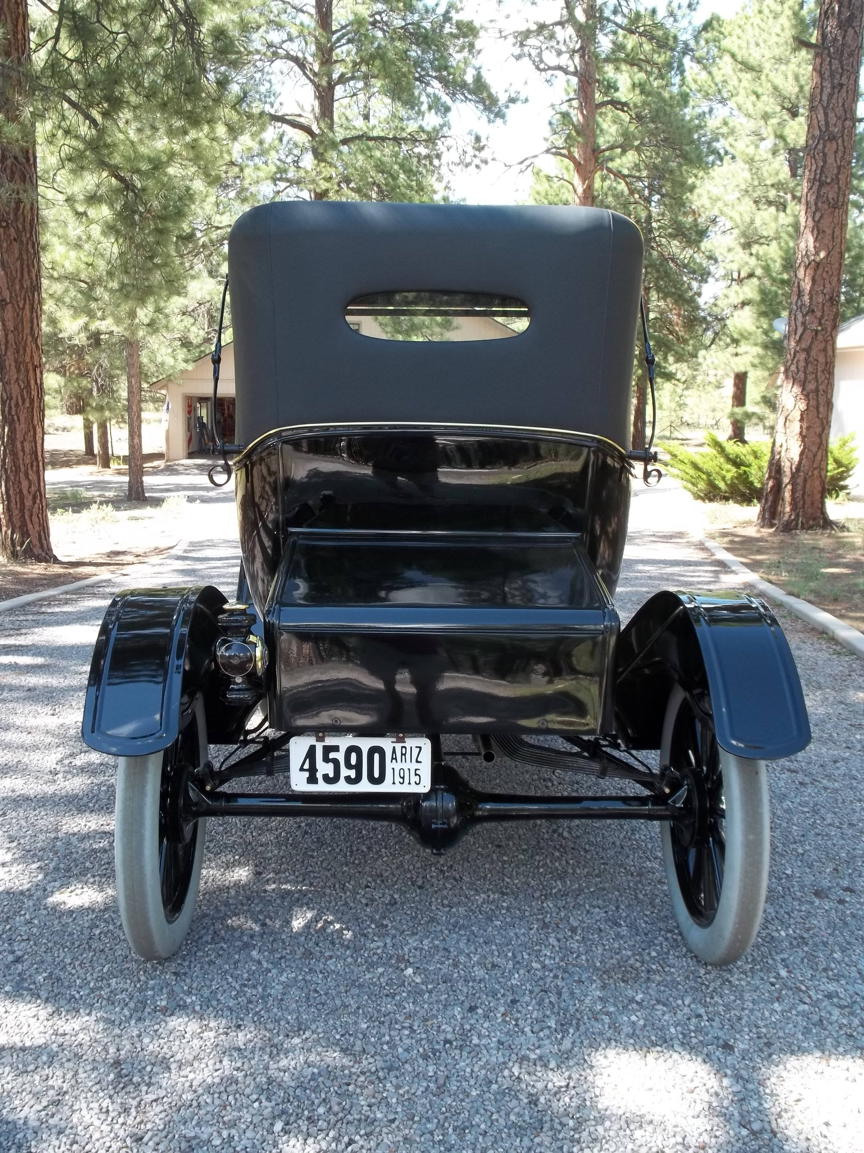

Larry, Here is a photo of the tail lamp bracket on my 1915 Coupelet. I have seen this same bracket in early photos of a 1915 runabout (See "Model T Times", #418, November December 2018, page 29). Regarding my comment about the original 1915 Touring in Flagstaff, I checked the engine number and casting date and the engine was cast on April 5, 1915 with a build date of April 8, 1915 according to the serial number stamped into the block. This car has not been disassembled and has the "four piece bracket" detailed by Trent Boggus. I hope this helps, Russ Furstnow

That's an interesting mount, Russ !

Early Coupelets are very interesting cars!!! Russ Furstnow
