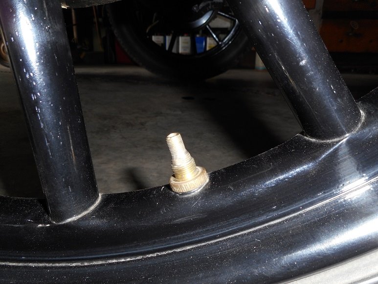

Why I use Schrader 888 valve stems instead of 777's. They are 1/4" shorter, and do the same job, with a few threads to spare. The main reason in weight. They work exactly the same with a 30X3 or 30X3 1/2.

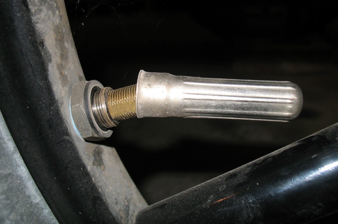

...the stem has no effect on the Cover as it threads onto the rim nut, not the stem.
Depends on the year and the stem.
That's true on this nickel era stem.

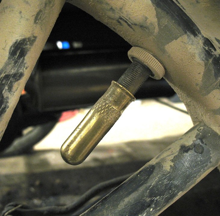

But this brass era repop screws directly onto the stem. That may be due to the stems and covers sold by parts dealers today being the larger size that was used on non-Ford cars.

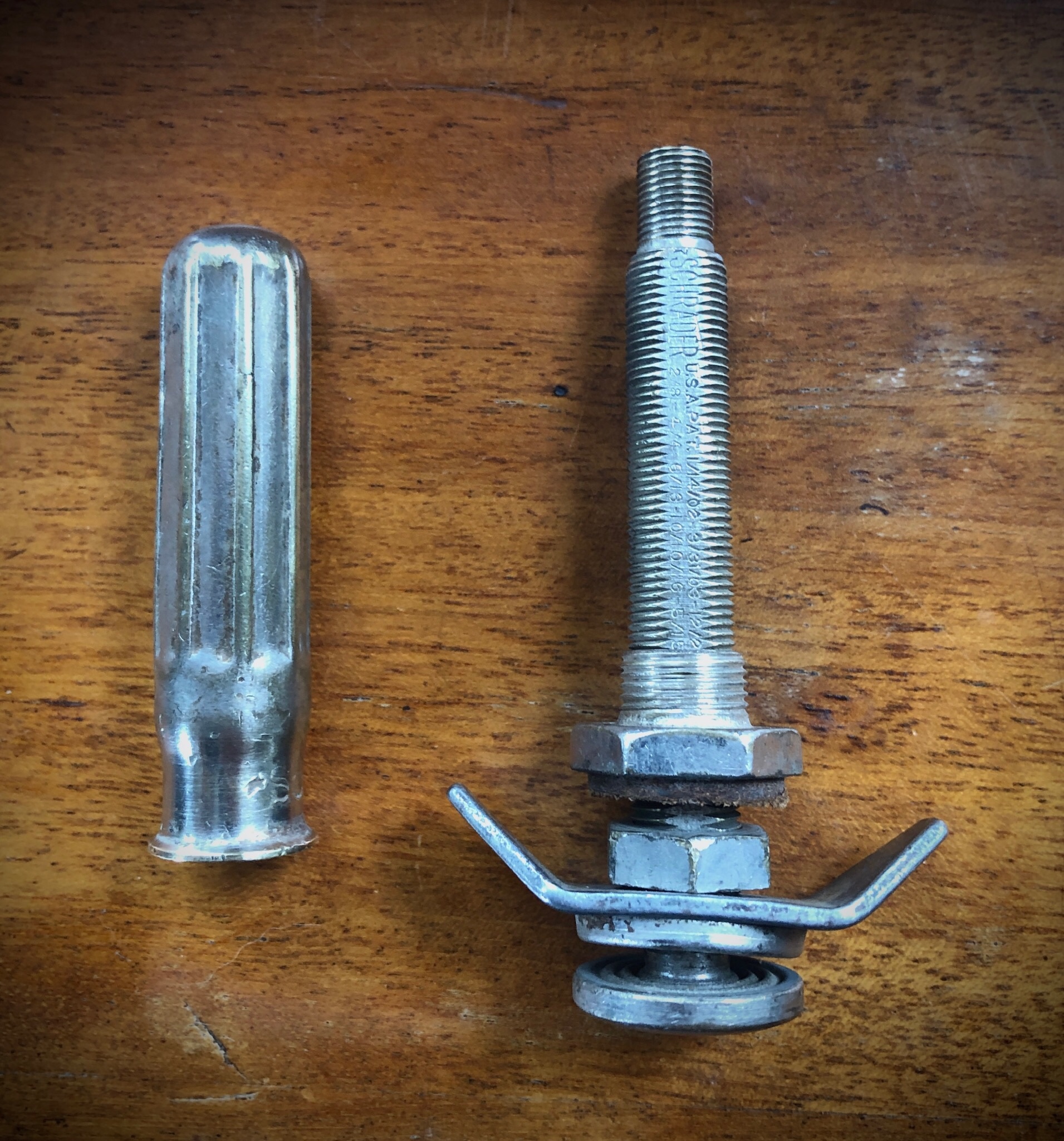

Just in case some crazy person wants to attempt fabricating a batch of Schrader 777 size stems, page 4 of this document has the dimensions. One issue I see is that they can't just be turned on a lathe, they require two sizes of external threads plus one size of internal threads to accept the valve core.
And, the flats on the large threaded section need to be milled so that the bridge washer can slip on. I measured an original 777 stem and the thickness across the flats varied between 0.335 and 0.337 inches.
