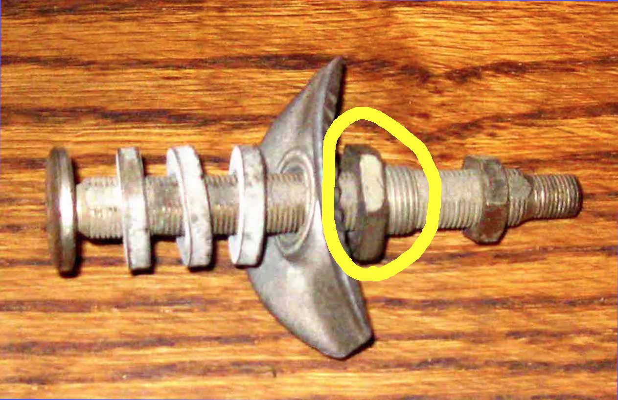

A former forum member's take on changing a non-demountable tire on the car.
http://www.mtfca.com/discus/messages/17 ... 1325091009

I've never seen a stem like the one in Frank's picture. The use of three different threads is strange, the shape of the bridge washer is strange, and the three washers have me mystified.

Steve, there are the usual two threads. The small end is the universal valve cap size. The rest of the thread is the same all the way to the flange on the end. The third size you are seeing is the thread on the ferrule that takes the dust cover. I have no idea why the three washers are there. the bridge washer certainly is unusual.

I see what you mean, Allan. Looking more closely I see that the threads here are not part of the stem. That leaves just the bridge washer and the three thick washers as the oddities.
