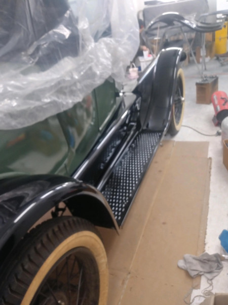

Re: What have you done to your T this November
Made some frame modifications. Trying to keep this 1930 period correct.
Looking good David! Thats the way my Dad made them on our Speedsters!

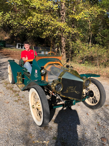

Getting close to finishing this build. Had it out for a few test drives.
Just give me time to Rust and I'll be good as new.

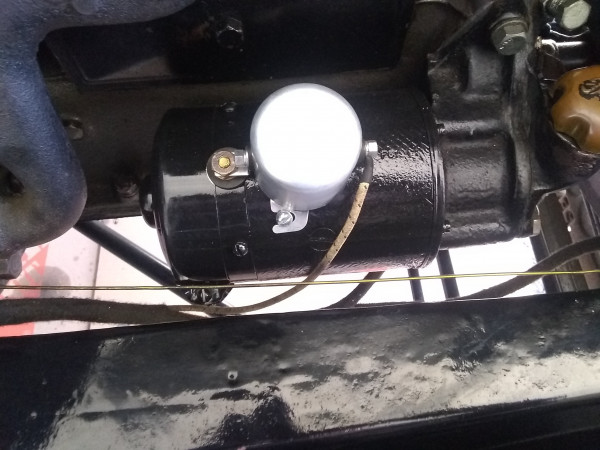

Not on my T's but on a 24 roadster that a fellow is trying to get going for a friend. He had no idea how the ignition worked, so I went over and checked it out. The coils worked well when grounded individually, so showed him how to remove the timer, and explained what it did. It has a new day timer that had a bad spring on the brush. Showed him how to take it apart to replace the spring, and gave him general information on the operation of the T! Nice Roadster, has a sticker from the covered bridge tour, and a ruckstel rear axle. Good top and paint.

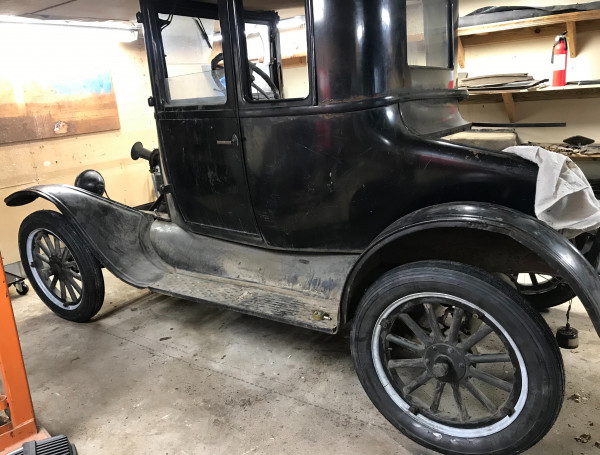

In getting the 21 ready to sell, pulled the engine and fixed clutch issue. Pins were below the outer surface of the drive plate. Installed plate with longer pins and added extra disk to the pack. Dry the pack came up a bit on the short side. Now seems to de-clutch better for shifting the Warford.

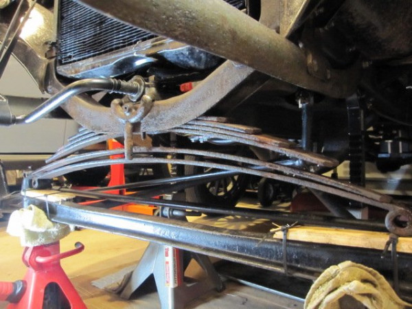

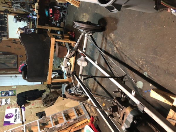

Got the roadster on wheels with the lowered rear suspension.

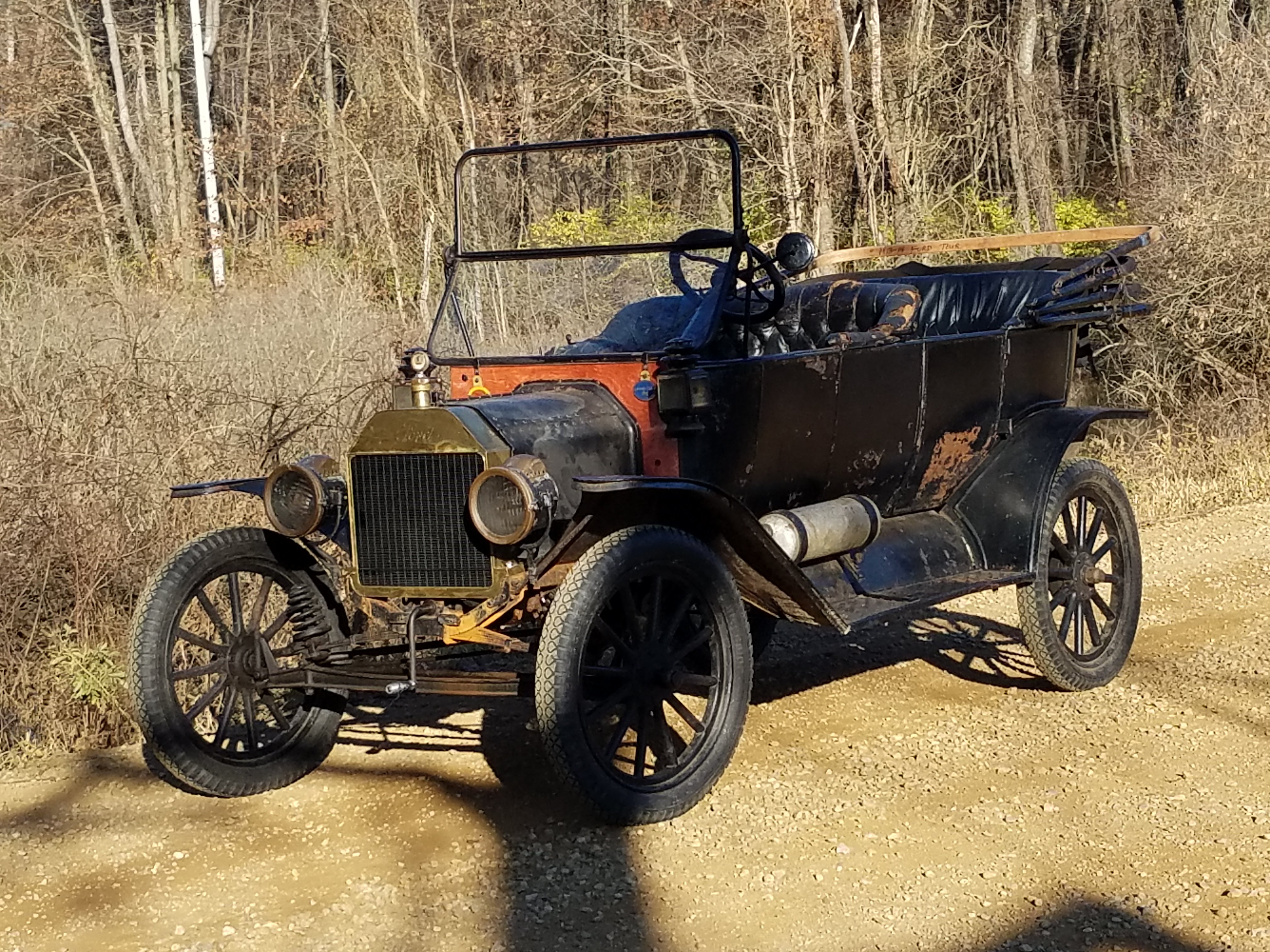

I mounted new tires on the rims I had galvanized. The rims and wheels are Jaxon. They came on the car when I bought it. I also blasted and painted some misc. parts and took the head off to check on the cooking system. Given the amount of rust I found, that was a good idea. The car had been sitting for almost 60 years, so I wanted to make sure things were clean.
I got it running last summer, so it was time to make sure everything else was okay. I have been trying to load pics, but my browser keeps crashing when I try. I will try again later.

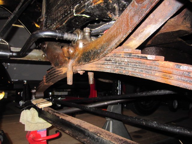

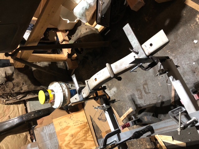

Got the old rusted in place front leaf spring out after cutting the tie bolt and wedging the leaves apart and out. New leaf spring ready after I install the new perch bushings. Thanks to "T" springs in W Hartford for the nice quality front and rear springs.
Finishing painting body damage from an accident in June. Decided to paint all the black

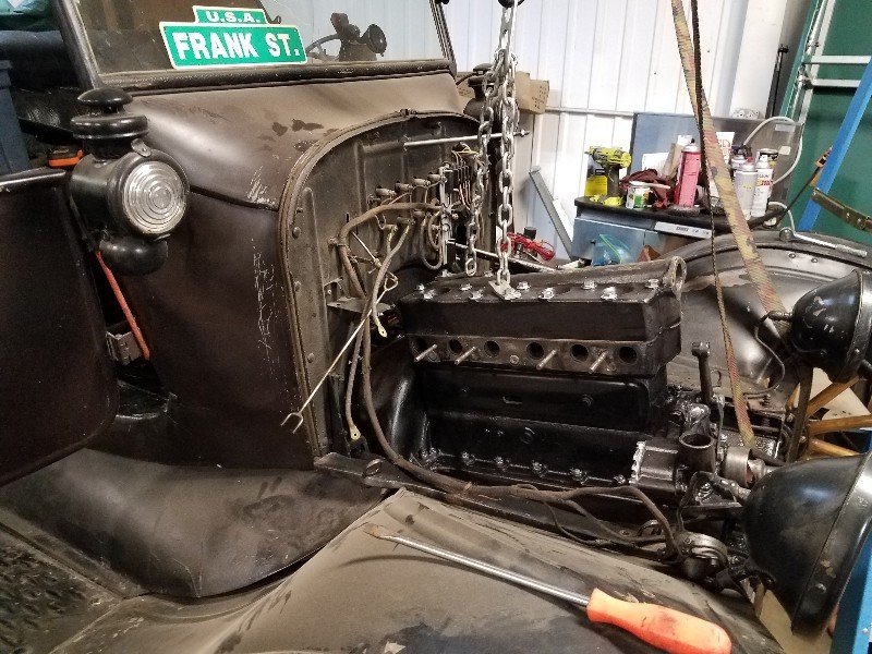

Pulled the tired engine out of out 27 Touring for rebuilding with help from my Son Chris.
Taken the front floormat and floorboards out in preparation for adjusting the clutch screws. Unfortunately, she who must be obeyed has instructed her husband to start putting up the Christmas decorations immediately if not sooner. I'll probably get back to the clutch in a few days.
Rebuilt generator for my 1920 T.
Worth every penny.
Worth every penny.
