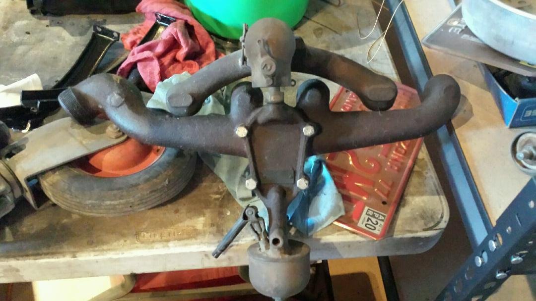

What is this all about ? I know it is a intake and exhaust manifold and a carb ?

Vaporizer Carburetor used in 25, 26 and 27. A MTFCA search for "vaporizer" will yield numerous informative posts.

It's basically meant to turn your gasoline from an atomized liquid into a gas. Kind of like how a Coleman stove works.

The holly vaporizer carb is built very much like the claimed 50 mpg carb. Can anyone provide any mpg data on this carb compared to other t carbs. My holly nh probably gets 18 mpg, but that is only a guess. Thanks for any input.
