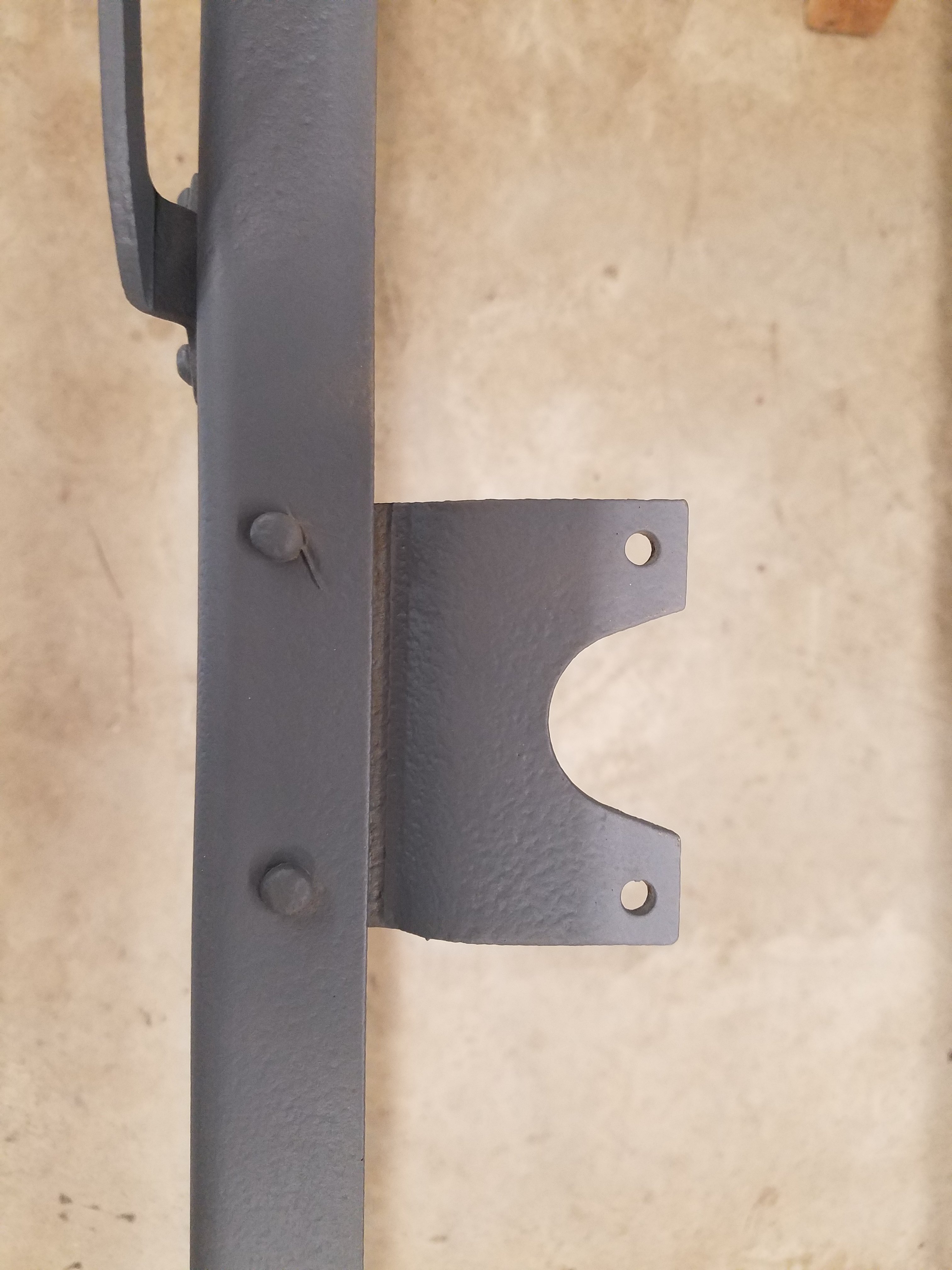

This is a factory switch mount on a 23-24 frame. What type of switch was mounted on it? I have not seen this bracket before. Thanks for any help

I think Gail Rodda pointed that kind of switch as used early in starter production in 1919 back when I was a kid. I wish I had written everything down those older guys said back in my teens.

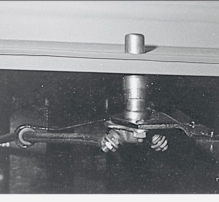

Likely the 1919-1920 early switch mount. Photo from Bruce’s book.

I used the frame hole count and hole placement to date this frame. I thought it was 22 1/2 to 24 model year by the chart, but now I will have to recalculate my thinking. Thanks for your help.

Another photo off prior forum post of a 1919 -20 frame with this riveted mount for foot switch. Yours seems bit different .

I went and took a look at a 1919 non starter touring a couple weeks ago that had that same bracket riveted to the frame.

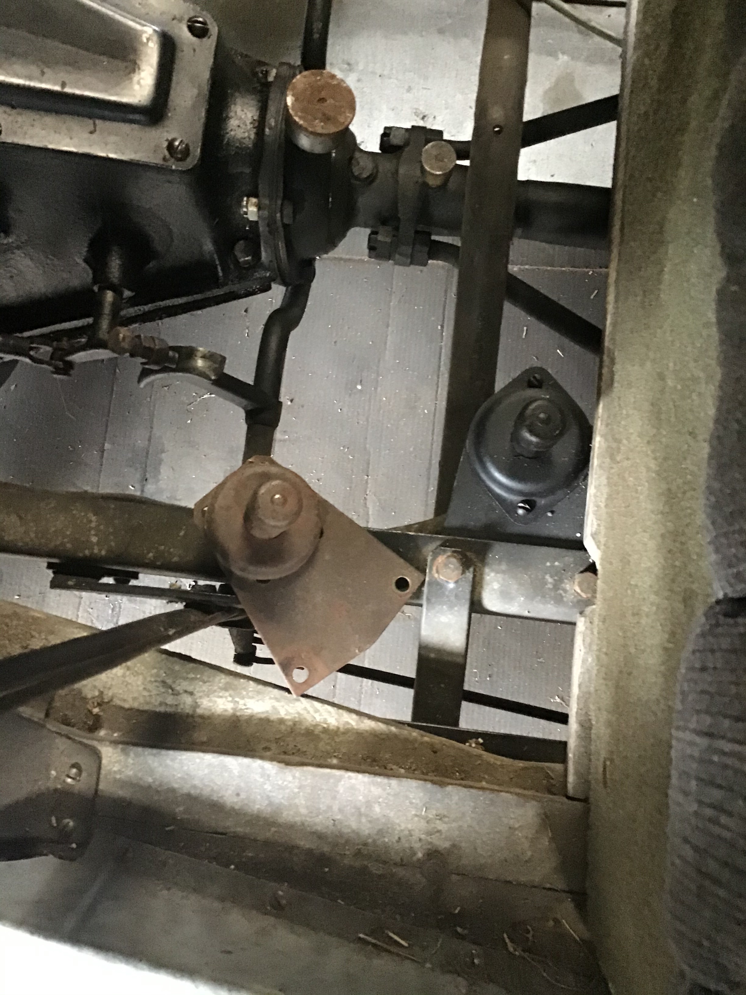

Here is a photo of the switch in my late 24 Coupe. As you can see there is no extra bracket on this car and the switch bolts directly on the frame. I also have another switch that was used I placed next to the one in my car. They are almost identical. The switch was in the car when I got it it in 1958 and seems to be original for the car. Ford must have used several different styles. This on eliminates the use of an ‘extra’ bracket so maybe this was a cost and time saving style that was used. It would save the extra step of riveting the bracket to the frame. Another detail is the frame has the four hole ratchet bracket riveted to it. So it’s a 24.

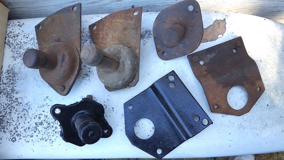

Here are the various foot switch used on the T. Maybe more styles, but one shows riveted bracket type.
Photo taken from old forum post.
Once used a Tractor Supply Co. switch sold for universal use. Drilled holes in the std.later bracket that bolts under the running board bracket brace. Of course the early frames didn't have that type of running board brackets or holes, so the early foot switch bracket is riveted to the frame.

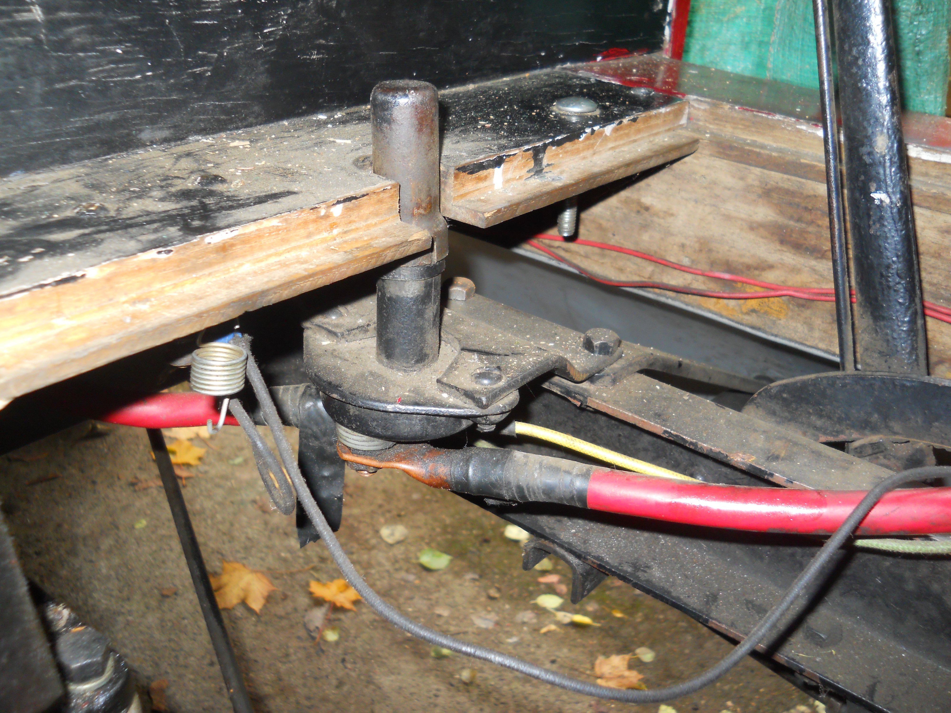

One could adapt a modern switch like the TSC to save the original bracket.
TSC switch on old later std. bolt on bracket.

Hey Dan your picture of the universal tractor switch reminded me of the ones that is sold at T
SC and other farm parts houses. Knew there was one somewhere I had seen. Thanks for the reminder.

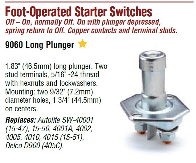

I would use a Cole-Hersee #9060 or equivalent. C-H are the best quality I have seen. They look like the previously mentioned switch from Tractor Supply and might be the exact same one they are selling.
