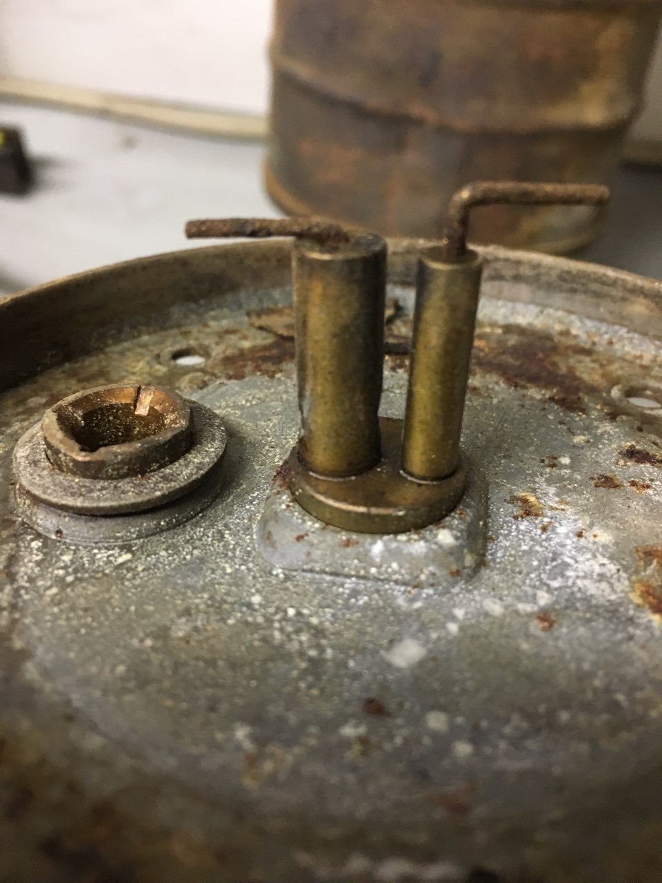

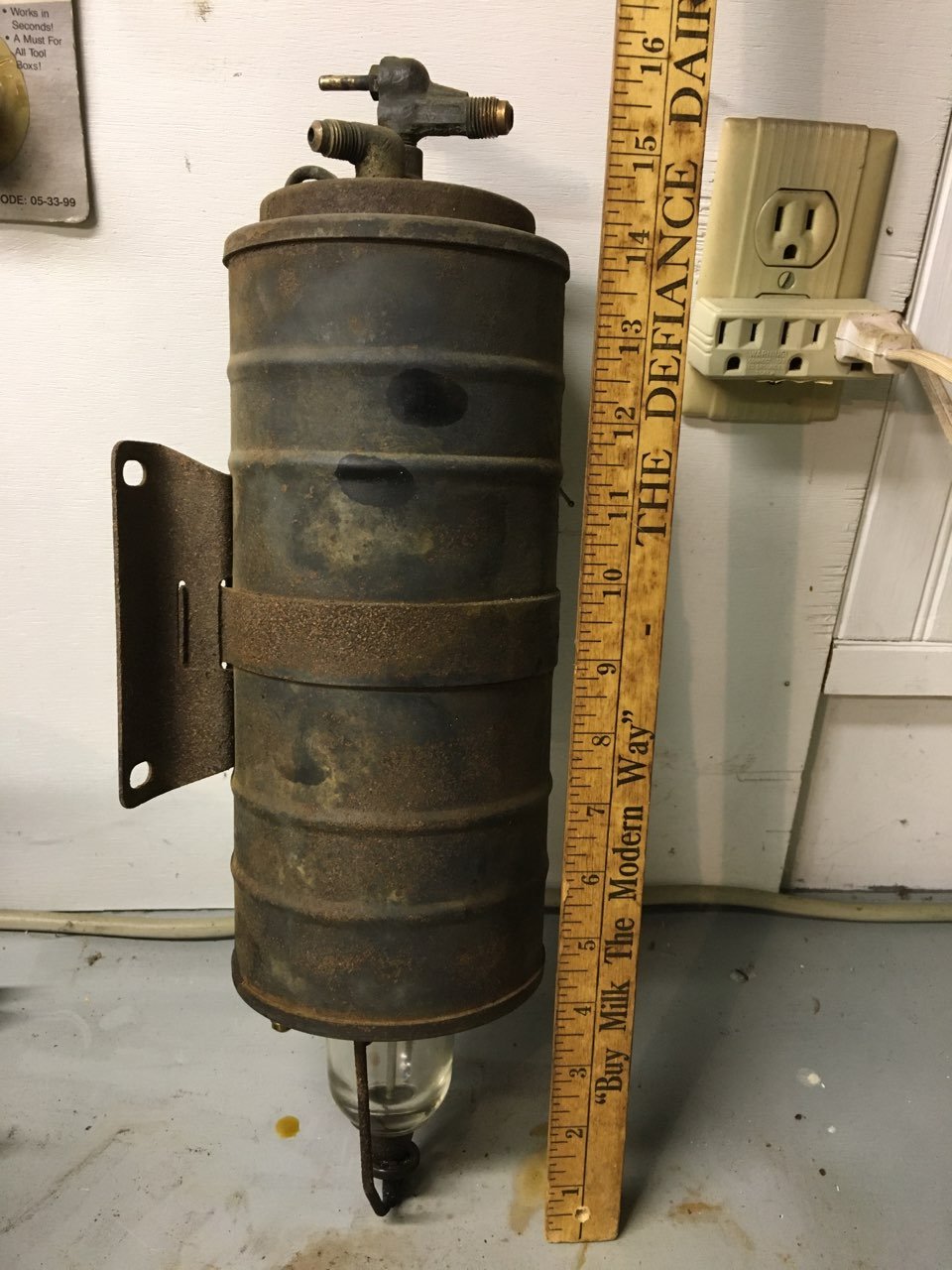

A guy in our "T" club just picked up a 1931 Essex (thus, the tie in to the "T"), I also have a '31 Essex that's been sitting in the back of my building for "some day". He got my interest going on the thing and thought I'd start out figuring what my vacuum tank is missing. I don't know the manufacturer, but there is no place for the usual mechanism the Stewart tanks have to be mounted. Anyone recognize this tank and know what is needed to get this going? Looks like I need the inner tank also.

While nether of my books cover specific pumps used, the Motor's Handbook of Specifications Interchangeable Parts Service Instructions that covers 1925 to 1933 shows that pump. It is a Stewart-Warner Leverless Vacuum Tank.
When float is down, float stem holds valve to intake manifold open and air valve to supply chamber closed so that suction from intake manifold reduces pressure in vacuum chamber and closes flapper valve thus drawing fuel from the rear supply tank. When vacuum chamber fills, the float rises and the float stem closes valve to intake manifold and opens air valve to supply chamber, giving atmospheric pressure to vacuum chamber. Fuel then flows through flapper valve until float again sinks. When carburetor float valve is closed, vacuum tank float remains up and no fuel is drawn into the tank. Shut-off valve at bottom of tank closes when the filter bowl is removed.

Thanks for the info Mark. Does it have the inner tank? I tried to find info online for the leverless system after your post, but couldn't come up with anything. It would be great if you could post a pic.

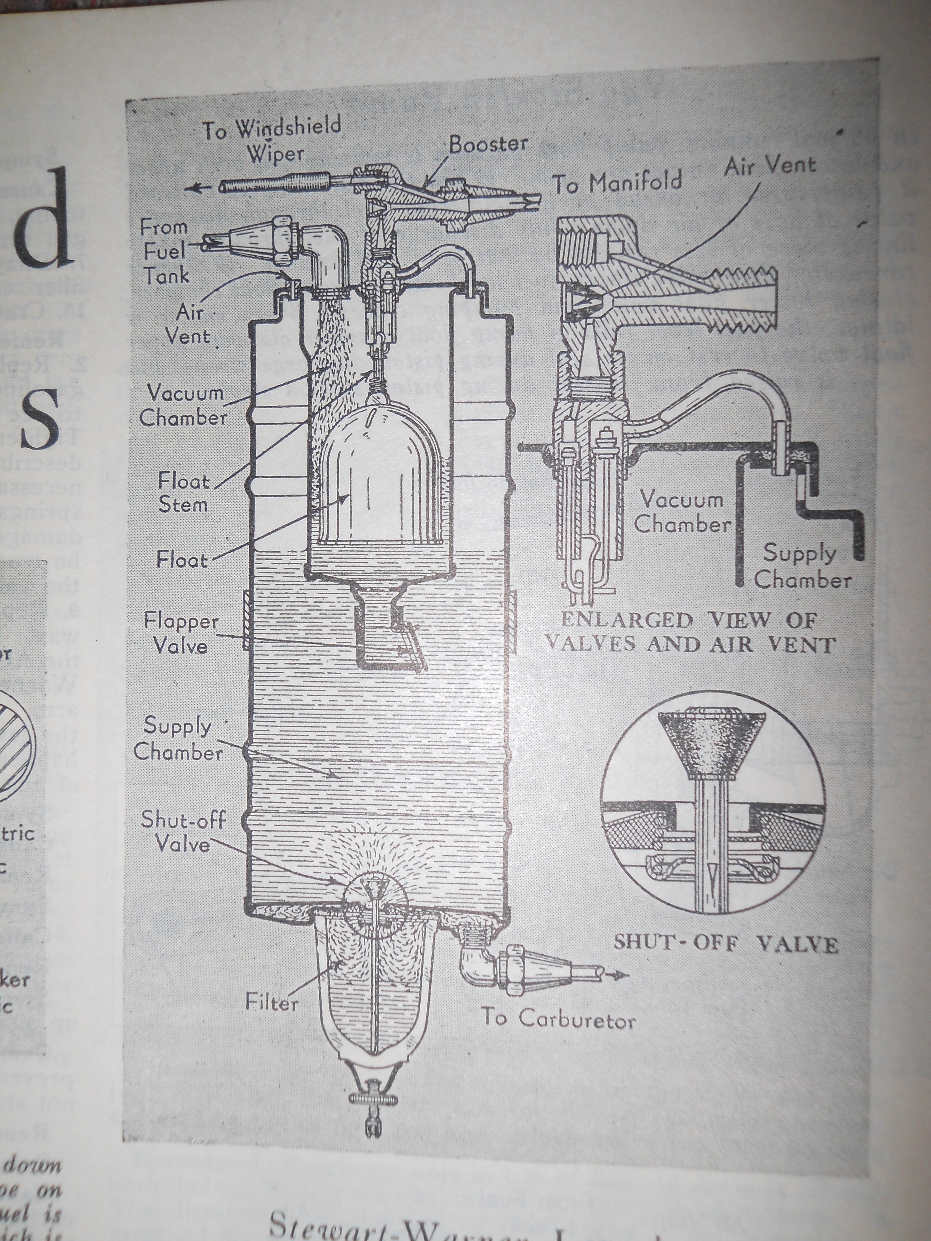

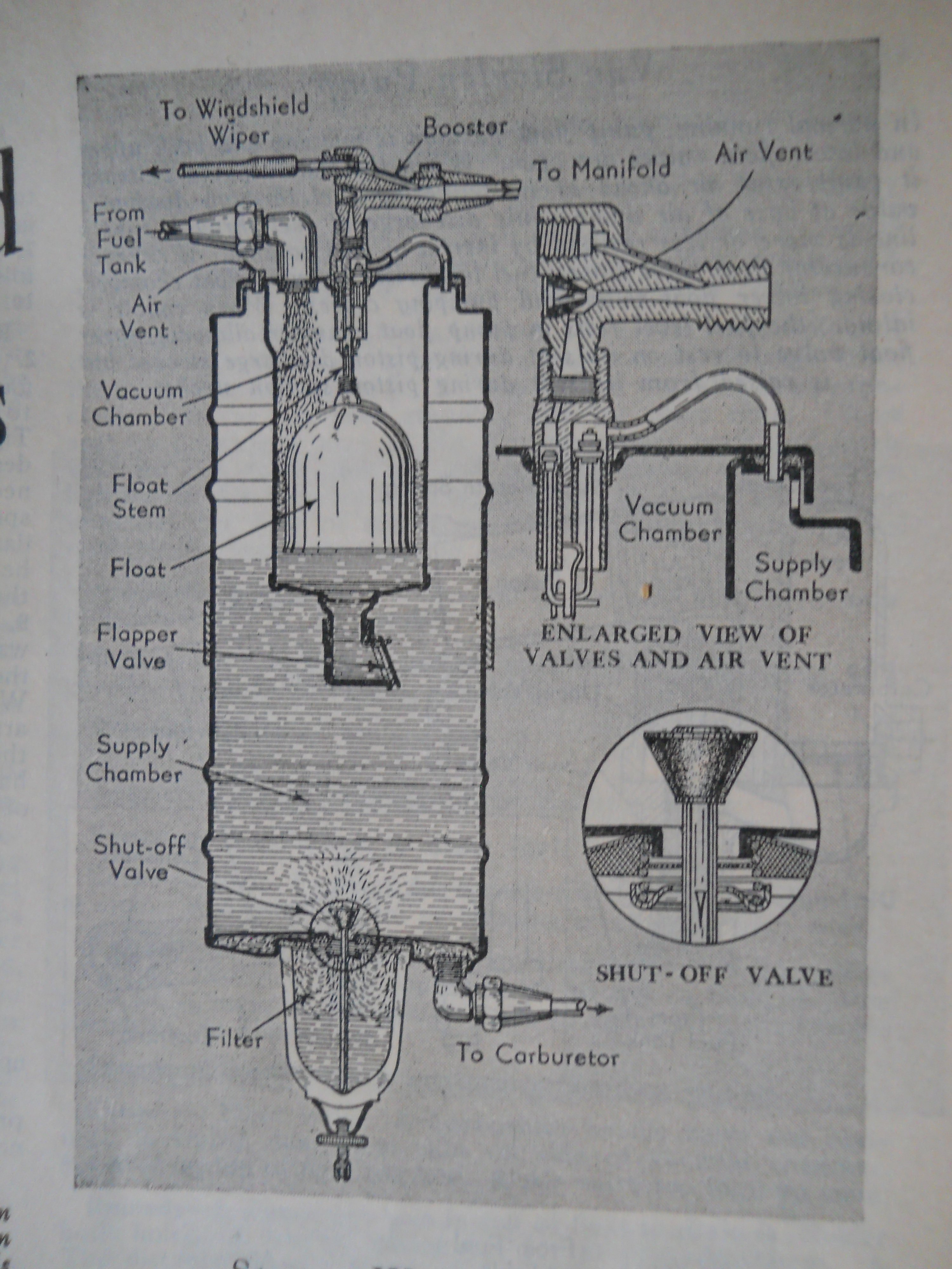

Yes there is an inner tank. A good working vacuum pump should work fine, but I would suggest getting one that is a little more serviceable. That one looks to be a sealed unit which back in the day might have been ok. If not a Stewart, more common type, electric fuel pump with a regulator would be my next choice. Hope these photos of the diagram work ok for viewing. If too small just hold down the Ctrl key and click the + key to enlarge. (hold down the Ctrl and click the 0 key to return to normal size, not the O'h key)

Re: Vacuum Tank ..... What's Missing?
Thanks for the diagram Mark..... that explains a bunch. Not the usual vacuum tank set up. I appreciate the help.

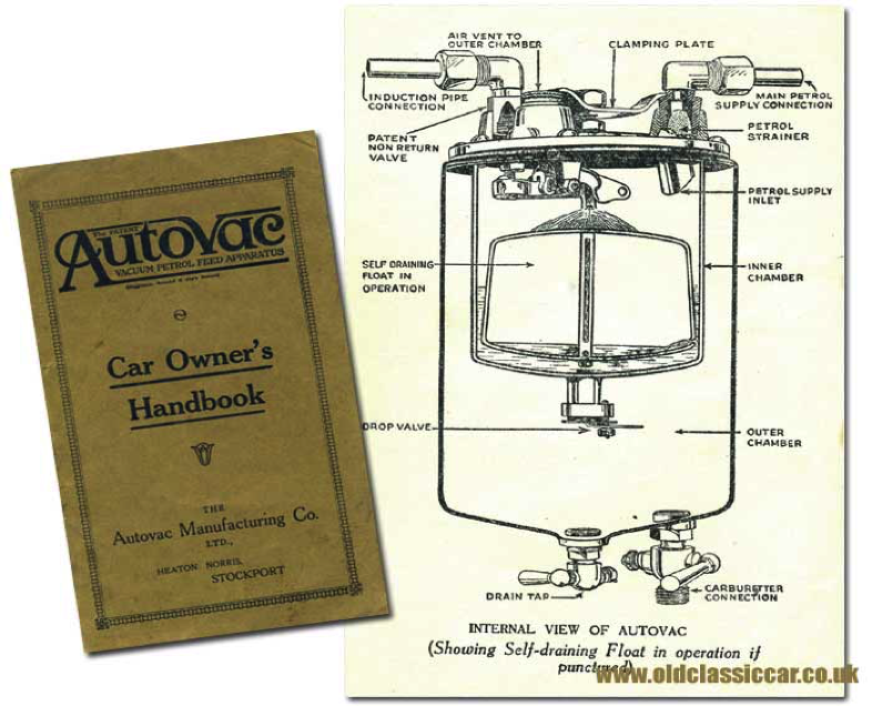

Early Rolls Royces had a similar setup to get fuel from the gas tank (which was down low behind the rear axle) all the way to the front where the carb was above the level of the top of the fueltank, they called it the 'Autovac'.
