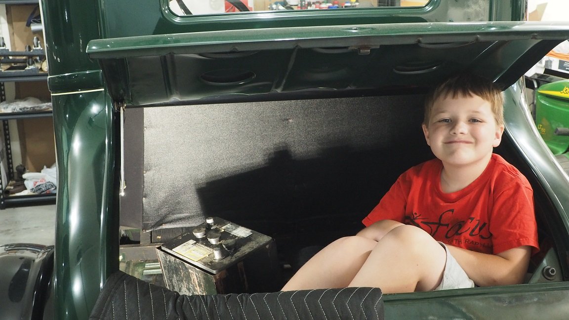

Post by Ken Lefeber » Wed Nov 11, 2020 1:54 pm
It was a good thing my mechanic fits in the trunk area when it came time to replace the battery. :D
