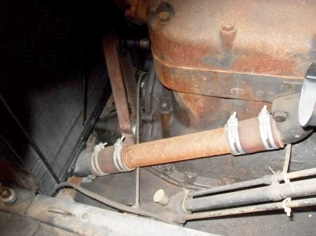

Re: Engine splash pans
[image][/image]
Hard to see....my 1925 T

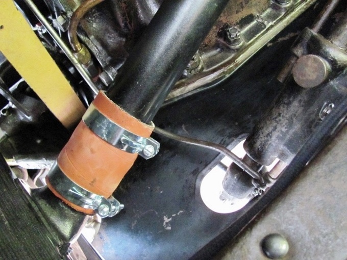

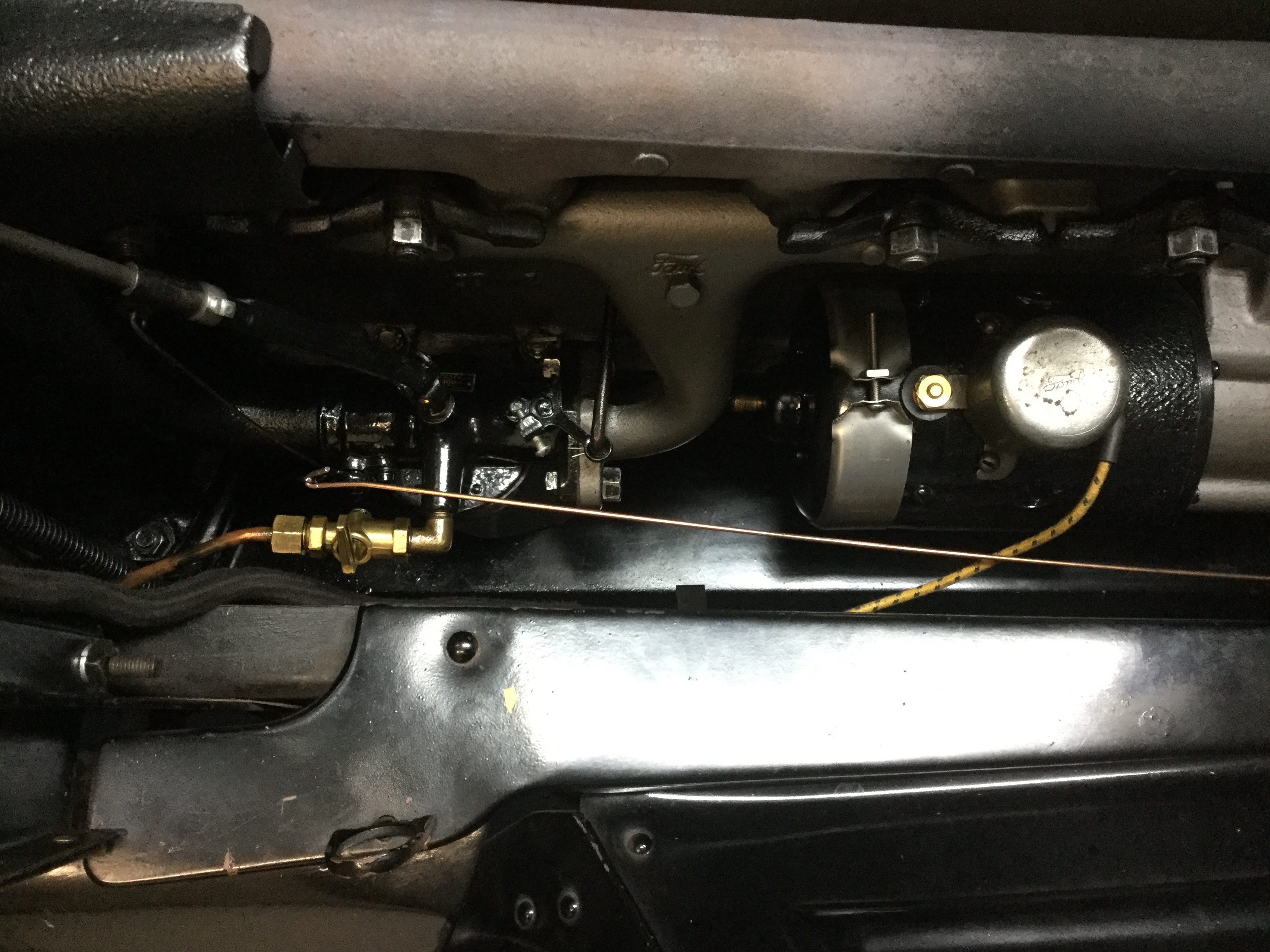

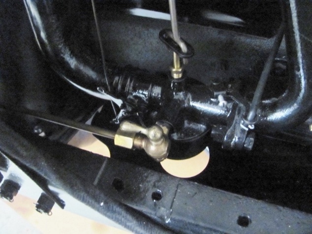

Here are views from a '23
Carb side
Steering side
Carb side
Steering side

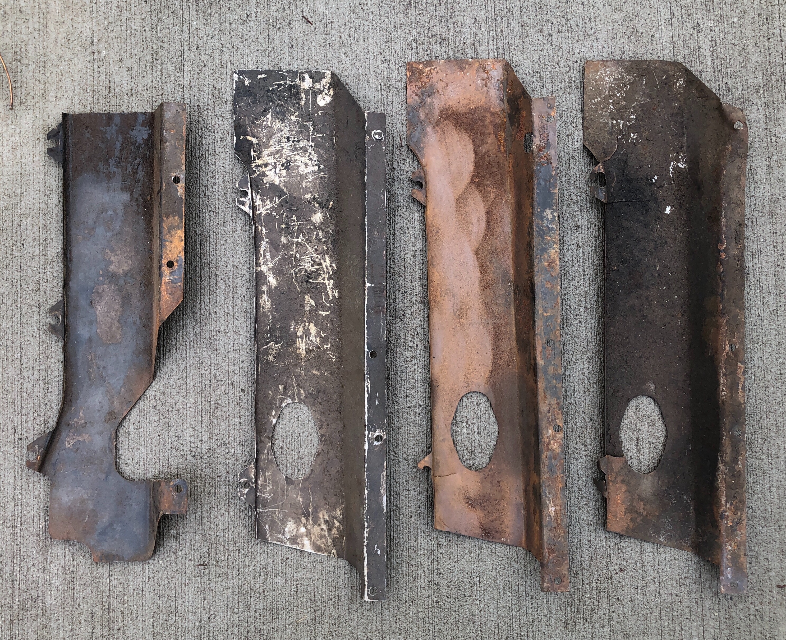

Been trying to put together a pair of good original pans. Here is what I’ve found so far. Because i have a U&J carburetor I will need to modify the right side pan.
Mark... Wonder if the right side guards get pulled and cast asside more often, than the left, because of the carburators?
