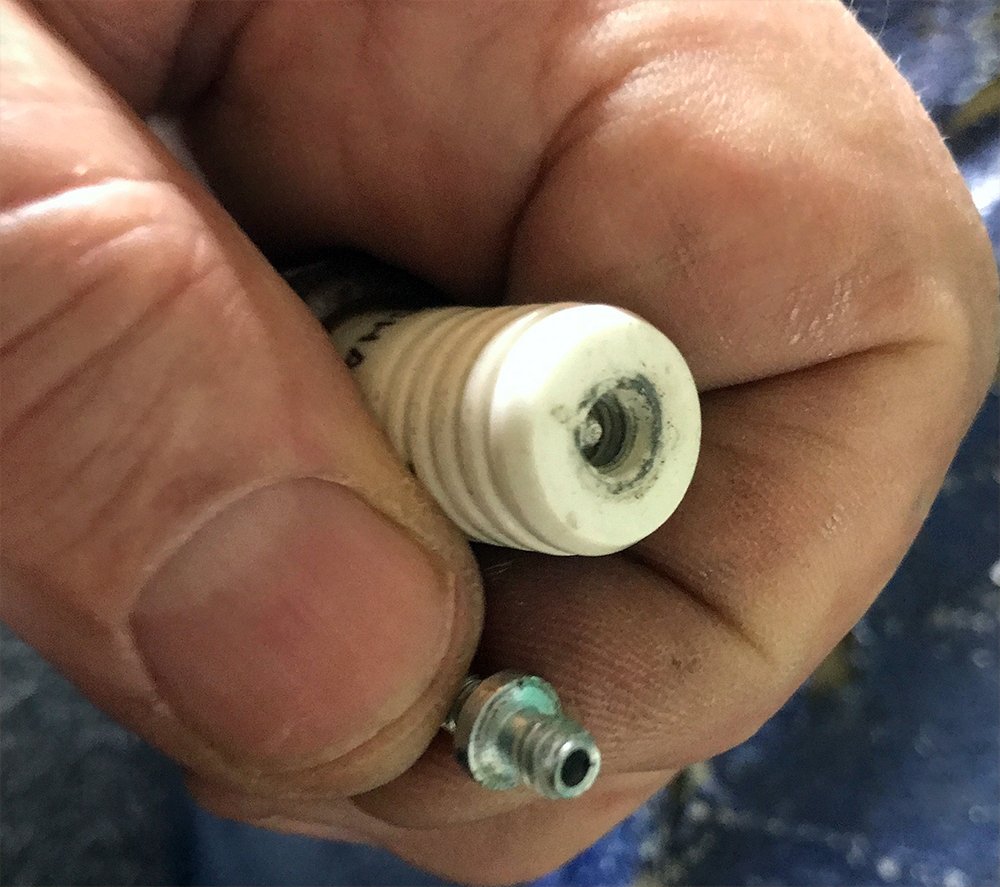

I was checking my T before taking a trip and found the wire loose on the spark plug in #3. When I tried to tighten it I found the top post was actually loose (see photo). I applied a little JB weld and it seems to be holding. I let it set overnight and put it in my T before taking a 50 mile jaunt today. So far so good
Tomorrow I'm joining a tour in mid-Michigan so I'll give it a good test. I have a few spares in my toolbox just in case.

Those production ones I quit using due to that. Autolites worked for me Tim.

I had similar issues with auto lite. They leaked compression where the ceramic comes out of the metal. Also had a couple come apart as the pictured ones did.

It's a good idea to always have a few extra spark plugs along on a tour. You don't get them at the usual Napa or Auto Zone or even a Ford dealer unless you order and wait. So carry along a few extras just in case. When you tighten the contact, tighten just enough to hold it. Even if the wire terminal should come loose, it is unlikely to cause your engine to miss, but if the terminal pulls out like your picture. Muy Mal.

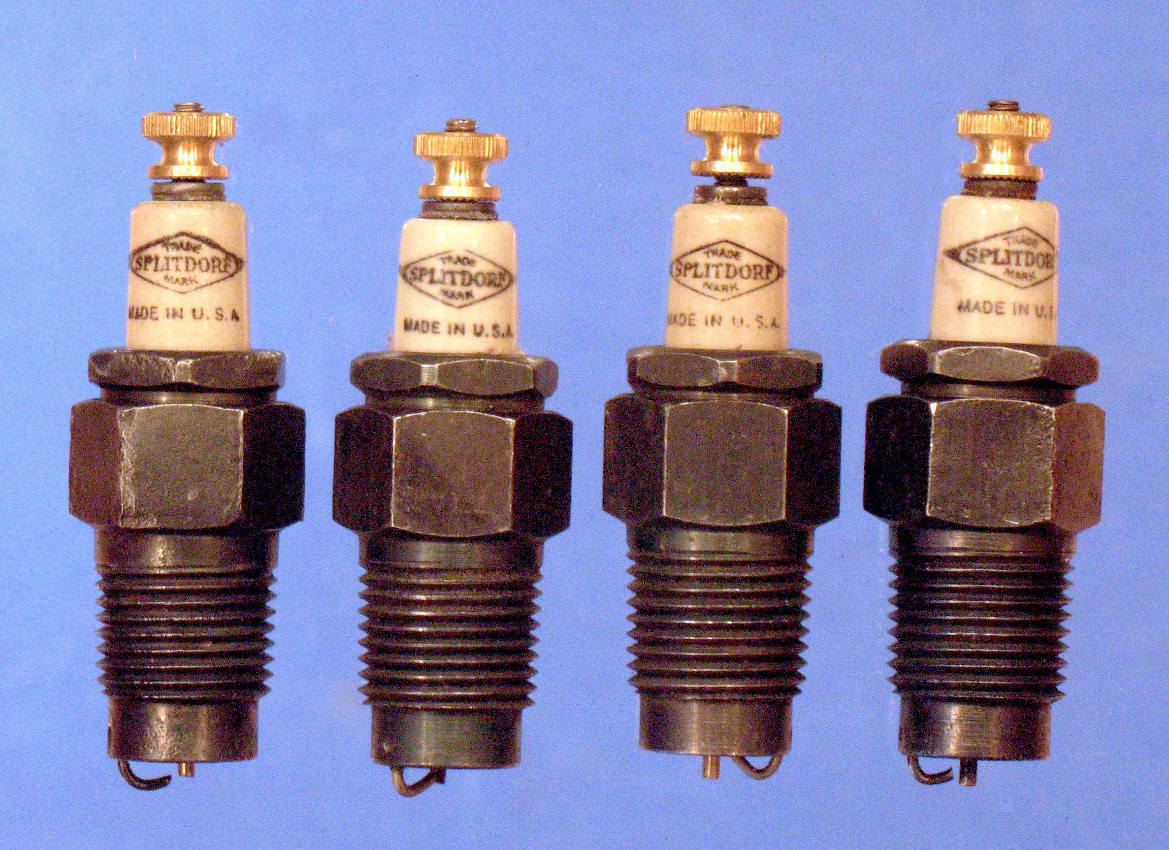

The modern ones are notorious for that. Autolite 3095 is cheap and works OK for awhile, but you're lucky if they're good for a year. I've used modern plugs, but have gone back to old timers. New Champion X plugs are ungodly expensive, but you can get originals at swap meets or on eBay much cheaper. At swap meets I buy plugs for $2 - $5. I might go as high as $10 for a nice early plug. I think the Splitdorf plugs I've been using are from the thirties.

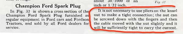

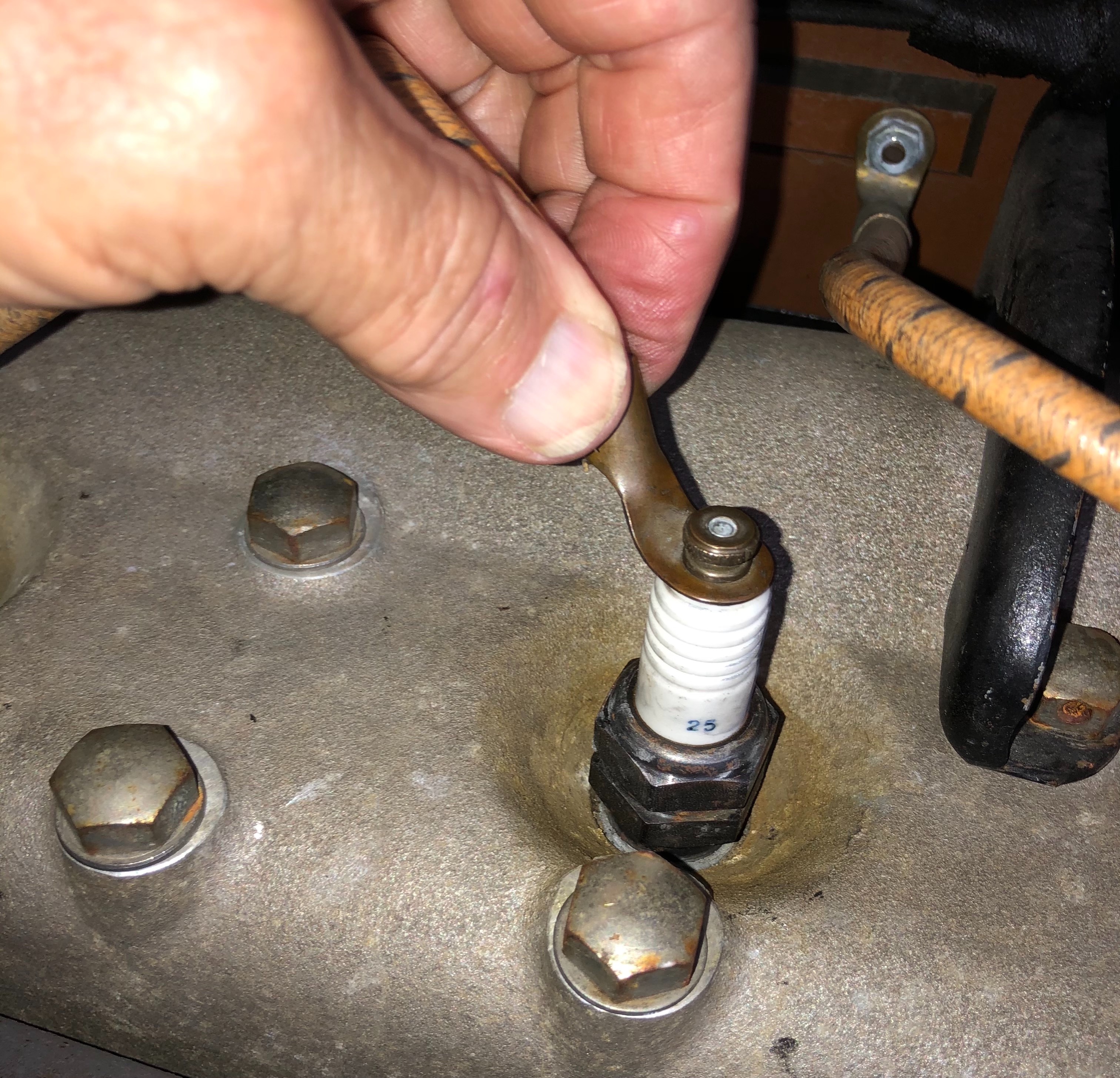

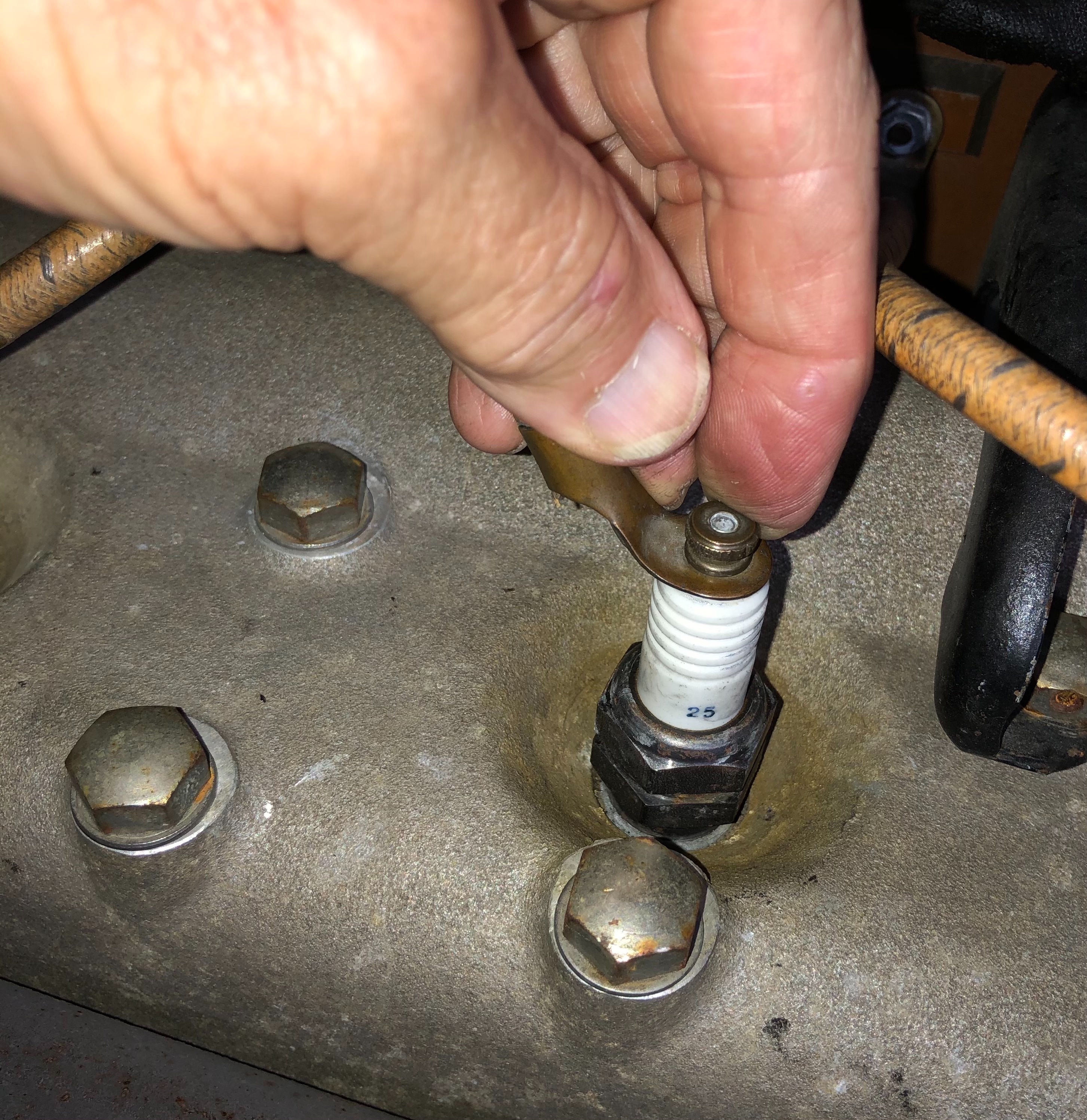

Have experience that before with the Champion 25, but still like this plug, run them fine. Seems to work well with the Prus high compression head, gapped at .025"-.028", hot spark from strong magneto too.
That upper post is only ceramic glued, so take care in plug wire attachment. Even Ford realized that use of pliers or tools on the terminal nut is bad for the electrode.
So, I always do what Ford suggested, that is to twist the knurl nut with finger and thumb firmly on the brass terminal.
Then push on the spark plug wire to rotate the brass terminal on the wire clockwise, that will 'lock' the brass plug terminal under the knurl nut for solid contact.

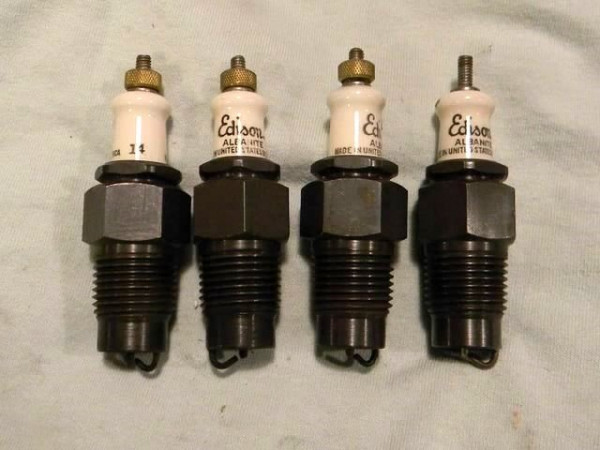

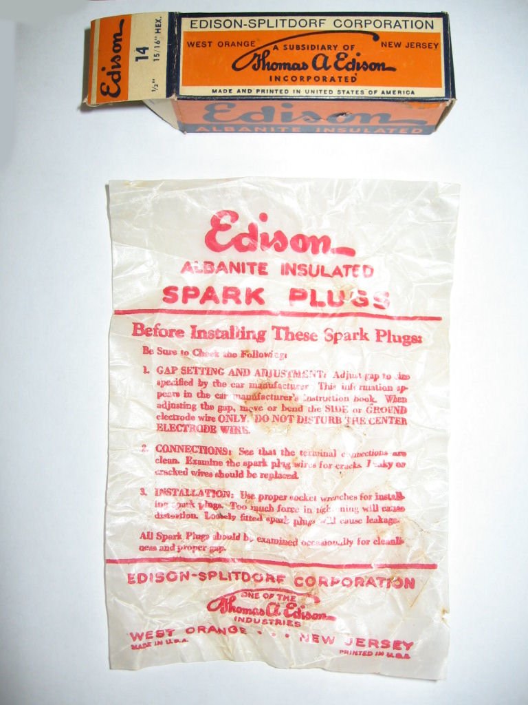

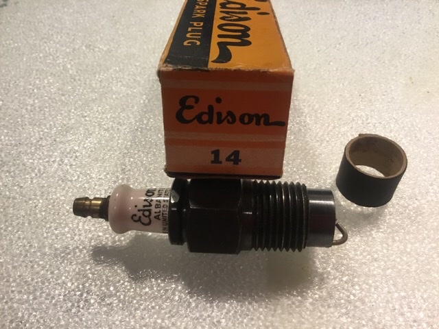

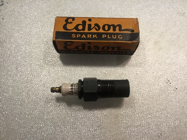

Has anyone used vintage #14 Edison’s? I have several mint condition ones in my display case, but use Champions I bought in 1970. Jim Patrick

When I had the same problem, it was because the nut sold with them(the normal spark plug wire type) would not go down and hold and kept coming loose. This was way back pre internet and didn't have a people to ask base at the time. The threaded in part unscrews when you take the nut off. You could just screw the end back in, it would make contact but more then likely with just unscrew again. Maybe two part epoxy on the thread part in the plug.

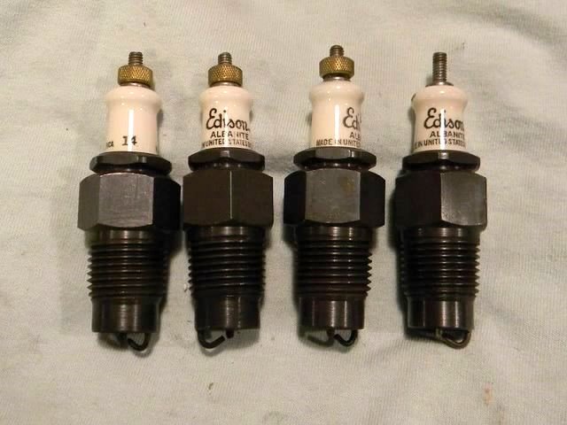

Those are great looking Splidorf plugs, Steve!
I run Edison 14s in my car, they burn hot and run great. I haven't had to touch them since I installed them in 2014.
