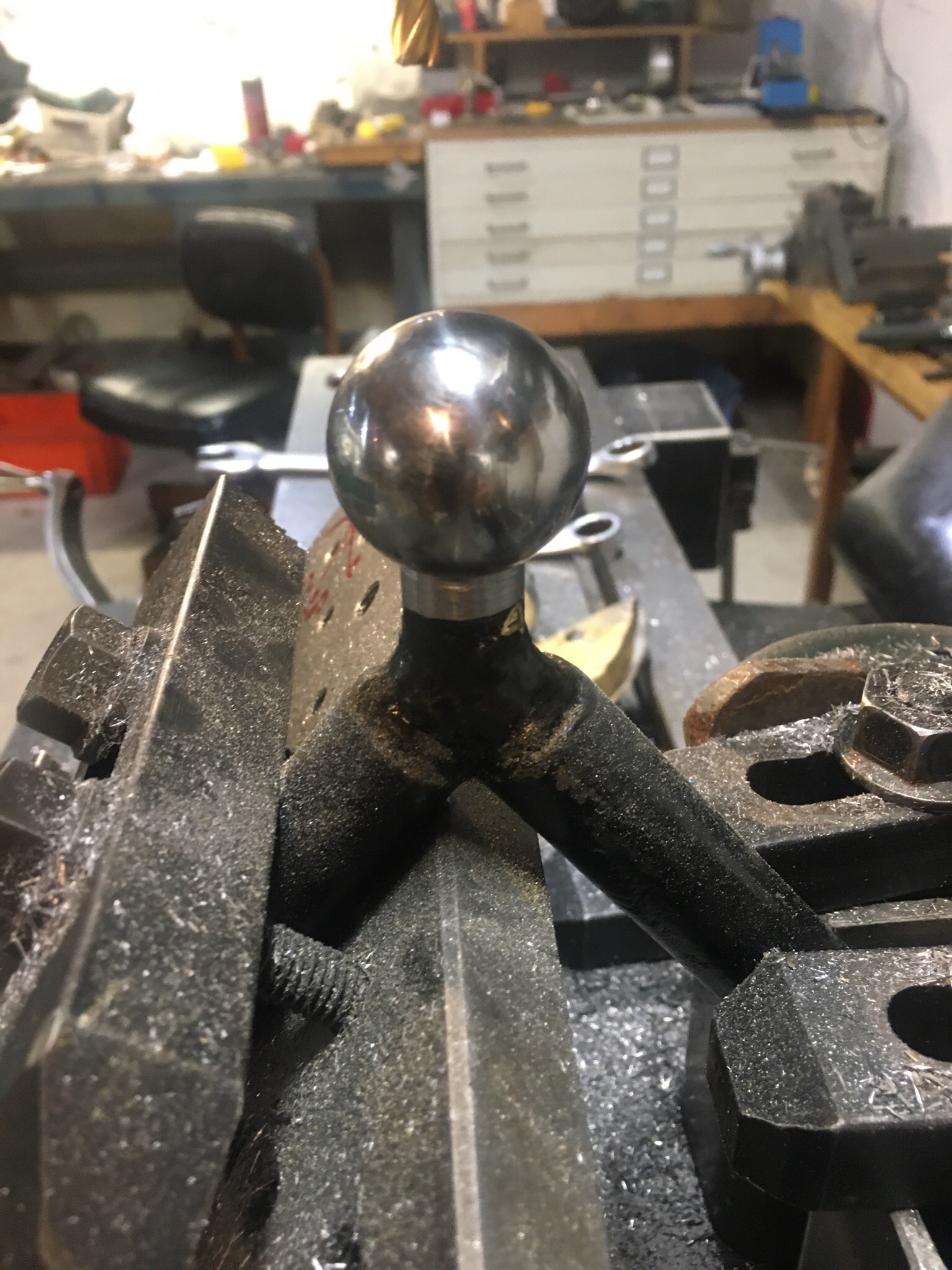

Hello All my friend and I were going to attempt to replace the ball on a early front radius rod. We are thinking to cut the old one away on the milling machine drill hole in a inch and a quarter stainless ball barring. I can imagine some here must have tried this, and if not I still would like to hear what the thoughts are on this idea. Or is there a better way to skin this cat? Thanks Craig

Thanks for the replies! We cut this this morning and we’re going to pin the ball. After reading through the answers above we will weld it as well. Would anyone here have experience doing this and how it holds up over time/miles?

Craig's photo shows the early Y forging which has the tubes coming almost to the ball. Later over-the-axle style wishbones had the forged Y like tose used on the under axle wishbones. I have never been able to ascertain when this change was made.

Thank You David I have been contemplating how to go about working with these two different metals. I will be trying your idea of silver brazing them together this weekend.We also have discussed drilling and pining the ball in place once we are sure of the correct location for It along the newly milled shaft.
