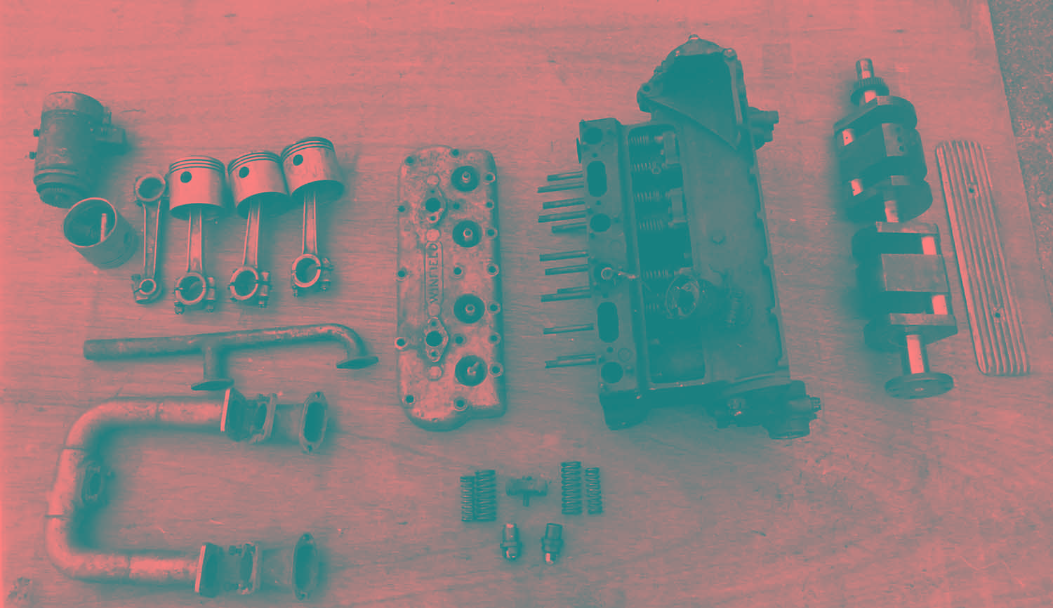

I have decided to walk away from this project.
If you will pay the shipping I will pass on the crank and cam. The only criteria is that you convince me that you can carry on and I will share everything I have learned.
All the best
Les
Probably best to contact me off the website!

I’ve thought long and hard about building one of these cranks over the years... but was never a priority for some reason...? I’ve imagined carving on a 4” x 6” chromoly bar for many hours... and then flipping it over to continue carving for many more hours! Not to mention the drilling, the grinding, the heat treating... and the BALANCING!!!
Now what about the rest?! The tremendous amount of work to build an engine worthy of housing the crank is near unmeasurable. Not to mention everything attached to it!!
It would be incredible to create such an iconic piece of early racing history, but it seems to me this crank should go to someone who is looking to recreate the “Kant Skore” special, or some similar high profile effort to honor the Winfield legacy. And of course, if nobody out there is taking on such a project... I would be honored to use this crank for my own selfish interests 😉

The crank wouldn’t decide how the engine made power... but theoretically allows the siamese intake ports to be less... well siamese. Even with this crank and cam, the siamese intake ports are still arguably inefficient as there will always be the dead space associated with the “other valve”. However, it will provide even use of the siamese port, and so preventing one cylinders air charge from affecting the other. At the time, almost all overhead conversions had siamese intake ports as well, and so even with the increased port and valve sizes and combustion chamber design, they still suffered from the siamese port airflow issues. This probably had a lot to do with Ed being so competitive with his flathead.
Smoother firing was the main advantage, certainly not smoother running. Less variation between cylinder performance means more power! This crank installed in an otherwise stock motor should improve performance without changing the temperment or reliability, simply by improving airflow. Now the cam on the other hand...😉

I’m walking away from it as I have concluded that I have WAY too many projects and this one will certainly consume a bunch of time!!
Properly built I don’t know of any reason that it wouldn’t be quite reliable and civilized.
Currently I have 6 other T based engine projects (not one of which is stock). Then add in a bunch of other cars I realized I should pass it on to someone like KEVIN!!
