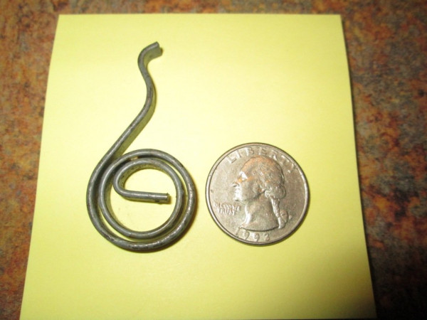

Re: 1915 Touring ar Door Spring
This is the new spring I replaced the broken one with in our '14 Touring - I believe the '15 latch to use a similar one.

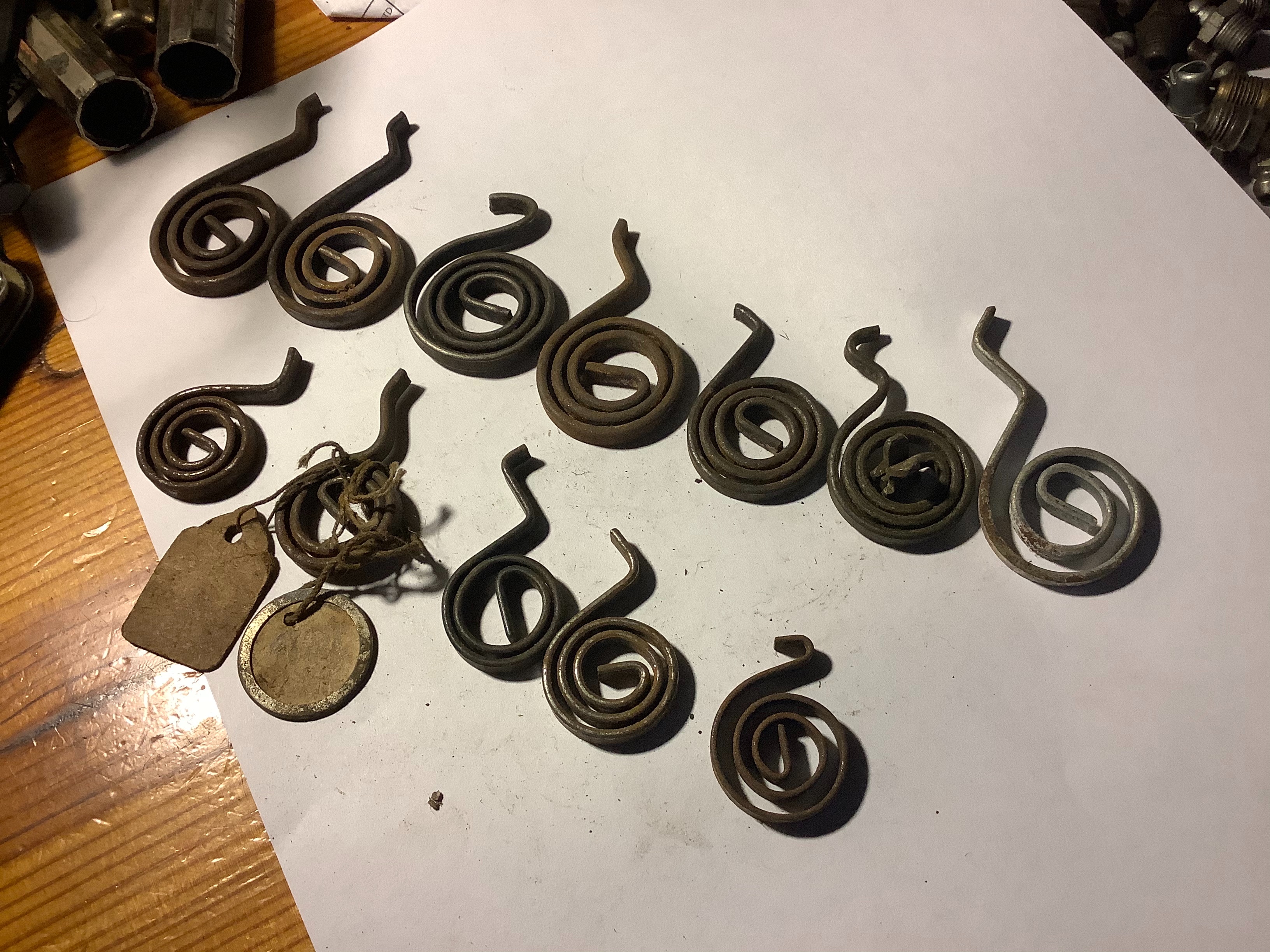

Looks like I can maybe help. As you can see, lots of variations. Tmorsher@icloud.com to reach me.
