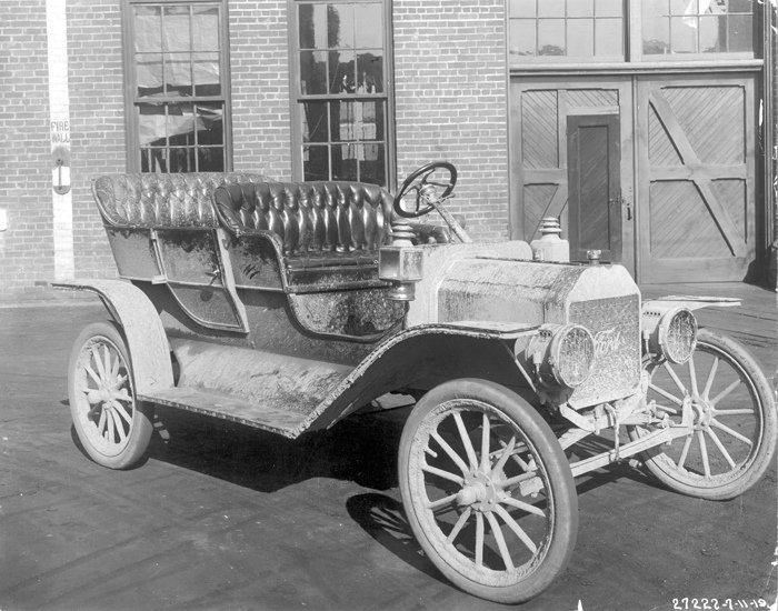

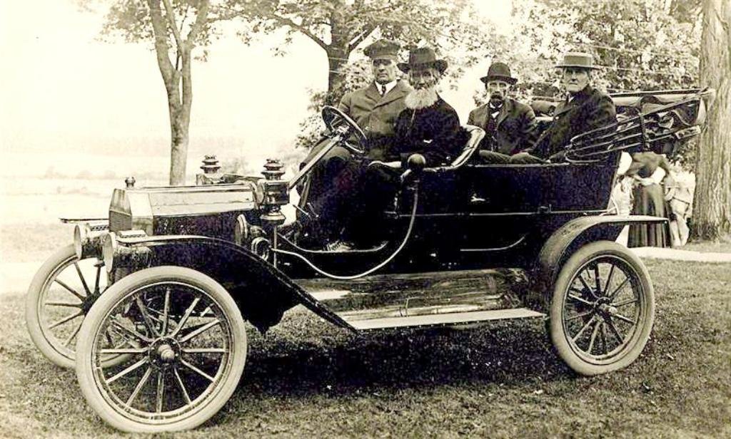

It was only the two (one right, one left) front body mounting brackets that used two bolts. The other four (middle and rear, two right, two left) were three bolt like nearly every other T through '25, from the very beginning of model T production. The change was made to three bolt on all six brackets around the beginning of 1910 model year on the touring car bodies (late 1909 calendar year). There appeared to be about two months when both two or three bolt brackets were being used in that front position on touring cars. There are several good solid survivor early 1910 model T touring cars with the two bolt brackets on the front (Including if I recall what I read, Tony Bowker's).
According to the number of original era photos showing them? The open roadsters apparently got the change to all three bolt brackets a little later, probably in early calendar 1910. There are a surprising number of photos of clearly 1910 roadsters with fully 1910 features, still having the two bolt front brackets. The crossover period was probably a bit longer on the roadsters also.
