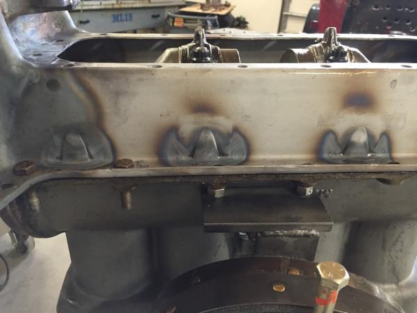

Here is a pic of the pan bumps... and there will usually be a 3/8”-1/2” thick spacer between the pan and inspection cover as well

I can usually tell if it’s an A crank by the “bumps” on the side of the pan.

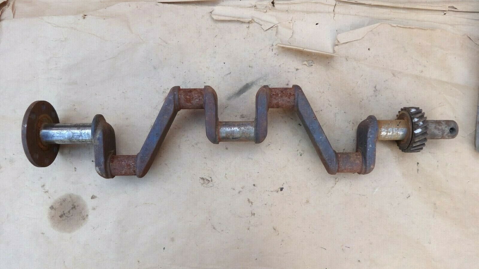

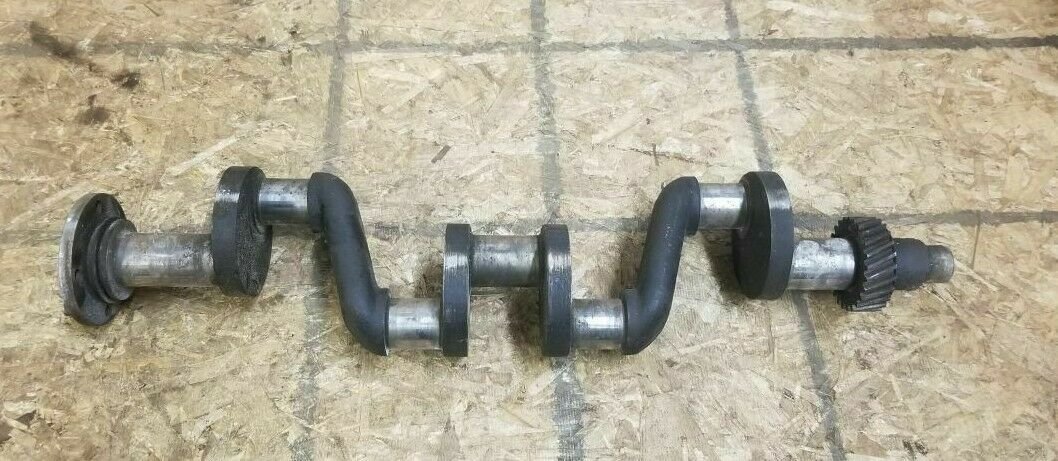

Model T...
Model A...
Model A...

Thank you, Tim Rogers. Opened your post while my wife brought my coffee this morning! She also likes cars. I asked her could she see the difference between Model T and Model A crankshaft. She immediately saw the difference! She said, "The Model A looks 'newer.' "
