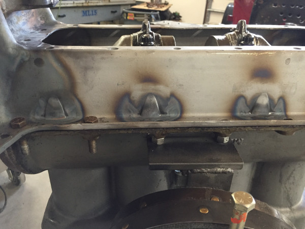

If the front of the crankshaft at the pulley is threaded and the pan has four bumps on each side where it is bolted to the block, there’s a good chance you have a Model A crank

Here is a pic of the pan bumps... and there will usually be a 3/8”-1/2” thick spacer between the pan and inspection cover as well

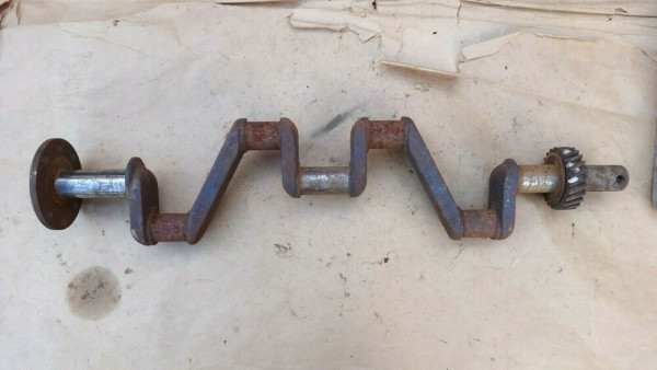

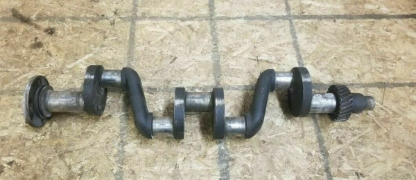

If you have the inspection pan off, and are not familiar with either crank... the A crank has circular webs near the main journals, and the T crank will look like it was bent up out out of a coat hanger

I can usually tell if it’s an A crank by the “bumps” on the side of the pan.

Model T...
Model A...
Model A...

Thank you, Tim Rogers. Opened your post while my wife brought my coffee this morning! She also likes cars. I asked her could she see the difference between Model T and Model A crankshaft. She immediately saw the difference! She said, "The Model A looks 'newer.' "
