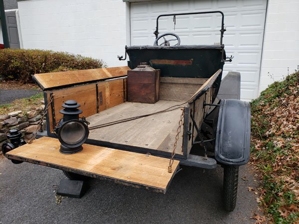

Post by Retro54 » Sun Nov 22, 2020 4:55 pm

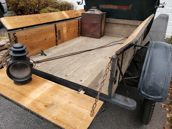

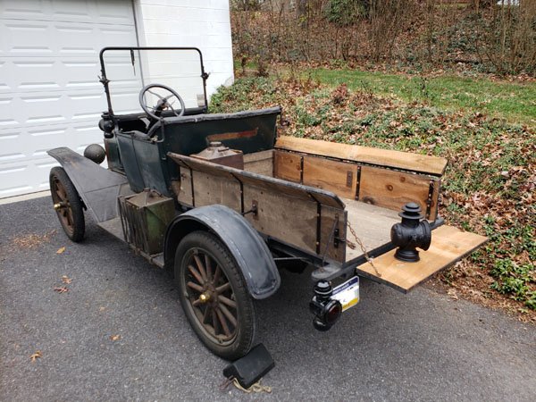

Whelp... 2020 may have been a year of setbacks, but also of triumphs! With time on his hands and having as much or more excitement about this project as I have, Dad plowed forward and completed the bed for the T. I've posted here a few times as we made leaps forward in progress, but after just under a year the truck is about done. And really, I would NEVER have gotten this done without Dad's picking away at it. I did spend time in the shop working with him, but between my visits he kept picking away at it and really got it to this point. He was happy to do it, and I'm excited to have a real family TREASURE!
Here are some previous posts:
- Photo Request for 1915 cut-off touring: viewtopic.php?f=2&t=2771&p=21774#p21774
- Getting Ready for the road viewtopic.php?f=2&t=14722&p=111533#p111533
- Seeking Wood Bed Plans: viewtopic.php?f=2&t=15140&p=120580#p120580
- Project Update: viewtopic.php?f=2&t=16371&p=124072#p124072
Both Dad and I are both just tickled with the results! This is the kind of car we seek out at shows and we hope it will be a conversation piece at shows I get a chance to get it to. Not bad for progress from April 2019 through today ehh? I'm proud of our progress!
The building of this body, for us, was an exercise in discipline. We really really wanted it to look like a body that COULD have been built by a farmer in the 1920's once the family was done using the touring car body. To that end, all of the hand-forged hardware is from an old Indiana farm wagon, and the pieces we needed to 'make' we tried hard to make match the look of the other old hardware. Lots of neat, little details pull this all together and make it what it is. The dimensions are just slightly taller and slightly longer than the 'slip-on; kits you can purchase or that were produced in the old days from vendors. We just used our eye and determined what worked best for this truck. It's certainly unique, but so is the rest of the car. As you can see, just adding a few period accessories really makes the look! This is going to be fun to use and show. And next year, after a few mechanical items, this fun car will be hitting the road! Next up is a re-build of the rear axle and checking the bearings, then it just needs lights and I'll be on the road.

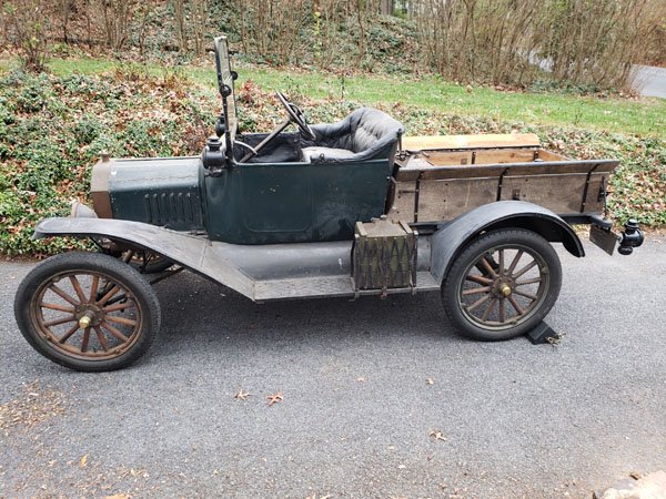

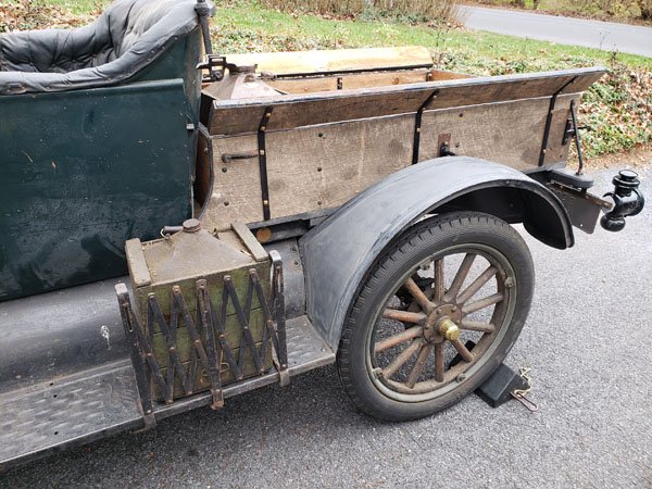

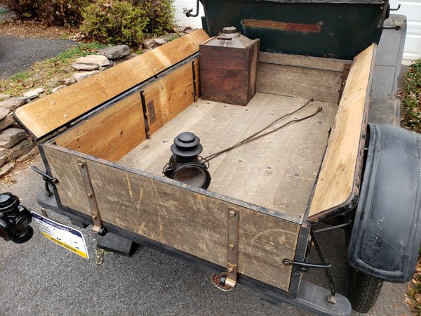

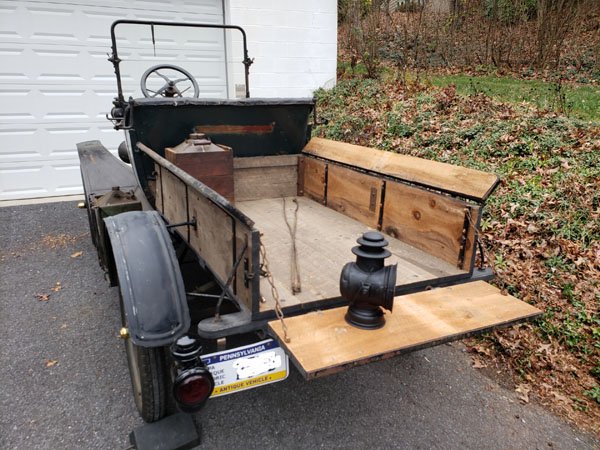

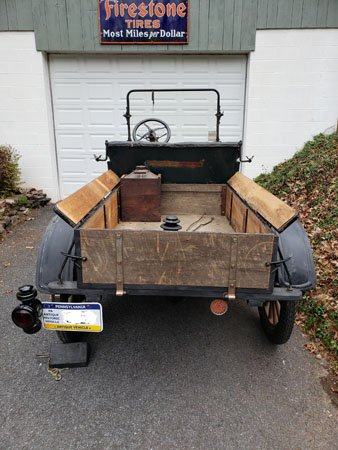

Some more shots... I got lots!

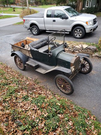

Post by Retro54 » Sun Nov 22, 2020 4:56 pm

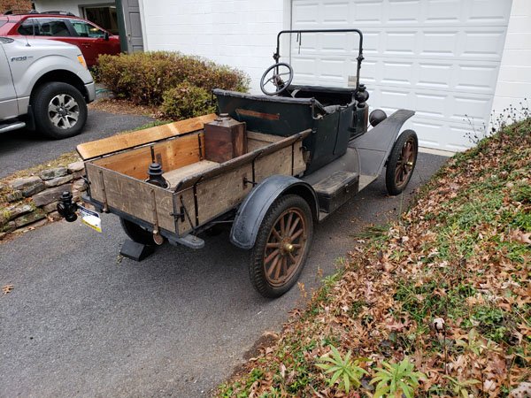

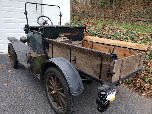

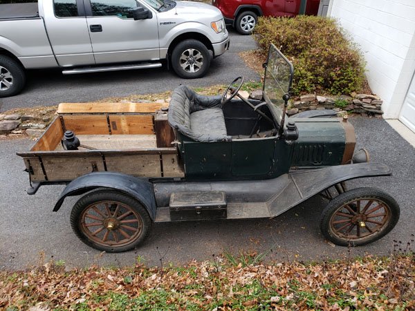

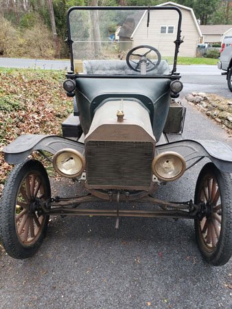

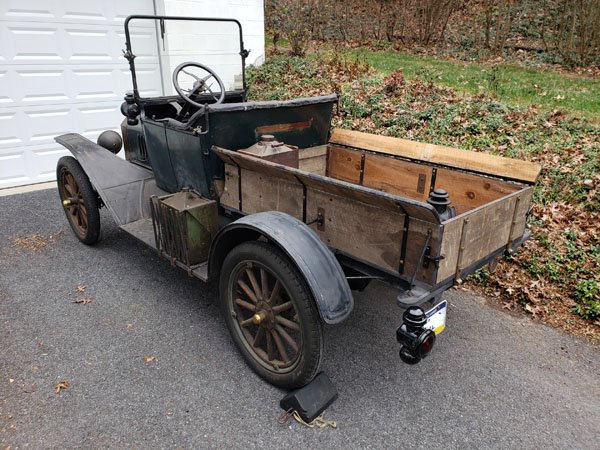

More photos of the overall car.. then some detail shots.
The 100 years or so between the gray ford truck and this one is certainly not lost on me!

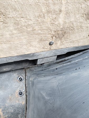

Post by Retro54 » Sun Nov 22, 2020 4:57 pm

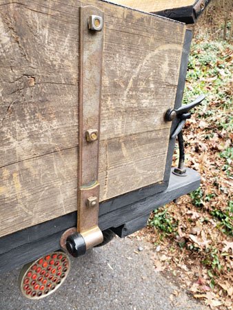

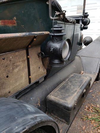

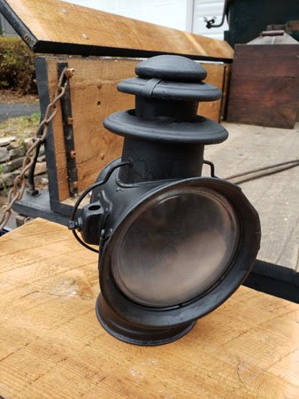

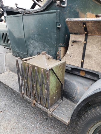

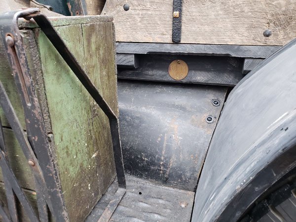

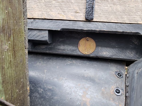

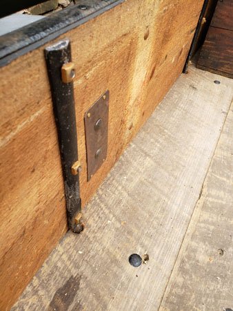

Some details...
The Harrisburg, PA brass tag on the bed rail is a Copper Phone Cable tag.. pretty cool little thing.

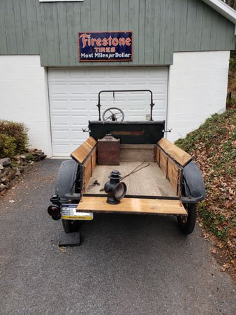

Post by Retro54 » Sun Nov 22, 2020 4:58 pm

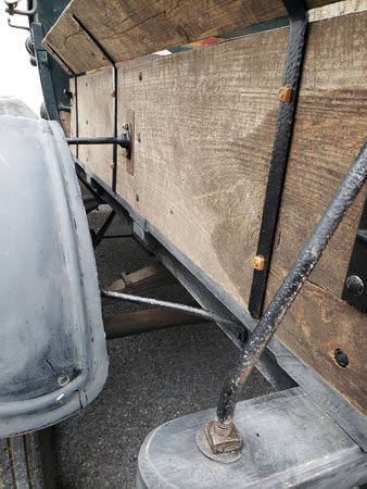

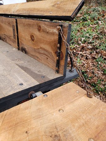

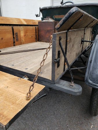

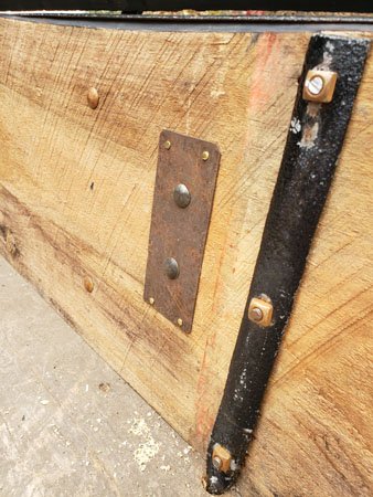

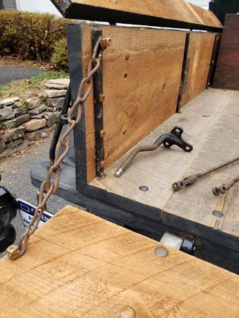

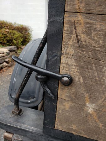

More shots of the bed... hope these detail shots help someone out someday!
The bed latches are the ones sold by Langs. I think that most people mount them with the handle pointing out from the rear of the bed, but that seemed like a hip-sticker to us! Mounted this way, they are flush with the body and shouldn't stick anyone.

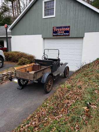

Post by Retro54 » Sun Nov 22, 2020 4:59 pm

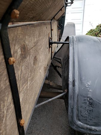

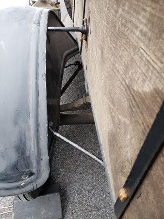

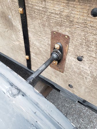

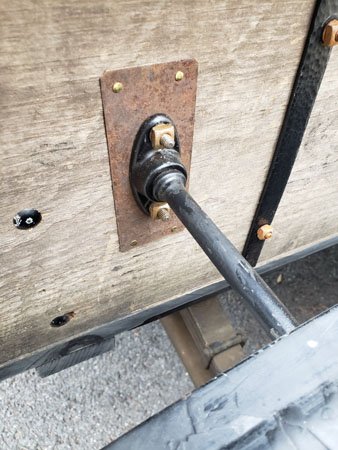

Some more detail shots... These last ones are of the fender mounts, we figured it out ourselves, and while not exactly how other body's may mount their fenders.. it works well for this roadster pickup. You don't have to make it complicated!
Retro54
Posts: 590
First Name: Andrew
Last Name: Blaydon
Location: Middletown
Re: 1915 Cut-down Touring Body completed
Post by Retro54 » Sun Nov 22, 2020 5:02 pm
Last photo dump. The post for the fender bracket mount is a new metal rod.., the bracket is a touring bracket if I recall correctly. The rod threads into the bracket on the bed side and is long enough to go through the entire fender mount bracket underneath the fender. The extra brace rod at the read of the fender really stiffens the whole deal and make the fender pretty solid.
The metal plate is tacked into place and should provide reinforcement for the support bracket. Plus, it looks the part too!

dmdeaton wrote:
Sun Nov 22, 2020 8:26 pm
Andrew,
Where did you get the tailgate hinges?
They are new.. ha! 10 inch strap hinges on strait pintles.. bolted thru the rear wood cross member. 8 inch hinges were too short.

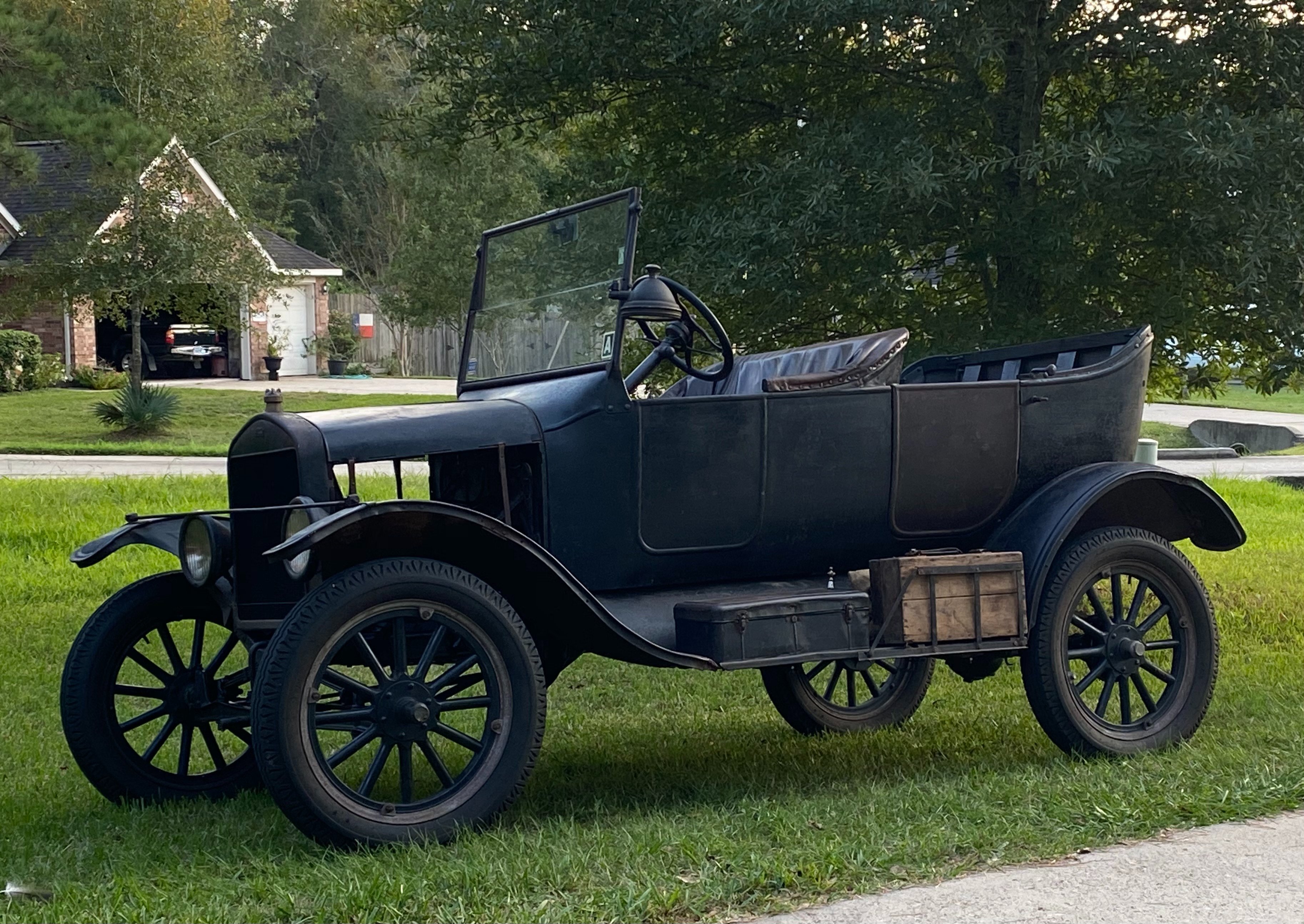

Re: 1915 Cut-down Touring Pick-up Body completed
Post by RustyFords » Mon Nov 23, 2020 4:19 pm
It looks super Andrew....congrats on a really nice job.
This is my favorite look for a Model T....as John Mays says, "it has its work clothes on".
Here's my 24 Touring dressed in that same kind of attire. :)
