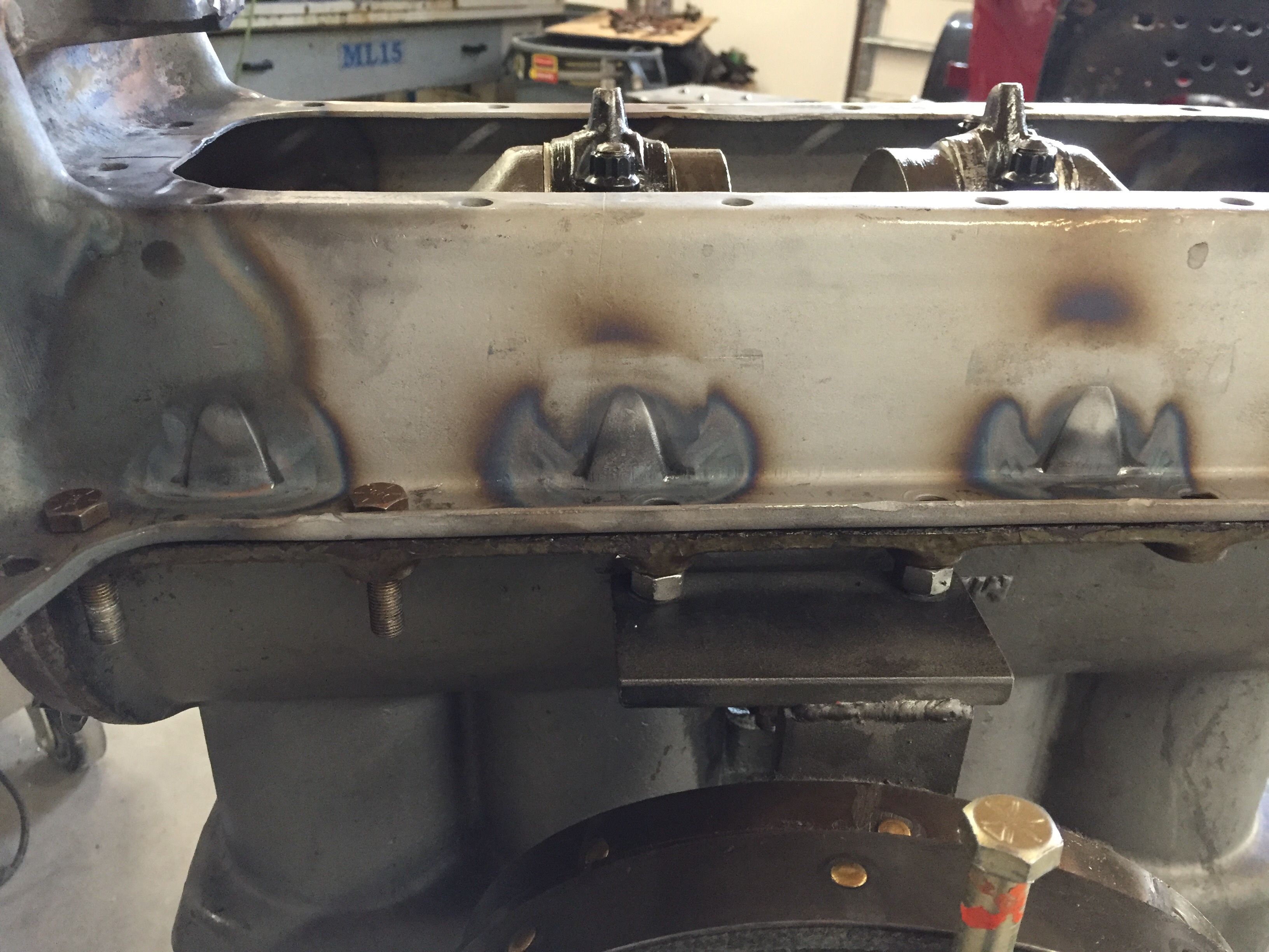

Here is a pic of the pan bumps... and there will usually be a 3/8”-1/2” thick spacer between the pan and inspection cover as well

I can usually tell if it’s an A crank by the “bumps” on the side of the pan.
