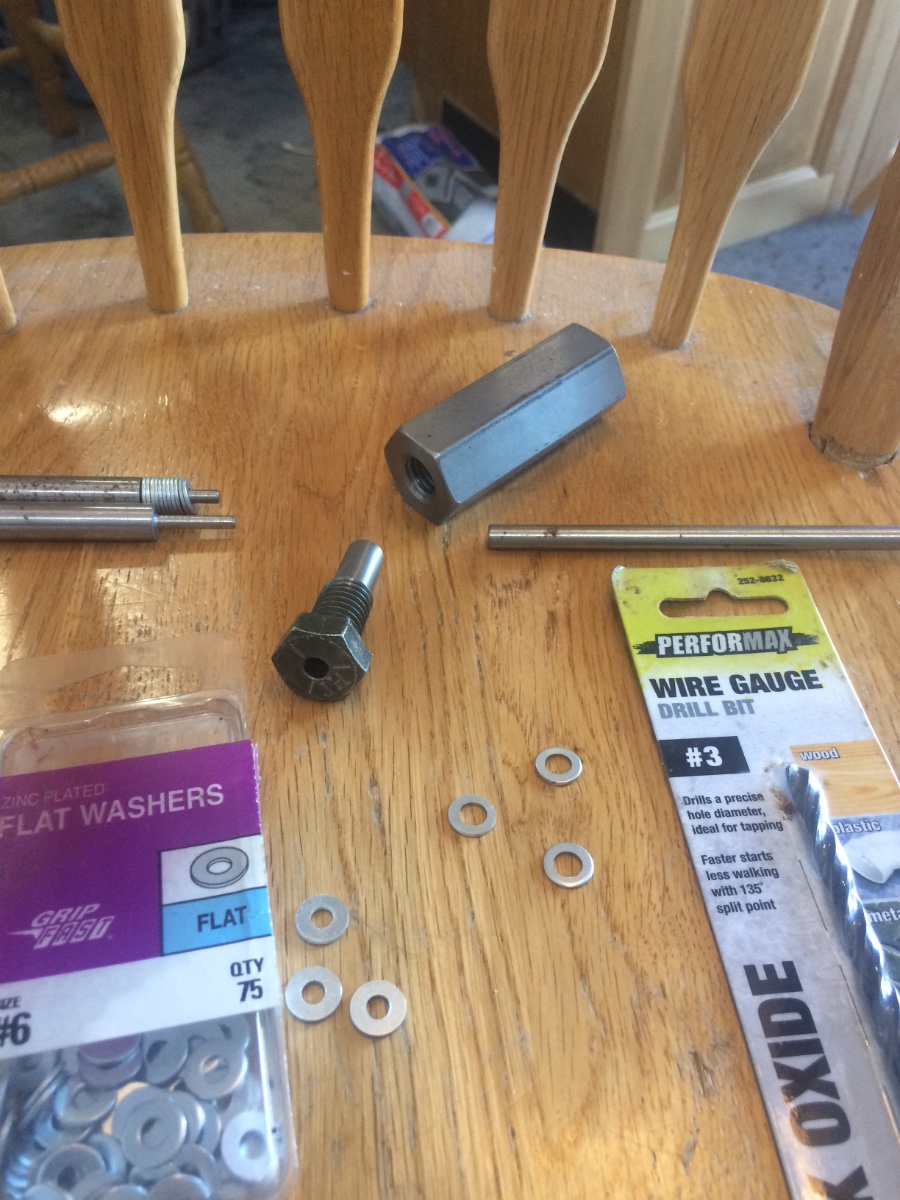

Make a fixture to hold and drill #6 flat washers with a #3 drill bit.

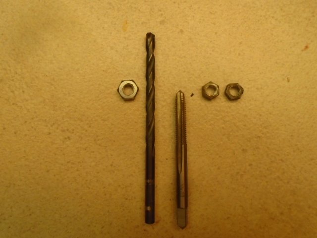

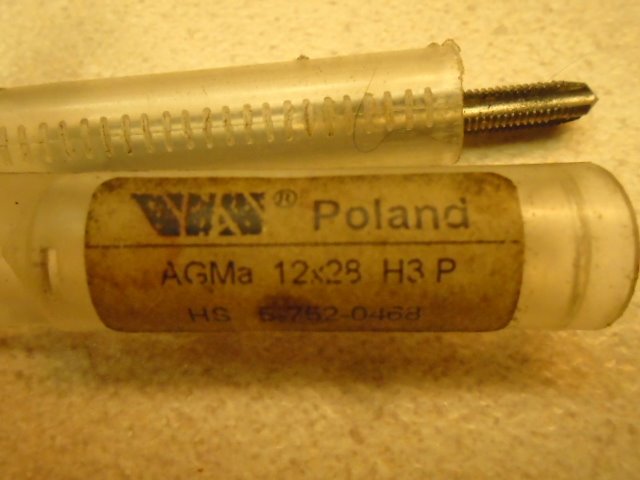

The front most nut is 10 - 32 the remaining nuts are 12 - 28. I made a set of nuts by using a #8 nut and drilling it out with a #14 drill bit then tapping it with a 12 - 28 tap The two small nuts on the right, one is original and one is a # 8 nut drilled out with a #14 drill and re-tapped to 12-28. Once set up these nuts can be made very quickly

The coil vibrator and upper bridge nuts are 12-32. I buy thousands a a time with other rebuilders and vendors. They are custom made from the Ford print. The taps and dies are available from several vendors. I believe I purchased mine from KB tools. Dean made me a tool for shim washers and it works great. Thanks Dean!

Dean, that is an awesome drilling fixture you have made up there. I sent you an email but I am not sure if it went through with the new forum. Could you possibly tell me how you made that or what it is made of? My last restoration amongst my hit and miss engines was a South Bend 9 inch lathe and I am dying to find a project for it.

My error the top nuts are 12 - 32 not 12 - 28. I had a 12 - 28 and a 12 - 32 tap in the same container and I picked up the wrong tap. I have now put them in separate containers. I tell my grandson it is because I am 80.
