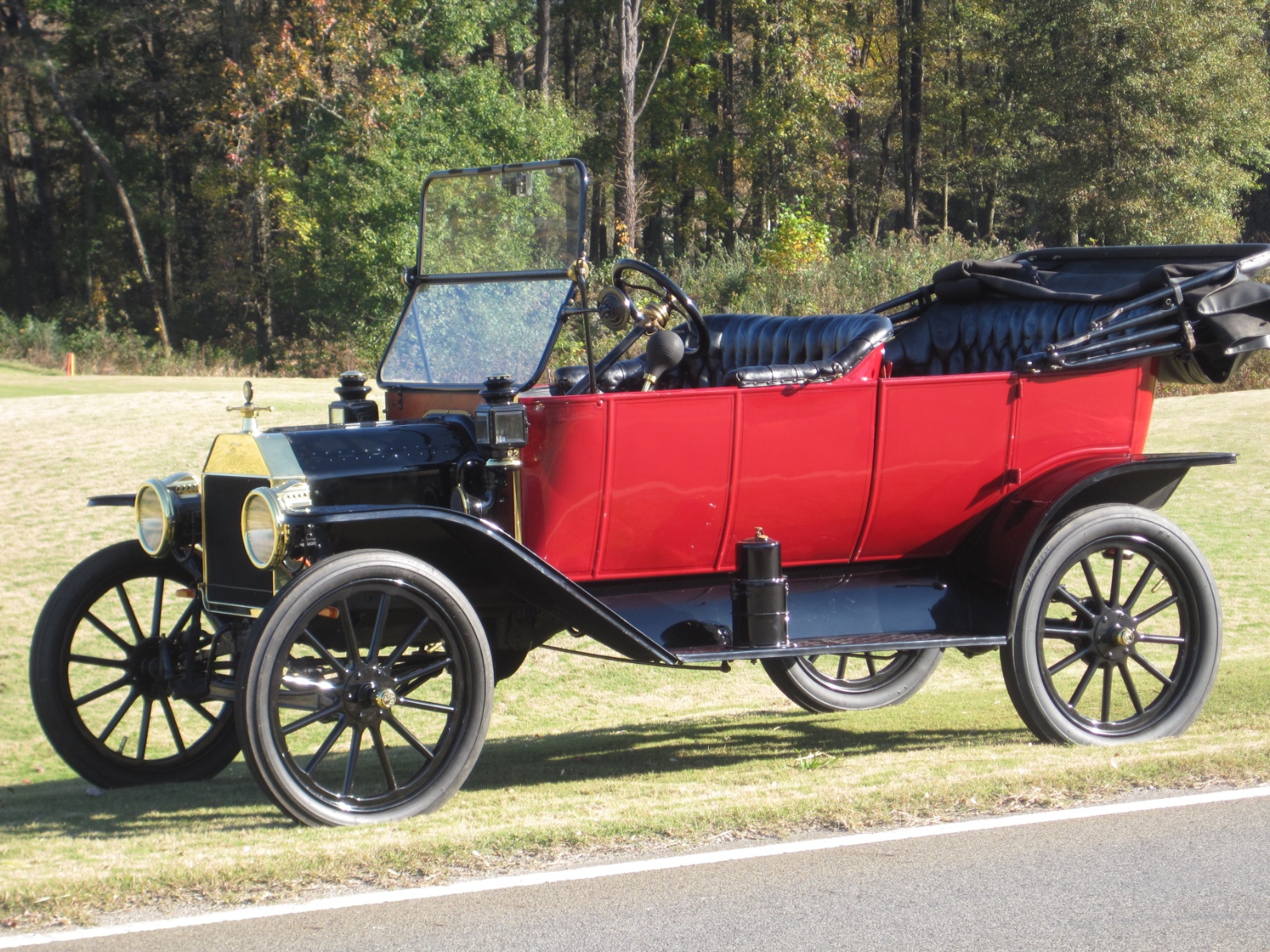

I am in the process of replacing the top on my ’13 T. It is an early ’13 with an engine casting date of 12/15/12. I have three different types of brass Murphy fasteners on the car. They are the figure 8 style, the oval cast base style and the oval pressed base style. The pictures below show the three different styles. Can any one tell me what is correct for an early ’13? Do any of you have an original, early ’13 with the Murphy fasteners?

The one on the right is correct. Keep in mind Ford did not use the same brand fasteners on all '13s. Actually most of them were plain, unmarked.

Larry, thanks. Were you able to find documentation on the fastener you identified as the correct one, and if so, where? This style is not reproduced, but the other two are. For your information, my '13 Touring is the one that was owned and restored by Otis Clinton.

Hi Kim, my car is the red one that Otis restored in the mid 50s. It seems to be a pretty authentic car, other than the color.

Don: I have many fond memories of your car. Otis and I were close friends for many years, and I have rode in your car on many occasions as well as touring with them. Looking at the photo you submitted, it appears you have roadster L arms for the top. Otis had a '13 roadster too, and maybe he got them switched? When the top is down, the rear top socket should be parallel with the top of the rear fender.
