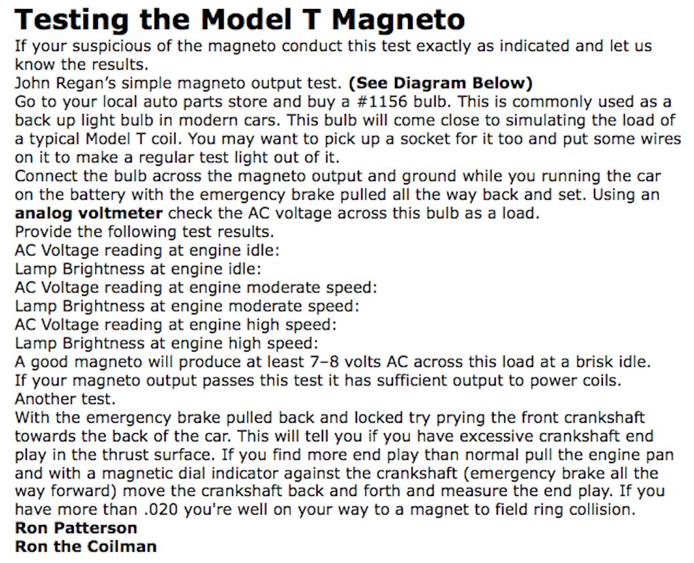

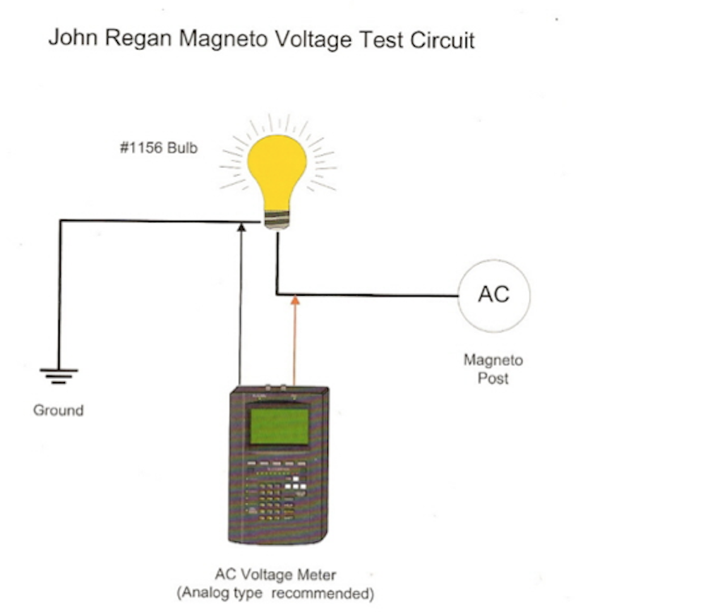

Easy test - start the car on bat, get out the trusty Volt-Ohm meter, set it to AC volts (at an idle you're only putting out a few volts), put one lead on the mag post, the other on the hogshead or other unpainted source of ground. Mag present = voltage shown on the meter, Mag absent = no movement on the meter.

I will also make up a test light as Steve suggested as they always come in handy especially when you only need a go/no go answer. Once I've started the T and tested for the coil I will then start rewiring the ignition switch.
