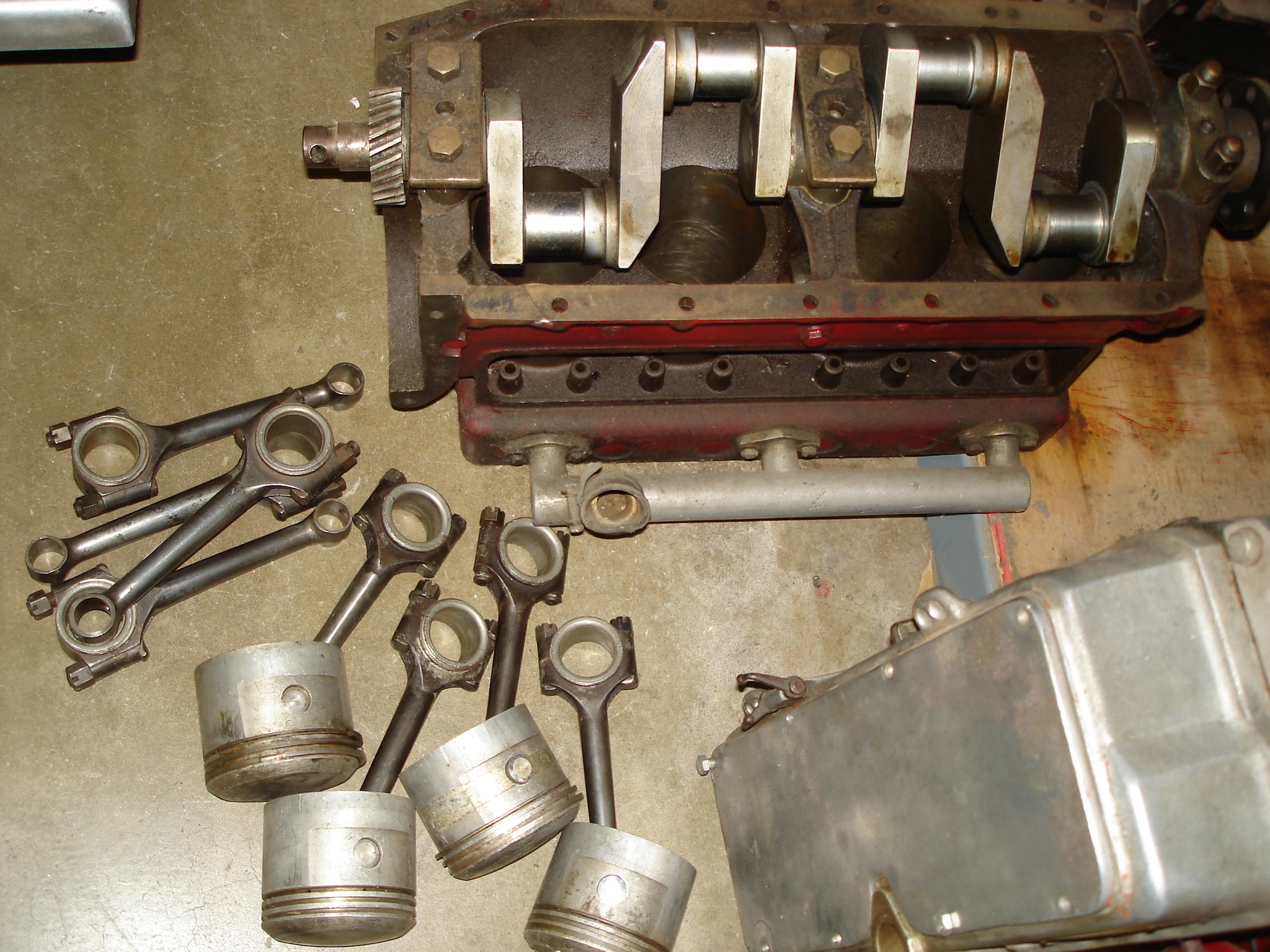

The bottom end of my DO Fronty sprint car engine. Wills Saint Claire V8 crank in a Model T block. Bronze main caps with steel reinforcement plates. Tube rods with full floating pistons and aluminum buttons pressed into the pins.

Re: Hopefully not too silly engine bolt/nut question
It looks like the helical gear on the crank (not sure if it's for a distributor drive or oil pump or the OHV valve system drive?) was removed, and the journals were turned down - to keep the rods centered in the bores, I'm assuming? I'd love to get the specs on your rods, as it's looking like I'll have to have a set made.
(Bye bye bank account! --lol--)
I'm actually thinking of something like modern press-interference fit pins, tho another option would be something like what Honda did with their racing motors 50 years ago and using circlips. I want to make sure whatever I put in there doesn't decide to come apart...
Interesting about the bronze caps; I can understand the steel plate backing them up tho ... last thing one wants is to have something come apart like that. One thing I'm curious about is if the stock main bolt locations are OK, if there's enough clearance to do that, or if they'll have to be re-located outbound of the original locations. I'm also guessing that the holes in the rod caps are for oil feed lines? My block has 3 drilled out bores at each of the main saddles that are threaded on the outer ends... I *think* the intest was to feed pressure oil; regardless, unless I can find a reason not to I'll probably follow that lead.
I need to check the stroke on the crank against the stock one I have to figure out clearances, etc. The one thing I noticed right off was the heft of that beast compared to a "normal" T crank. Maybe a "mere" BB Rajo head isn't enough for the crank?
Anyway, thanks, Mike, for the picture and the info...
Sus
Sus

Susanne- we make 1/2 x 5 and 1/2 x 7 Grade 8 + main bearing bolts with centerless ground shanks for use with our 1 1/2" tall heavy main caps. You can contact me at dmcgearsATyahooDOTcom if you would like more information. thanks, Dan

Email sent - thank you, sir!
