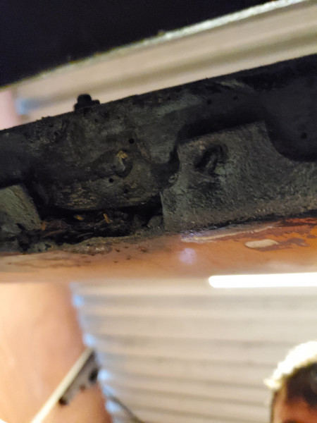

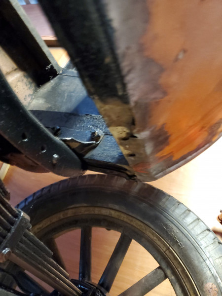

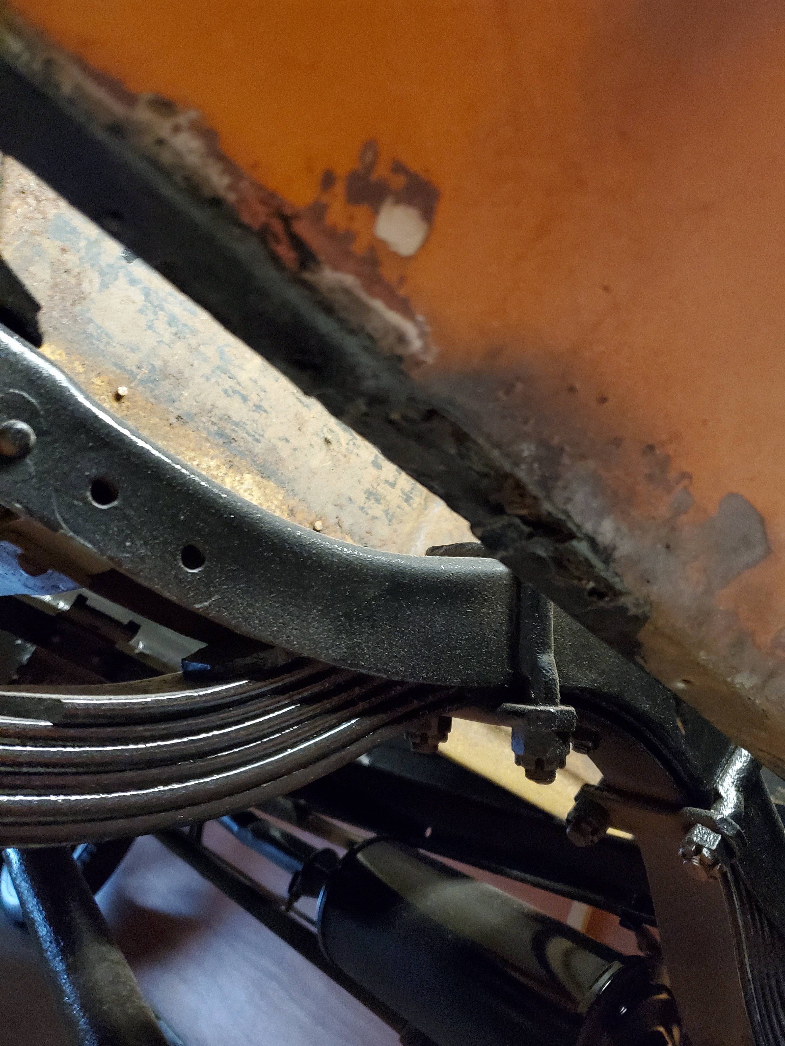

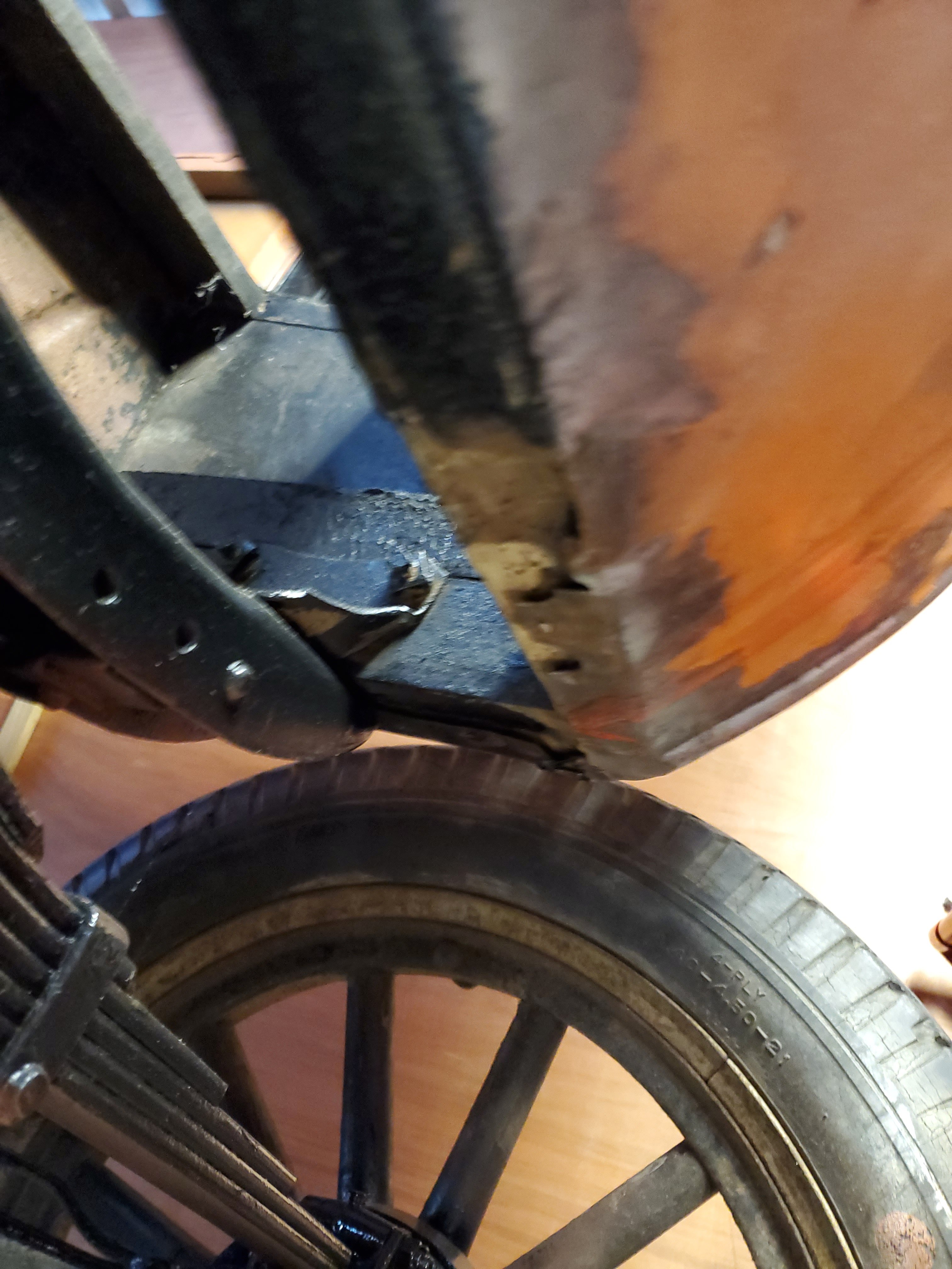

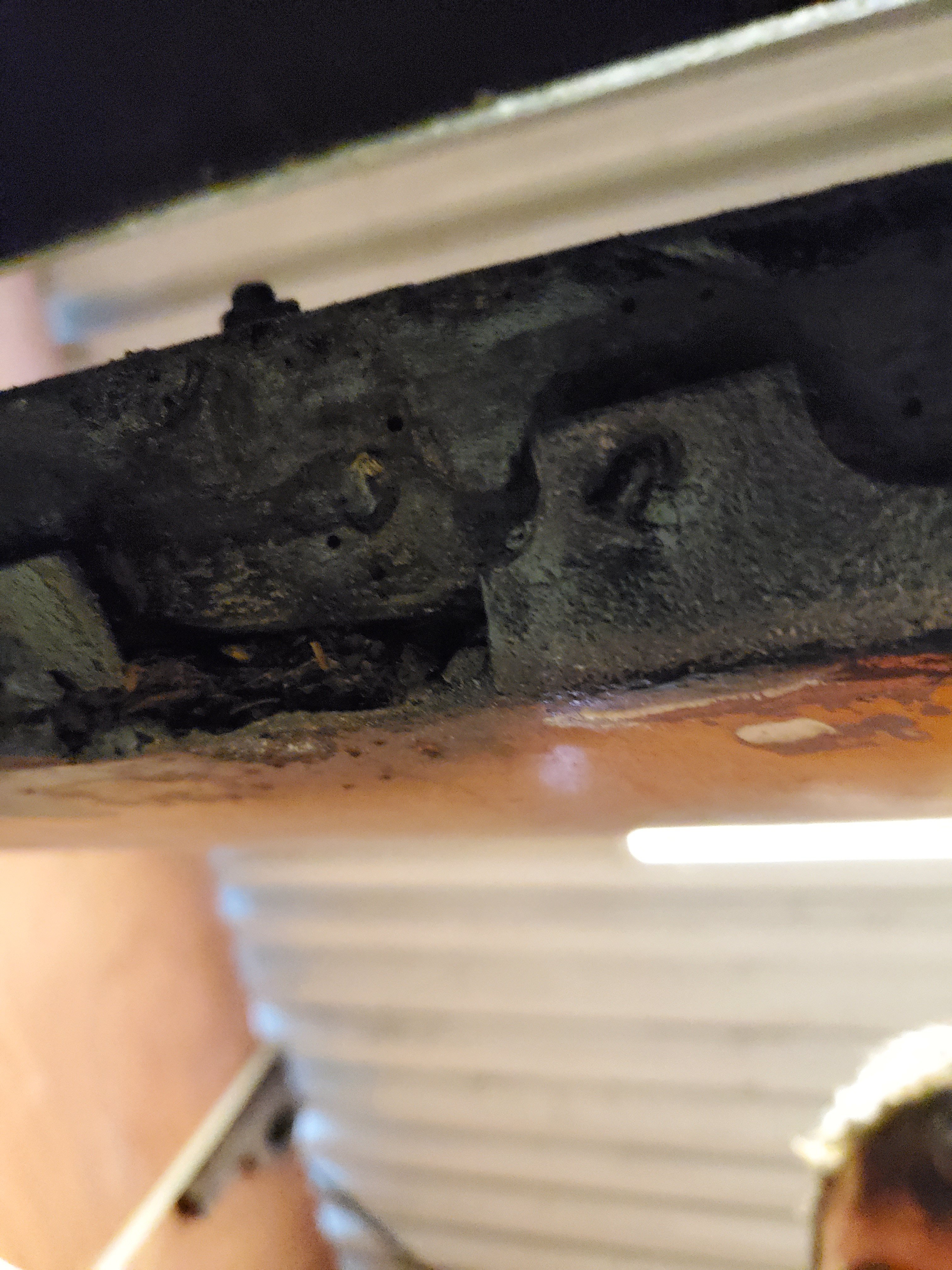

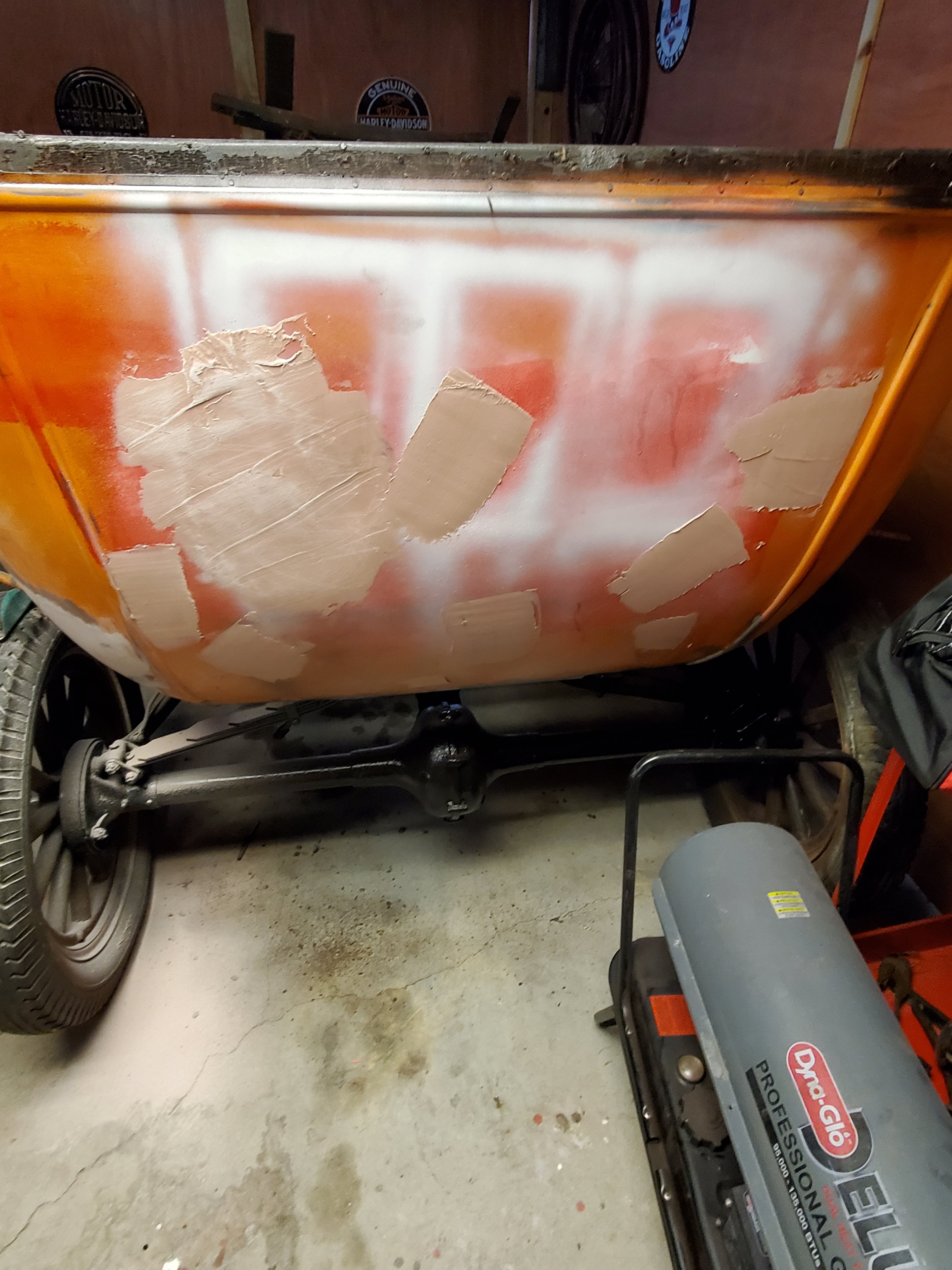

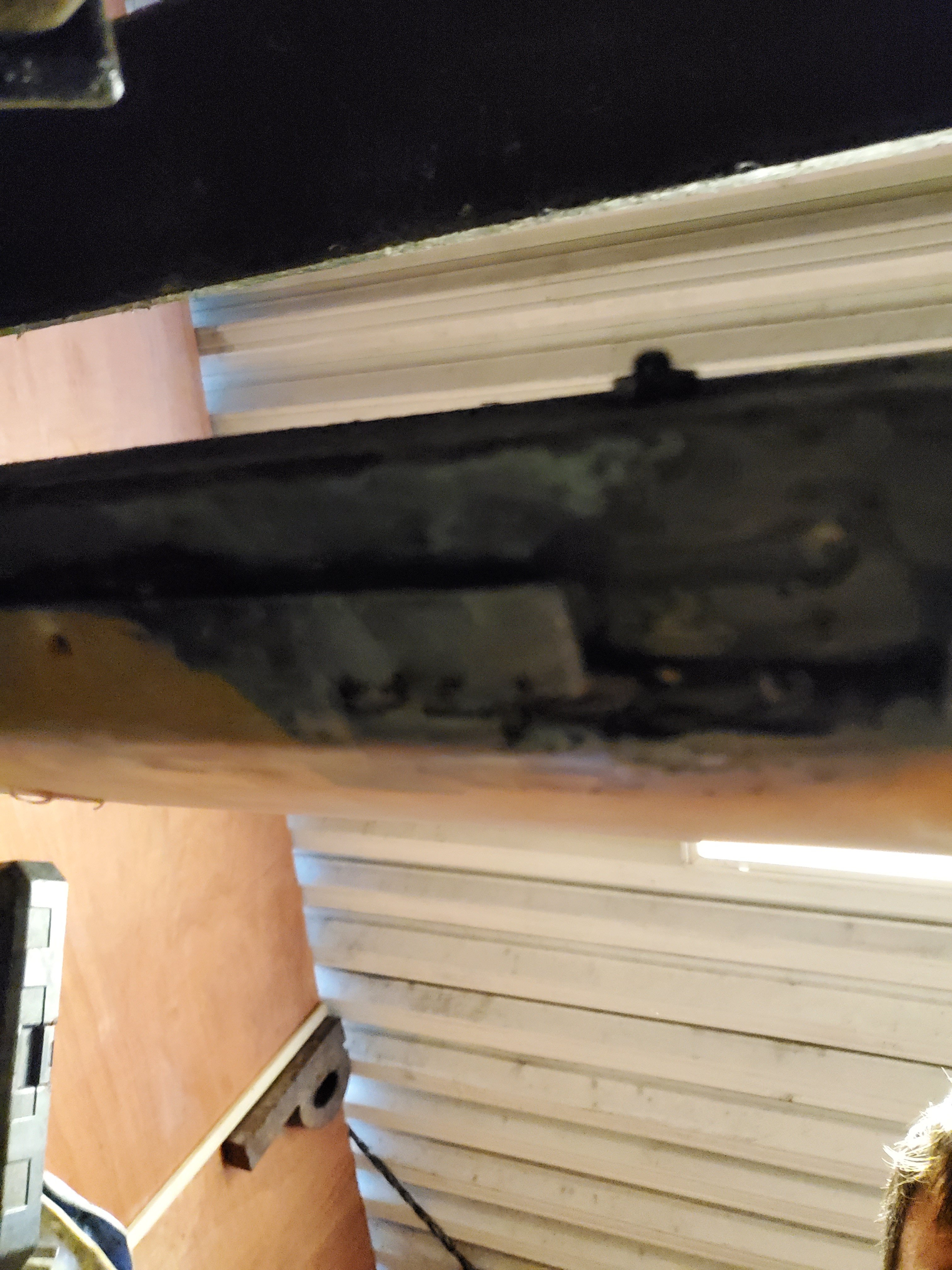

Hello all need some advice for my 23 touring. The rear panel is full of bondo, and the bottom tack strip that attaches to the body is rusted out. This is from water gathering under the spare tire bracket. I was thinking of ordering an entire replacement panel for the back of the car. Just a few questions how are these panels attached as I cannot see any obvious welds? What panel would I need from Macs or another source as I'm not sure on the year of the Canadian car vs U.S. panels. Thanks

Thomas, the panels are likely spot welded together along the rolled beads. These welds can be difficult to spot on a rusty/painted panel.
From your photos, I would not replace the whole panel and go through the process of massaging a reproduction panel to fit. Rather, I would have sheet metal worker fold up a patch panel to repair the tack edge. This should have the angled foot and a folded in recess along the top edge so that the original panel can be lapped over it. This will help it to hold its shape during welding. A series of 1/4" holes drilled in the original panel can be Mig welded through, just like spot welding.
If you have the skills and equipment to replace the whole panel, you could certainly do the repair to the tack edge. If not, the repair should be far cheaper than a new panel replacement.
Hope this helps.
Hope this helps.

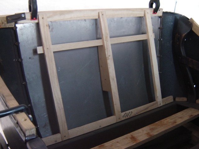

The rounded over molding strips are spot welded to either the quarters or to the panel itself (i cannot remember which and the metal piece in the bottom is spot welded to the panel as well.
There are also bolts that hold the quarters and that panel together. You can see that here in this picture

You'll want to save that T round molding as an exact match is not manufactured. Restoration Supply Company has one that's close.
