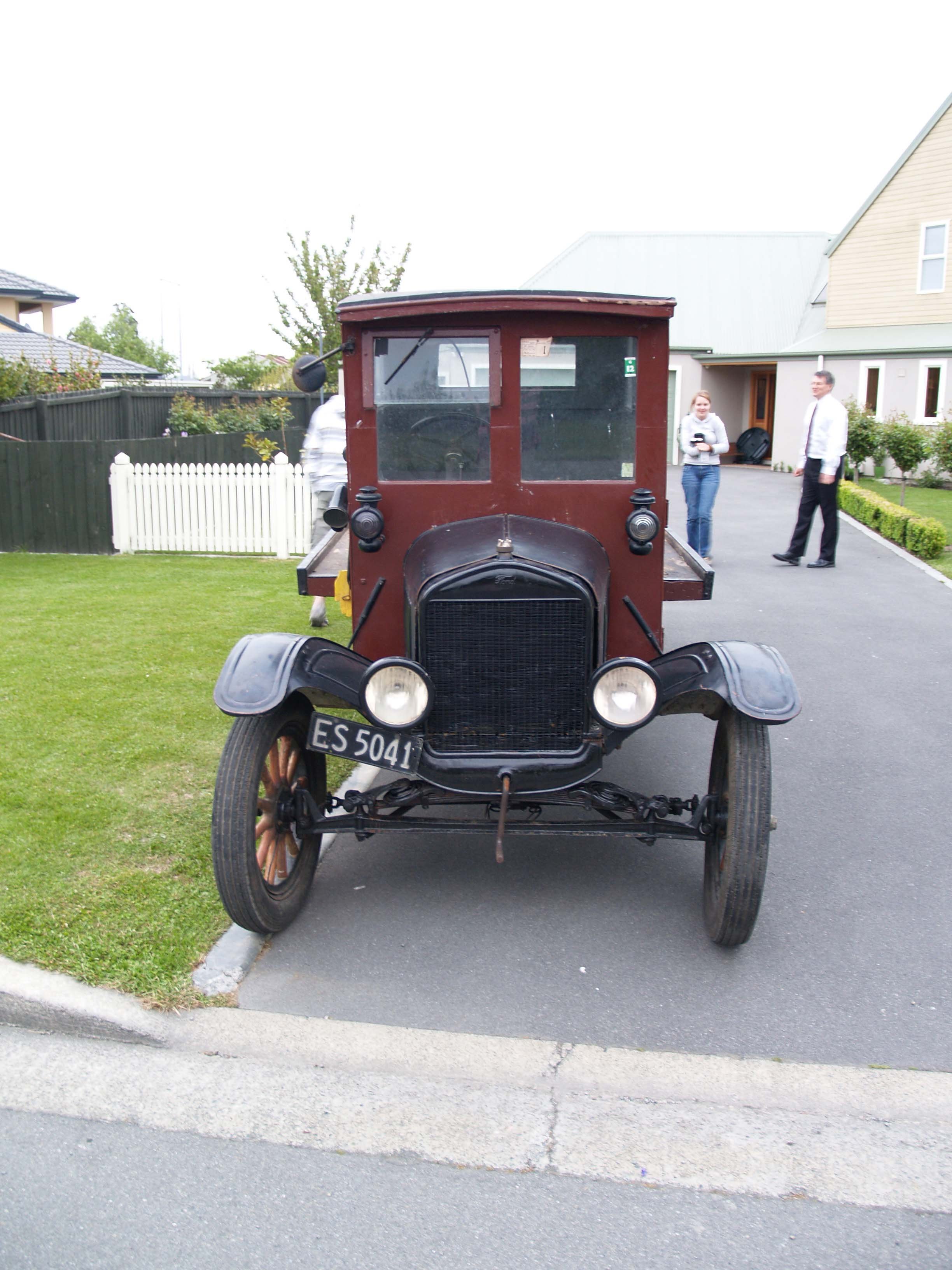

TT Truck:
These are a 'flat' pancake style. As the bushes were worn, I took them off. Now rebuilt with new springs I have not yet reinstalled them. Anecdotal reports from club local members about excessive bouncing put me off, but I may try one day.

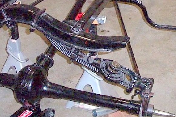

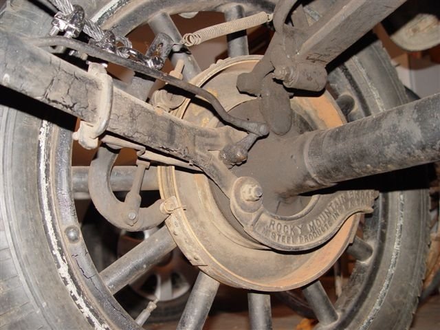

This is the rear Pancake bracket. The rear hub is not in place, but you can see the bracket, it fits to the rear backing plate where the std. perch mount fits. But, this bracket also 'over hangs' the rear drum, pretty tight tolerance, but it fits ok... .except when you put on the new RM external brakes. There is enough clearance for the drum, but the repro RM brakes have that spring bracket at the top, that can interfere with the pancake bracket. [/i] other info
Hassler Pancakes with Rocky Moutains http://www.mtfca.com/discus/messages/80 ... 1260070485 Re: will pancake hasslers bolt to the rear of a big drum ruxtel

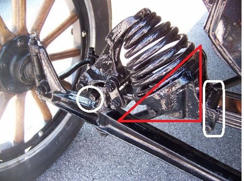

Hassler shocks are designed to slide on the leaf springs (red triangle) and have stops (white outlines). The stop on the leaf spring is the spring clamp and causes the Hassler spring to be engaged to stiffen to leaf springs downward motion and prevent them from bottoming out. The boss on the lever arm causes the Hassler spring to be engaged on the rebound of the leaf spring. The design suggests a dampening effect. The question then is under what conditions would the Hassler spring become engaged in either direction. Today's roads are much different than those of old. The only ruts are railroad tracks, furrows and roads in the spring thaw.
Perhaps the reason for using them is to demonstrate the technology of the day and perhaps experience a smother ride
"A shock absorber or damper is a mechanical or hydraulic device designed to absorb and damp shock impulses...
In common with carriages and railway locomotives, most early motor vehicles used leaf springs. One of the features of these springs was that the friction between the leaves offered a degree of damping, and in a 1912 review of vehicle suspension, the lack of this characteristic in helical springs was the reason it was "impossible" to use them as main springs. However the amount of damping provided by leaf spring friction was limited and variable according to the conditions of the springs, and whether wet or dry. It also operated in both directions... One of the problems with motor cars was the large variation in sprung weight between lightly loaded and fully loaded, especially for the rear springs. When heavily loaded the springs could bottom out, and apart from fitting rubber 'bump stops', there were attempts to use heavy main springs with auxiliary springs to smooth the ride when lightly loaded, which were often called 'shock absorbers'. Realizing that the spring and vehicle combination bounced with a characteristic frequency, these auxiliary springs were designed with a different period, but were not a solution to the problem that the spring rebound after striking a bump could throw you out of your seat. What was called for was damping that operated on the rebound."

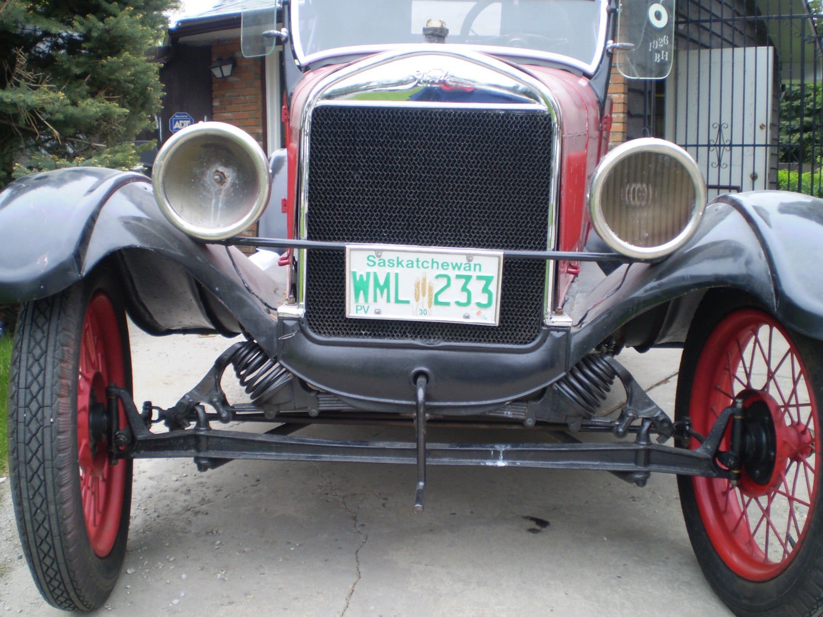

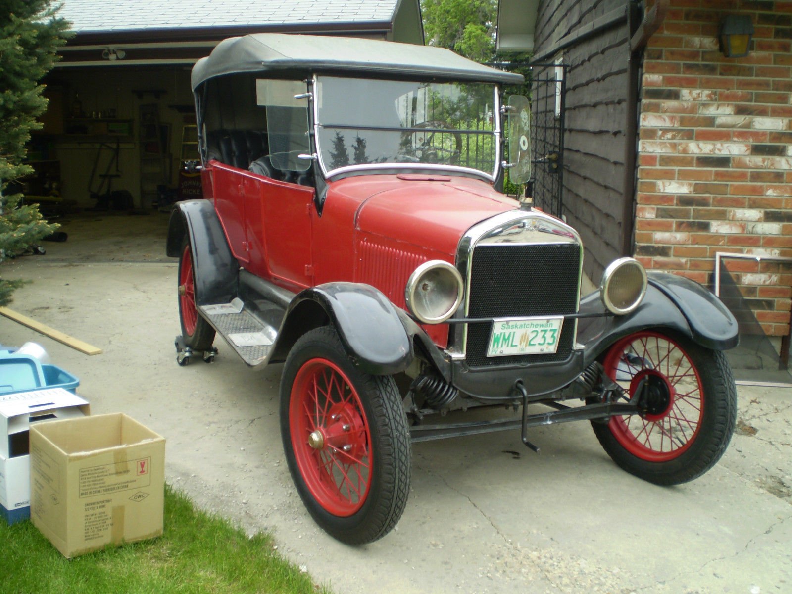

The Hassler rebound check was a sort of snubber like Gabriel snubber and the "shock absorbers" that were option on 1926-1927. Rebound check is a perfect name, because that's exactly what it does. Here's the patent: https://patents.google.com/patent/US1646583A/en

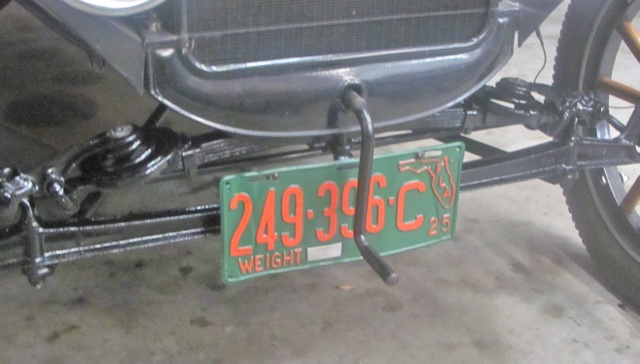

My 1923 roadster came with single Hasslers front and back, and it sails over railroad tracks like they're not there. You do have to be careful with extra deep intersection gutters however. It's also worth nothing that Hassler beehive springs were originally sold in different "strengths" depending on application. The sales literature said that the springs were color coded, but with a century of painting, sandblasting, and repainting...
I also vaguely remember hearing that Hasslers change the front axle geometry, and when installing or removing a set, the axle needs to be turned 180 degrees (or the spring perches swapped) to change the camber. Perhaps better mechanics than I could chime in?

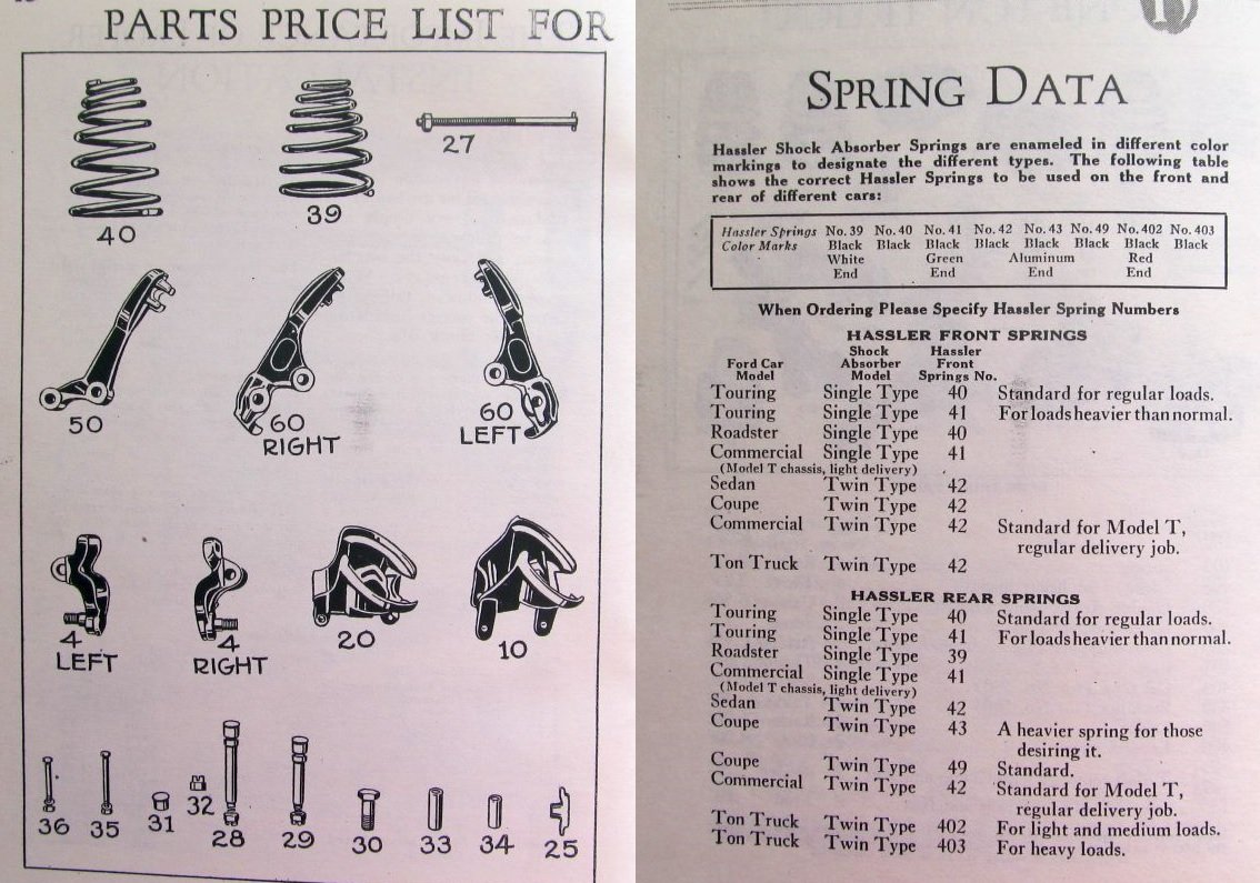

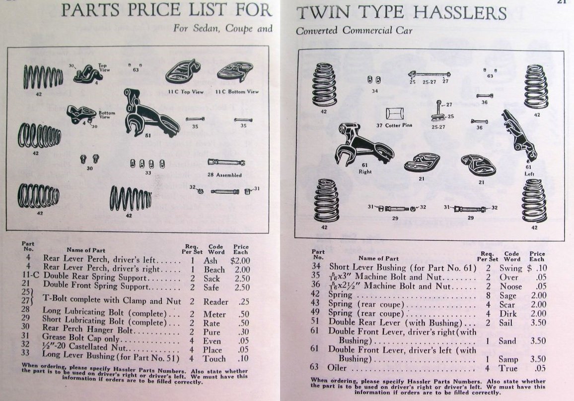

As Buddy mentioned when Hassler shocks are installed, the perches need to be swapped side to side. This was the reason I removed the ones on my car. Because they were installed wrong, they needed repair. I still want to reinstall them some day because they are part of the cars history.
- Posts: 4045
Re: Survey on Hassler shocks
Chris

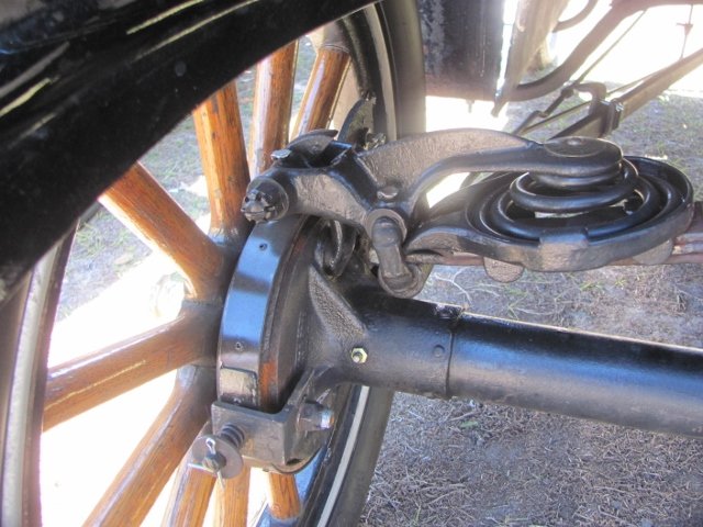

You are correct on install of the original Hassler shocks, those ‘Beehive’ types have coils in various strength for the different Ford body styles, plus they do need the spring perches to be removed and relocated, moving the left perch to the right, and right to left, transposing them to keep axle tilt.

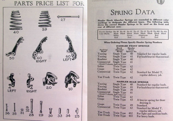

However the New Hassler, 1924 ‘Pancake’ style uses the same flattened coil spring for all body types, and they use new front brackets that don’t need the perches to be removed or transposed, but only each spun in its position to turn the shackle hole outboard. So they mount easy.
"Beehive" Hassler
1924 New "Pancake" Hassler
Click on image to enlarge for reading:
"Beehive" Hassler

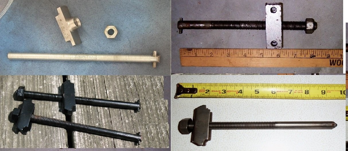

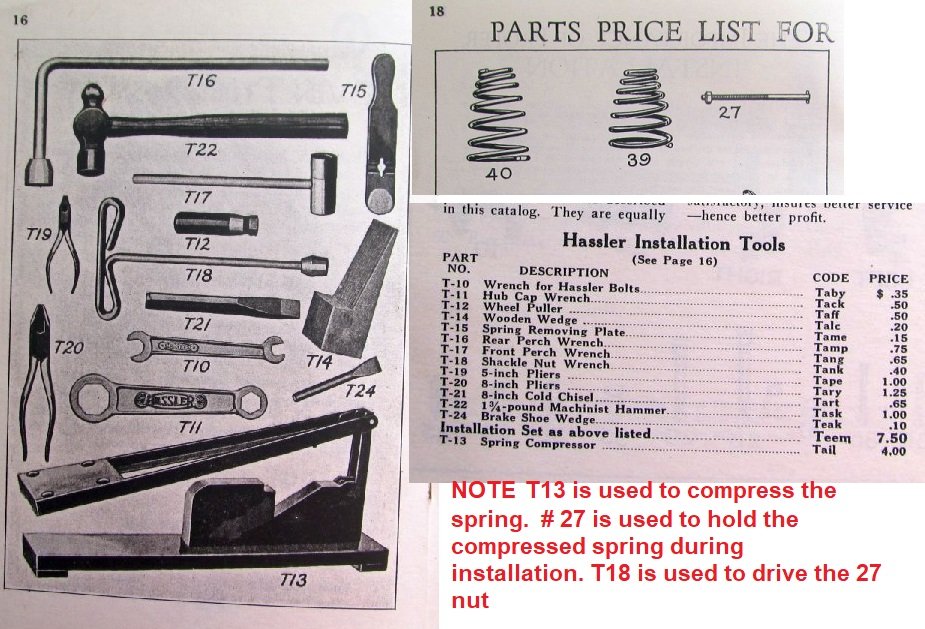

I didn't see this problem, but it is a safety issue. Fortunately neither my friend nor I were injured, but I will describe what happened: We bought a set of the currently manufactured Rock Mountain Brakes. We installed them on a 17 touring. The car had hasslers on it but the brakes wouldn't fit with those hasslers in place, so we removed the hasslers from the rear axle. In doing so, one of them sprung across the garage with great force. We were in a different direction, but if someone had been on the other side, could have had a serious injury.
- Posts: 5472
Were you utilizing the correct spring compressor tool to remove the springs ?

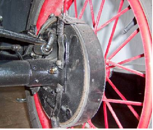

other info

- Posts: 6542

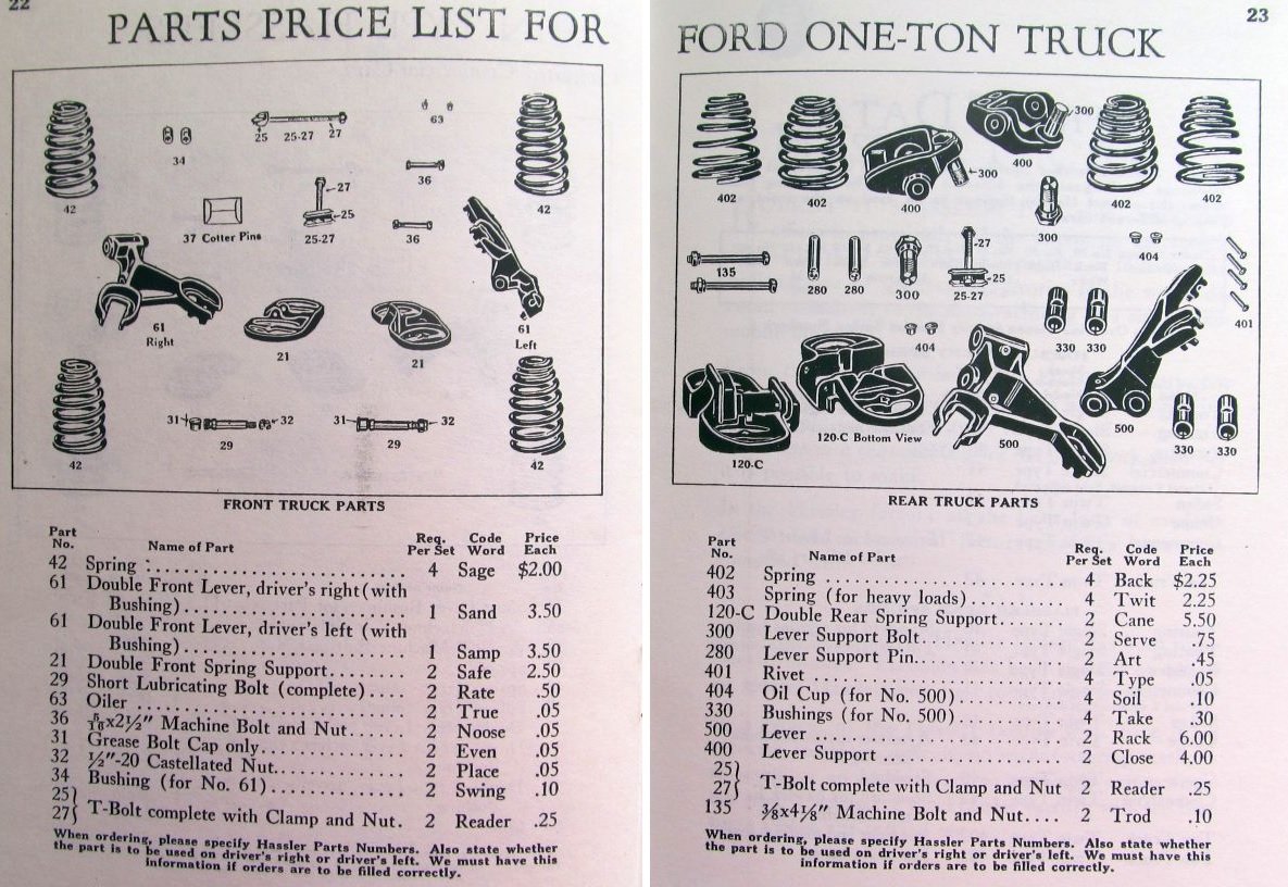

Hassler Beehive springs made for different T's. No idea if they assumed just vehicle weight or added in some passenger weight to determine the proper spring rate or did some trial-n-error method. In any case if someone wants to do the math here's the formula explained, https://www.engineersedge.com/calculato ... _14934.htm
These are the springs - doubtful if any color codes survived - also we weigh more then they did
- Posts: 5503
Frank;
Does that flyer show the parts for the Dodge Hasslers, and if so could you copy and email them to me?
Thanks for posting the scans of the pages. In the past when I put together a set, I just matched all the springs. Didn't know they came in different sizes. Part No 27 in the first cut is the compression tool for installing.
- Posts: 6542
It appears that the catalog is for Ford cars only and there is no reference to Model Year. Here is the link to the an old forum discussion (Jay in California) & displays the entire 103 catalog http://www.mtfca.com/discus/messages/41 ... 1394937519Mark Gregush wrote: ↑Sat Dec 05, 2020 3:24 pmFrank;
I Goole'd the internet and couldn't find any reference to Hassler/Dodge
Just read the Hassler installation instructions and noticed that reference to the T bolt. Turns out that they used a spring compressor, T13, to compress the spring while on the ground and then used #27 the T bolt to hold it compressed during installation. T18 was used to drive the nut on #27
I believe the picture in the catalog is missing the bride that would span the top of the spring These are advertised as compression tools

Frank thanks for checking and posting the link. I was given T-11 the hub cap tool.
