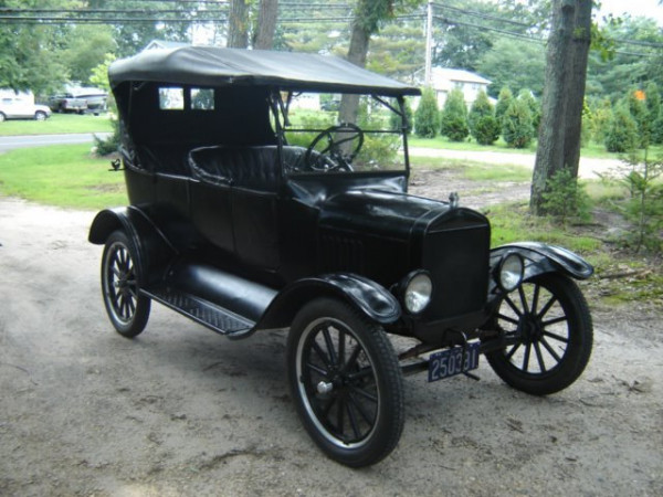

You might be able to find a "basket case" for under $1,000 but will need to do a lot of work on it to get a running car out of it.
26 touring as purchased.jpg (61.04 KiB) Viewed 16128 times
pile of rusty parts.jpg (41.21 KiB) Viewed 16128 times
Ten years later and many additional thousands of dollars, finally finished

Yeah but the before and after pictures for a true basket-case disaster to nice drivable are priceless! -- IV

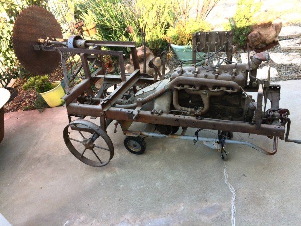

1st Step Find A Engine
Some time back, I did this step of finding a engine. A year ago I saw a ad for a Model T engine. The engine was for sale for over a year. I had been in the process of moving, so I avoided the temptation. I called the seller and asked about the price. He said he had people contact from out of the area, but he wanted to talk in person. I asked for a price and he wanted a offer. I told him that without knowing the condition of the engine I couldn't offer more than $100
I went to see the engine. It ended up being a 1915 engine on a buzz saw...
1915 buzz saw.jpeg (83.61 KiB) Viewed 15613 times
Here is a link (viewtopic.php?f=2&t=6381&p=109563#p48044) with more of the story. Now people don't have to lose sleep about using the engine for the buzz saw:)
Okay, I will edit the first post with the engine/price. That leaves me with $900.
Update:
$100 Engine purchased (8/31/20)
$900 left to spend
Matt

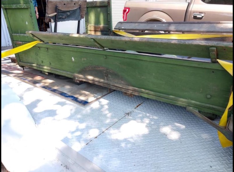

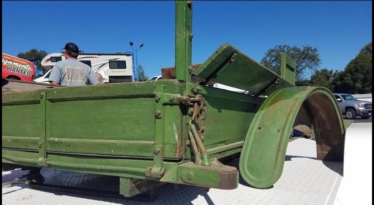

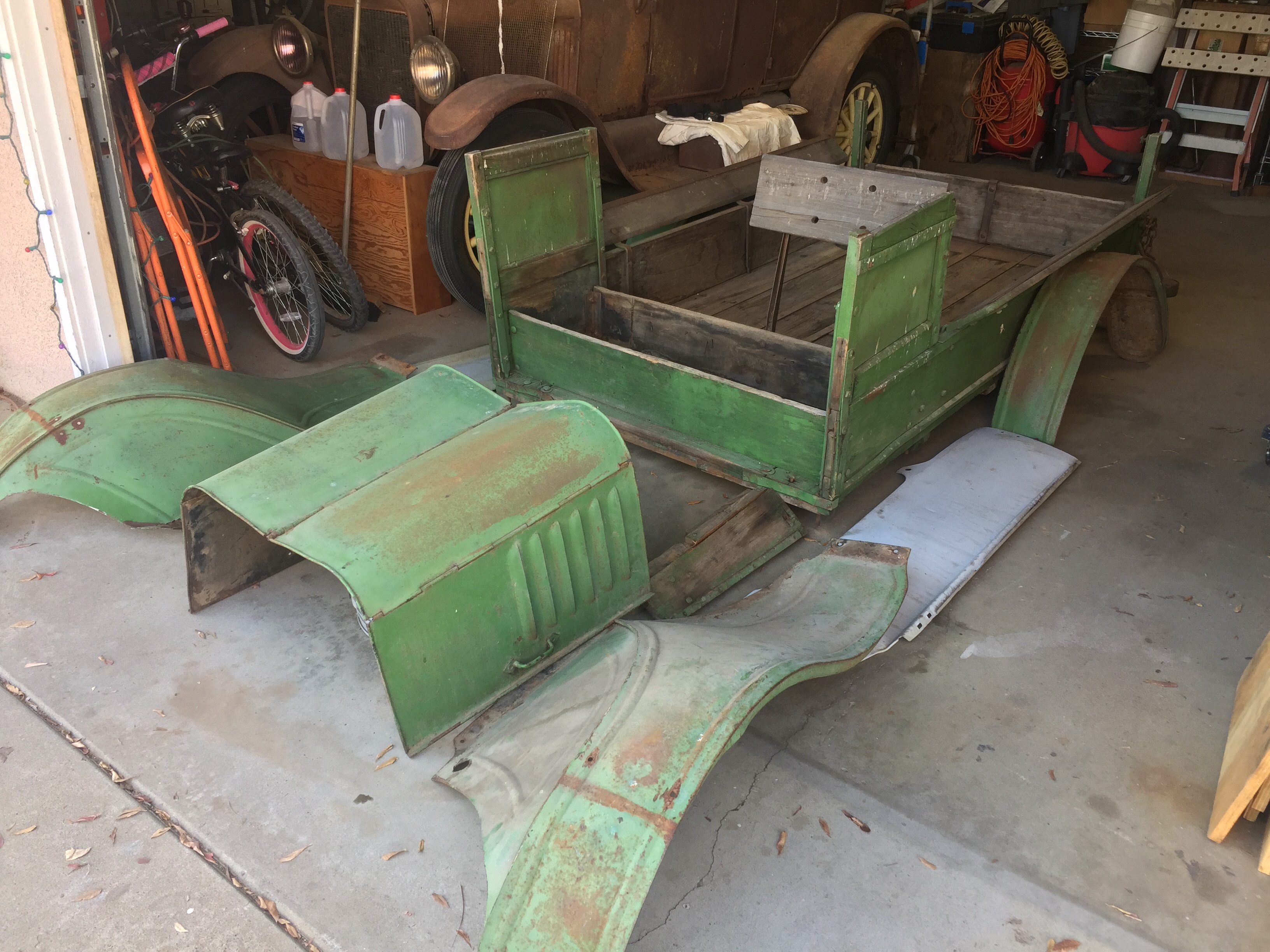

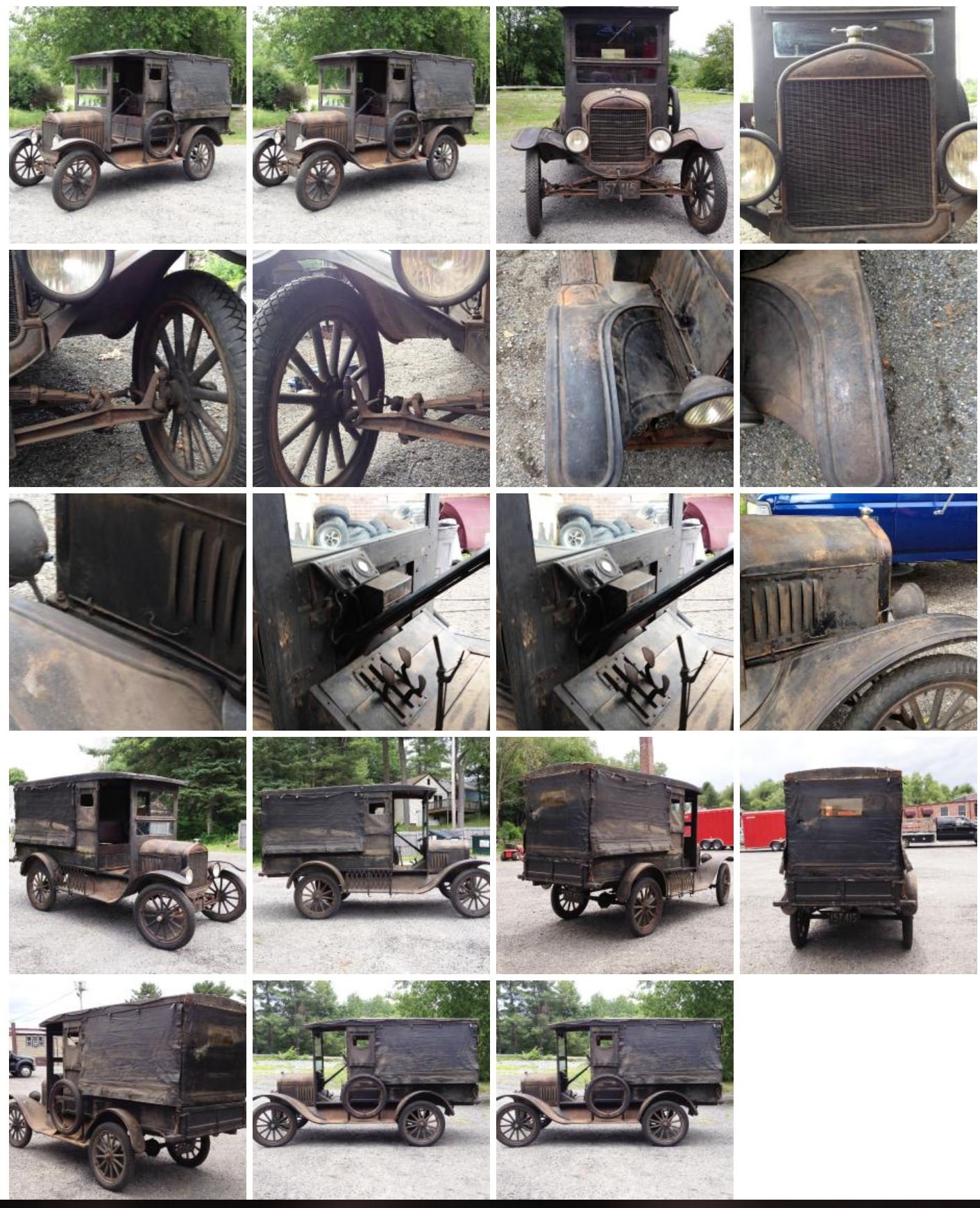

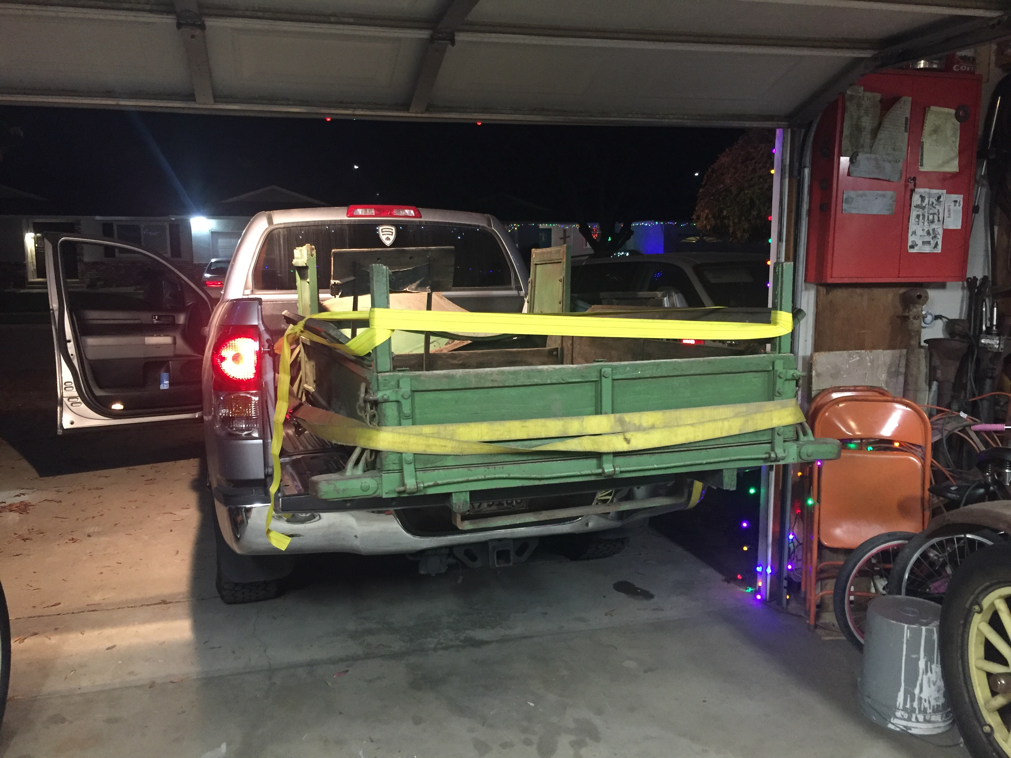

Post by Matt in California » Thu Dec 17, 2020 5:38 pm

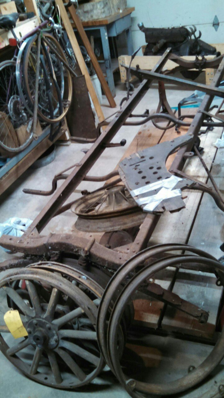

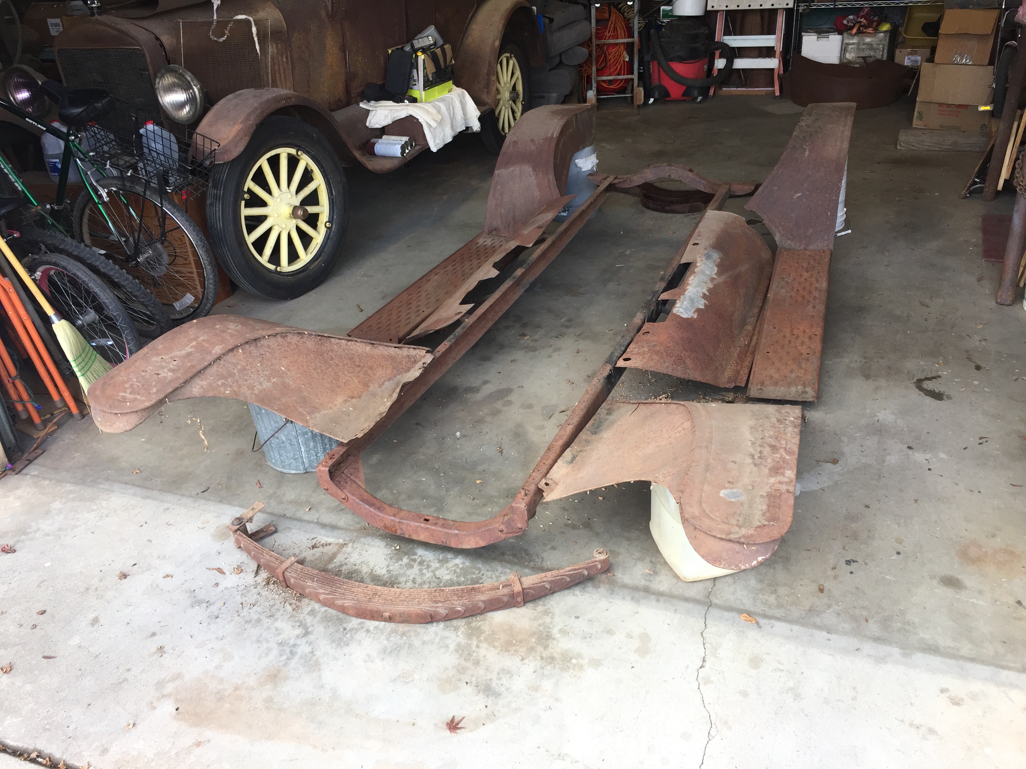

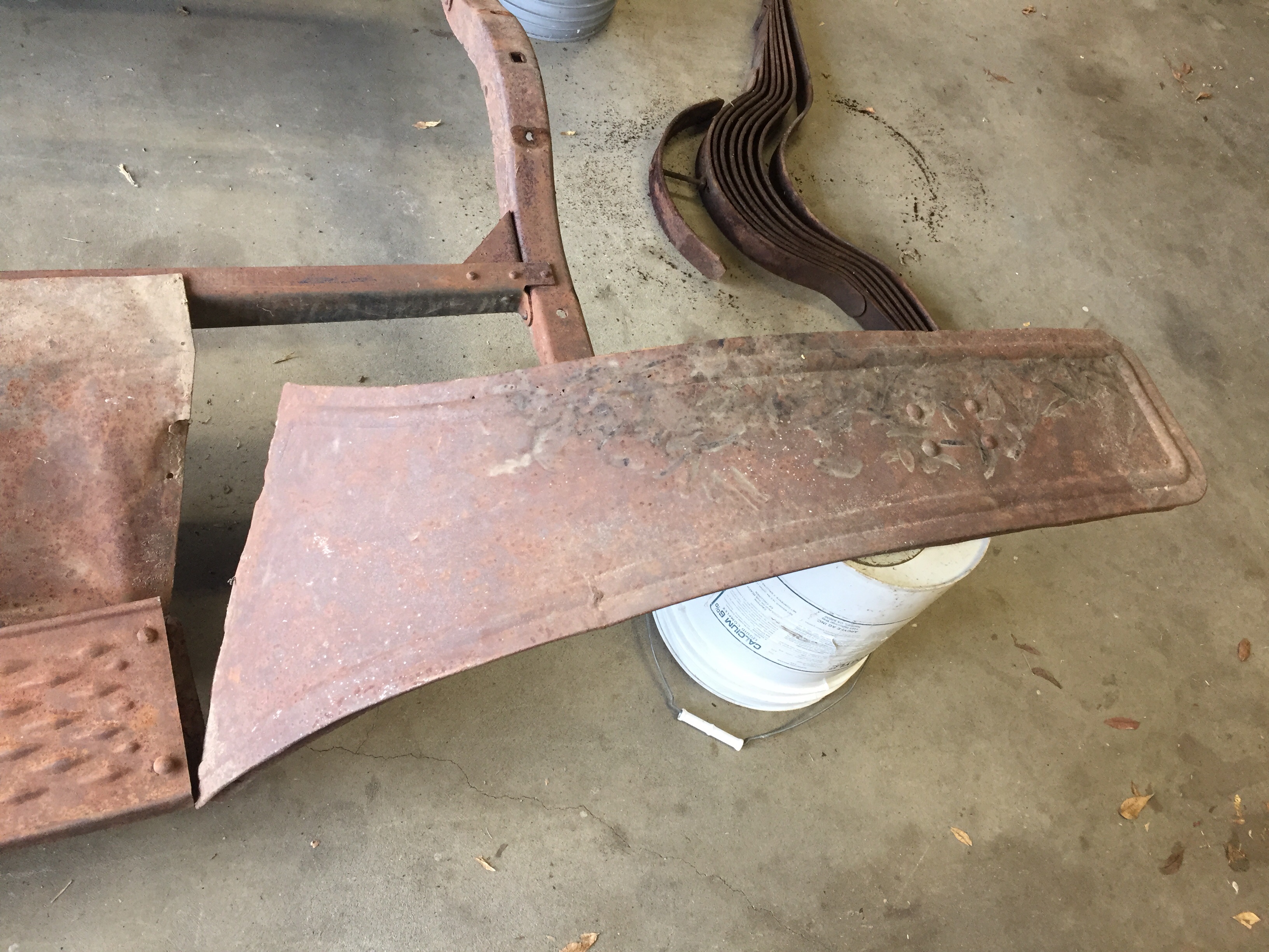

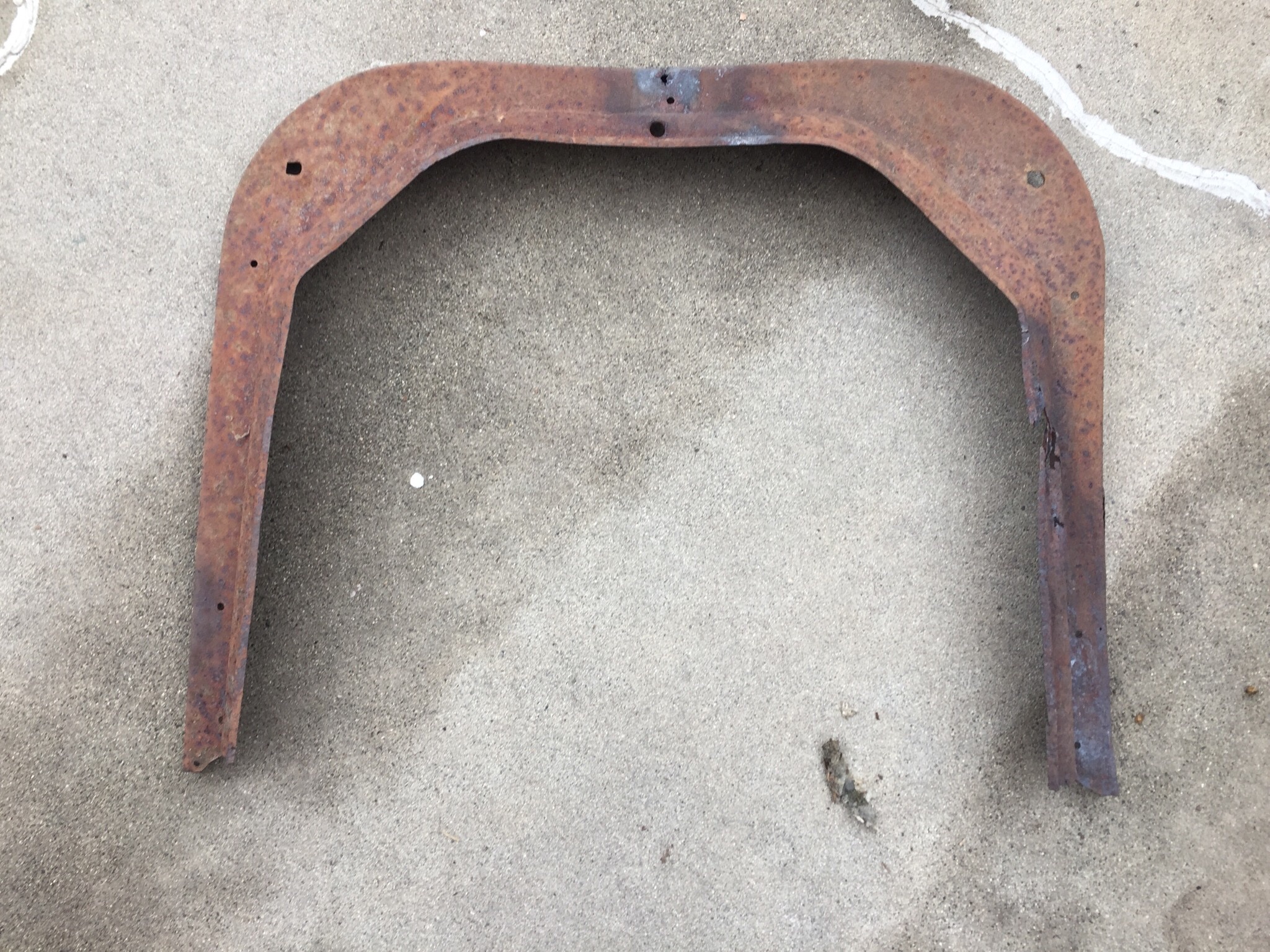

Well I moved forward (I hope that is actually the true direction) and purchased this:
I spent $200 on the lot. I post more details later.
I look forward to hearing comments and feedback.
Matt

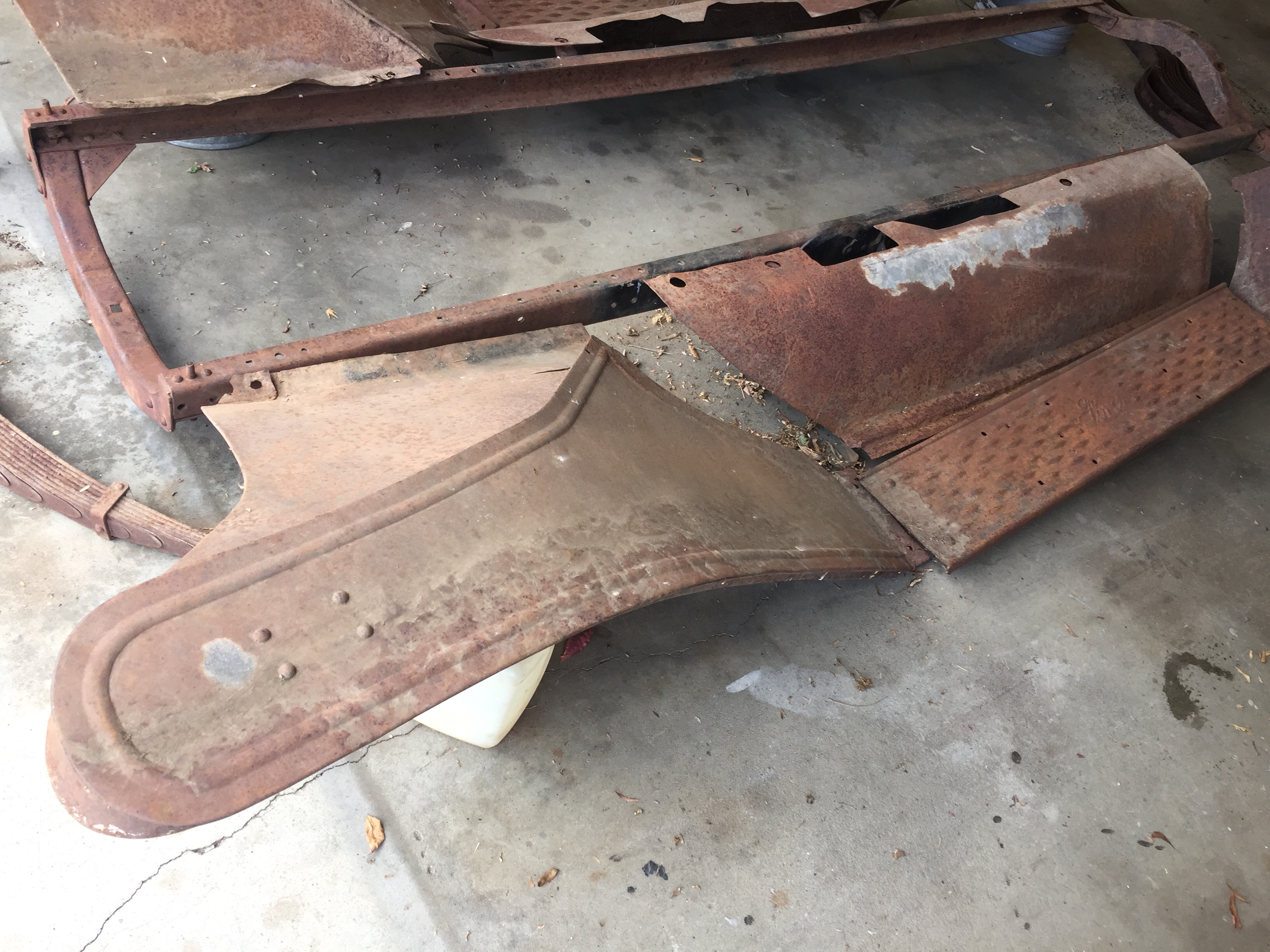

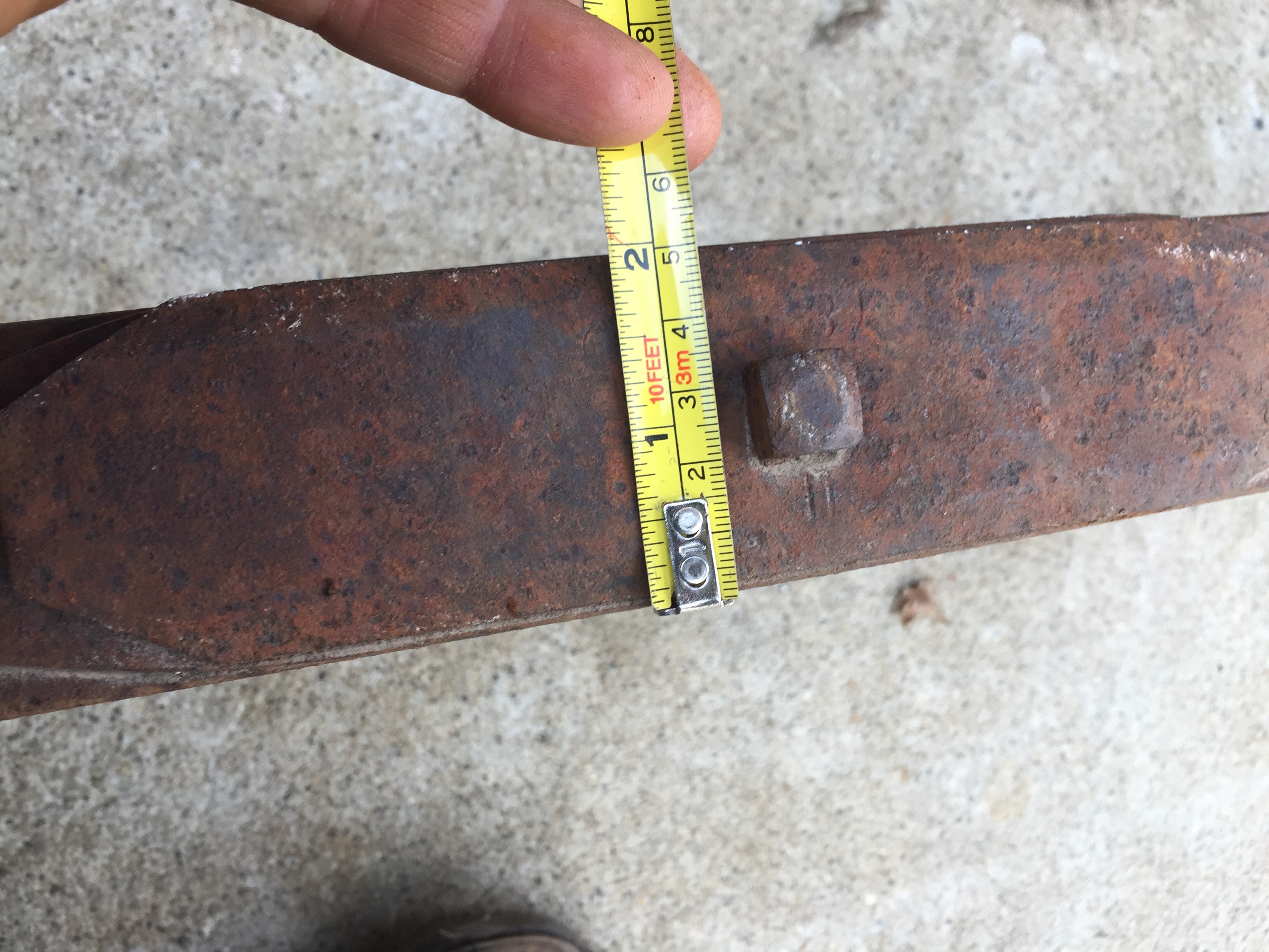

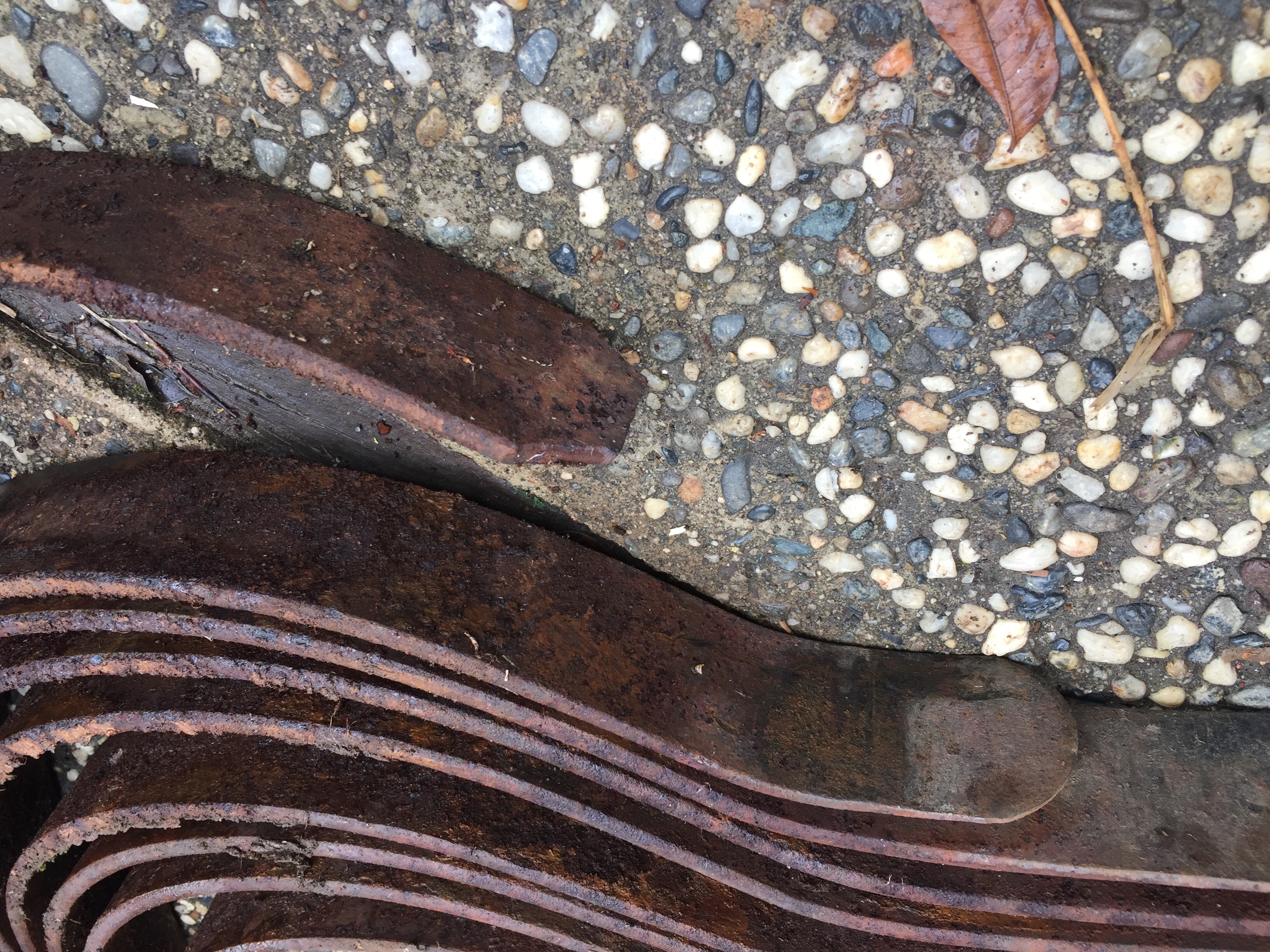

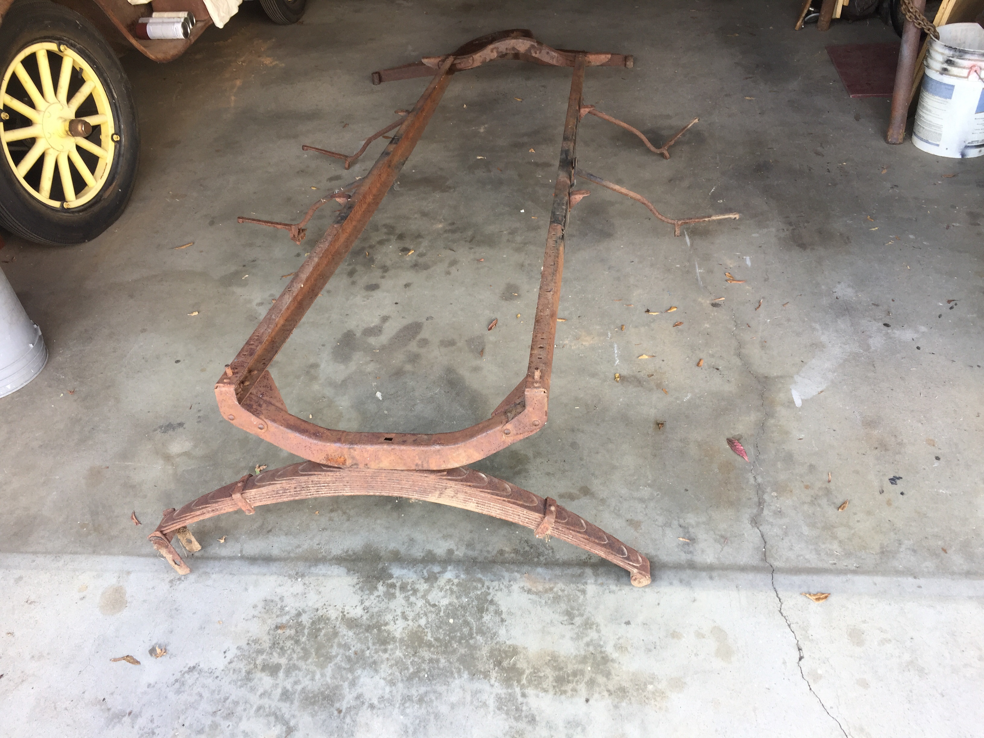

Post by Matt in California » Thu Dec 17, 2020 5:44 pm

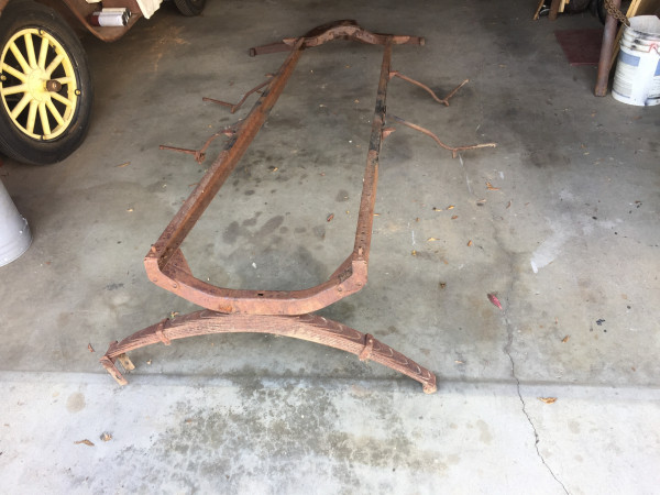

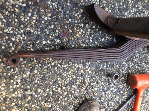

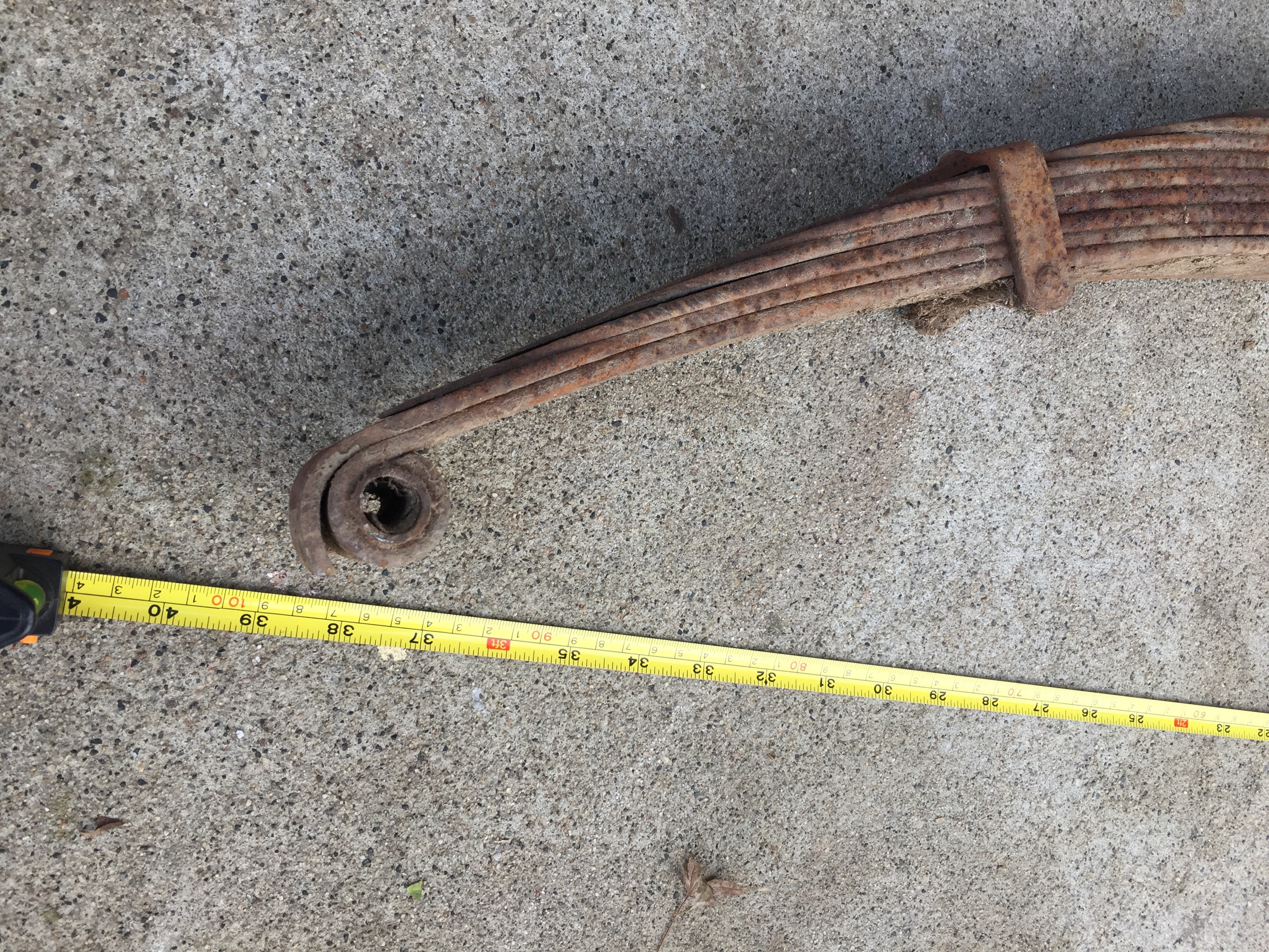

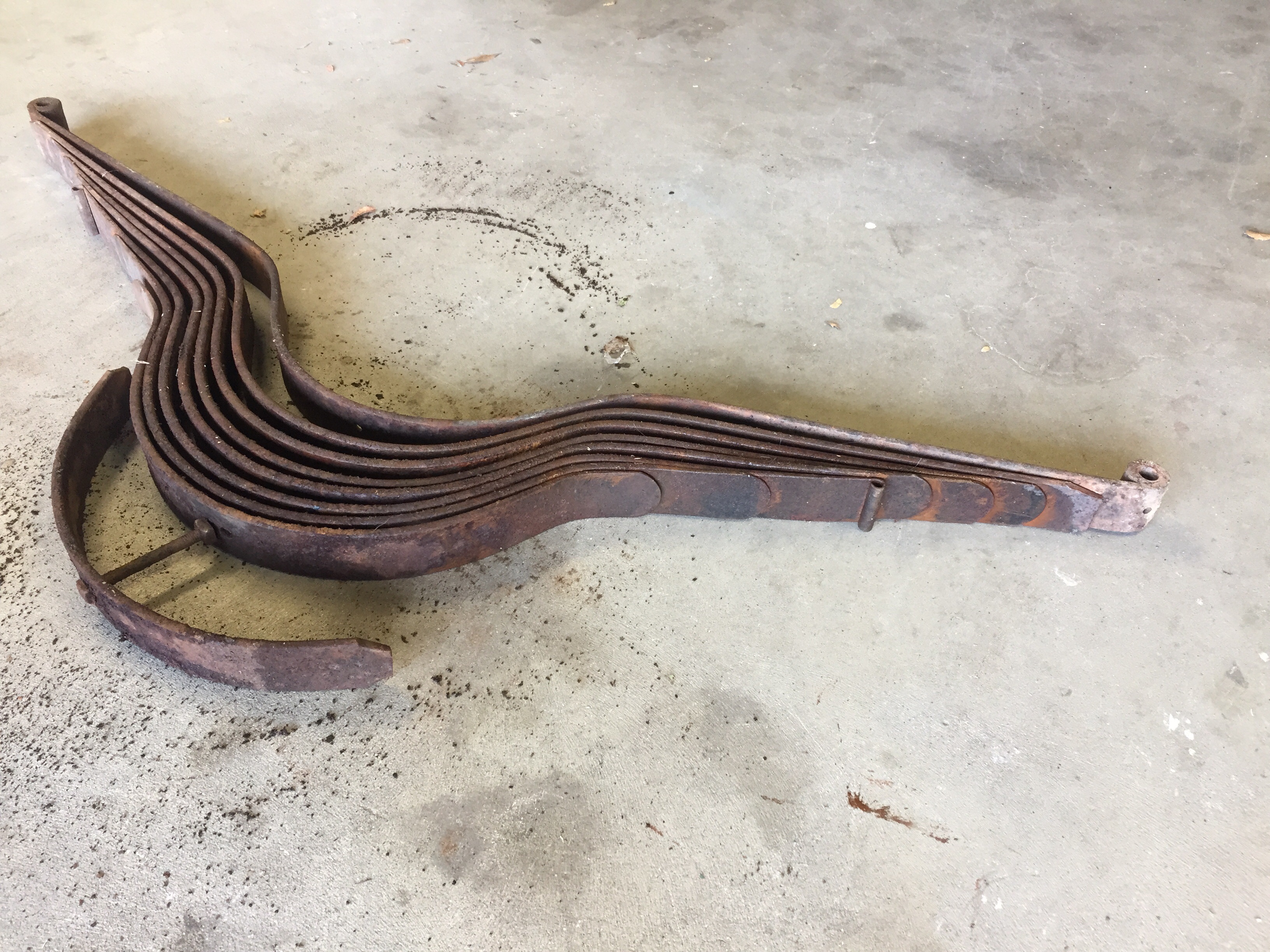

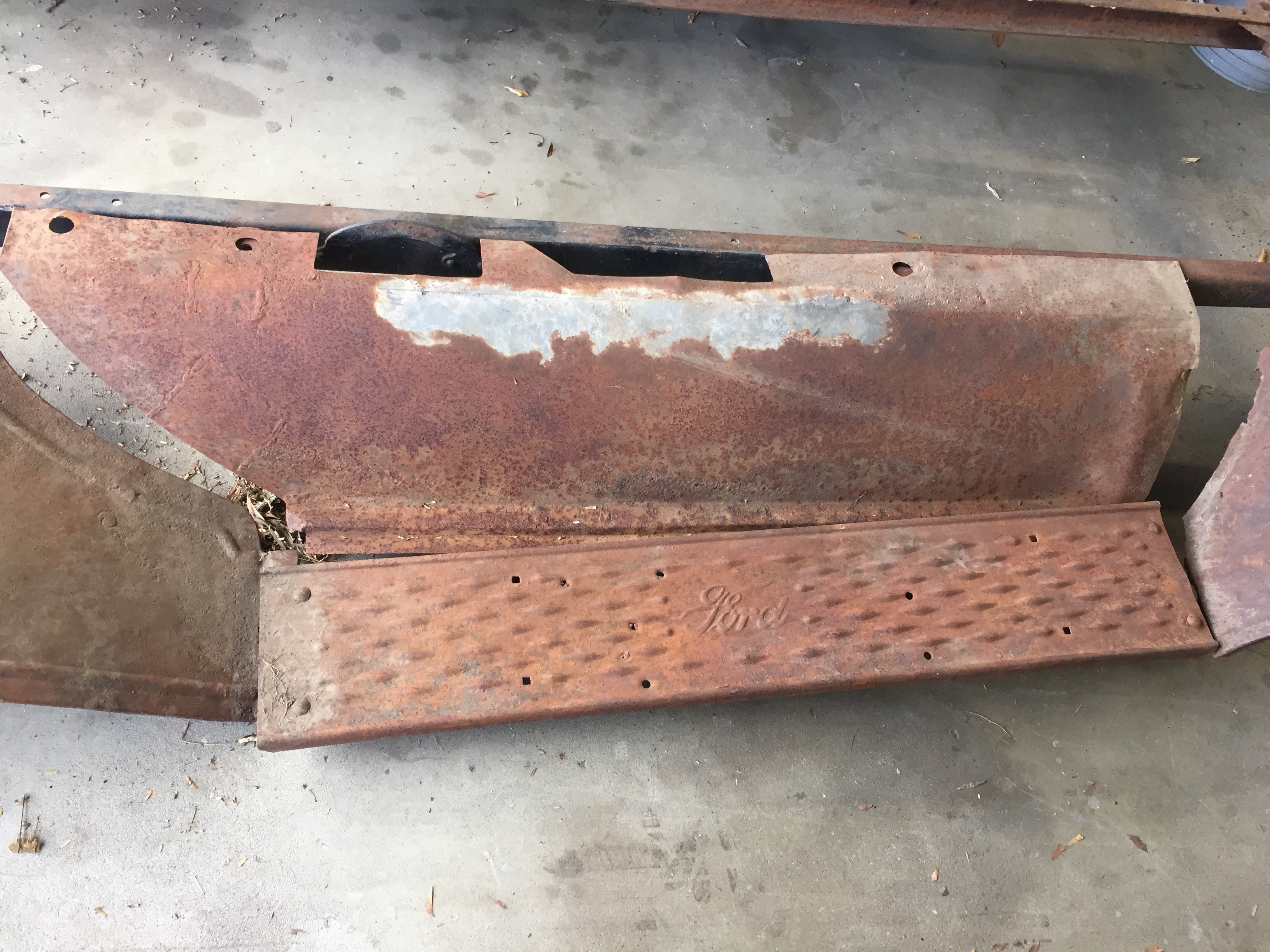

I took apart the rear spring:
Front spring is too large (2 inches).
This is my first T that is not 1926-27. I see that I have load to learn.
Matt
Posts: 6607
Re: Personal Challenge (Contest): How cheap can I purchase/make a Model T for?
Post by TRDxB2 » Thu Dec 17, 2020 9:07 pm
What "model" did you purchase and what "model" you are planning to assemble? Keeping and account of every nickle & dime is the real challenge. ;)
Matt in California
Posts: 829
Joined: Sun Jan 06, 2019 5:42 pm
First Name: Matt
Last Name: G
Location: California
Post by Matt in California » Fri Dec 18, 2020 2:16 am
Frank,

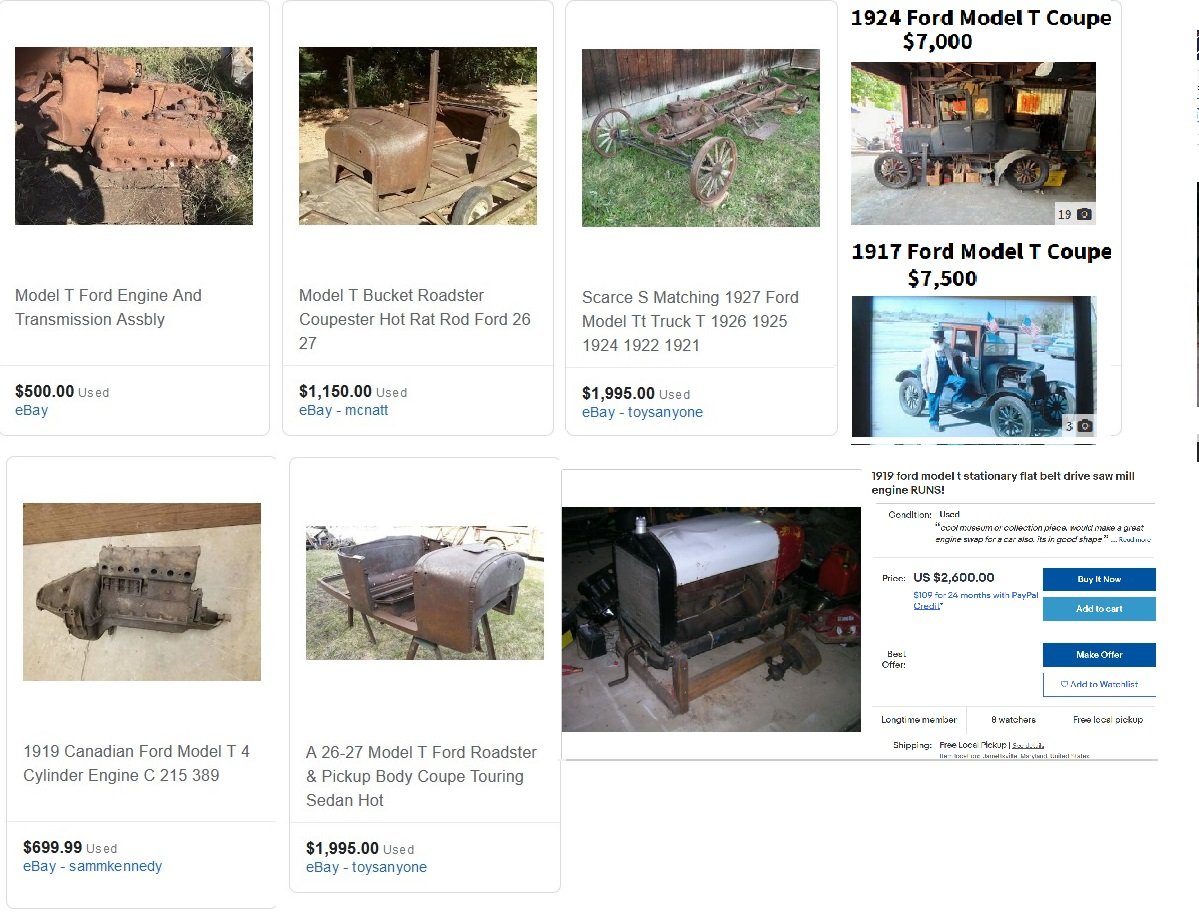

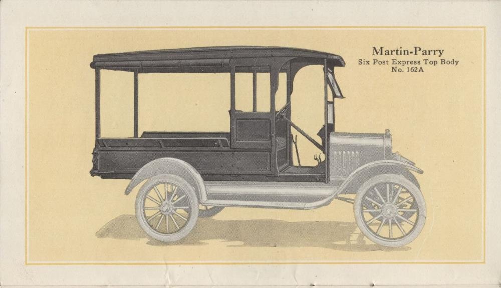

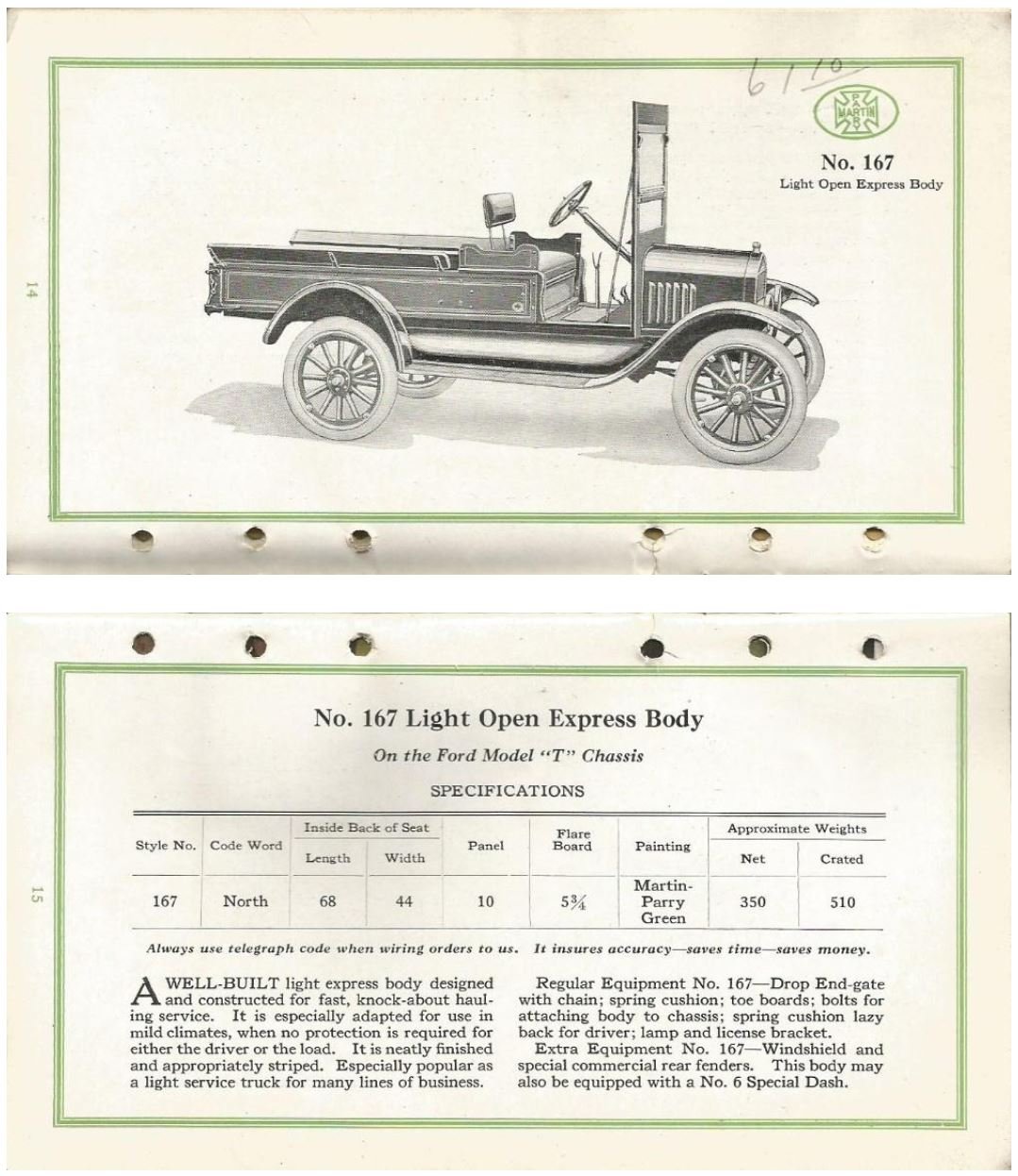

To answer your question: a model T of course :lol: Actually, tried to take a poll to hear what others thought I should build. I didn't get much response, so I was left to my vices! To more directly answer your question- After purchasing the Martin Parry body I had the choice of making something match the approximate year (mid 1920s) of when it came out. In this case it would be like the owner purchased a bare chassis from the dealer. Or the other option would be to assume the Martin Parry was put on a "used" car. I never owned a brass era car, so I decided I wanted to move in that direction. That said, I am having second thoughts with this purchase considering that I spent $200 of my last $300.
Here is the story. I saw these parts online. They had be listed for two years. I got ahold of the seller and went back and forth regarding setting up the time. Finally on Wednesday I got a message that I could come. After work I was able to go, arriving after 4:30 pm. Being this time of the year it was getting dark. The parts were pushed back bushes between a old car in the backyard. I pulled them out. I also found that the seller was the mom of the guy who owned the parts. Evidently her son had cancer and she was helping him out. About this time I decided that I wouldn't asked for a reduced price. It would have felt bad not leaving some money by this point.
It took me about 30 minutes to find all the parts that were listed two years prior. I couldn't see things real well. But today I found some surprises. First that every piece of sheet metal had major issues or repairs. One rear fender was actually multiple fenders of different years patched together to match the other fender of 1914 era. Another surprise is that the front fenders, running board and splash guard are 1911 era. I was thinking the parts were newer brass era. I believe the frame is the 1917-19 era. I am not exactly sure on the rear tapered springs.

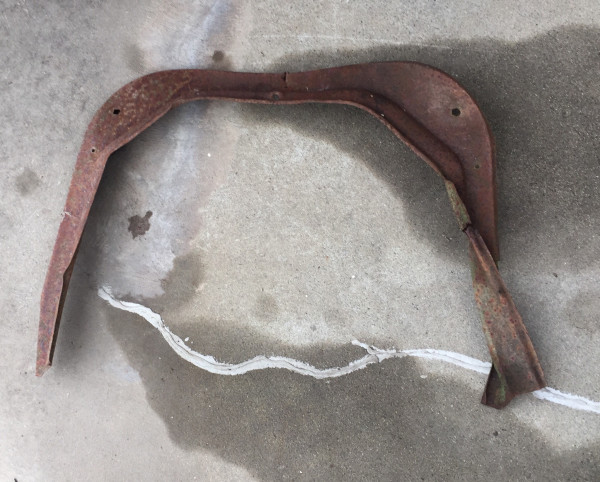

After some reflection, I am considering using the the Martin Parry rear fenders along with the 1911 front fenders, running boards and splash guards.
Matt

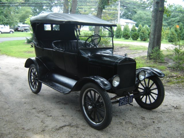

Posts: 6607
Post by TRDxB2 » Sat Dec 19, 2020 4:37 pm

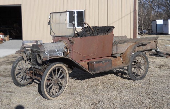

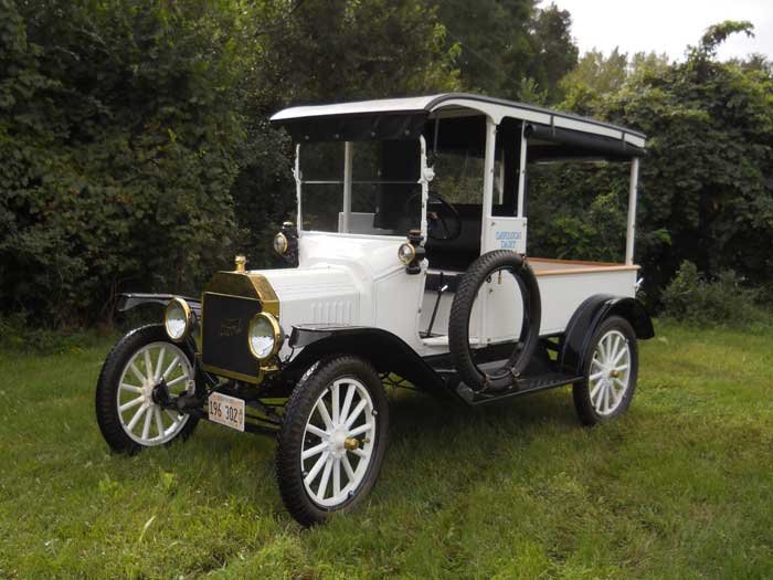

We do have a newbie to follow - Jonah D'Avella - the questions he asks are really good ones and the type of issues a person would encounter. I really agree that a decent running T without major issues is a far better beginner's car than I bucket of parts or some abandoned project. He's 14 and here is his first posting t o the forum "I recently bought a 1926 Ford Model T Touring and I am looking for a club near me. I live in north-eastern Tennessee and am looking for a club in Kingsport, Jonesborough, Jonson city, or Bristol." Added a picture of his car - not quite complete but a good beginning since most of it is put together.
J's car.jpg (80.67 KiB) Viewed 14243 times

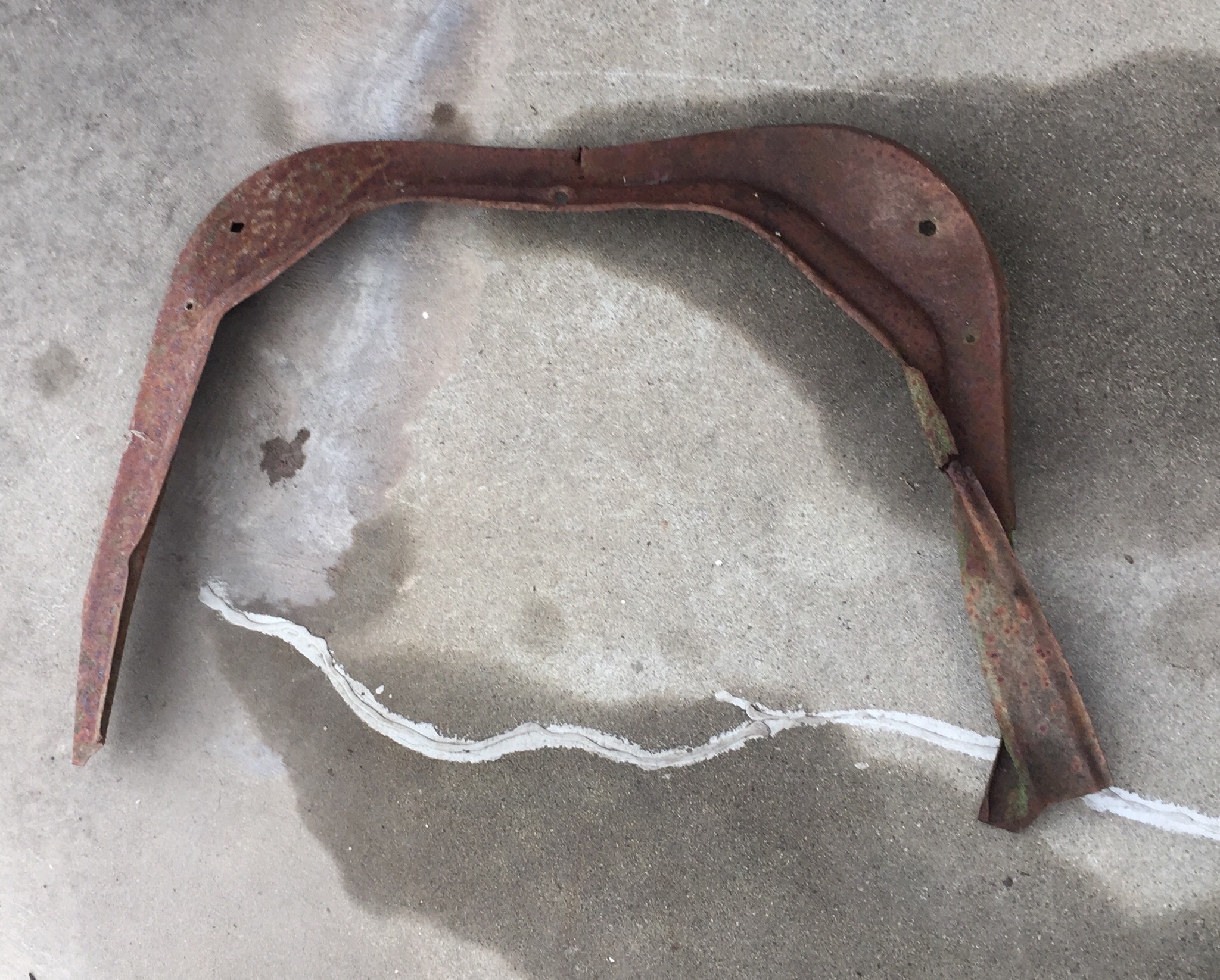

Post by Matt in California » Wed Dec 23, 2020 12:25 am

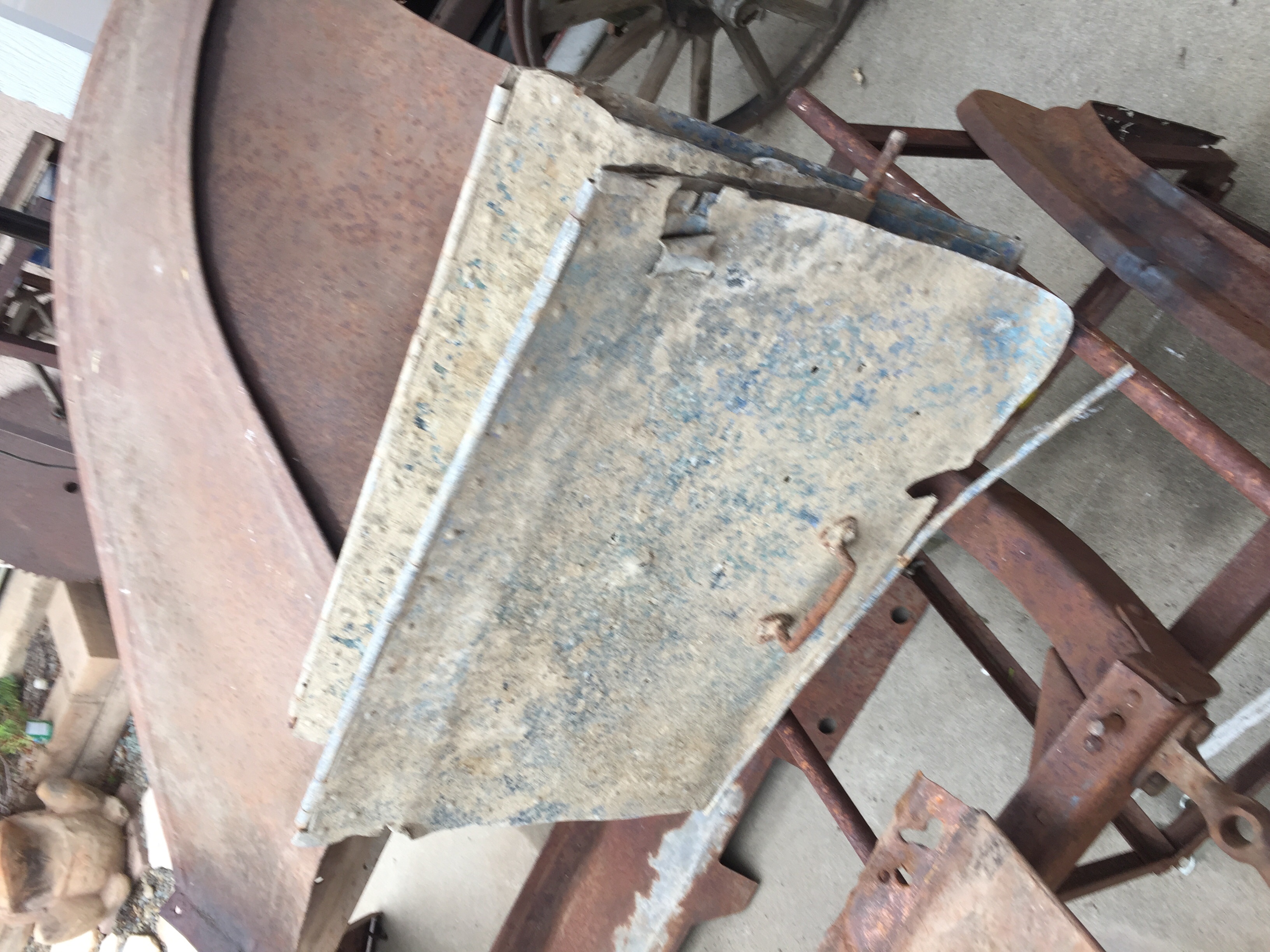

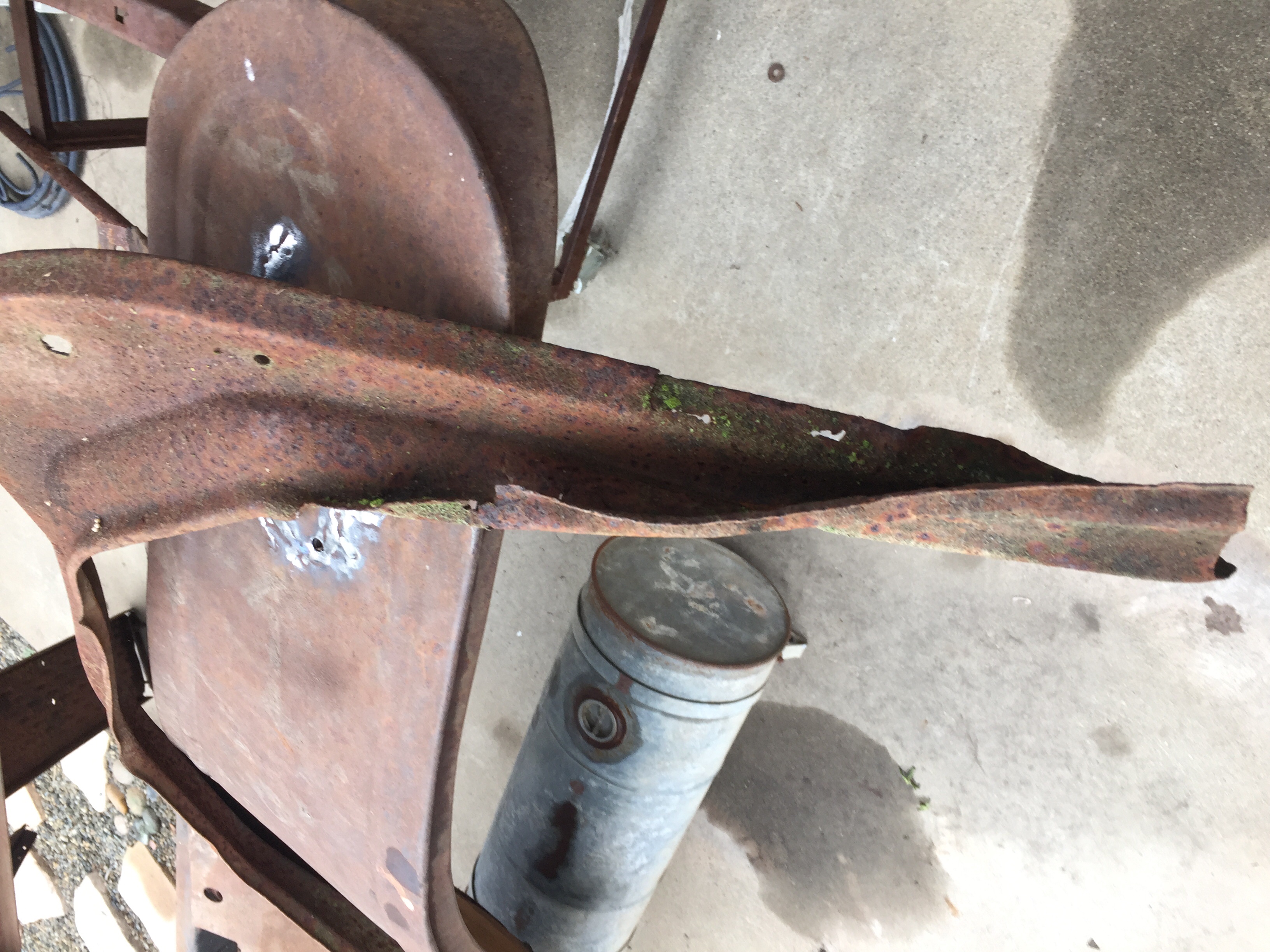

I did some work on the hood former that I got from a friend.
It looks much better now.
Anyone ever open up an rusty aluminum hood?
The only thing that I can think of is removing the rivets.
Matt
jab35
Posts: 1039
Last Name: Bartsch
Location: Dryden, NY 13053
Post by jab35 » Wed Dec 23, 2020 11:27 am
I'd try Evaporust. Make a shallow wood trough that just fits the hinge side of the hood, line with heavy plastic sheet (construction grade trash bag material) and soak the two hinges. If successful, open sides and repeat with center hinge. Others may have better ideas, jb
I agree with trying something like Household Cleaning Vinegar first 50/50 water solution (cheaper than Evaporust). Need a mild acid to remove the oxidation . Once loose I would remove the hinge rods rather than trying to open the sides or center rod.

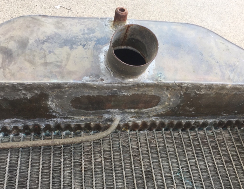

Post by Matt in California » Sat Jun 19, 2021 3:02 pm
I hope to progress with this project this summer. I did get the 1915 engine running. I also got this radiator with my final $100:
It has had a lot of work done to it! I will need to find a inlet!
