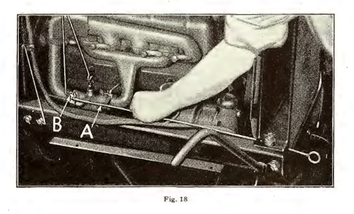

Photo from Ford Service, outer edge of pan shown after removal of hood shelf bolts, free end under frame rail.

I don't find any text about the engine pans specifically, but Figure 18 shows the pan hanging under the frame rail after the nuts and lock washers have been removed. While the configuration of the pans changed over the years, believe they were always attached under the frame rails. I found nothing about them in the encyclopedia, but maybe somebody who's a better searcher can find a reference.

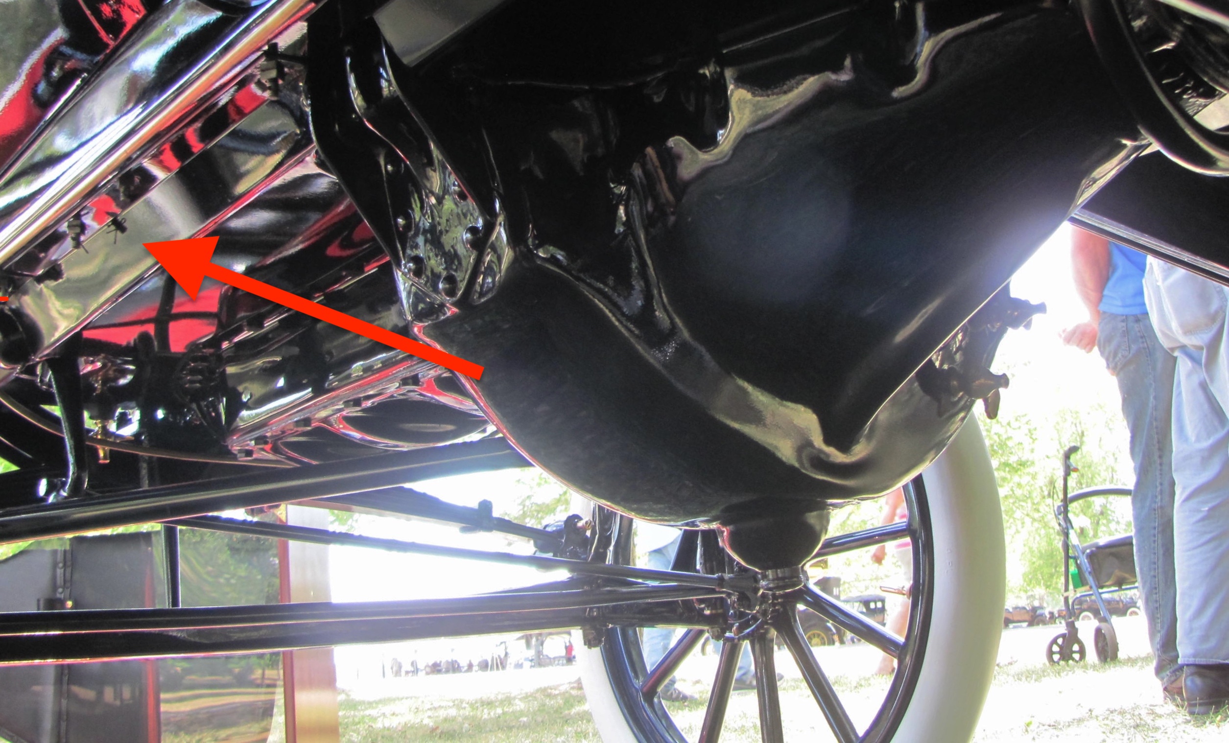

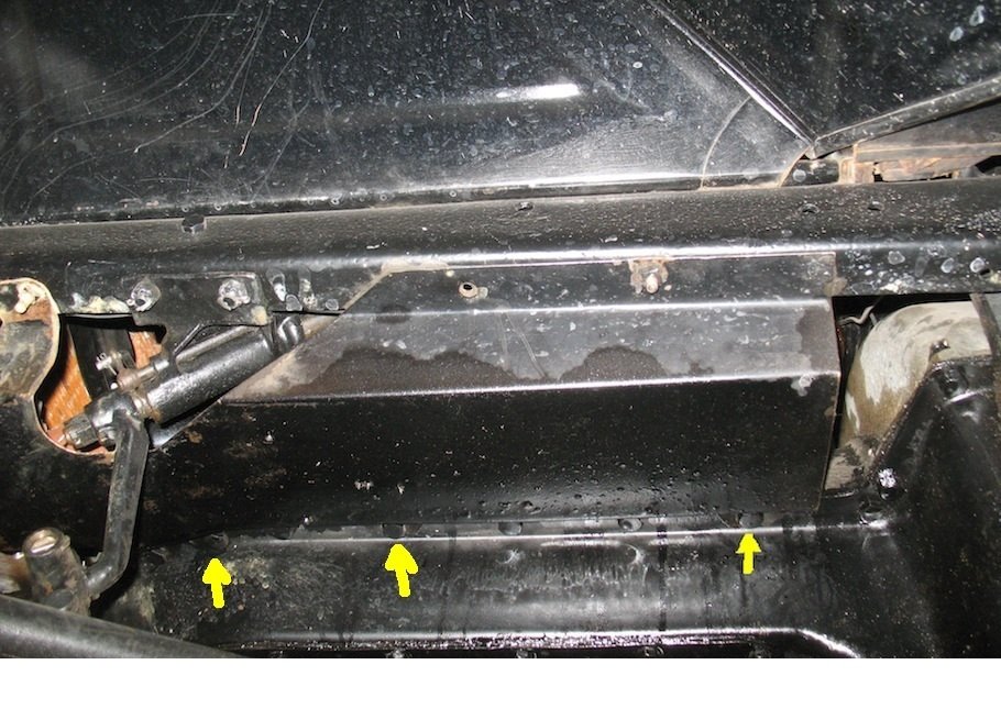

Re: Engine Pans
Look at this link - has very good pictures of the mounting points towards the bottom of the discussion
http://www.mtfca.com/discus/messages/50 ... 1447712968
example of one picture there

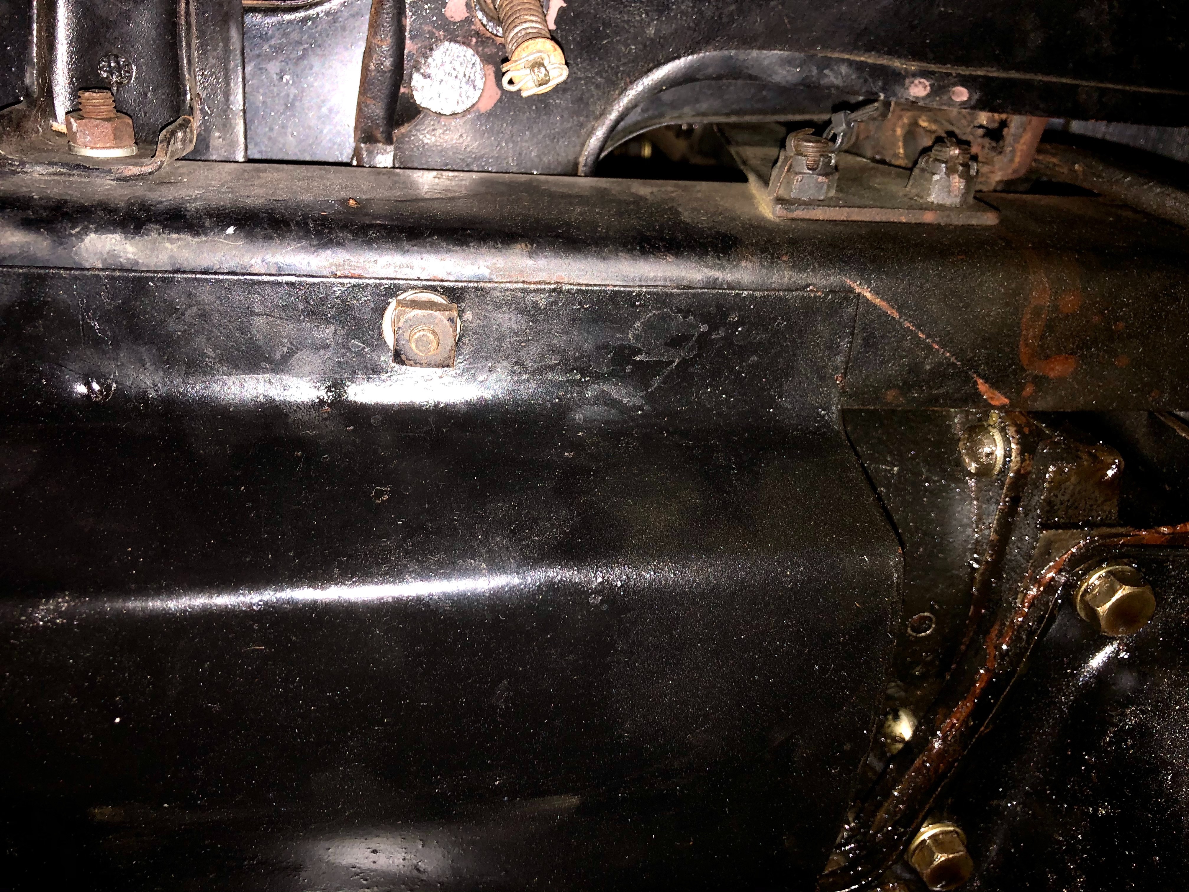

And Allan, yes me too, I try to save all the original T nuts and bolts, here is original square nut on 1925 engine pan bolt, the lock washer is modern, the original broke, and the original are thin, and fit snug to the bolt shaft and are smaller in diameter than the modern.
