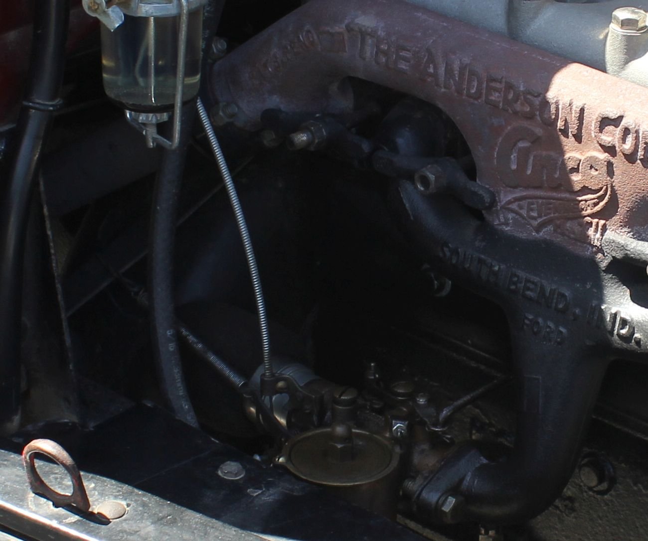

I finally got around to installing the Stromberg OF I bought from Bruce Compton at Hershey two years ago. It had been an older restoration by Stan and when he saw a picture of it, offered to update the plugs to how he does them now. So, it’s been around the block.
I did the preliminary adjustments over again since I wasn’t sure if they had been moved from handling. Used a small brass tube with a pipe fitting and silver soldered a 1/4” brass barbed end for gas line tubing to connect it to the steel gas line. Works fine. Steppd on the starter button and in four revolutions it came to life and actually idled very nicely right away. It was warmer here today and I was wondering what I would do if I needed to choke. It does have an arm to the choke wire that comes from the radiator. But what about when sitting in the car. It’s clear that the stock pull knob won’t work the way it’s configured. And then there is that interesting fitting on the back of the OF that allows adjustment of the butterfly through a cable to the steering column, but this appears to be for regulating a rich mixture for driving rather than a momentary choke when starting. What are others out there doing for choke?
So, I did a little fiddling with the idle and high speed adjustments but need to spend some quality time with it on a better day. Also need to do some better fitting of the throttle rod as it’s binding at the highest speed settings. We are expecting 70 mph winds soon and I just wanted to go a couple of times around the neighborhood. Feels pretty good and I see a smoothness in acceleration. Nothing yet on the high end that seems better than the straight through NH I just removed.

Ohh .. ok, so you are connecting it to the arm meant for a cable. This isn’t made for choking ... but for an adjustment for making a lean mixture for driving. So I guess that adjustment isn’t so important then. Yes, I have the original rod for that bell crank to the old carburetor. Thanks.

Yes, both ends of the “y” arm on the carburetor are for the choke plate. Top arm for rod out to the radiator and bottom arm for wire to lever near steering wheel for choking while in the driver’s seat.Mark Osterman wrote: ↑Sun Feb 24, 2019 8:04 pmOhh .. ok, so you are connecting it to the arm meant for a cable. This isn’t made for choking ... but for an adjustment for making a lean mixture for driving. So I guess that adjustment isn’t so important then. Yes, I have the original rod for that bell crank to the old carburetor. Thanks.

Mark : Do like Michael says and use the lower lever on the choke control. It's almost the same as the arm on an NH but the Stromberg has no return spring built into the mechanism. If everything is totally free, the choke will usually open by gravity, but I attach a light spring to pull it open. The choke arm has nothing to do with adjusting the mixture for driving (like the mixture control on all the original T carbs). Once the two adjustable jets are set, no more adjustments are required except for maybe idle speed occasionally. Cheers : Bruce

I added a return spring to mine also and used the original choke rod.
The Stromberg likes a little choke till it runs for 20-30 seconds. I also put a piece of vacuum line around the choke rod where it goes through the firewall to hold it in place.

This is my set up. I used a choke cable with a knob that looks like the original choke control. Also used a spring. Works good.
