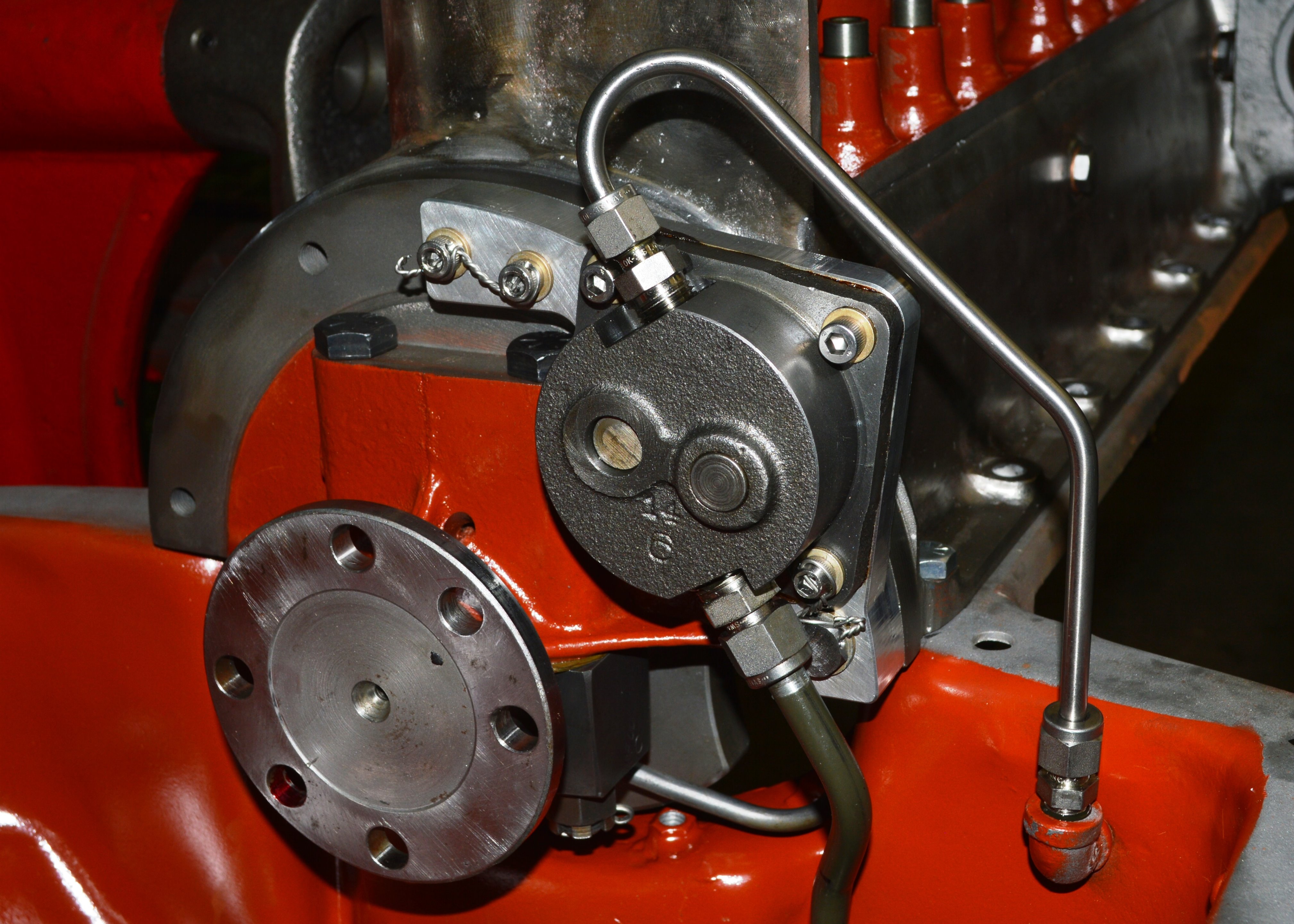

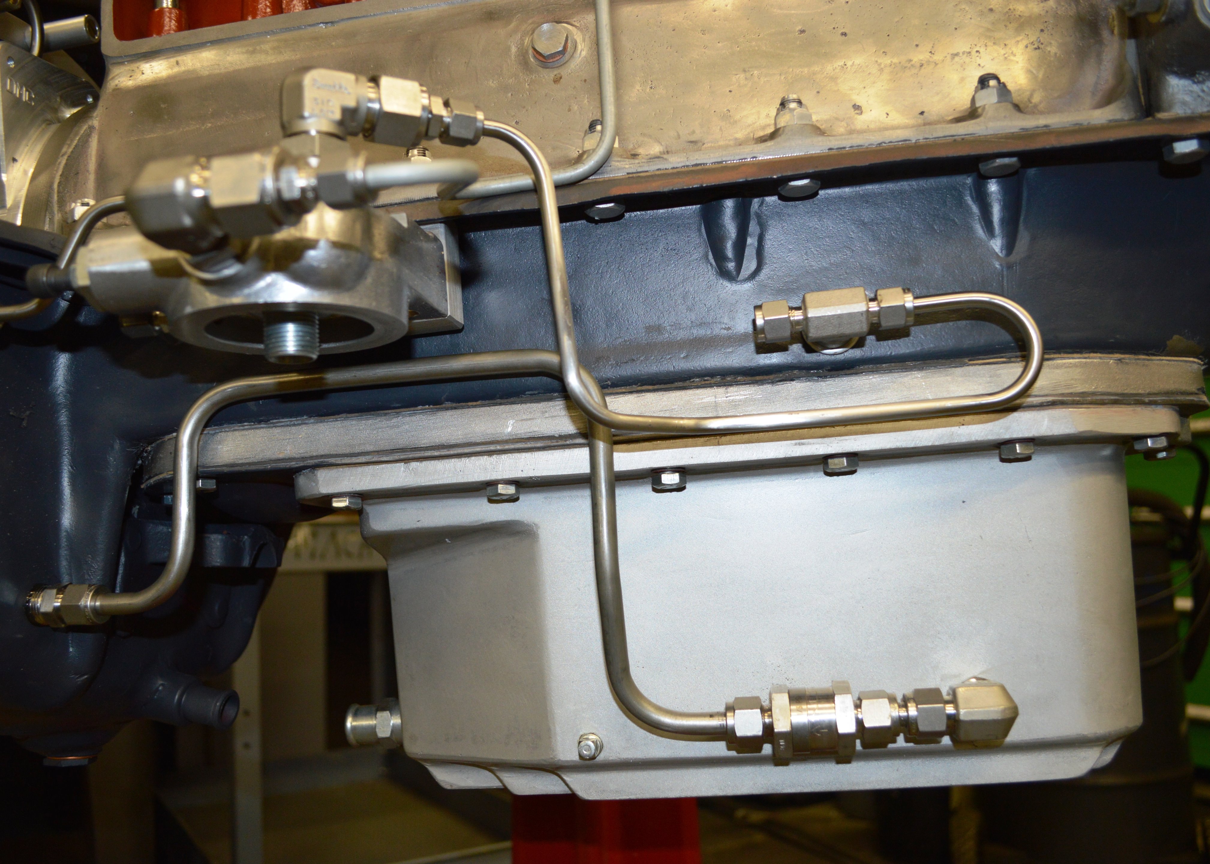

Rich- I have VW pumps/mounting brackets in stock, as well as the oil sump shown in the pictures below. You asked about an oil relief valve for the pump. The filter bracket shown in the picture with the sump has a built in adjustable relief valve. I have these available as well. I caution you regarding using a manual valve to control oil pressure as its not a real good long term solution. The oil pickup in the picture shown is in the oil sump with a removeable circular inlet screen. There is a baffle in the sump to control oil surge.
Send me a PM if you are interested. There are a few tricks to making a VW pump reliable when mounted as shown. Glad to answer any questions.
