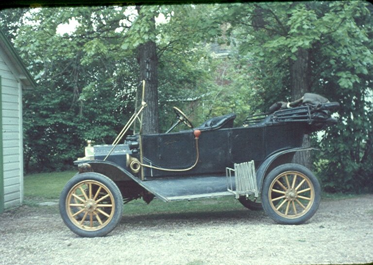

Hello,
I have a 1913 Ford Model T Touring. The engine serial # is C 11408. I've had a couple of different opinions regarding where the car and /or engine were manufactured and assembled. Can any of the experts out there shed some light on this or direct me to a reference? Thanks very much for your assistance.

Hardie,
Thanks very much. My 13 is a 3 door (no drivers door). Were all Canadian 13's 4 doors? Wonder if I opened up a can of worms! I'm contemplating selling the car and would like to say for certainty (if I can) if it's truly a Canadian or US built model. Do you think it would affect value based on country built in?

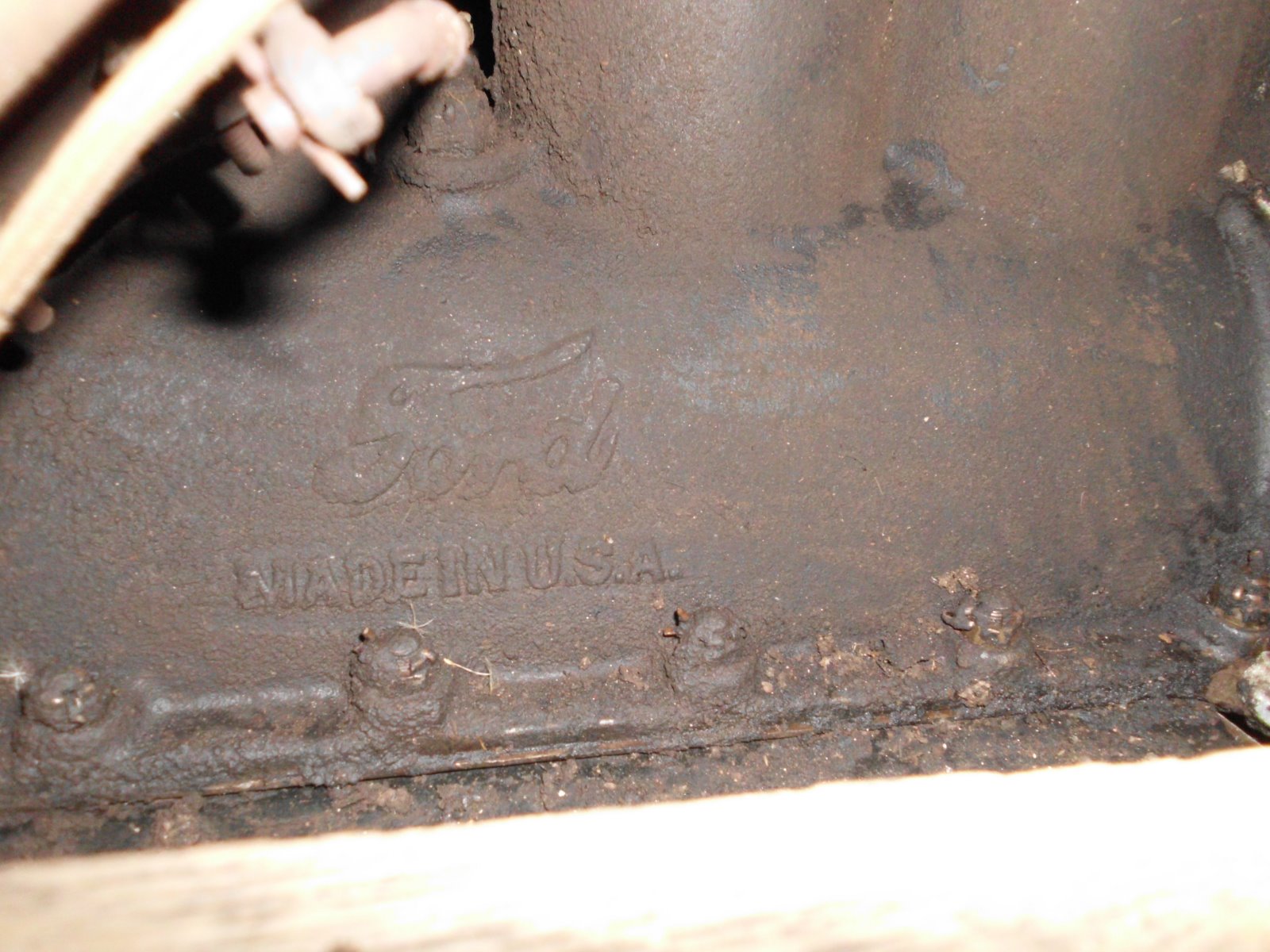

I don't think the Made in USA was ground off, I don't believe it was ever cast in the first place. I have a Canadian 15 and 16 engine and only Ford is cast on the block and nothing is ground off. I don't think the country of manufacture was cast in the blocks until some time in 17 or later.

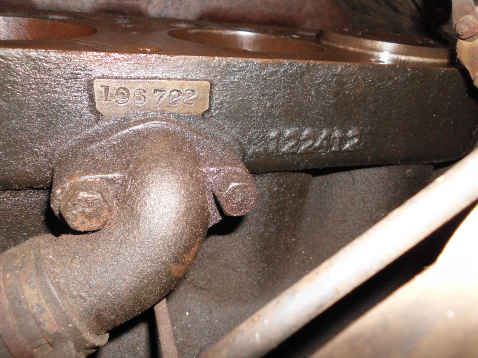

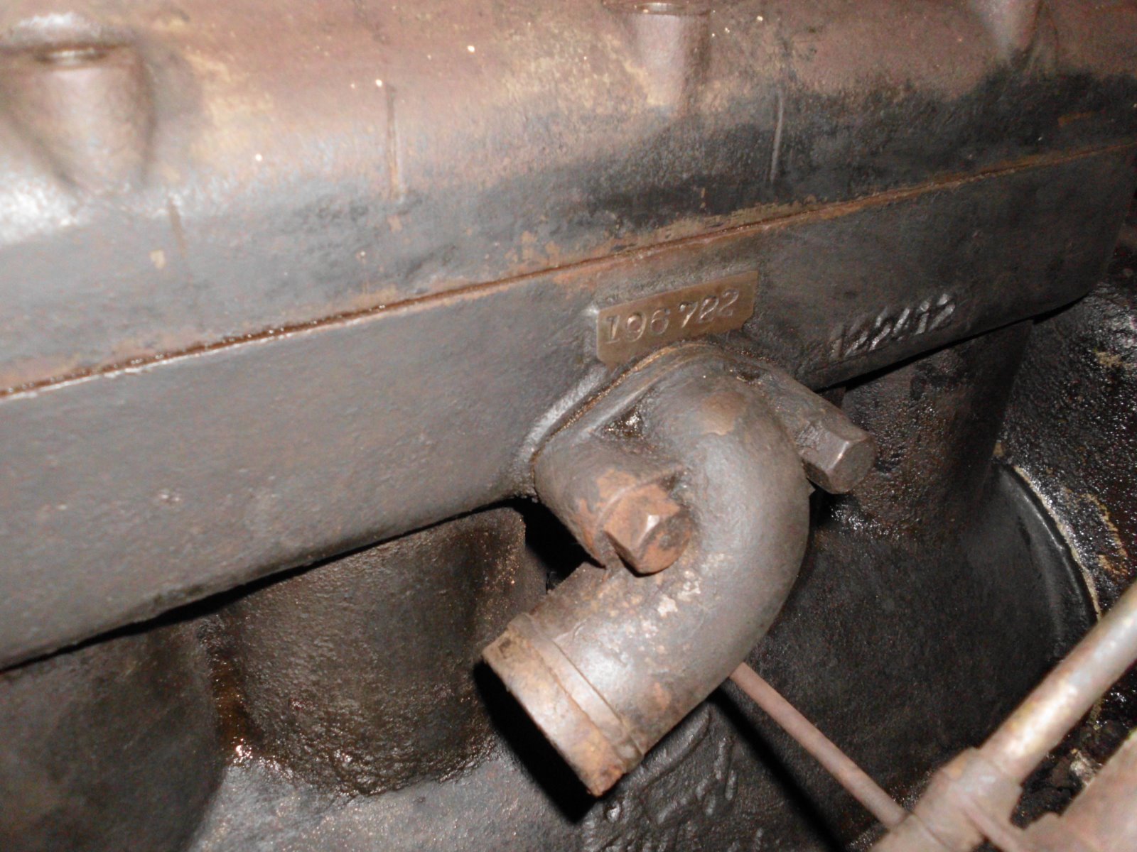

This is my early 13 Touring engine cast 12-24-12

David, the fossil evidence is contrary to your timeline for the casting of country of manufacture on engine blocks. Many, if not all early blocks in Canadian supplied cars sent to Australia show where the 'Made In USA' was ground/chiselled off. I cannot put a time to the end of this practice.
