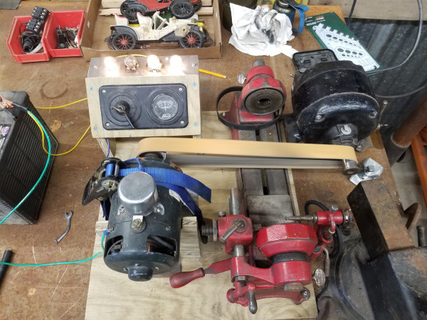

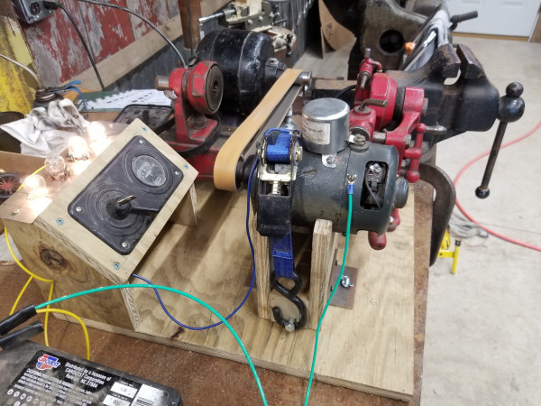

Enjoying a little time in the shop while waiting on material for two jobs at work. The generator on the 27 tudor Im working on was not working. While I was at it, I rebuilt two other generators for myself. I picked up a Tru-cut armature lathe and a growler but needed a test stand. I borrowed some ideas on the forum and got creative.
The belt has yet to come off.
Not OSHA approved but works great

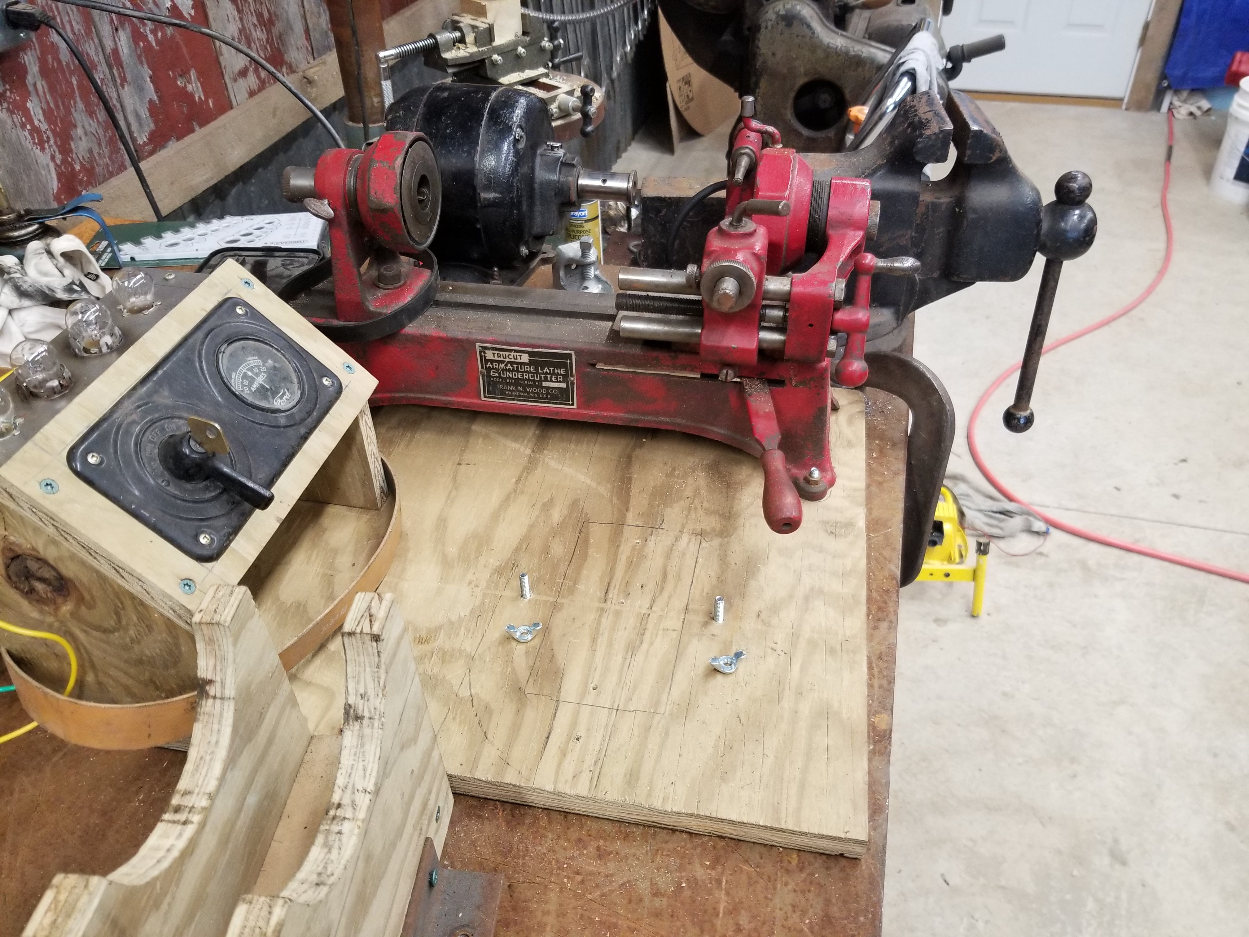

If I need to use the Tru-cut, I remove the two wingnut and remove the stand. I had to buy two bulb holders for about $7. The rest came from all my junk ( as my wife says). About 50/50 on finding a good armature from old generators.

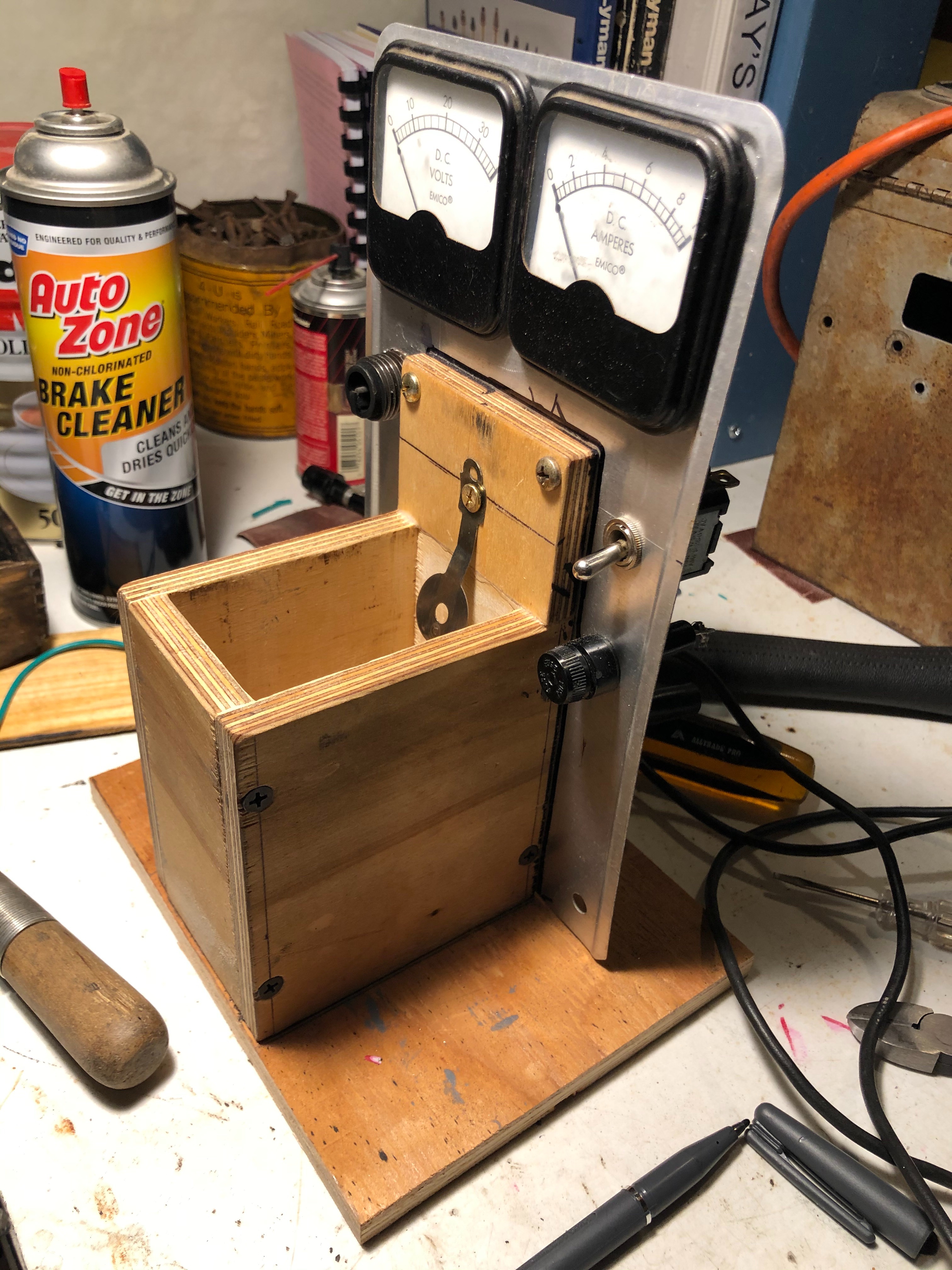

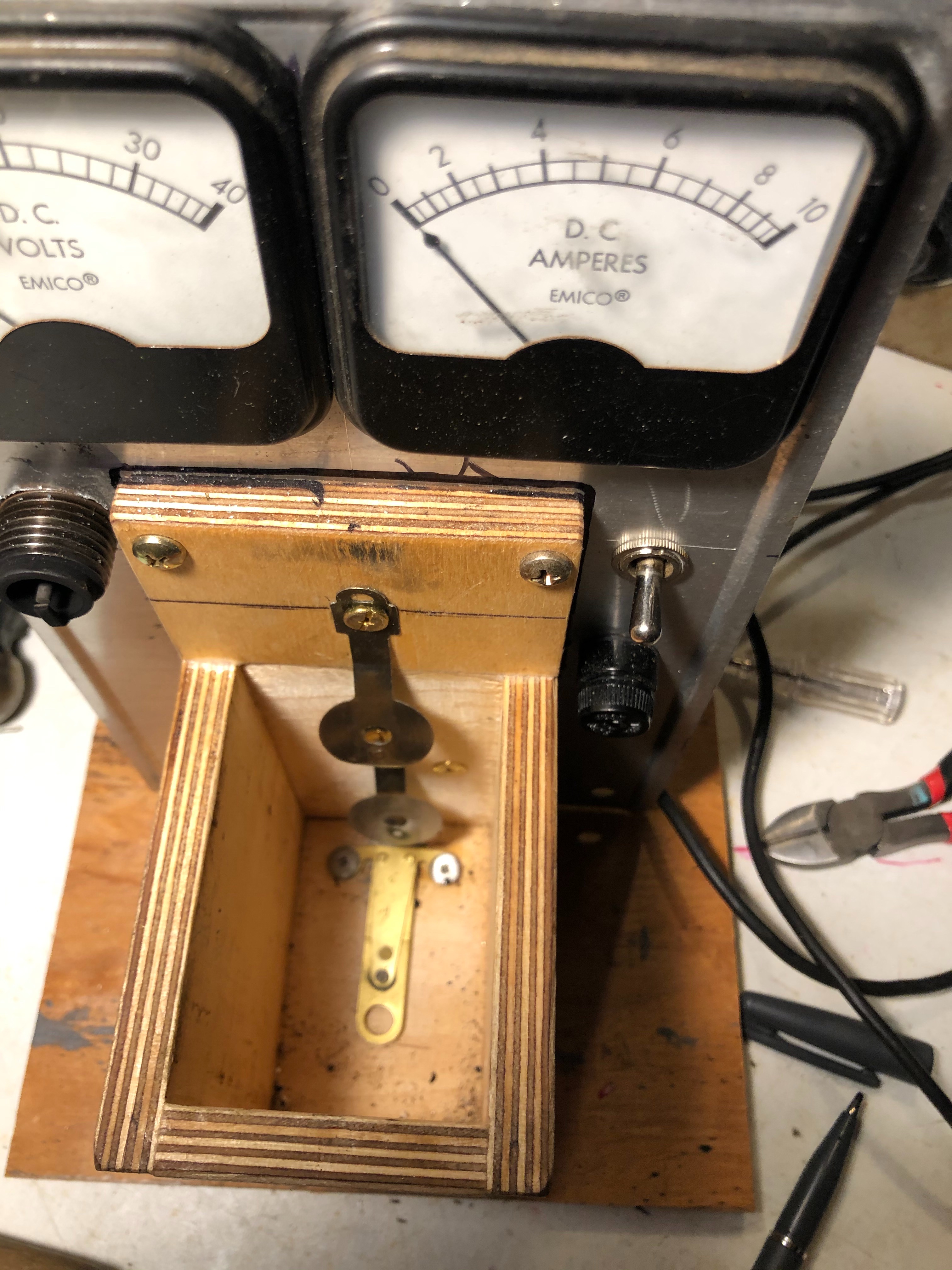

If a person makes a test stand for a T in order to be proper it should be made of “junk”. Pics of my “junk” coil tester.
