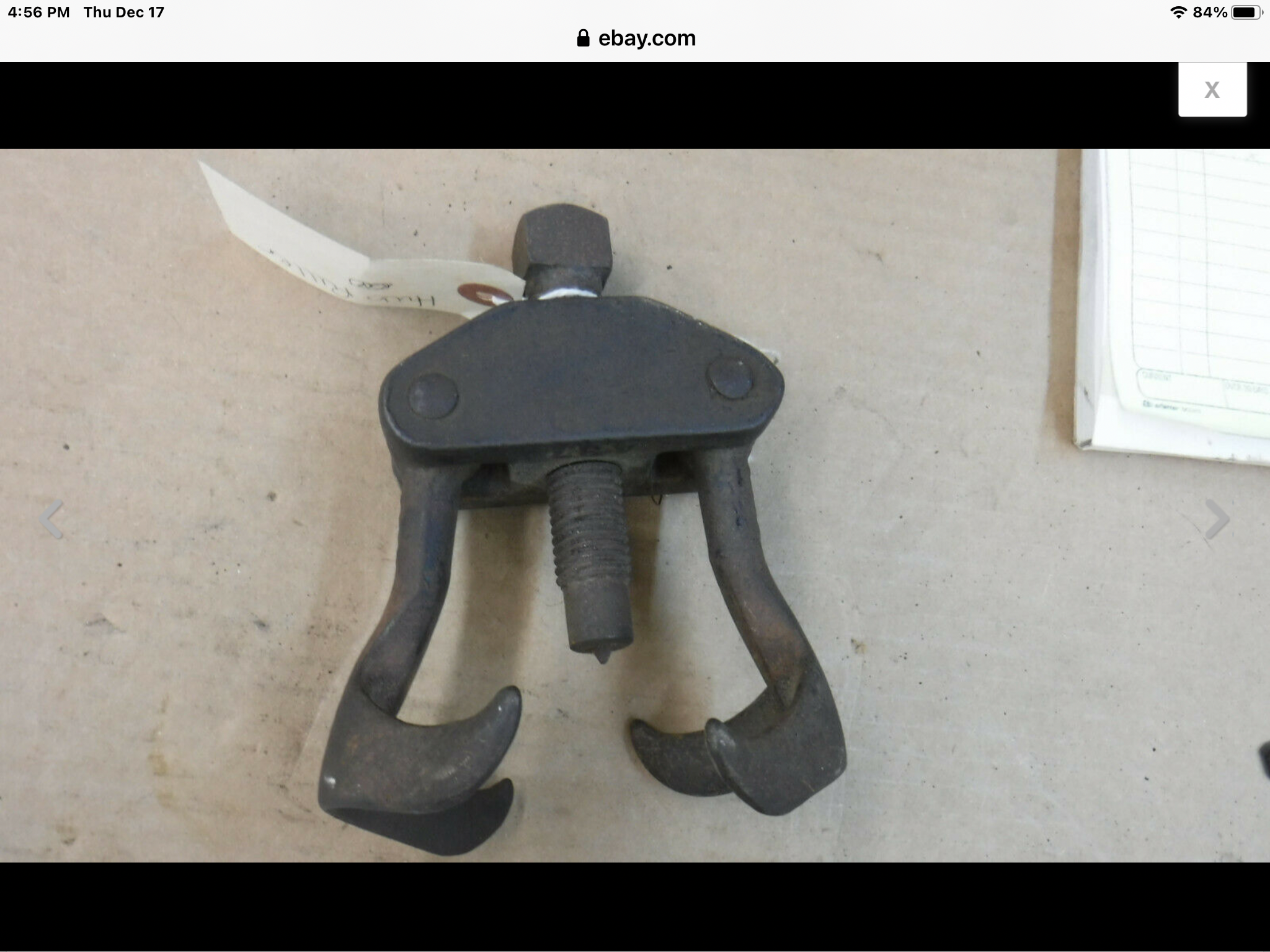

Post by DanTreace » Thu Dec 17, 2020 8:46 am
Good 2 jaw or better yet a 3 jaw puller.
Remove the nut, and then apply lots of penetrating oil, Kroil or P B Blaster to the threaded areas, if the threads are rusted, wire brush away the heavy rust to let the fluid sink in, let is sit awhile, but soak it!
Then apply puller, use a mallet and tap on the puller shaft, then tighten and the wheel spider will pop off.
IMG_1636 (998x1024) (595x610) (575x590).jpg (137.4 KiB) Viewed 5036 times

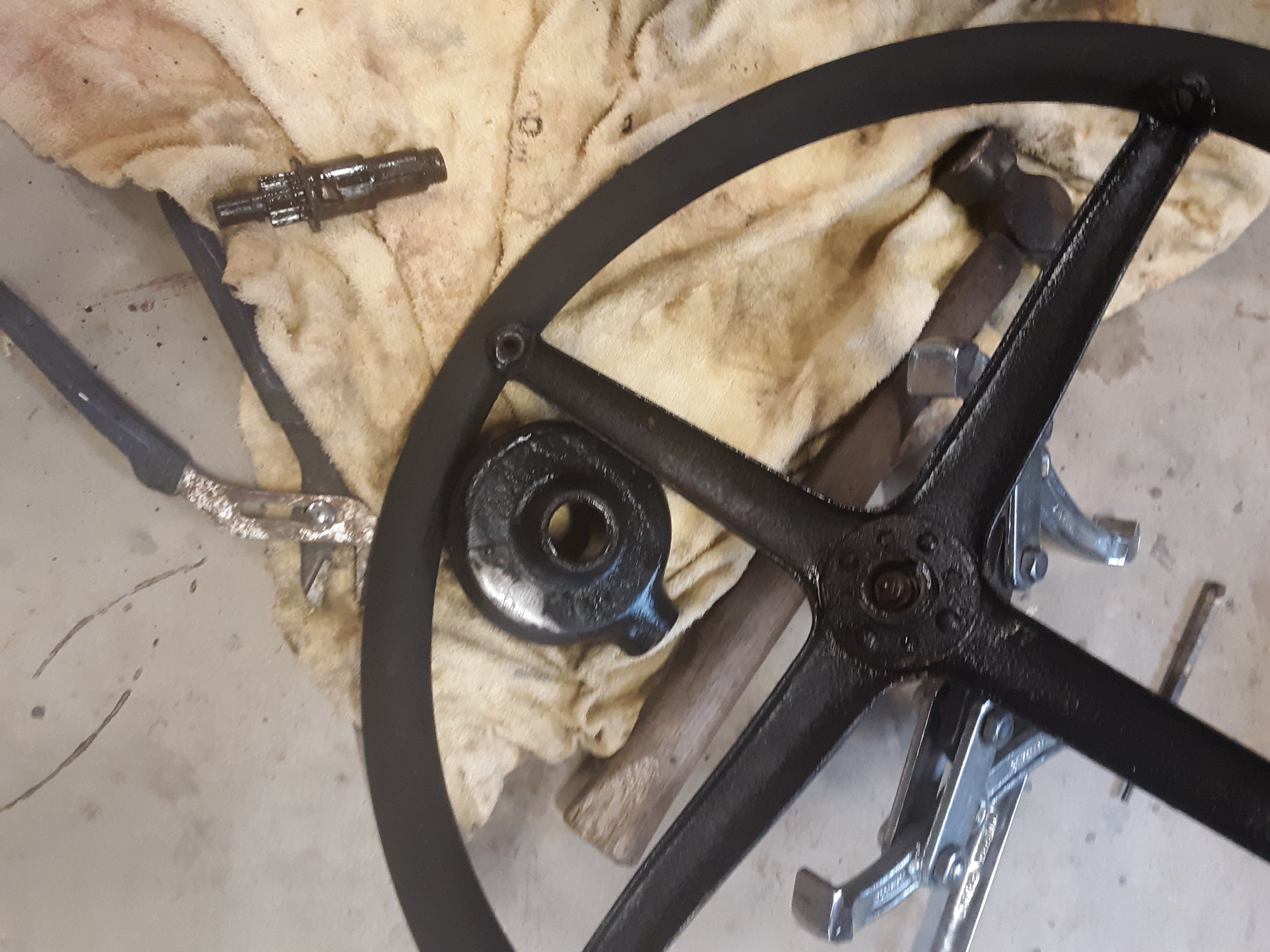

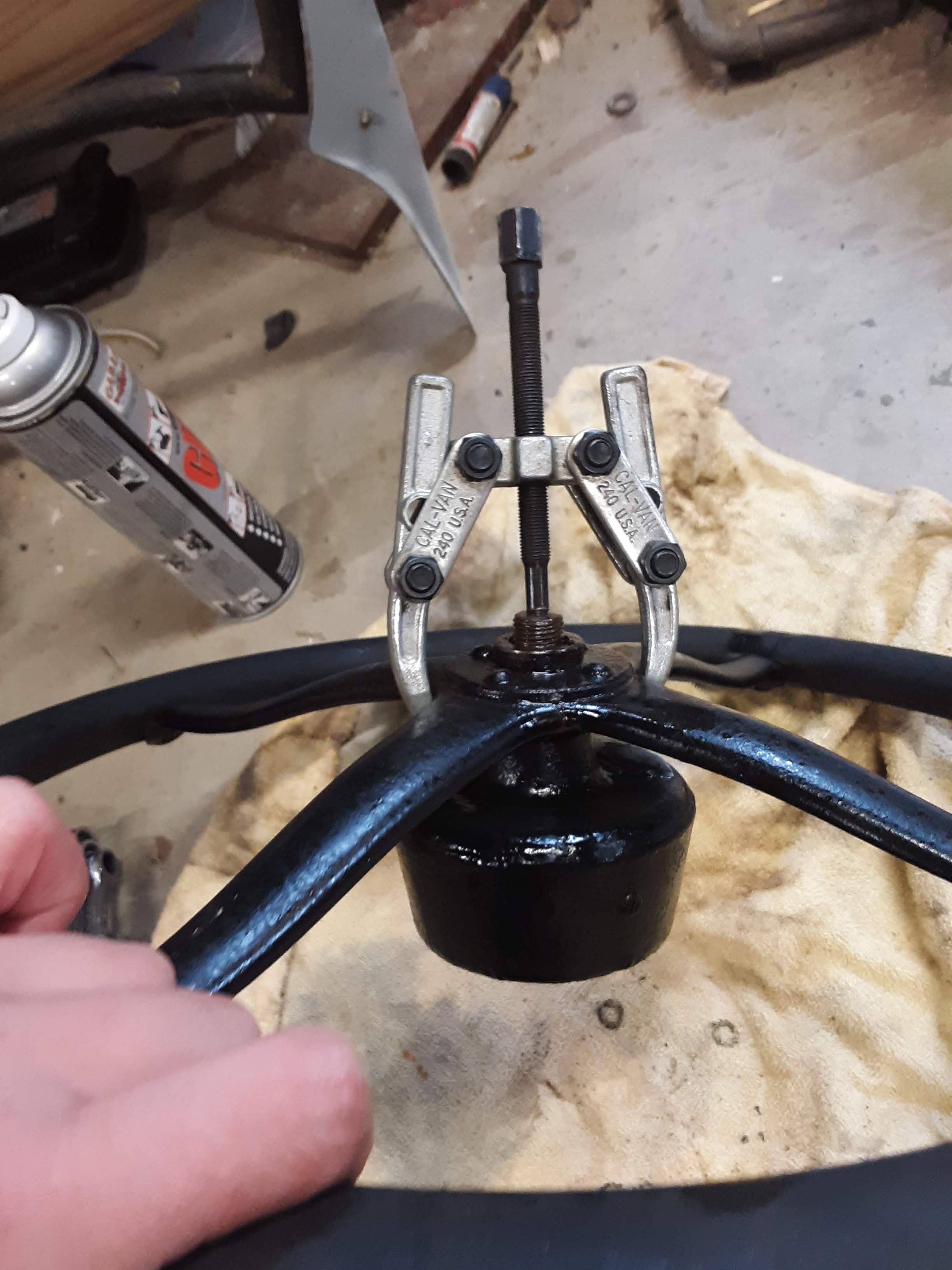

Post by Jonah D'Avella » Thu Dec 17, 2020 12:47 pm

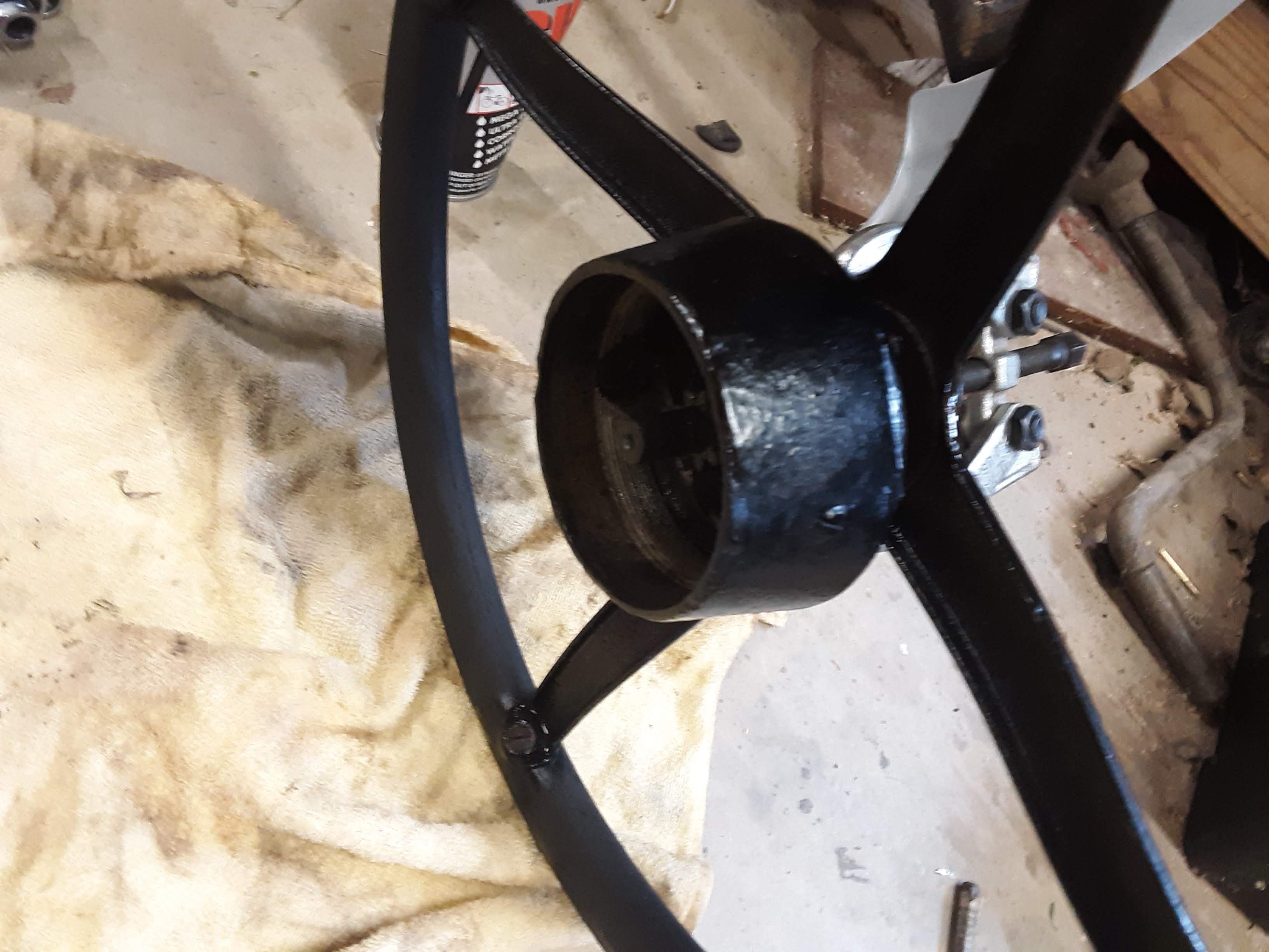

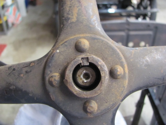

here are some pics

Posts: 4046
Re: STUCK!!!!!
Post by DanTreace » Thu Dec 17, 2020 1:39 pm
Your small gear puller is a bit undersized but might work.
A larger puller and strikes with a 2lb mallet will get it off. Tighten the puller shaft fully by cranking on the hex head with a big wrench.
If all else fails take a torch to the stuck pinion and heat it , that can help separate the spider from the pinion.

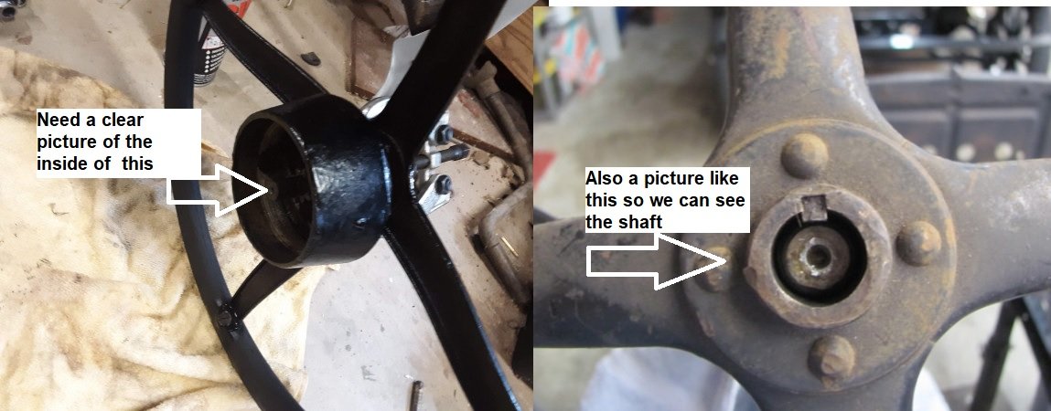

Posts: 6545
Re: STUCK!!!!!
Post by TRDxB2 » Thu Dec 17, 2020 2:41 pm
Need two more pictures, like I have shown, to make sure we understand what is holding the wheel from coming off. Since you have a wheel lock there may be something unnoticed. Question: The housing of the wheel lock is still attached - is it fixed to the wheel or can it turn freely?

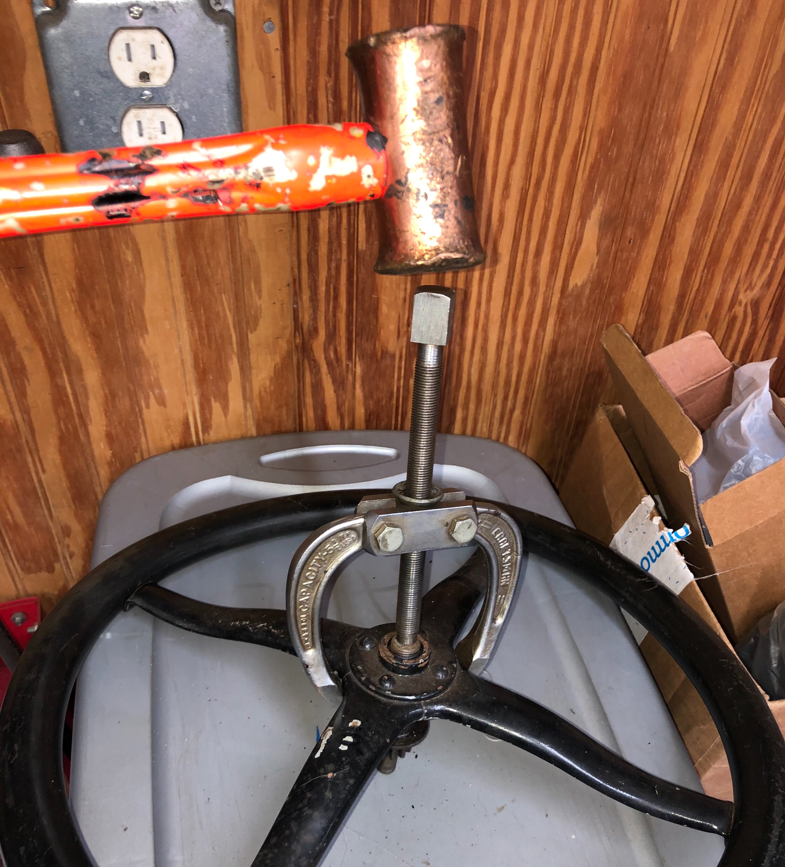

I admit I’ve never had a stuck steering wheel, but it’s good you took it slowly. Better to do that than overuse a big hammer and forever regret it.

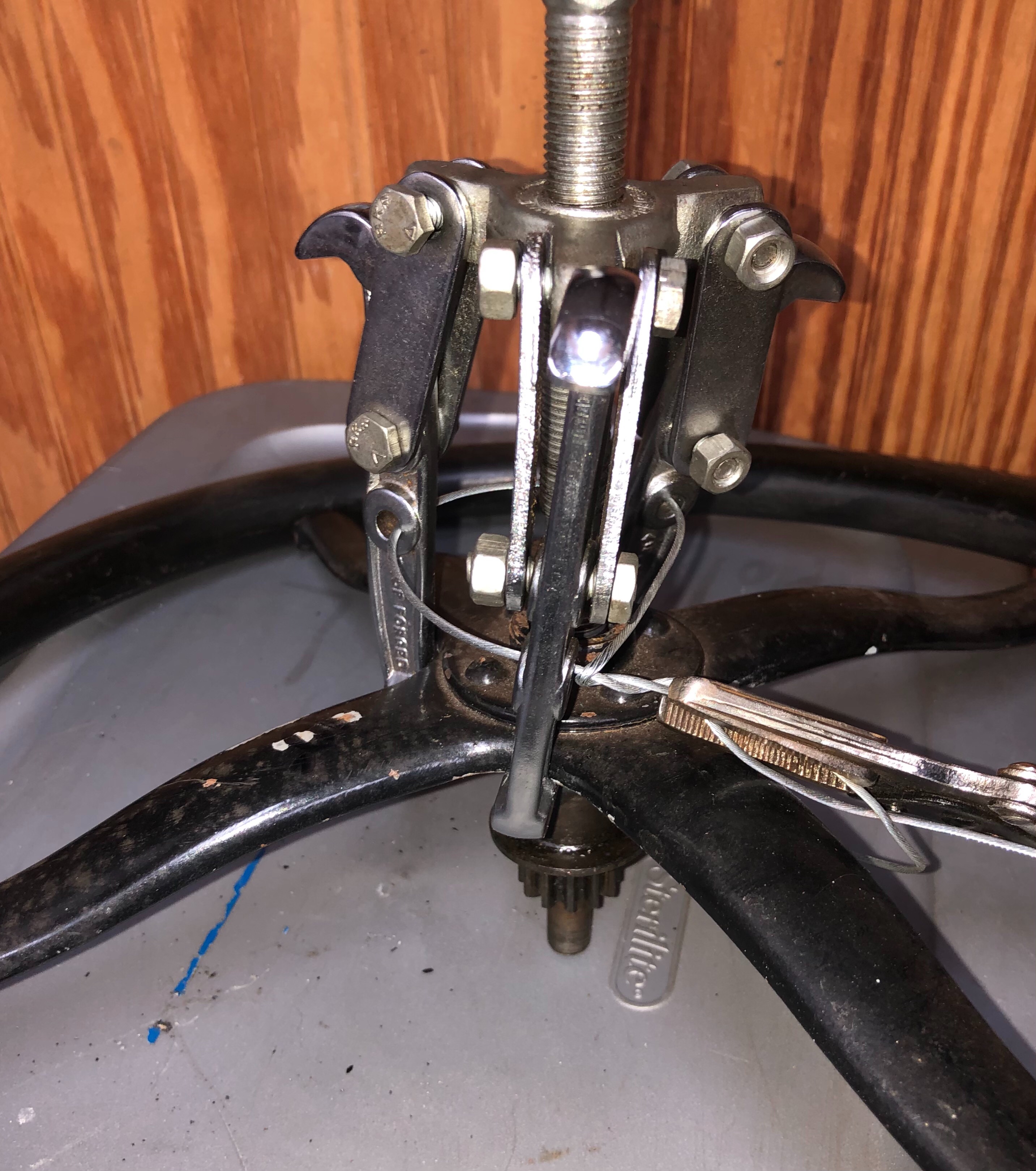

I think this is an apco T ford steering wheel puller. I hope I’ll be corrected if not.
