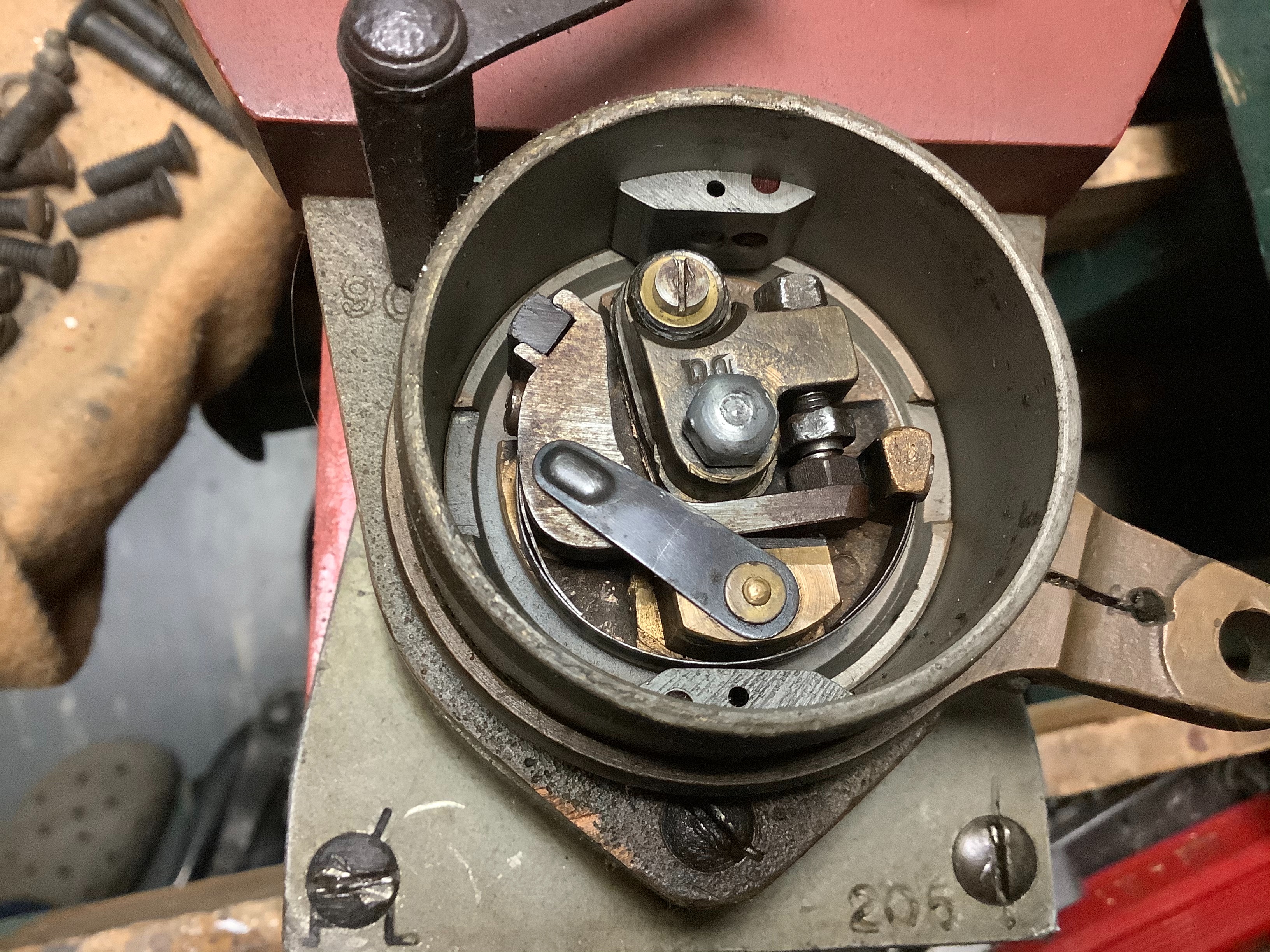

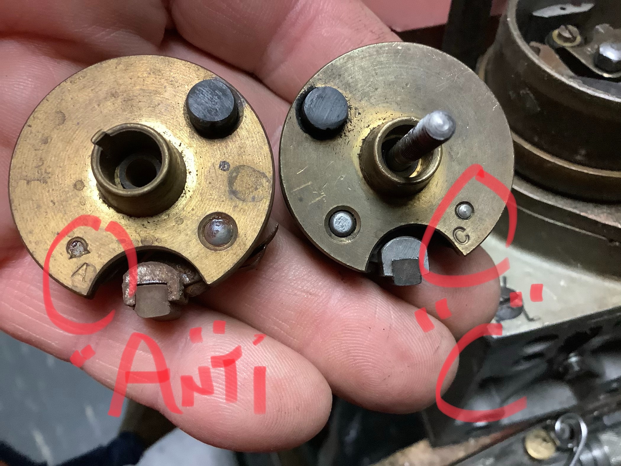

Tim, shown is the right point sets inside the mag. That set is clockwise. Shown on the backside , one is marked “C” for clockwise. The other “A” denoting Anti-clockwise. That is how Bosch referred to them. If you need a copy of the manual, let me know and I can email it to you. It answers everything you need to know to set it up correctly.
From memory, the 3 gear side drive setup uses an Anti-clockwise mag. The side drive like you show, and all the front mag drives use the Clockwise mag. If not correct, hopefully someone will shout out. If you don’t fool with these all the time, the info leaks from my brain. The recent Bosch mag shelf that I made up, I’m not sure of rotation required. Need to map it out someday.

“A” means anti-clockwise , also counterclockwise. “C” means clockwise

Thanks for the information on the markings. That makes it easy to swap them over if needed.

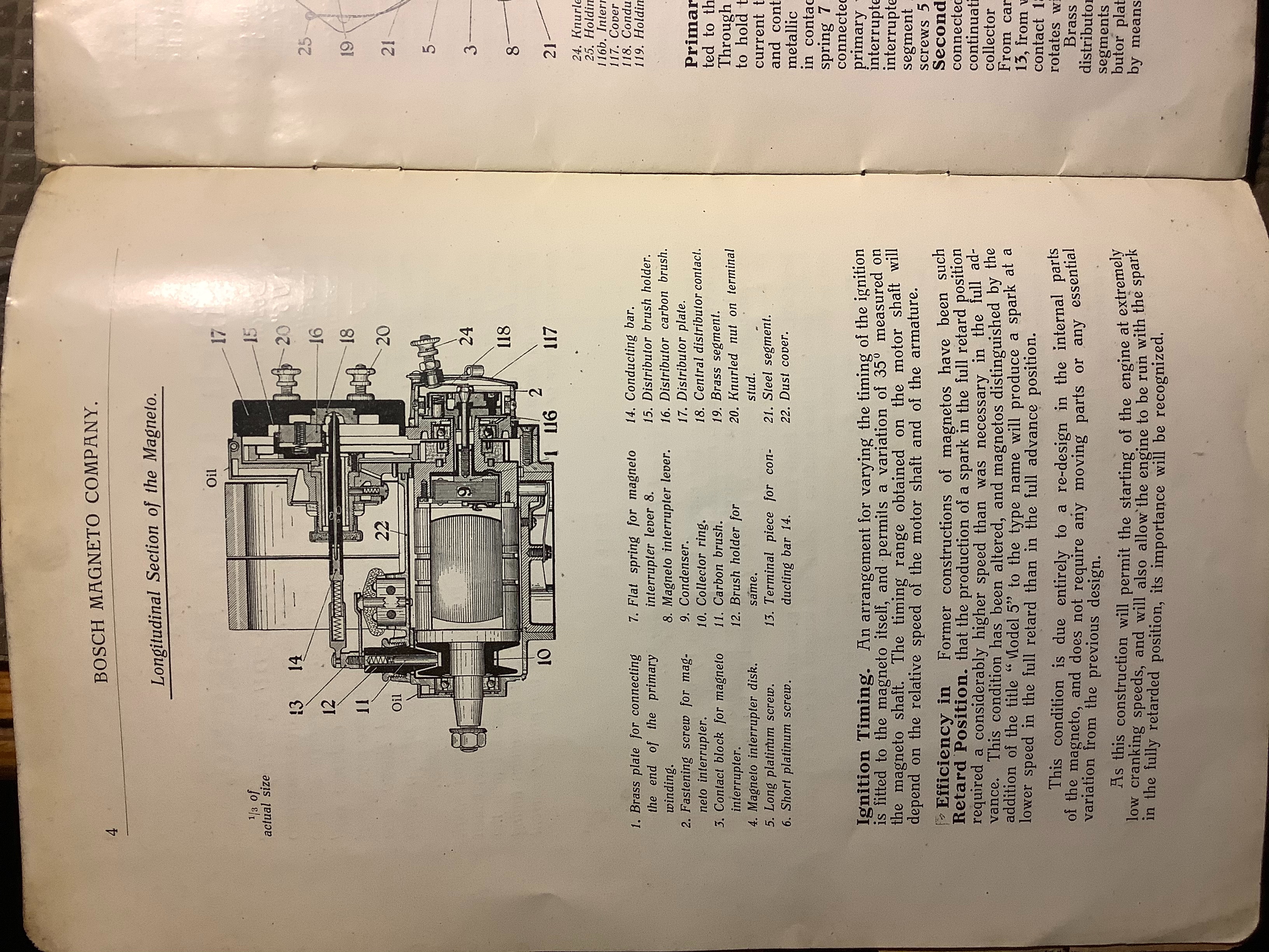

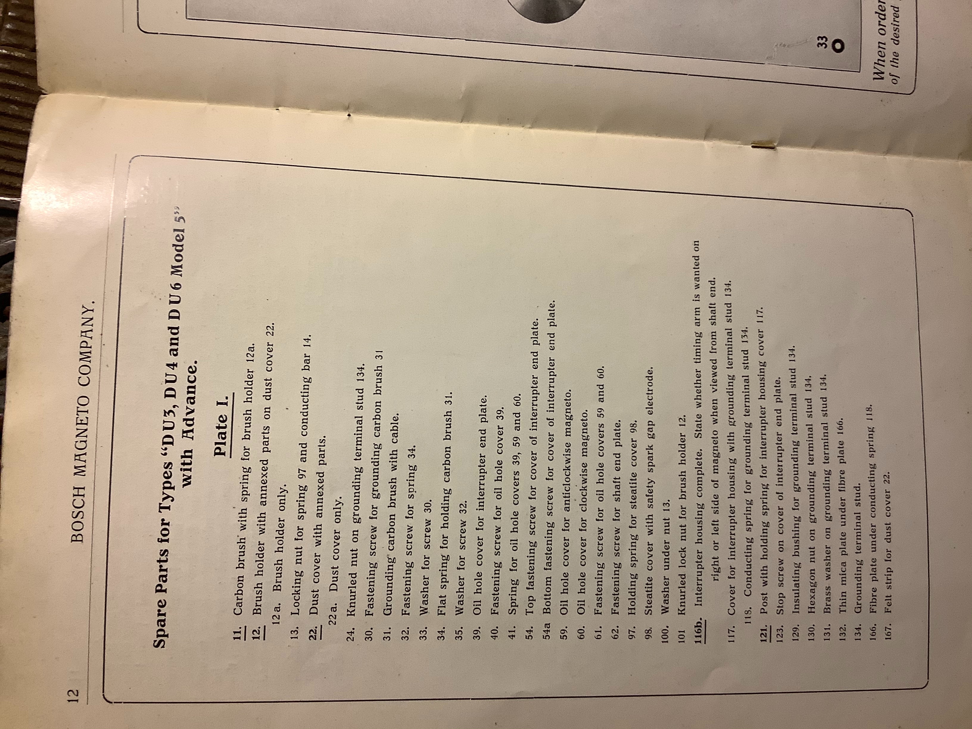

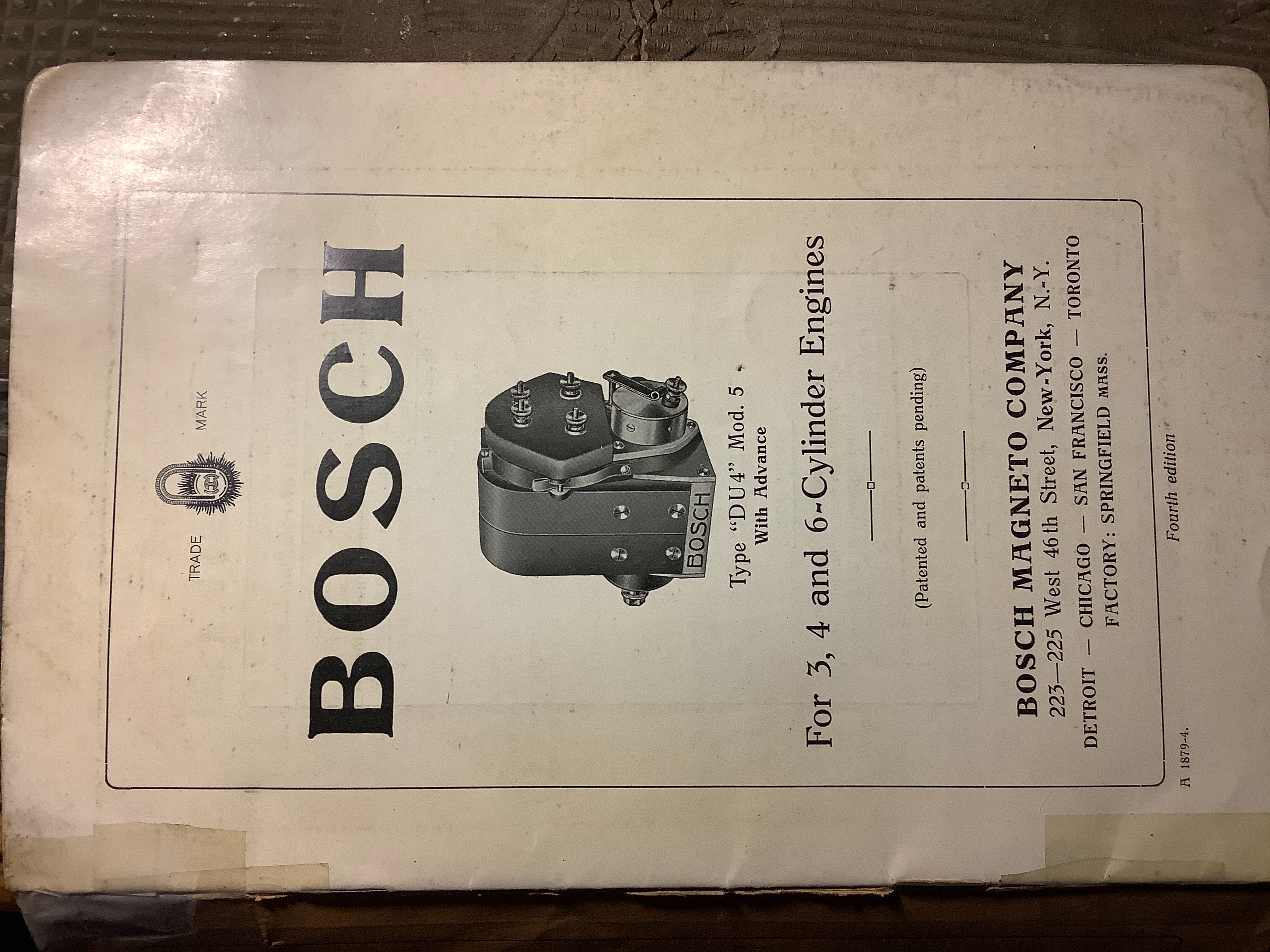

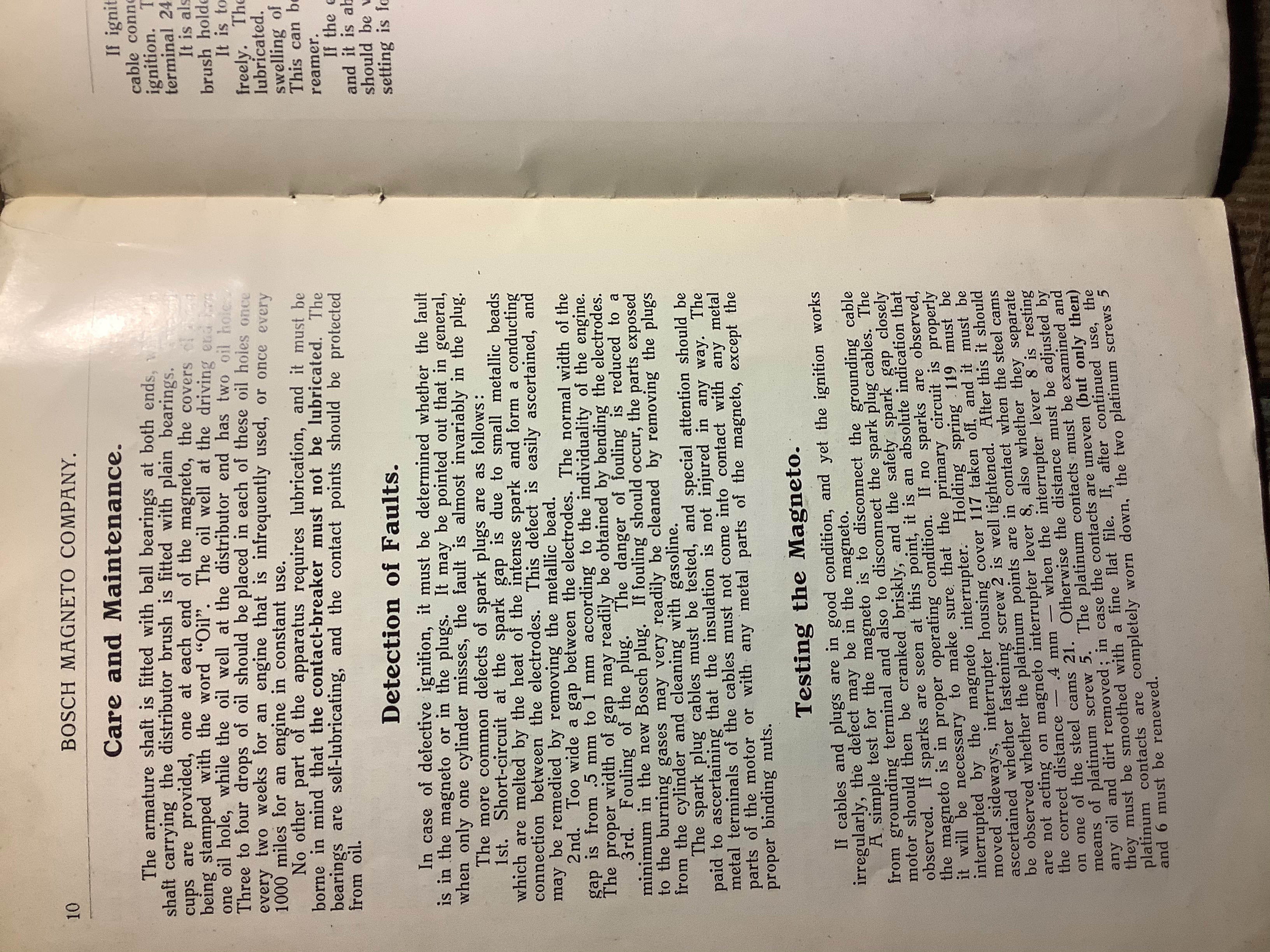

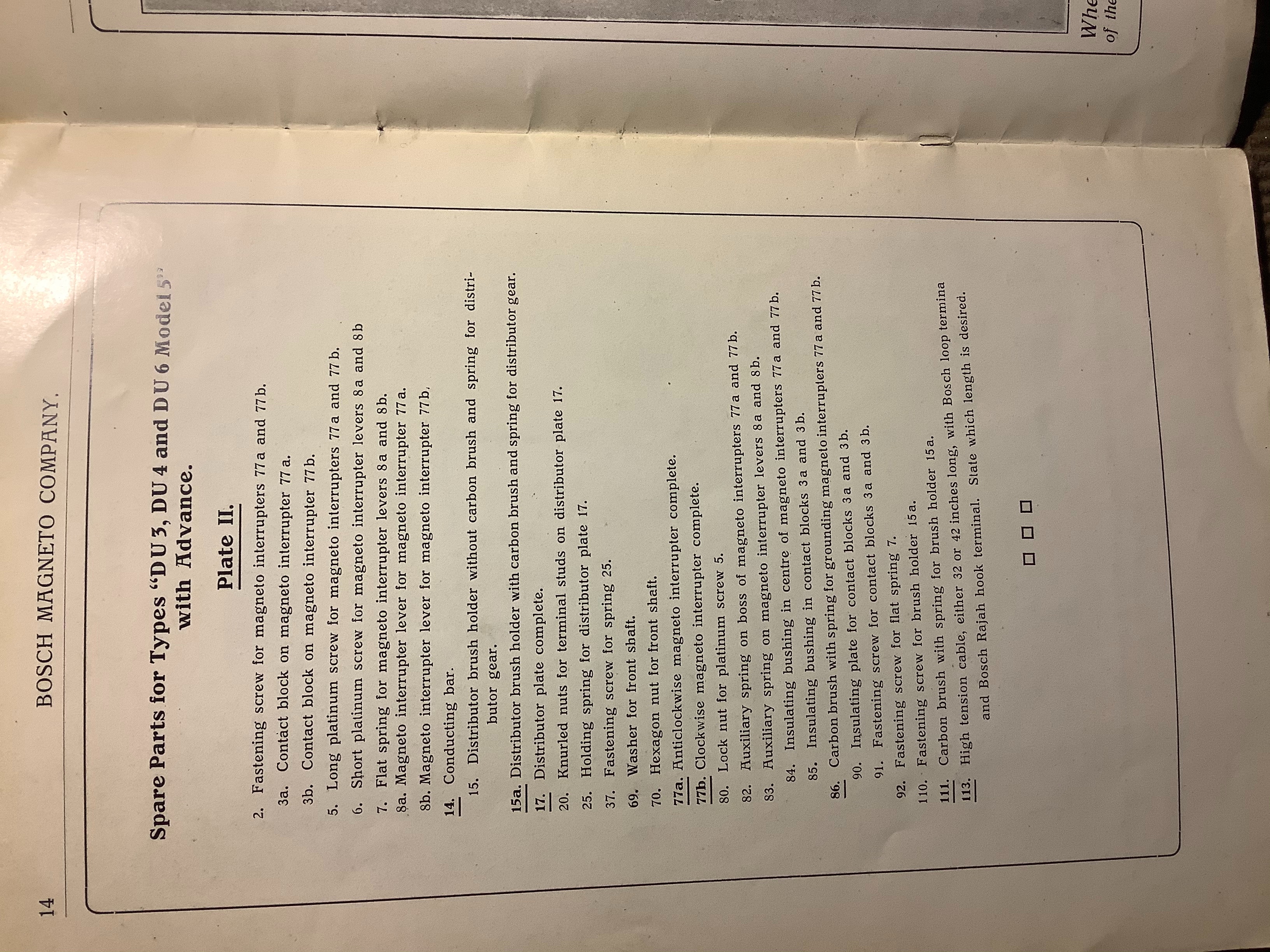

Tim, those pics are gold for many people! May I steal them for my magneto records? Serious question. I don't know if I've seen that before!
Which manual do you have? Very curious. PM me if you feel it more comfortable.
oldcroak has graciously provided me with many magneto manuals. A God-send.
For impulse coupler users, most times that part's cake as the parts are marked like those "jewel pics" of the points plate.
Just flip the parts (and the spring) around so you see the A or the C/AC as your needs dictate.
Replace the interrupter (points) plate, re-time the gears and set the impulse coupler.

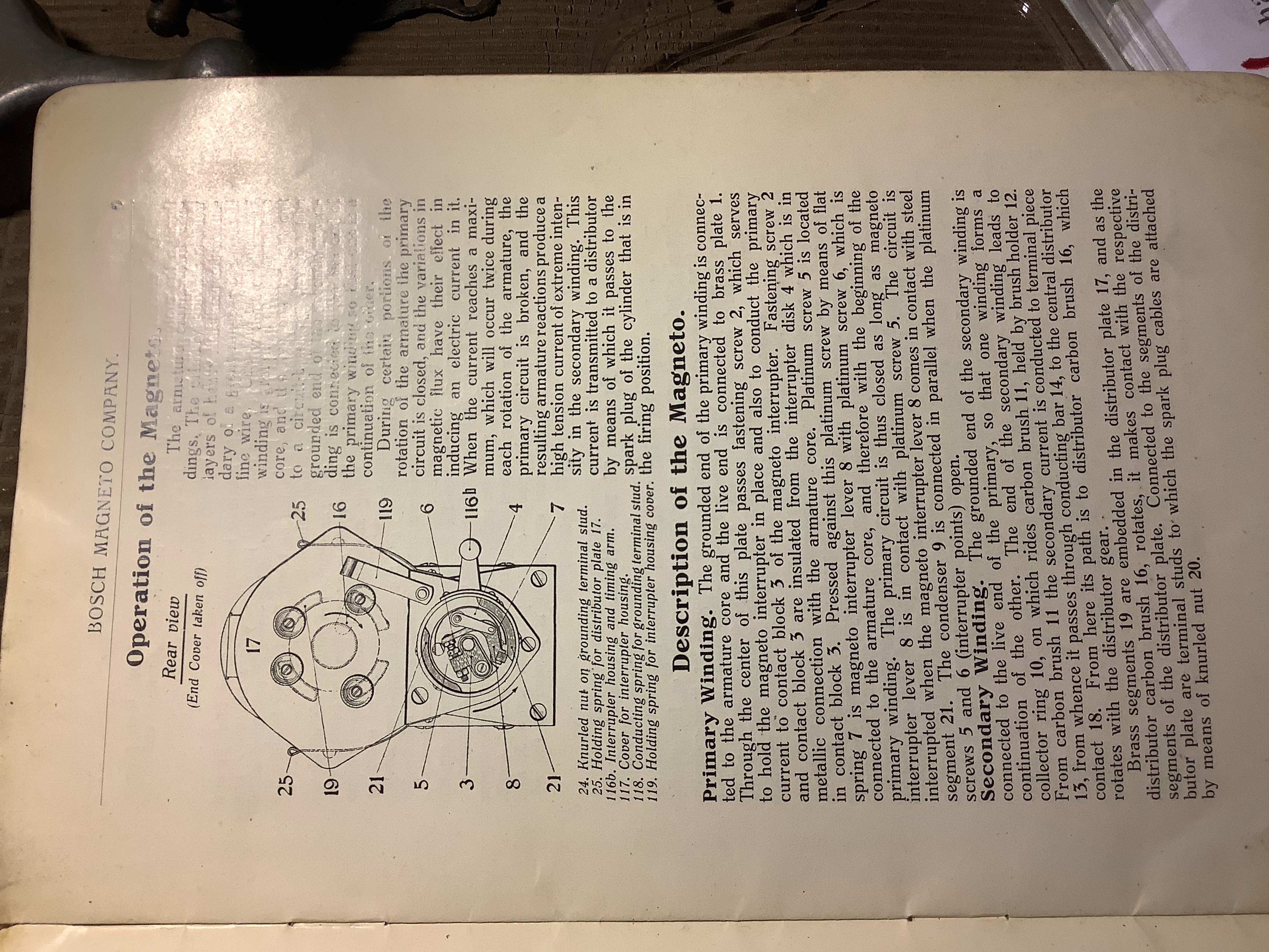

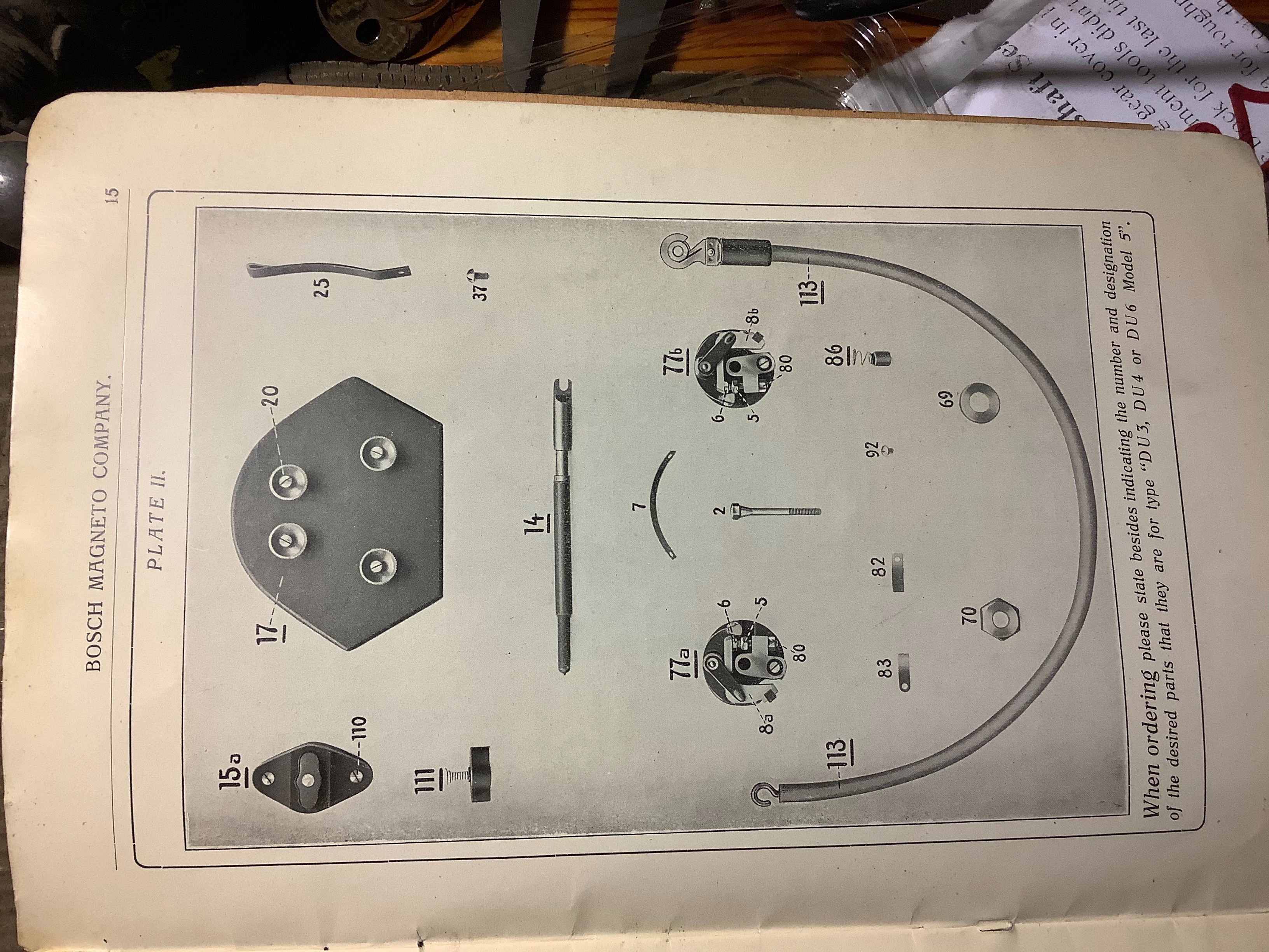

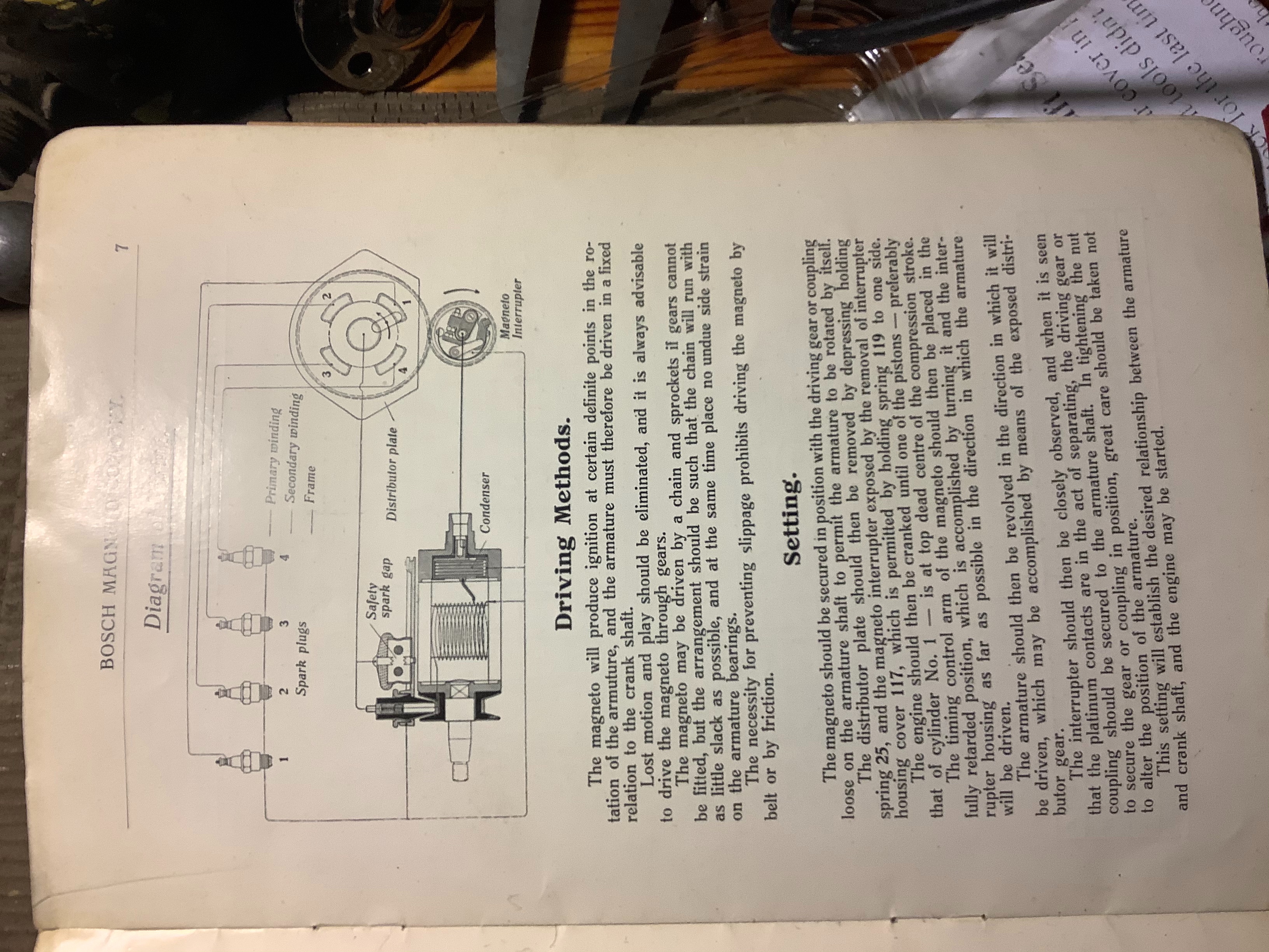

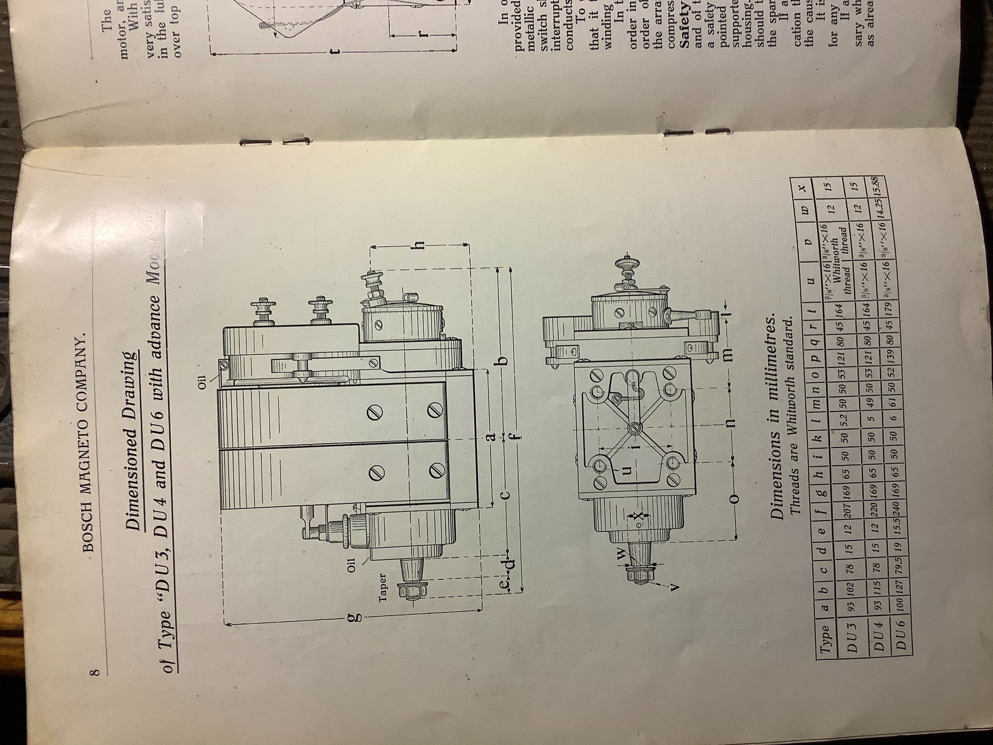

I’ll post the manual for the DU4 here, Duey. Feel free to pass any of it on, but please let me know if I’m incorrect.
