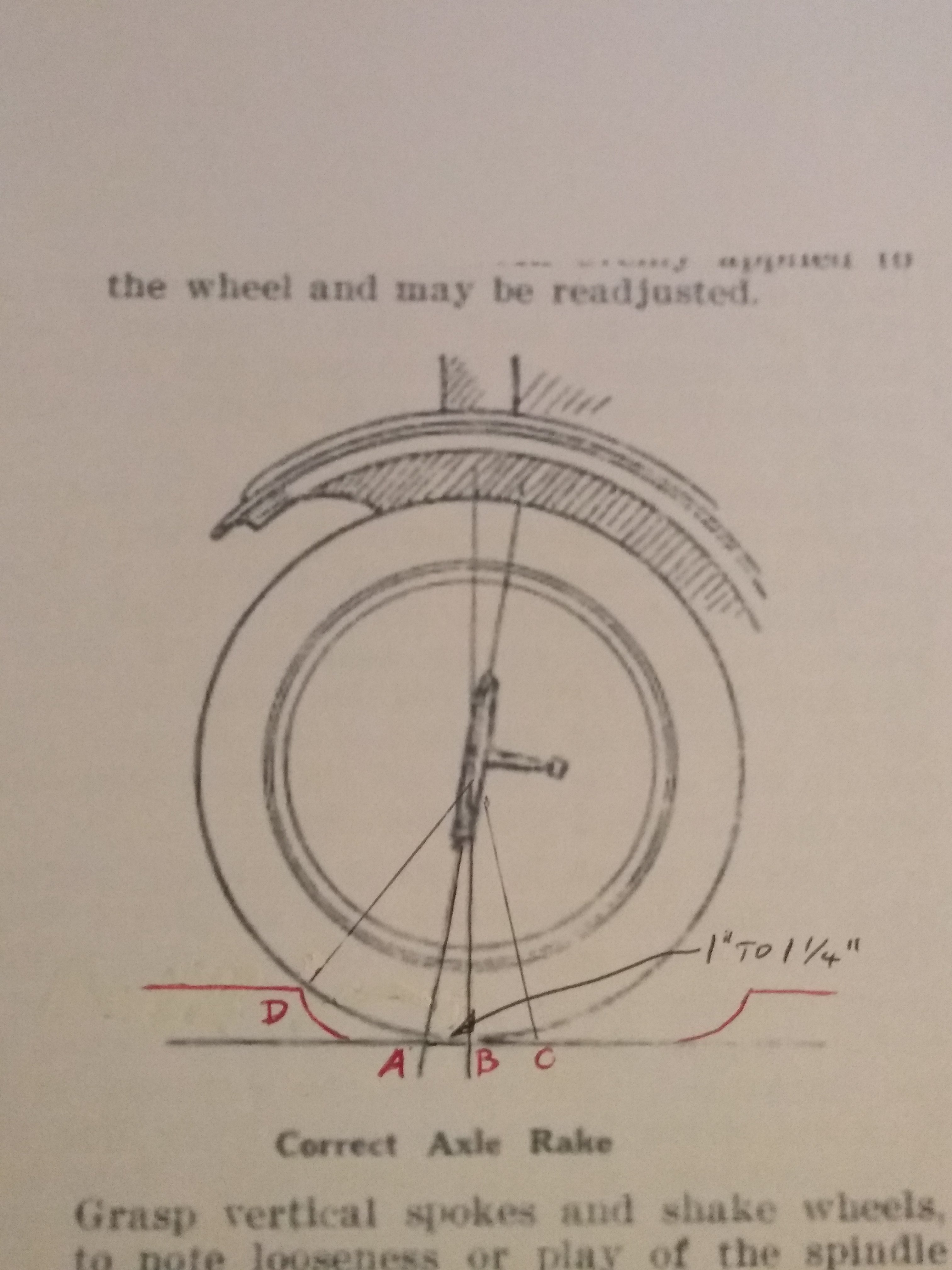

Have you measured the castor, camber, and toe in? An alignment problem can cause it to pull. A common problem with the early T's with the wishbone bolted above the axle is caused when you hit a curb or pothole hard. Even if you have not hit it hard in over 100 years, someone could have done so. This will bend the spring hangers causing the change in castor to what is called negative castor. Think of the castors on a chair. The axle is always behind the wheel as you push the chair. If you happen to push in the direction of the axle, the castor will spin around. Same thing happens to the car wheels. The top of the axle should be tilted toward the back of the car and the bottom toward the front. If it is bent, it will have negative castor. The camber and tow in are mainly used to keep the wheels going straight ahead when you are not turning.
In the Ford Service manual paragraph 147 page 45 the castor is called Pitch. To measure this park on a level floor, preferably a concrete slab. Place a square with one leg on the floor and the other against the axle right against the spindle body. From the front of the car measure the distance between the spindle body at the top and at the bottom. The difference should be no less than 1/4" nor no more than 5/16" The top should be leaning toward the back of the car. If it is not within these measurements, it must be bent to fit. I have not personally had to do this, however, you would need a tool similar to a large pipe wrench with a very long handle, perhaps, with a piece of pipe on the handle and use as a lever to bend to fit.

Is the wishbone holding the axle firmly with approximately 5 1/2 degrees of positive caster? (That was explained in more detail by Norman above -- Thanks Norman). Originally a 1909 to 1919ish would have the above the axle wishbone but sometimes they are replaced with a below the axle wishbone and/or braces below the axle are added to the above the axle wishbone.
Is the ball on the end of the wishbone that fits into the engine pan have minimal play but still free for the wishbone to move as the front spring absorbs bumps etc.
How to check the front axle caster to make sure it is not set too low. More positive caster makes the car's steering more stable going forward but more unstable backing up. Never back up fast in a stock T as by design the wheels tend to go full left or right when backing up. That is because "IF" you have the correct 5 1/2 degrees positive caster on the front axle -- when you are going backwards it has the effect of being 5 1/2 degrees negative and the front wheels want to go hard left or right. In the USA we have shopping cars that have casters on the front. And if I move the cart reward, the front wheels on the cart will turn around. The posting at: http://www.mtfca.com/discus/messages/29/40382.html shows the paragraph Norman referenced. It also has how to use a plumb bob and pencil to do the check instead of a square.
