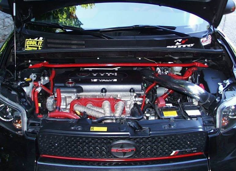

Whenever I see a post like this I always have to ask Do you experiment on your “Modern” the same way and why.
- Posts: 4472
Re: Motorcycle Oil
Charlie,Charlie B in N.J. wrote: ↑Thu Dec 24, 2020 7:24 amWhenever I see a post like this I always have to ask Do you experiment on your “Modern” the same way and why.
The Model T, being incredibly simple and basic in its design, seems to present an "empty canvas" to those who like to "innovate" and "improve". It just invites tinkering. Part of its charm I guess.
- Posts: 5545
Re: Motorcycle Oil
Hearing some of the cars racing around the area I live in, there is a lot of experimenting going on with them!
My 1996 S10 (if you can call that modern), calls for 5-20 or 5-30 oil. Because it is a high mileage engine, I am experimenting with 10-40. The engine in it is earlier then the truck so have been trying to get the EGR valve sorted out. The computer was made for an electromagnet type but the engine in it now is setup for a vacuum control valve. So spending time trying to sort that out. Even experimented with an adapter plate to mount the original type EGR valve back on, that was a no go.
- Posts: 6581
Re: Motorcycle Oil
YES! Because I have to.Charlie B in N.J. wrote: ↑Thu Dec 24, 2020 7:24 amWhenever I see a post like this I always have to ask Do you experiment on your “Modern” the same way and why.
