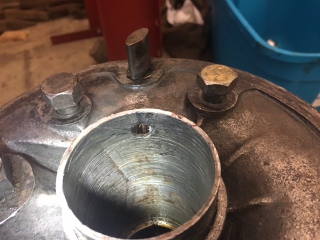

Does my rear axle housing need to be straightened?
Post by Bill Robinson » Wed Dec 30, 2020 9:02 pm
Does anybody know the limits on when an axle housing is bent enough to warrant attempting to straighten it? My axle shaft is off-center in the housing by .134”. This was a new, modern axle shaft that was installed in 2017. The shaft itself does not appear to be bent. The Hyatt bearing is good, within tolerance and no play, and the shaft itself has no end-play. What do you think?

I don't know the maximum distance recommended before straightening, however, there is a bit of slack in the roller bearings. The main thing to be concerned about is that if there is not enough slack for the axle to find a way to run straight, it would bend a bit with every revolution and eventually would get metal fatigue and break. So I guess it depends on how much you drive the car how soon that would happen. Someone else might know the vital statistics.

Bill, the difference between your measurements is .134" but the shaft is only half that amount or .067" from center. Not that this answers your question of how much is too much.

Hold on. Does that measurement really mean anything? Doesn’t the axle not sit centered in the housing without the outer bearing to keep it there? What am I missing?

Might not be the best advice but as long as the roller bearing will slip in without having to be aggressively forced in place I assume the housing doesn't need straightening. I usually try to fit the bearing four times with the axle turned to the 3,6,9 and 12 o'clock positions using the hole for the split pin as a reference. There might be a bit of a difference in the pressure needed at some points (which I assume means something is bent a bit) but as long as it isn't significant I go with it. I have seen plenty of housings where you would have to pound the roller bearing to get it to go into place and those I either put aside or straighten.

I have straightened enough rear axle housings over the years! Fairly easy to do with just a oxyacetylene torch.
I made a set of testing fixtures and I will try to post some pictures

Further to Bill’s posting, I think his is probably straight enough

I don't think that you can tell what is off that way. Did you measure the front and back also then rotate the axle 180 deg and check all four measurements again ? That would show if the axle is straight but it could be the housing or something amis at the differential carrier. I would say that if you can slide the good outside roller bearing over the axle into a good axle sleeve with out a lot of force, you should be OK.
The next time you have the rear end apart you can check the housings by their self. On a 1913 and later housing you can use a plumbob, clean cardboard, straight edge, a framing square, and a marker. Place the housing diff side down on the cardboard, place straight edge at pinion opening and draw a line along straight edge. Trace the outline of the outside of the housing center on the cardboard. With someone to help put the plumbob into the tube and center the stirring at the outer bearing opening. When the string is centered use the plumbob point to mark a hole in cardboard, remove housing. Now with a framing square draw a line at 90 deg from pinion line to plumbob mark. Now you can check how square and centered things are, any bend will be exsarated by the housing length. I haven't tried this on a pre 1913 housing they would require better measurements.

If it were mine, I'd straighten it. I don't believe there is any service limit though. With the system I use, I would heat shrink the axel close to the center housing.
On the other hand if the roller bearing slips into the end of the housing without binding I might leave it alone. I'm sure in the old days, folks simply substituted a worn roller bearing and let it go.

I have made extensive calculations on the axle bending, bearing misalignment, and bearing loading from the tire and gears. Your misalignment could be beneficial or detrimental depending on which way it is. Years ago car manufacturers offset to compensate for loading misalignment. That was 50 years ago.
I wouldn't worry about your issue. You could check the misalignment at the other end, but another good bare axle would be needed.

Is your drawing really correct in that it shows the axle sitting above the housing centerline? A bent housing would typically cause the axel to sit below the housing centerline.
Also, it appears that your inner seal is installed as you take your measurement. At some amount of deflection, the seal will begin to support the axle, giving an erroneous sense of just how much offset there really is. I usually check for any offset/deflection with the inner seal removed. Since there's always a bit of "droop" anyway, due to gravity, I lift the axel until I get some fair resistance, note how it's offset from the bore, then compare that to the offset when the axel is unsupported, (i.e. drooped). If the "up" & "down" offsets are the same, the housing is not bent. If they differ, then the difference suggests how much the housing is bent.
As someone else suggested, if you can insert the Hyatt bearing without using undue force to raise the axel enough to do so, then you're probably in good shape.

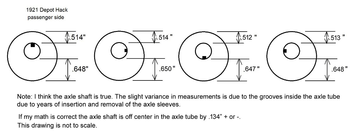

Jerry- the drawing shows the centerline of the axle tube is actually below the center of the shaft. I agree that the inside seal might be supporting (I hope!!) the shaft and maybe if I remove the seal it will let the axle drop approx 1/16" (could I be that lucky?).
In the morning, I'll go to my shop and pull the seal, and re-measure. My fingers will be crossed.
Meanwhile, I have some new numbers. This time I took the earlier suggestion that I should rotate the axle shaft and remeasure, to see if the shaft might be bent rather than the tube.
4 views of the axle shaft 90 degrees apart

OK. I removed the inner, modern cone shaped rubber seal. Luck did not go my way. Instead of the axle moving down toward the center as expected, the axle shaft lifted slightly to the top of the axle housing tube. The clearance at the top changed from .514 to .466.

The new measurements are too far off to ignore. I'd definitely find the cause and correct.

While nothing is impossible, I would think it's fairly rare to have the axel tube bent downwards at its outer end, causing the shaft to sit above its centerline. I would think that housings get bent due to the spring bottoming out and smacking the center of the axel housing, making the whole assembly "swaybacked". What you're describing is the opposite, with the whole assembly being arched upward. Not personally having had a housing bent to any noticeable extent, perhaps my understanding of how the bend commonly occurs is flawed. Maybe others can offer their findings.
How much force is needed to push the axel back on center? Can it be done easily by hand?

The axle housing should be straightened. I previously said don't worry about it but I was thinking .0067 inch instead if .067 in. off center. The hazards of not checking and rechecking. Art Mirtes

It is possible that over the years, the car has been jacked up with a jack under the center of the axle. That could bend the tube so the outer end is lower than the axle shaft. Unless this is a rare car, you can very likely find another axle tube to replace it, or carefully bend it back. Another possibility would be the inner bearing is worn out which would cause a sag in the center carrier.

Frank- I don't recall stating that there is any wobble to the axle shaft as it turns. Refer to my chart where I measured the shaft as it turns. There is no visible wobble. The little difference in the measurement at each quarter turn could either be 1. irregularities in the internals of the axle tube, or 2. lack of ability of the person in charge to use the internal measuring device. :lol:

In a perfectly straight axle housing, the axle will be below centre at the outer end. Gravity will pull the axle down and the inner bearing will not counteract this. Tolerances within the bearing and wear on the axle bearing journal will allow this 'sag' in the axle. The check I use is to lift the axle by hand. If it then appears to be the same distance from the top of the tube as it was before, then things are OK. A Herm suggested in the link, If the same measurement applies when the axle is pulled forward and then pushed backward, then things are OK on the horizontal plane too.
The worrying thing here is the ale is well ABOVE centre to start with, and the problem is likely to be worse when the shaft is lifted.

Just a quick question: Have you used a straight edge against the outside of the axle housing/tube to see if it is bent, or how much?

If you have someone available who knows how to straighten housings, go for it. Most all of them are bent to some degree.

This morning John Z and I dis-assembled the axle. As stated earlier- it appears that the RH half of the axle housing may be slightly bent down, towards the road.
The 1st photo shows the female end of the axle tube where the axle bearing sleeve is inserted. It is extremely grooved with highs and lows from end to end. The photo shows the grooves AFTER we honed it the smooth the high points a bit. After honing for about 30 seconds, then inserting the sleeve, we both immediately noticed that the gap in the sleeve had spread some. We then inserted axle shaft and then put the Hyatt bearing onto the shaft and easily slid the bearing into the sleeve. Before the honing, a little tapping was required to insert the bearing. There was no play between the shaft and the bearing. It felt good.
Photo 2 shows a straight edge on the bottom side of the tube. There is a very slight amount of daylight visible regardless if you look at the top or bottom.
Photo 3 shows a defect in the top of the axle. It appears to be a weld that someone attempted to grind smooth, but missed their goal. It now appears possible that the axle may have been involved in a wreck at some time.
This is the axle tube where the sleeve inserts. It was very &quot;grooved&quot;.
This is the axle tube where the sleeve inserts. It was very "grooved".
A small amount of daylight showing under my straight edge.
It looks like a blob of weld, but it could be a crack. No oil leakage, though.
Posts: 4168
Re: Does my rear axle housing need to be straightened?
Post by Jerry VanOoteghem » Mon Jan 04, 2021 8:55 pm
Some folks straighten axle tubes by welding on one side. The thought being, that the weld will cause the metal to shrink on that side, thereby pulling the tube straight. Not sure if the weld you show was done with that intent or not.
The rough bore in the tube is pretty much normal. It's a nice fit when the bearing requires a small shove, (usually by hand), when inserting it.
To get a real idea of how straight your tubes are, bolt the two halves back together, then set the assembly on 2 large "V" blocks. Rotate the axle housing on the "V" blocks and look for runout. These don't have to be precision "V" blocks. Anything you can make out of wood, that's solid and large enough will do. Place the blocks as close to the backing plates as possible, then rotate. Keep in mind, the mating faces of the differential housing can also be warped.

Great idea about the "V" blocks, Jerry. I don't know if it will tell where the "crooked " is, but it sure will tell me the "IF" it is crooked and where to start looking.. :o

Post by TRDxB2 » Mon Jan 04, 2021 11:51 pm
Another measurement method found on MTFCA
