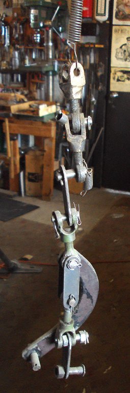

Post by Rich Eagle » Fri Jan 01, 2021 4:01 pm
I should point out that while the concept of that system looks simple the angles and center to center distances are very important to the correct function.
This is a photo of some of the various and adjustable pieces tried by the previous owner and myself. Along with a makeshift brake band from somewhere nothing anything like stopping was achieved. Hours were spent trying to find that magic point. Not until I copied the Buick patent drawings did I get a brake that worked. And work it did.

Post by Art M » Fri Jan 01, 2021 9:37 pm
Rich, thanks for responding with the picture. Considering the mechanical advantage and the complexity of the design, any wear requires an adjustment or a replacement. No self-adjusting with this system. I think this design has possibilities on a model t
