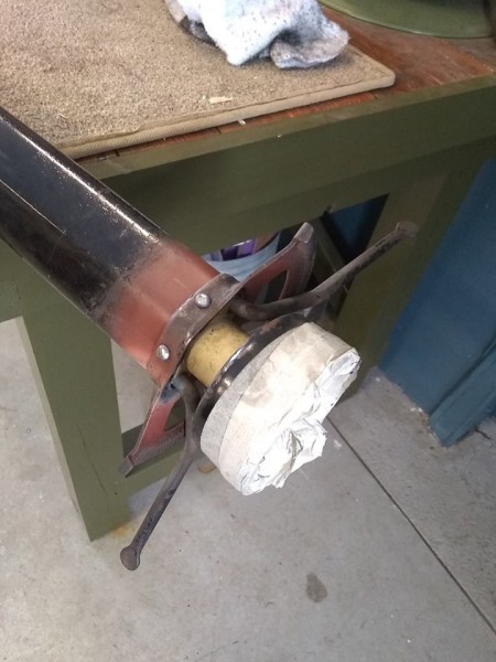

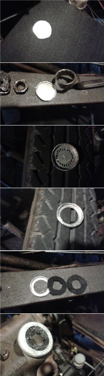

Made a cam seal because nobody has anything imperial in stock and importing them is too difficult.
The photo should be fairly self evident how it was formed.

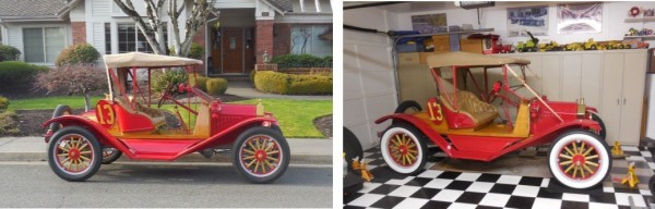

Changed from black to something more dazzling!!
What do you think, should I paint the wheel spokes red or leave them natural varnish?

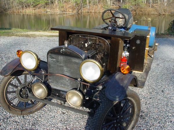

Re: What have you done on/with/to your T in febuary?

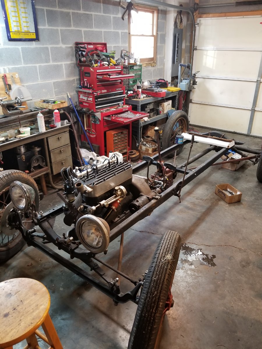

I got Ellie Mae's dashboard in, and her fuel tank, and the box for an arm rest/electrical connections!
Tom, looking good! We had a club member on Long Island (now deceased) who had a T a lot like yours. We christened it the "desk mobile". He drove it everywhere and it always attracted a crowd!
Thanks, this is a fun build and will be a daily driver. Everything I have done can be easily reversed to make a correct TT, except the spindles have had mounts welded on them for the calipers.
And it does look like a desk! Or maybe a fireplace mantle. But I like a big dashboard.
When I get the lighting done she should be road ready!
Looks good Tom !!
Fireplace mantle was my first thought, let's hope that's never the case.
You could stick a TV in there !!

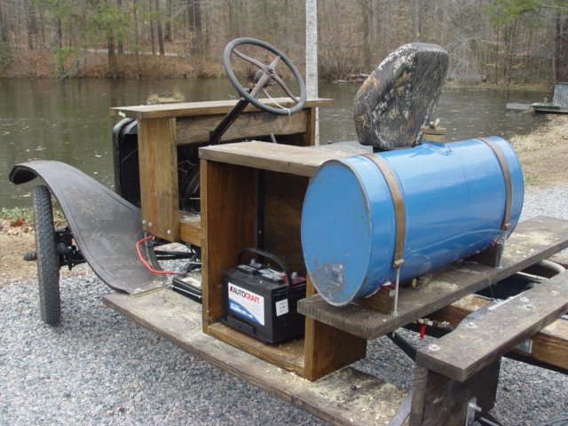

Loaded the doodlebug to go snowmobiling tomorrow at the 2019 national meet.

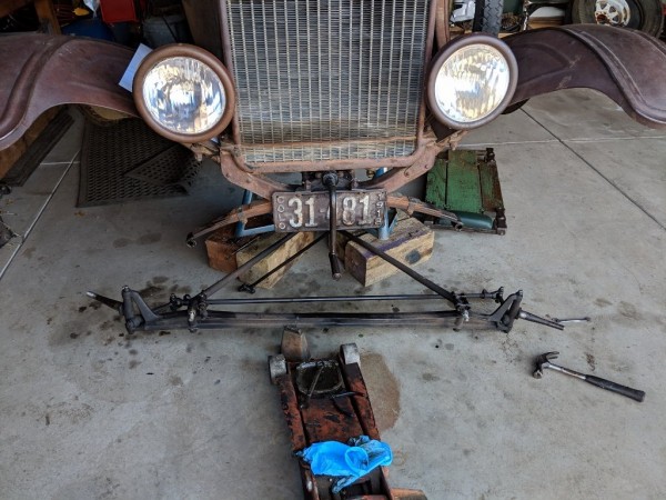

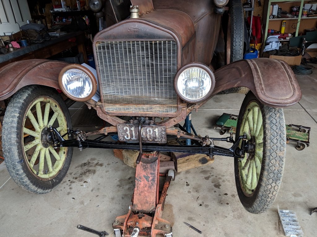

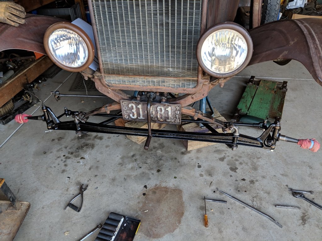

Took the old front axle and worn componants out and installed the new one.

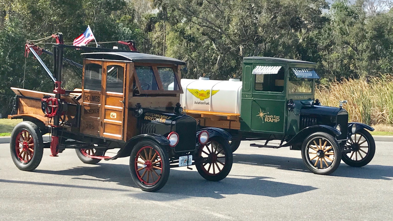

Went to the inaugural All Ford Show at Mac’s Autoparts in Titusville Fl on Saturday. Everything from 1917-2019’s in attendance.
However the only 2 T’s (TT’s actually) in attendance won 1st Place, and and Best in Show. Showed them young whipper snappers just how it’s done !

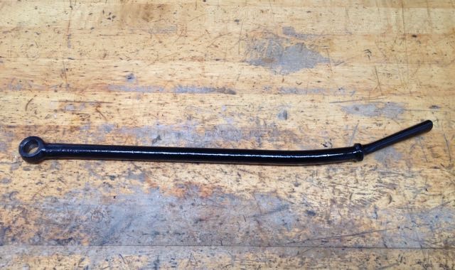

Tired of the Ruckstell shifter getting in the way when entering or exiting from the passenger side. Cut off 3.5” , attached handle from junk T hand lever, turned lever around and reinstalled. Position shown is "Ford high” or “out of Ruckstell"

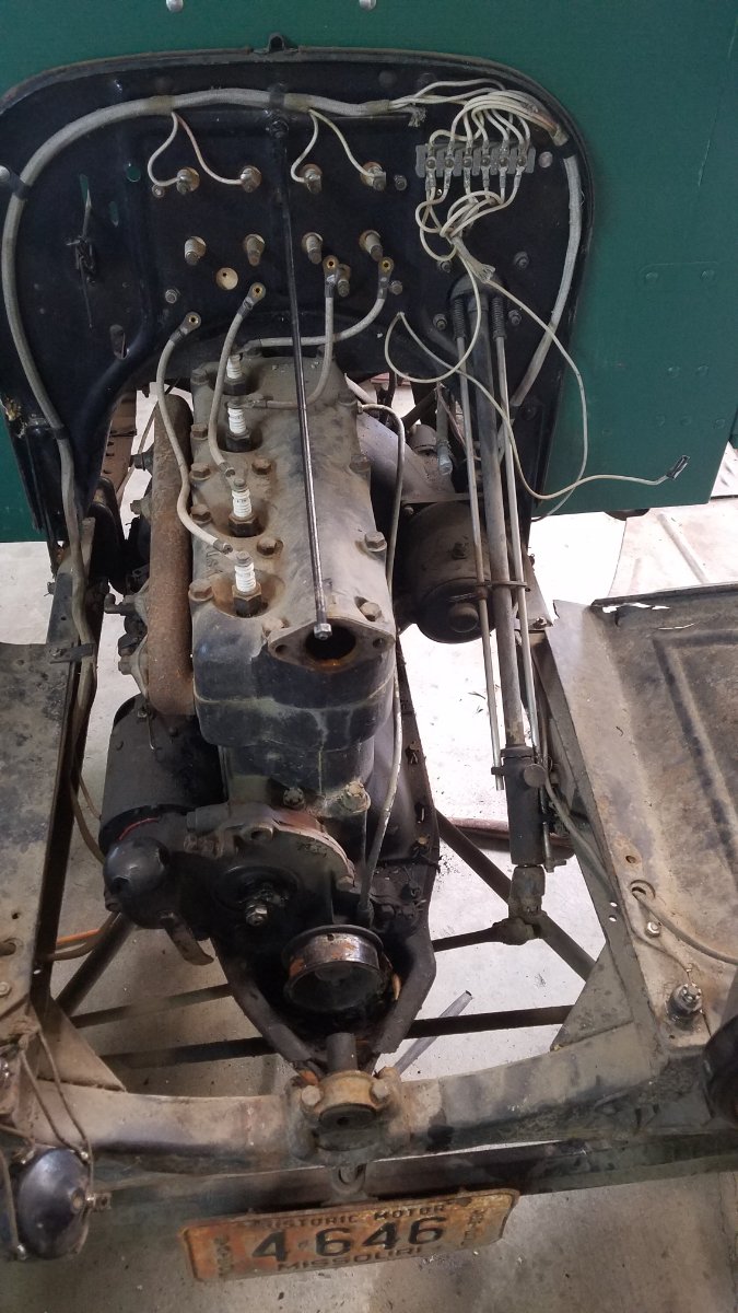

I gutted it!

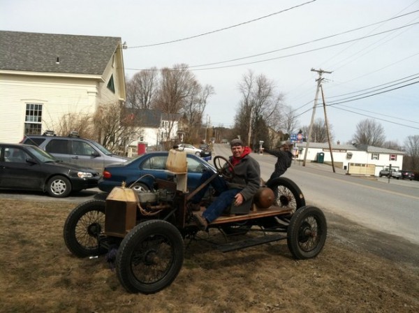

I am trying to learn to post a photograph of my Speedster!

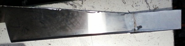

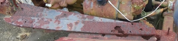

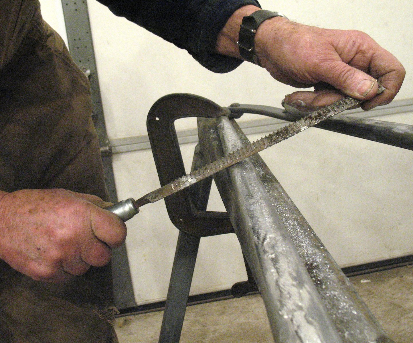

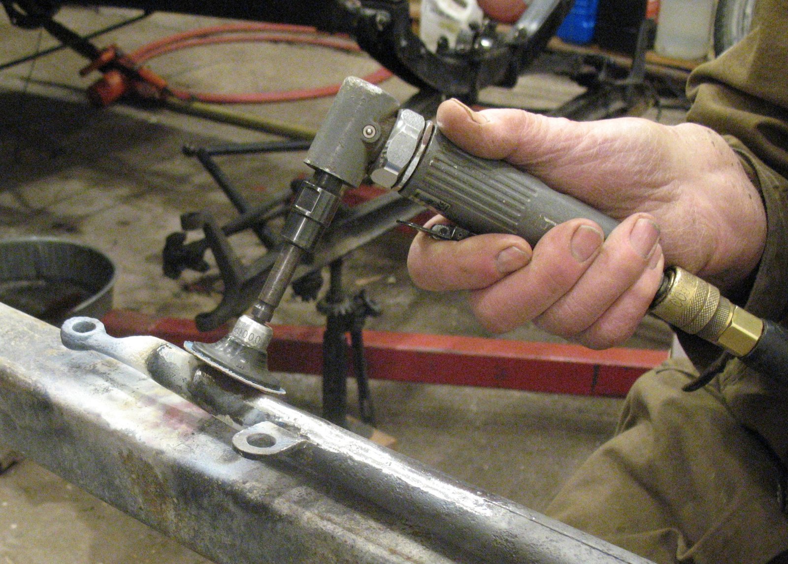

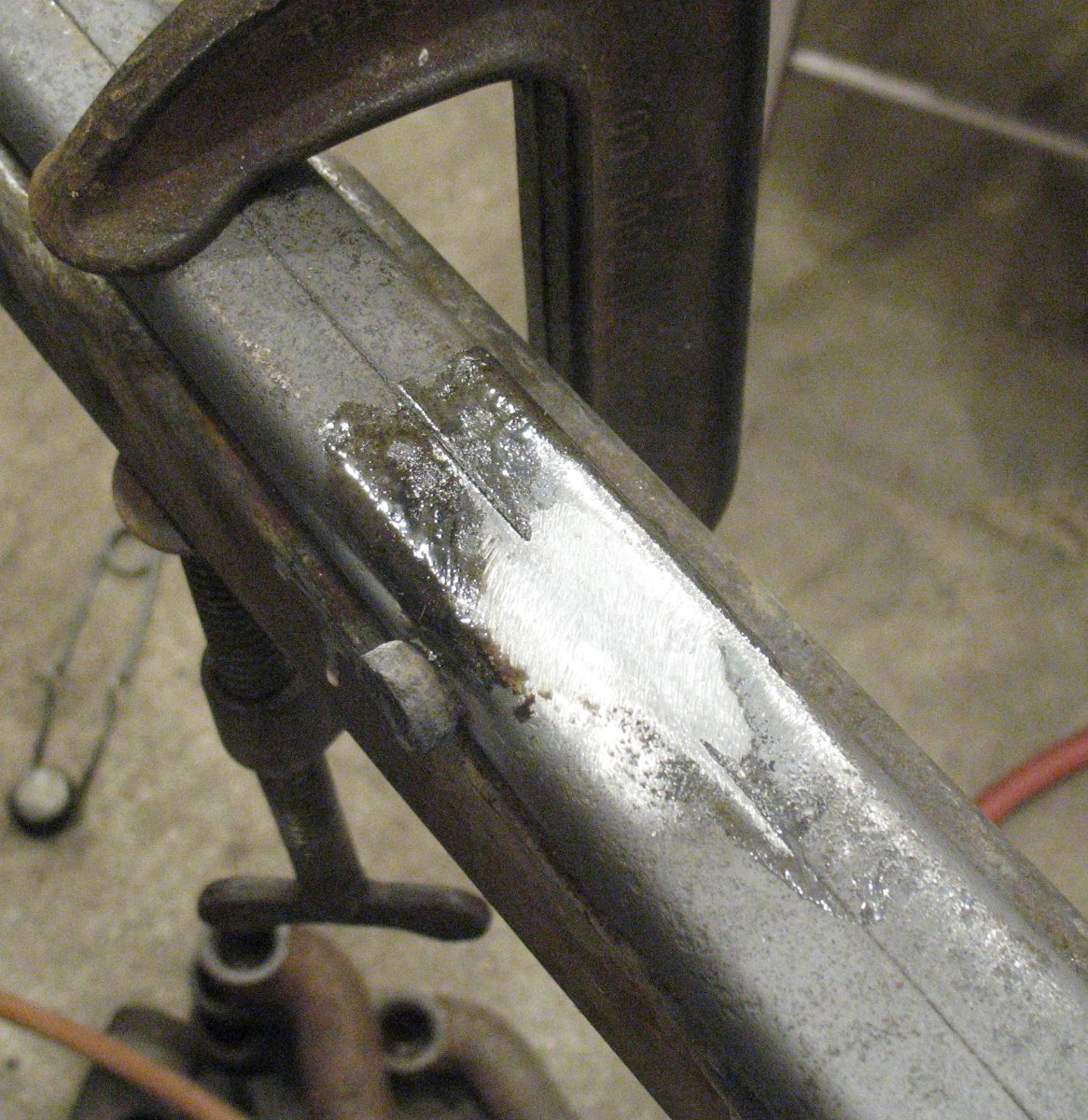

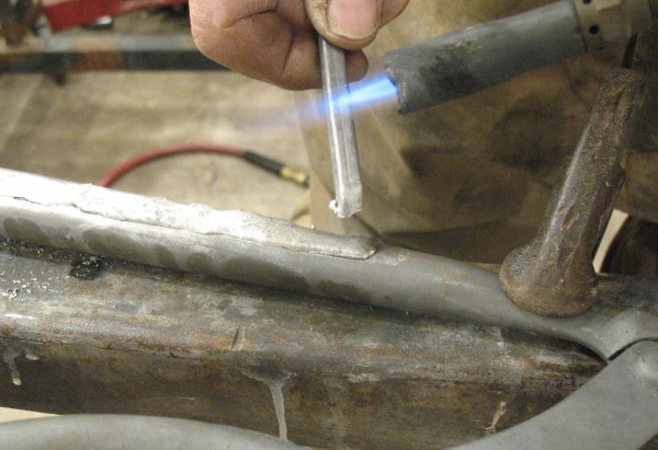

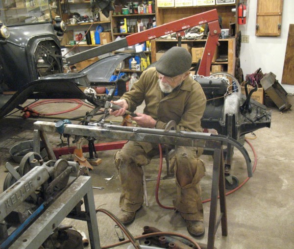

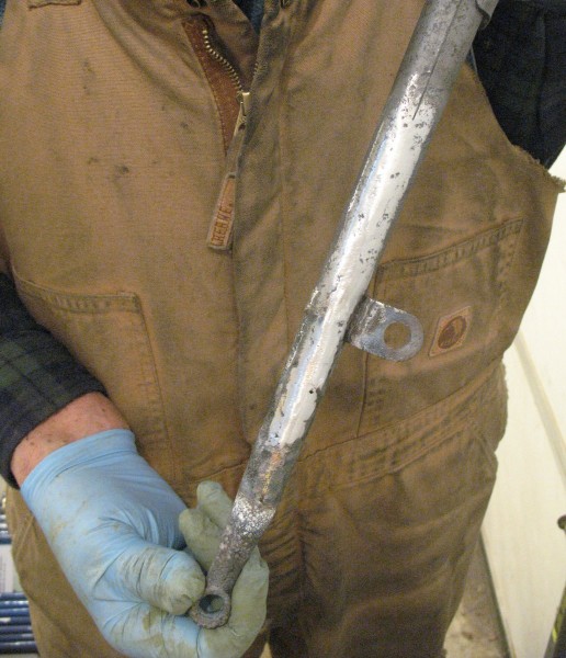

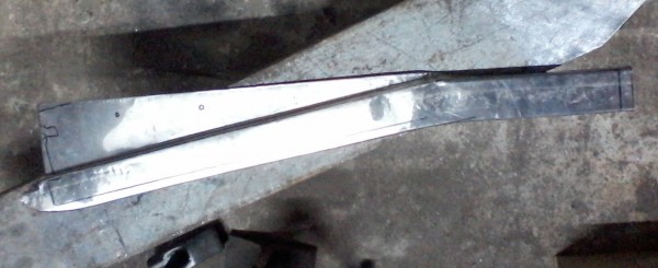

As found...
Used homemade arbor/mandrel tool...
Making use of homemade anvil...
More work needed on stainless...

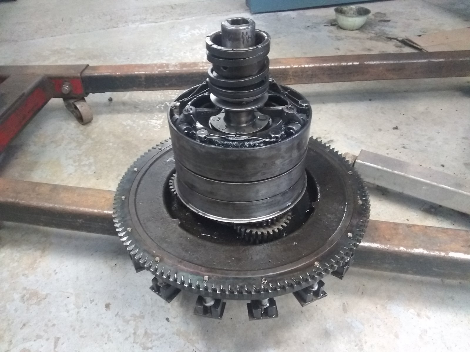

Got the engine out of the runabout. It will be getting a new crankshaft.

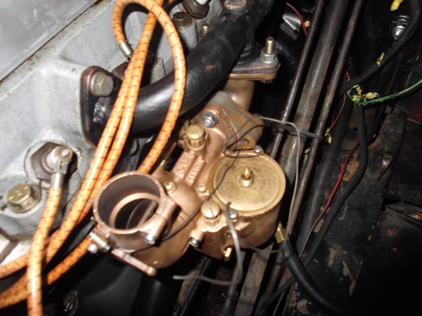

Towed it home after it quit on the road last week. Fuel contamination (again). I have never owned a car with the fuel issues of my '27. Cleaned the fuel strainer, removed the bowl from the NH carburetor. It looked like it went down with the Torrey Canyon. I'm now in the proces of cleaning the fuel system (again). Just got the carb gaskets from Lang's today. Will put everything back together tomorrow.

I suspect it will be again, and again, and again, etc., until you pull the tank and clean it out. I fought that battle until I finally got a new tank. There are no new 26-27 tanks, so cleaning is the only cure. I found that the sediment bulb and a glass bowl didn't keep fine debris from reaching the carburetor and spoiling my fun. When I took the tank out to clean it I found a loose baffle flopping around inside, so replacing the tank was an easy choice.Fuel contamination (again).

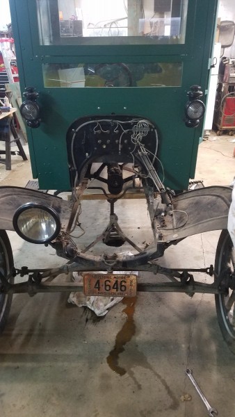

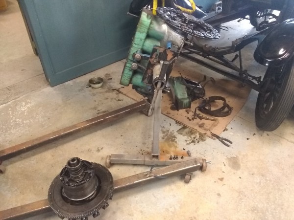

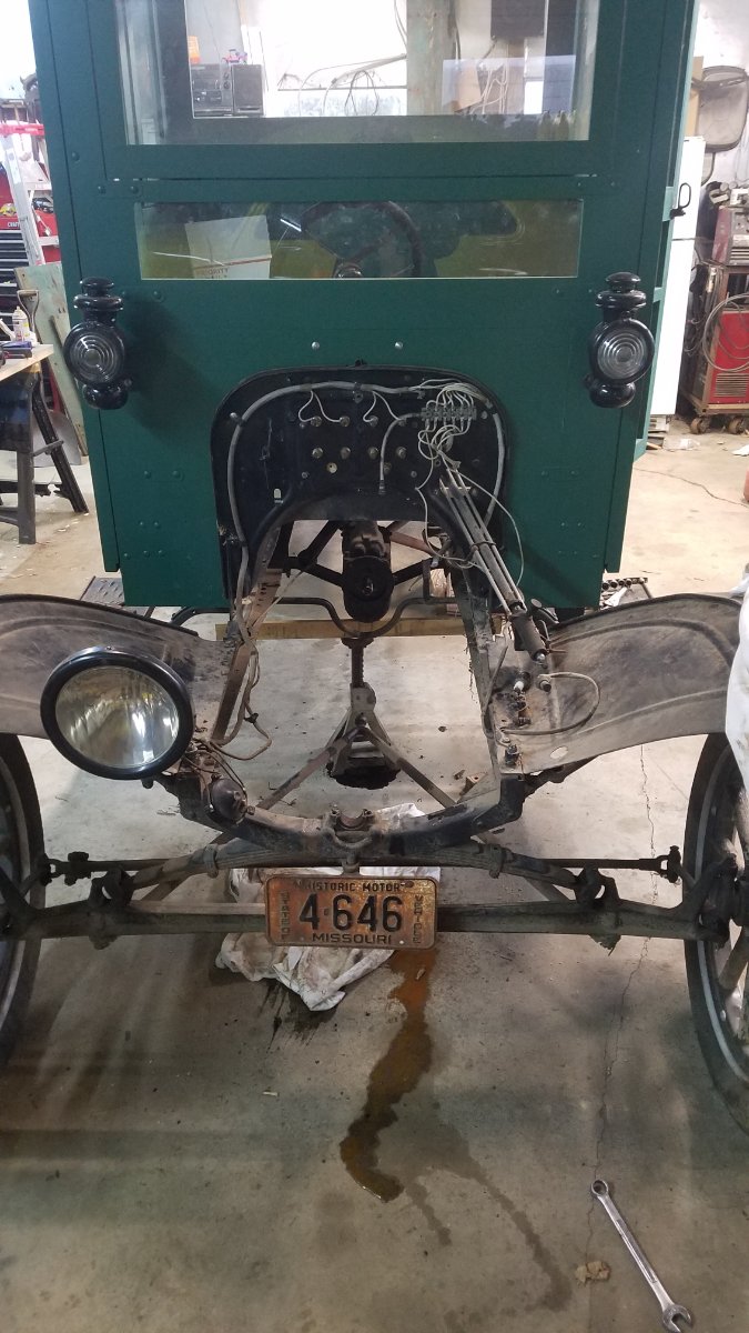

Went in the shop this morning and began removing the engine in the 23TT. I came in for a bite of lunch. I have 4 bolts to go and its ready to pull.
I have a rebuilt motor from Joe Bell I picked up last year for it. I have the 8in1 bed ready for paint so for now its motor time.

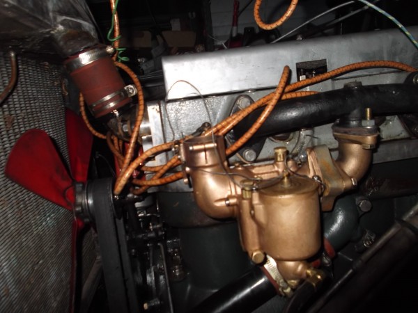

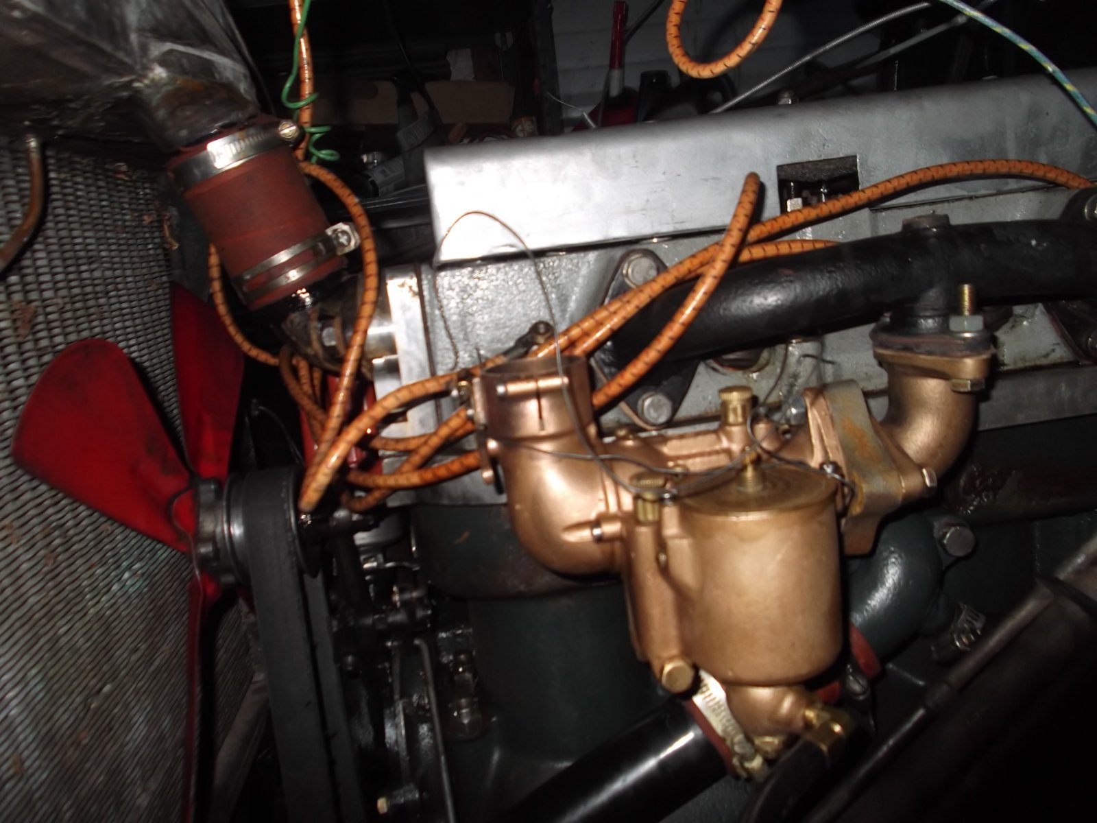

Putting a Stromberg OS-1 on my Nelly-Bell the Raloo Rocket. I am stuck till the replacement intake gets here so I can hook up the throttle. The one on it, cut down when I installed the VW carb. Will have to put the water pump back on, goes to summer high even on a 30 degree day at idle. Right now I am using a piece of wire to hold the throttle closed.

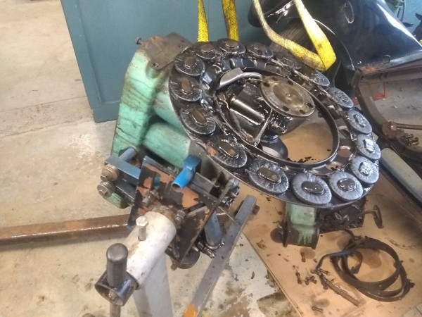

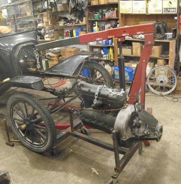

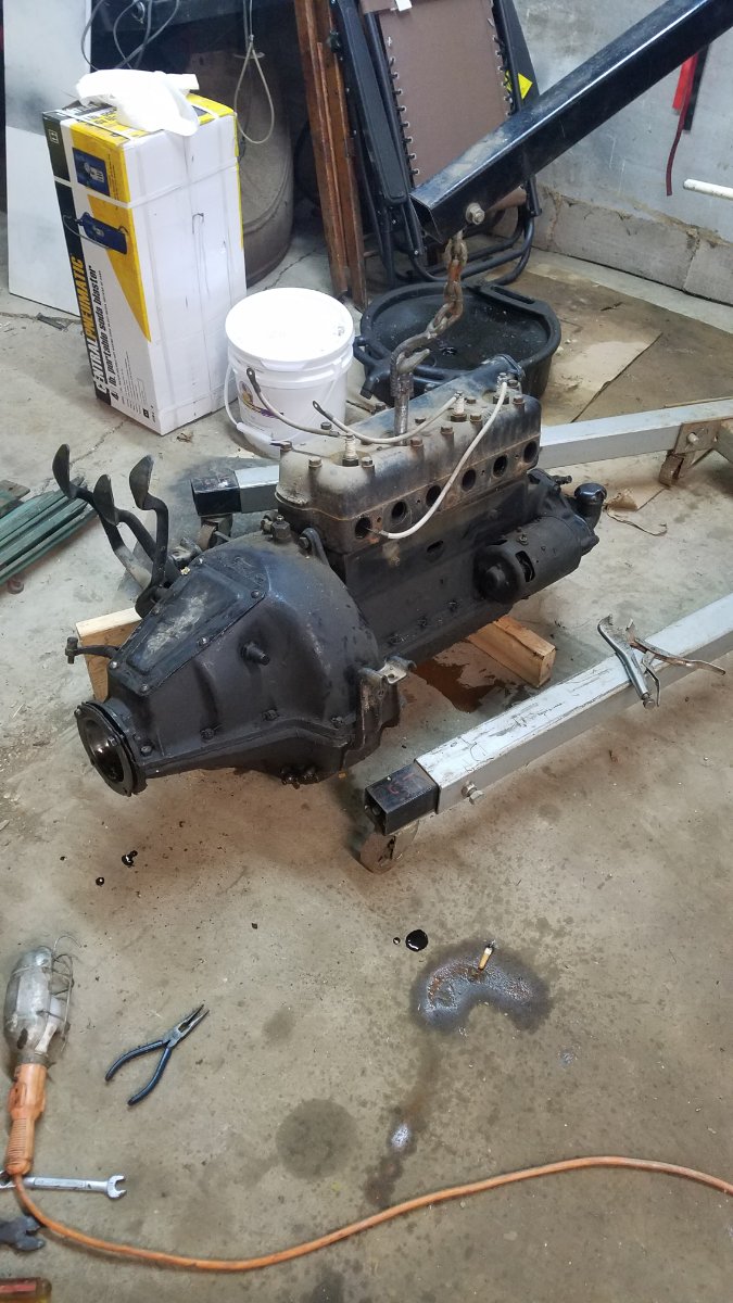

[/attachment]p
I won!!!!!
A little wrestling match and its out. Stripped of all parts needed for new engine.

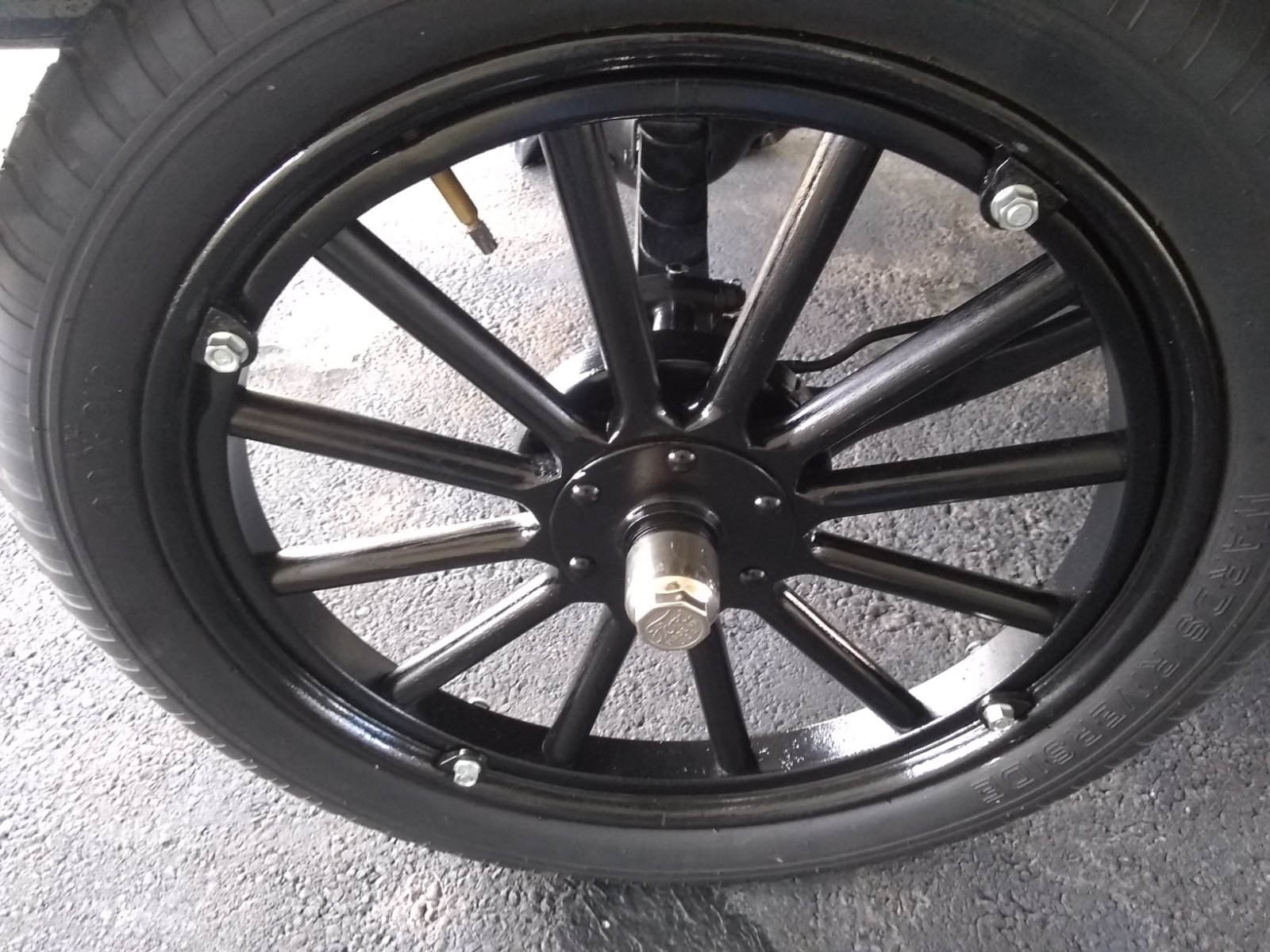

Wheel number two rebuilt, painted and installed.

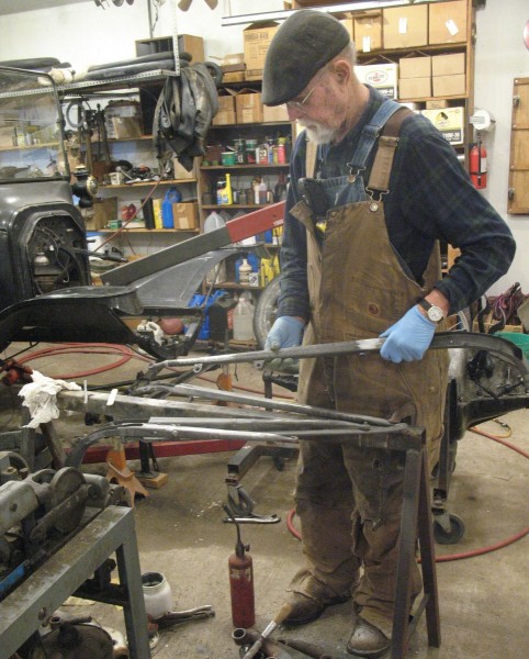

I need to get a top on the 1923 touring, so today I got busy on the top irons.
Filled an open seam and ground the weld.
First the die grinder, then the sanding wheel.
Welded shut an unauthorized hole, then filled the dent around it with body solder.

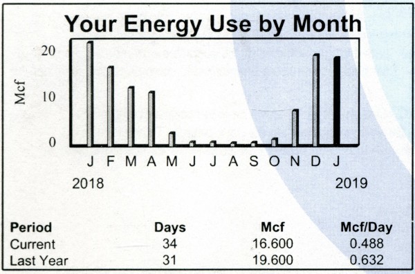

It makes winter considerably more costly than summer, but I consider it worthwhileI envy all of you with heated shops...

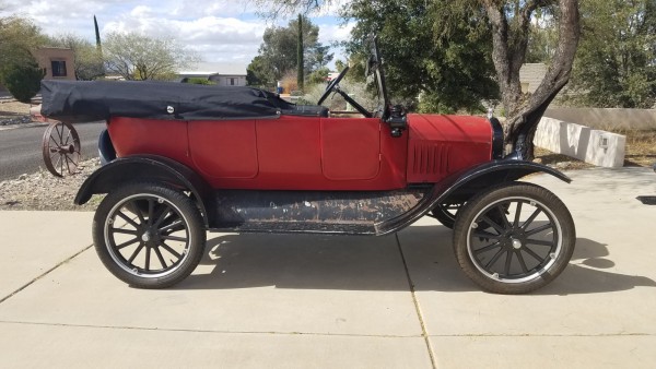

Ready to leave for the Sierra Vista tour. 57.5 miles from my house.
1923 Touring low radiator

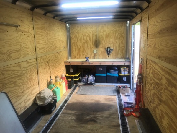

I finished the new trailer with a workbench, an inverter, 3 LED overhead lights, storage, a spare tire (kinda important), gas cans, a fire extinguisher and an electric tounge jack. And fixed all the leaks. Good thing as the drive here was harrowing at times, nasty weather. It was sunny today, but weather is looking iffy for us next week...good thing we rented a car as a backup.
We’re in my office parking lot in Tucson tonite in the RV, ready to drive the last leg to Sierra Vista tomorrow for our first tour!
I gave all my staff rides in the T yesterday and that was a blast.

I sold my modern 13 Speedster (to a good home) and started the 12 and 25. All's well that ends well.

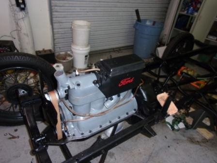

Installed the rebuilt engine in the 23TT. Spring is comin!

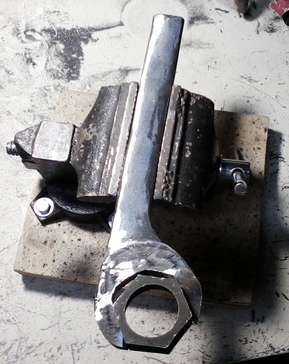

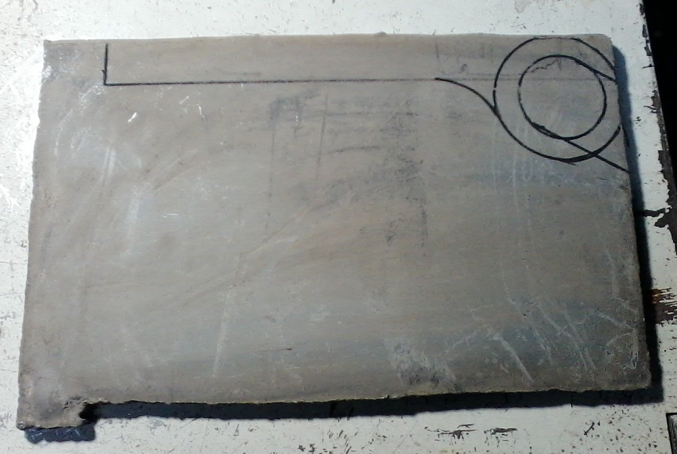

Pack nut wrench:
$6.00 thick plate from scrap yard and lots of work from grinder, sized to 2-1/16" opening, 12-1/2" long, 7/16" thick handle, 5/8" thick crescent. Maybe I'll paint it. Humble beginnings...

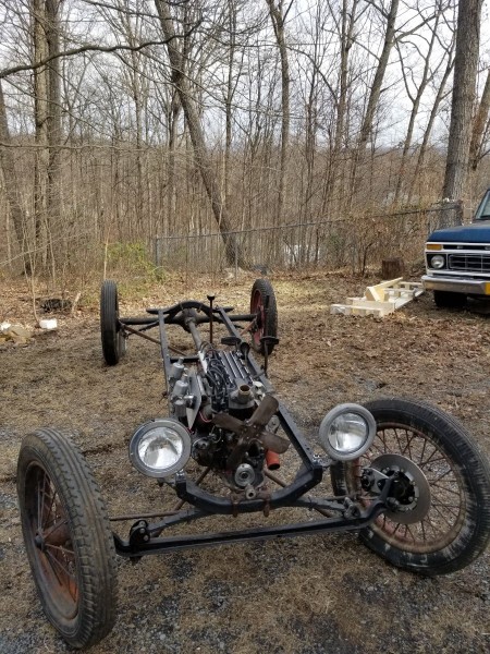

Installed my engine into the chassis.

Like the front disc brakes! Did you do them yourself?

Finished cold riveted the clutch plate last night on the kid's engine. Per Mike Bender's YouTube video, he says use your smallest ballpein hammer, after a few hours I just was not getting anywhere, I had to upsize one size, maybe to an 8oz Then I made good progress.

Yes. The friend that is helping me, this is his design and he runs them on his car. The set up works great as he has thousands of miles on his.

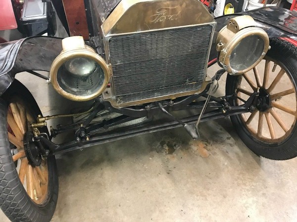

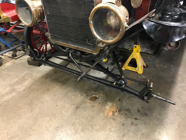

Rebuilt the entire front end on my early '13

Front discs are great, the front wheels do most of the braking! I think you might consider doubling up your wishbone though. It could prevent axle roll in the event of a slam-on-the-brakes stop.

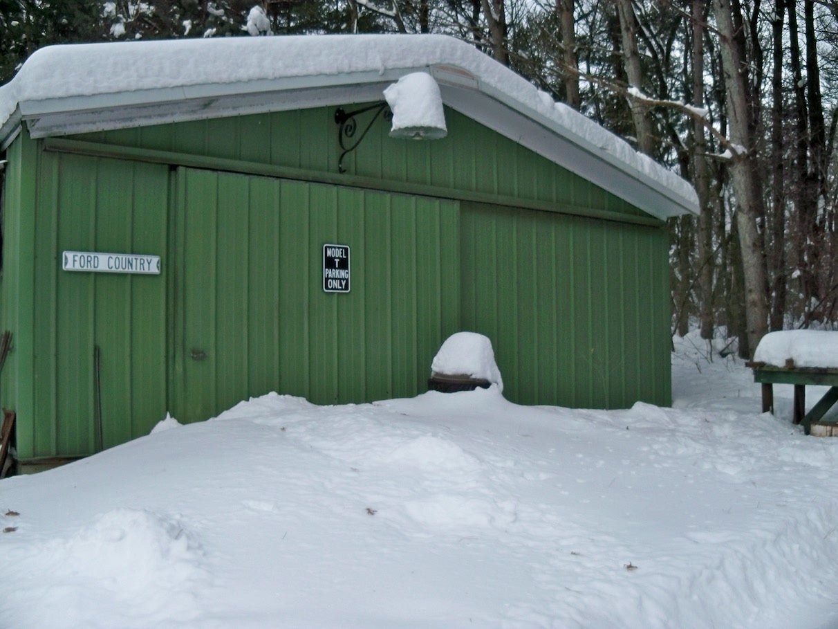

I looked at the shed where they are stored. And it is snowing hard again now!
Got back to work on top sockets for the 1923 touring.
Some of the seams were wide enough to need filling.
The places that needed filling were mostly near the bottom.
After tinning you lay on the solder...
...then you have to file it.

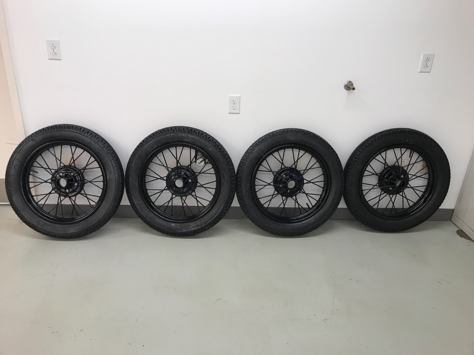

Got the wheels for my speedster back from the powder coater and got the new tires mounted.

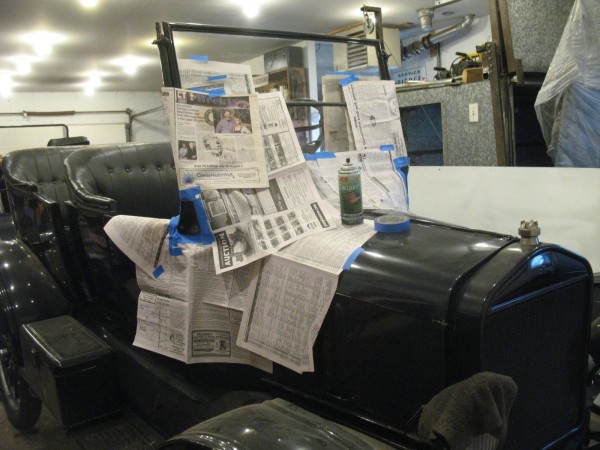

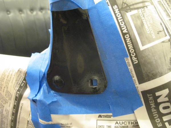

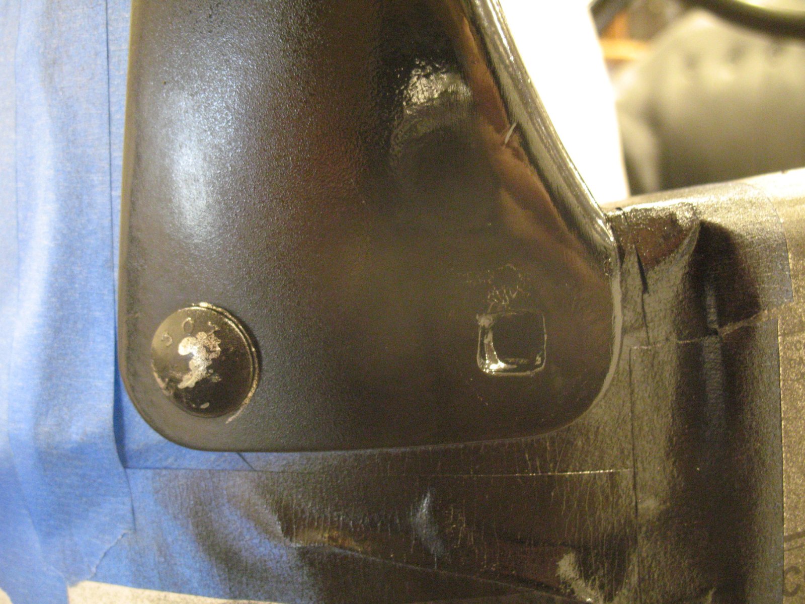

Touching a couple of spots on the touring.
The modern paint-shedding bolts with numbers on their heads are going away.

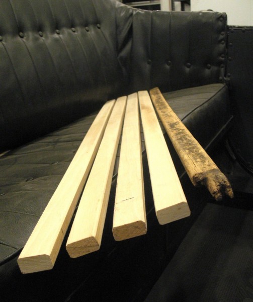

Made new top bows.
Fortunately I had one original that was complete enough to serve as a pattern. I still have to set up a steamer and bend them.

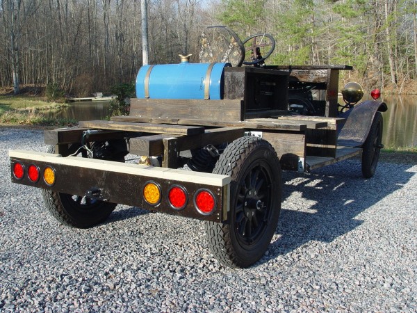

Ellie Mae is coming along.
The run/brake/turn signal lights work!
The headlights are basically where I want them, but they have more vibration than I anticipated. They are mounted on the bar between the two front fenders. Was there a way to minimize the vibration back in the day?
- Posts: 6732
Tom
mounting them the way they left the factory would be a start toward reducing vibration from the levels you are now experiencing.
Tom Hicks
- Posts: 761
- Joined: Sun Jan 06, 2019 12:07 pm
- First Name: Thomas
- Last Name: Hicks
- * REQUIRED* Type and Year of Model Ts owned: '24 TT, '26 TT, '24 Speedster, '26 Speedster
- Location: Chesterfield, VA
The top lights are mounted on the bar where lights are supposed to mount, which I guess is basically how they would leave the factory. I feel they have excessive vibration.Scott_conger wrote: ↑Thu Feb 28, 2019 12:44 pmTom
The lower lights are T headlights mounted upside down on the bar, so they have more vibration at the base than they would have if mounted to the frame like factory, and since their mounting rods are longer they have more vibration than the top lights.
The vibration is mostly side-to-side, not fore-and-aft.
It might not be a big deal since I have not hooked the lights up and used them at night, and I don't know how much vibration is normal for this set up, but I would like to find a way to add support to what I have so I can keep the configuration like it is.

your truck did not leave the factory with that bar nor lights mounted to that bar. If it left the factory with that radiator and those fenders, it is a '24 or '25 and the correct style lights mount on a hole in the fender irons, through the hole in the fender. That radiatior shroud, fenders and coilbox location all combined, would be perfectly correct for late '25. If the truck is late '26-27, based on the coilbox location, then you need the correct front fenders and the correct bar for those years (mid '26 and '27 are the only years for a factory bar between the fenders and lights on that bar). Either way, your vibration will be greatly reduced if it is put back the way it should be.
If you like what you have and don't wish to go stock, then you're going to have to do some serious reinforcing on the fenders as I'm sure you're aware. The bar and it's mounting appear far too flimsy for the amount of weight hung on it.
Tom Hicks
- Posts: 761
- Last Name: Hicks
OK, thanks. I didn't realize the engineering was that complicated. I like the present configuration, so I will hook them up and see how they do at night. I suspect I will be looking for a way to give more support and reduce vibration...

Installed a Stromberg OF carburetor in my ‘23 runabout.

It was a beautiful sunny day, temp 34. Joan and a friend had gone horseback riding, so I put on ski underwear, lined jeans, a warm shirt and ski outerwear. I put a bottle of IPA in my coat pocket and drove the '14 to town for a fine lunch at our local Thai restaurant.

Gil, that sounds great! I hope to emulate that in the near future.Gil Fitzhugh wrote: ↑Thu Feb 28, 2019 8:44 pmI put a bottle of IPA in my coat pocket and drove the '14 to town for a fine lunch at our local Thai restaurant.

Tom Hicks
take a look at this: viewtopic.php?f=5&t=1817
and see what the reinforcing kit looks like and then consider fabricating something similar to reduce your vibration on your lights.
