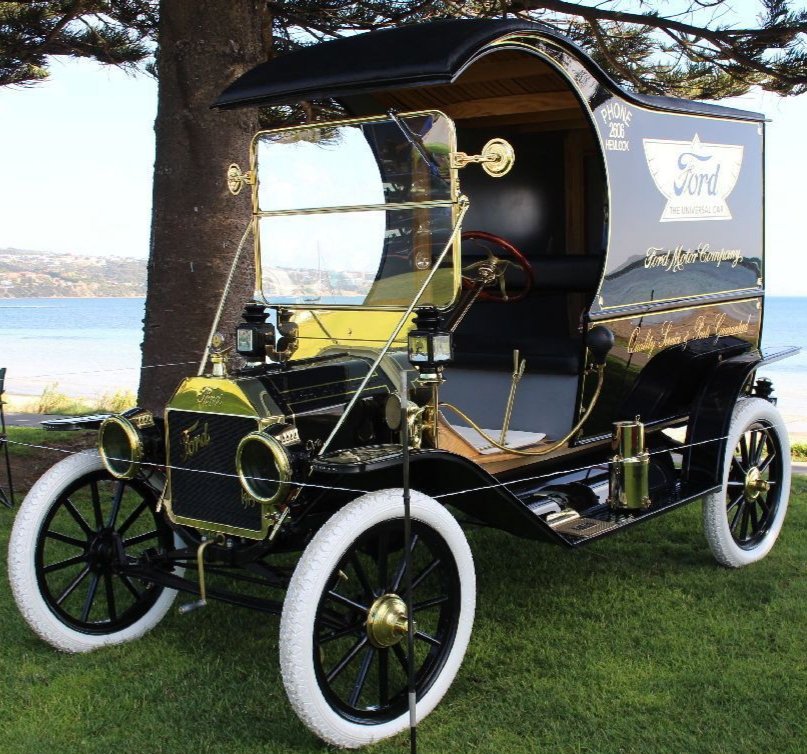

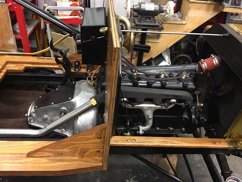

Hi Don, here bellow my original stock 1914 speedster project as well. It may inspire you.

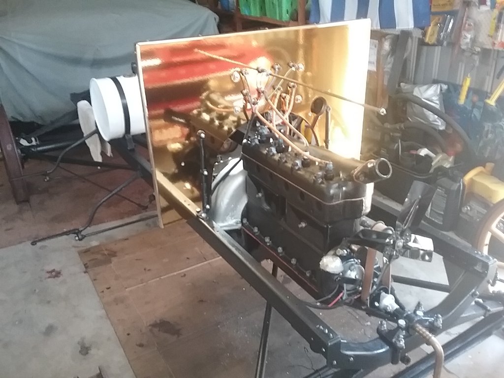

Don, These days you need to think out of the box !... Dont be a Lemming !!
I just stained my firewall few days ago in cedar on 1 side and on the otherside i went... gold baby !! Trust me the end result gets people crowding at the car shows , like bower birds they like shiney things ! Just Look at my last classy project :roll:

Johnny you did a fantastic job ! Congrats. How did you make the brass modling corner? I'm asking because I'm ready to install mine... :lol:
