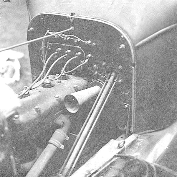

After that, many copies of the "Klaxon" AH OO GAH sound of motor driven or mechanical motor ratchet horns came along. Ford never put a hand or foot operated 'Klaxon' type on the T, only bulb type HONK sound or magneto vibrating type in 1915, and electric vibrating type BLAT sound in 1919 or so.

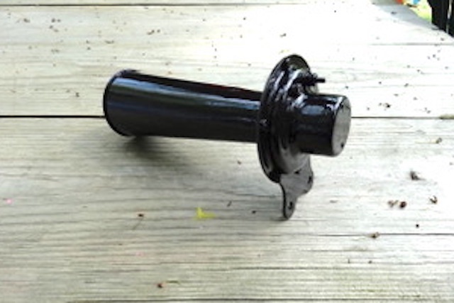

Your '16 will have the Ford BLAT sound magneto electric horn, similar to this later T, which is magneto powered, these horns work only on AC current.

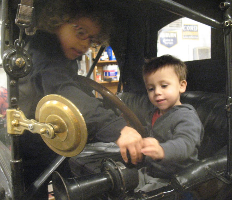

How do you know if a horn is for mag or battery? Look down the bell. If it has an adjusting screw in the center of the diaphragm it's a magneto horn.
I've tried a mag horn and a Stewart mechanical horn on my 1915. The mechanical horn is better.
