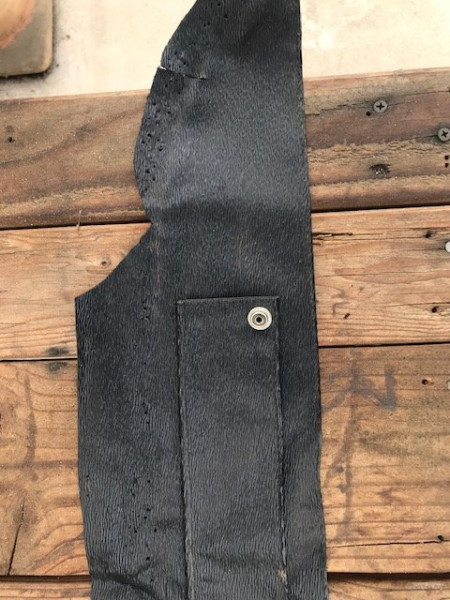

When I restored my 21 Touring back in 1970, it had no top for reference. So I ordered a top from Carter's Cut & Cover. The kit had a flap already sewn on to the wind flap that goes to the under side of the front bow. The new kit from Classtique did not. Since i rarely drive in the rain for long distances and not wanting any delays, I installed without. I did take a picture of the old flap. I have not done any research to find out what was originally provided from the factory.

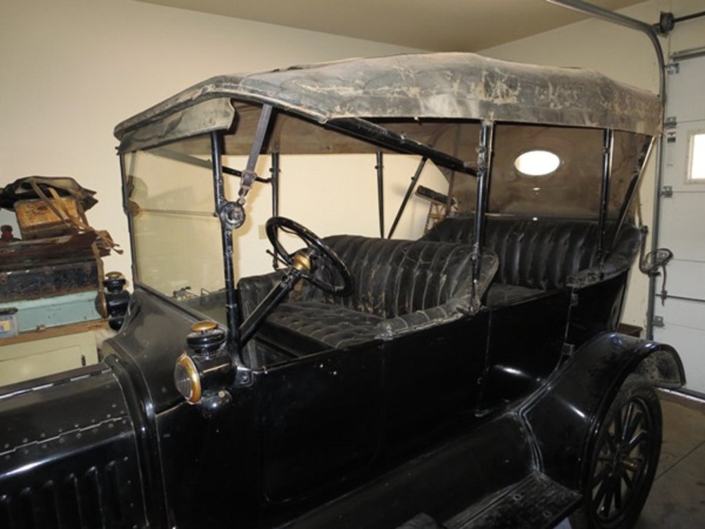

When I had the top installed on my 15 roadster I chose to have the a wind flap installed. In determining how the flap should be installed I found the following two photos helpful. I chose example 1, but example 2 shows an alternative flap.
Example 1:
Example 2:
It would be easy enough to add example 2 to a top that has already been installed.
Example 1:
Example 2:
