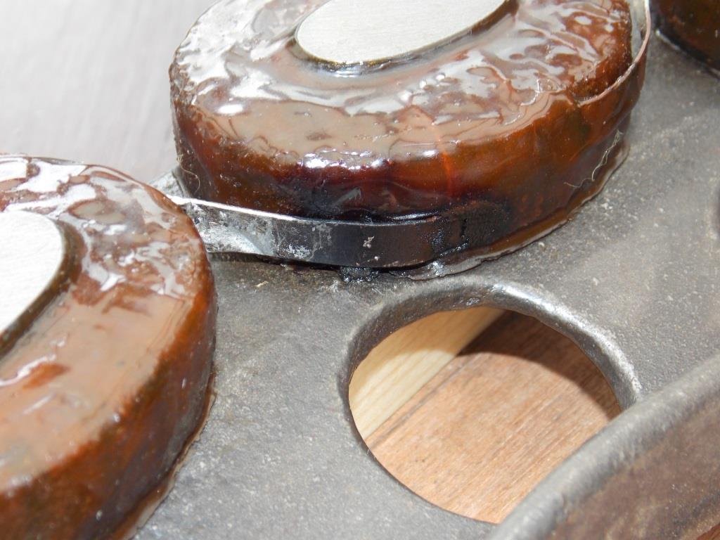

The later mag rings have insulators like this under the coils. The only double stack mag ring I've inspected is the one I'm rebuilding, and it was done before, maybe fifty or sixty years ago. It didn't have them. Should I use these? What are they supposed to do? The coils are already insulated with tape and varnish, so why these?

The insulating shield under each coil and the insulating between each single coil in the double coils are the most important.
The insulating shield between each single coil make the double coil working. If the insulation is no good the coil will make in the future an internal short and the loop will stop working.
The shield under each coil, between the coils and the coil frame, prevent a possible short of the coil to the frame.
Most of the time this short is due to debrit that is blocked at the coil out comming strip.
The photos are from a good looking coil ring that I tested as shown in the other post. During the test, in front of one coil the compass needle set parallel with the coil not pointing North or South. As soon as I shorted the coil ring (12V over the loop without the 21W light) at that coil a lot of smoke came with some flames.
The good looking coil loop was just good for a rebuild.
In that coil ring there were no washers between the coils and the frame.
On the photos you can see the "bad " coil and the damage.
So YES this shield is needed.
I make it out off 0.5mm gasket paper.
Snyder is selling them, I didn't use them jet ( made a few hunderds some time ago) but they will be part of my next order.
After assembled and tested the coil ring use a good coating to insulate it all from the oil and the engine debrit.
Good luck
Andre

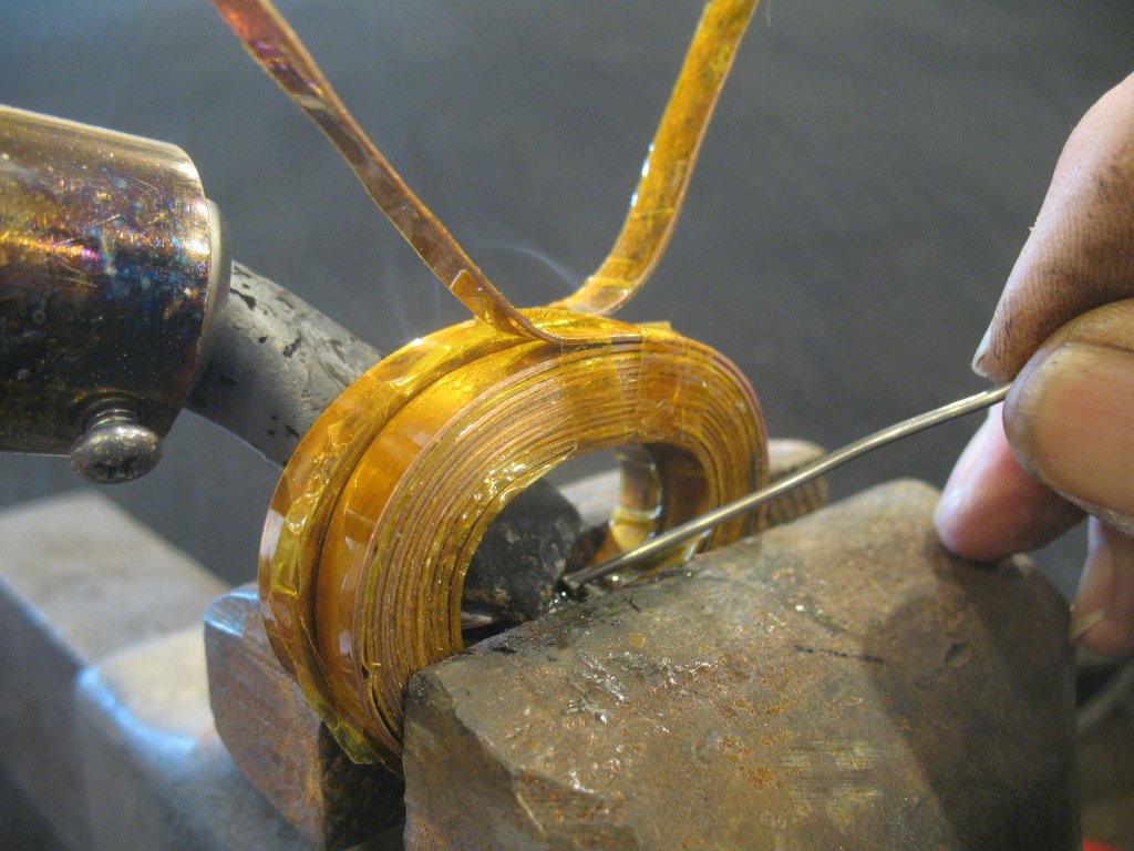

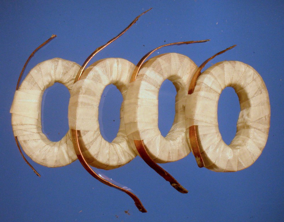

Insulation between coil halves: Yes, I have that.
Each half of the double coil has a layer of Kapton™ so that when the two halves are joined they have two layers of insulation between them.
The only place current can go from one half to the other is where the inside ends are soldered together.
Each double coil is wrapped in ½" fiberglass tape and coated with clear insulating varnish.
