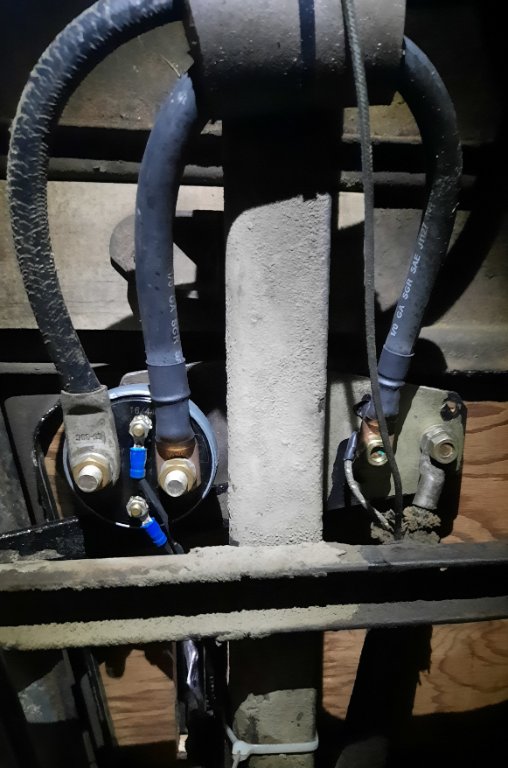

Re: looking for suggestions on location of battery cut off switch
I chose to install a solenoid in the cable from the battery to the starter rather than a foot switch. You could still keep the foot switch only use it to activate the solenoid rather than directly connect to the starter. For the feed to the terminal strip that provides current to all other circuits I installed a 30 Amp automatic circuit breaker.

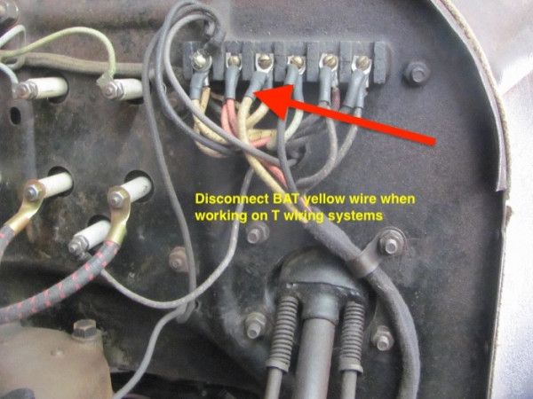

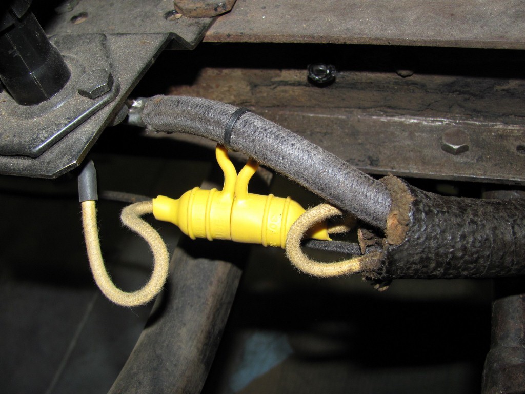

For me, the better way, instead of adding a switch on heavy battery current, is to add a FUSE to the wiring system, locate the fuse close to the footswitch on the Battery Yellow wire going to the terminal block. The fuse will protect against smoking wires that cause fires, and will be there when your T is parked in the garage, or as you drive along.
When working on my T's, rather easy to use a screwdriver and just remove that Battery Yellow wire from its terminal. That blocks all current to the wiring.
Had one experience of smoke rising from behind the dash panel driving down the road, that is a scary smell and sight!
No fuse then, fuses on all my T's now

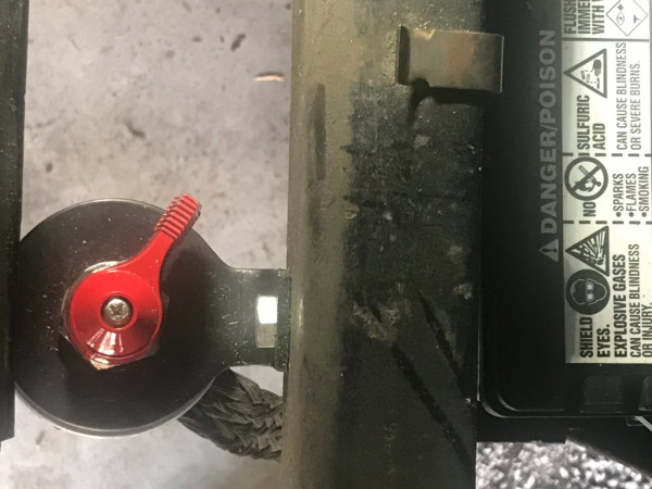

In answer to Dick's original question. On the frame rail near the battery. Connected to the ground terminal.

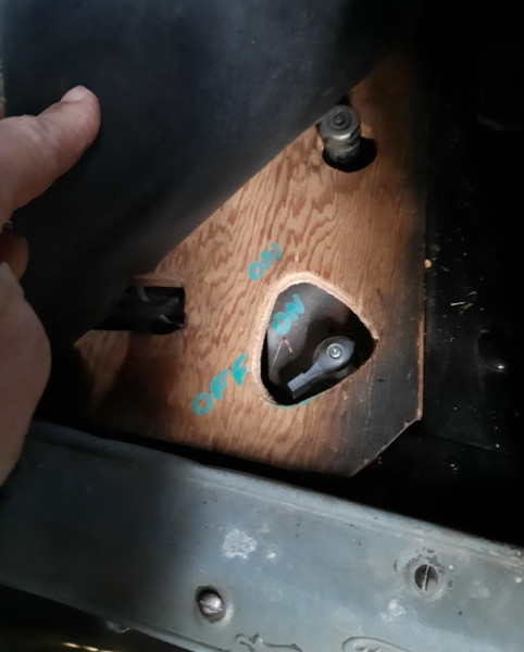

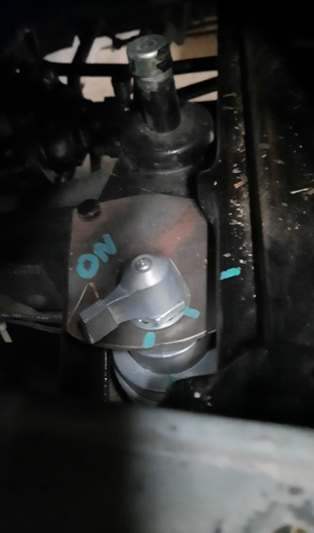

Hi, mine is mounted so I can reach it from the driver seat. It is hidden under the floor mat, so not obvious to the casual observer.
I used an old starter switch plate and it shares a mounting bolt with the working starter switch. Bill
Dick,
I've been using mine for 3 years now. I shut it off in the garage, or whenever I stop for a while like where there's litte kids, at a store or camping. The two smaller posts will interrupt the wire between the switch and the coil box so if it gets shut off while running on the mag it will stop the engine and not harm the generator. Also with the switch off it won't start on mag either... again.. curious litte kids

John Saylor's post and pic explains just what I said in my earlier post. THIS is where the protection really starts...right at the source.
Maybe I'm being too picky, but after seeing two cars with batt. cables rubbed almost to the bare wire between the Positive terminal and the switch made me cringe.
