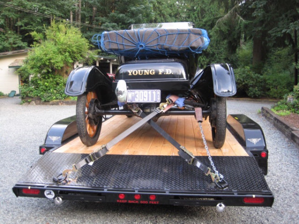

I have a '26 Coupe. I'm sure the aerodynamics would be better if it faced backwards, but I'm afraid the doors might come open (hinges at the front). If your Centredoor has rear hinges, you might consider facing aft. Otherwise face forward.
I always tie down the outer ends front and rear axles with straps that go around each axle, and run fore and aft and down to the trailer. I never touch the wheels.
For extra security, because it's there, I run the winch cable under a cross member and back and up to the front axle.
I usually tow at 60, but have touched 70. No problems. I would tie down the bonnet (hood?) by its lifting handles.

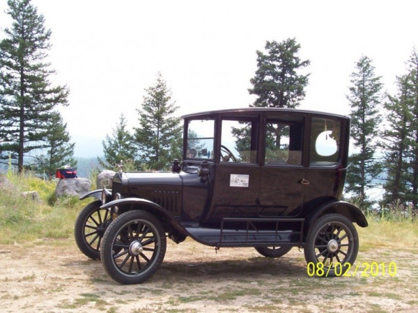

I towed our '19 Centerdoor from Washington to Montana for the National Tour there in 2010 - open deck at 65 - 70 mph - piece of cake !

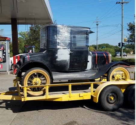

In 2001, hauled my 1926 coupe 1,400 miles from York, Maine to Central Florida on an open U-Haul trailer without incident. I hauled it facing frontwards. Of course you will need to tie down the car onto the trailer and remove anything that might blow off or out, such as the hood, the floor board and the seats, all of which can be hauled in the back seat or bed of your hauling vehicle. Unless you can adequately secure the removeable parts inside your Centerdoor T.
For such a long trip, I took the extra precaution of wrapping my T in several layers of 6 mil visqueen (sheet plastic) from a 20’ x 100’ roll and wrapped the visqueen covered T like a mummy over, under and around using 2 full rolls of duct tape. This was useful in keeping the visqueen from blowing away and the visqueen protected the T from wind, kicked up rocks, road debris and rain.
The U-haul trailer drove very well and though I drove it the recommended 45 mph for the first few miles, it wasn’t long before was keeping up with traffic going 70 mph on the interstate. As a matter of fact, it handled so well, it was easy to forget it was back there.
When you tie it down you will need to use four extra tie downs (web type ratchet tie downs at each wheel and crossing eachother) in addition to the wheel net type tie downs supplied by U-Haul but be careful when you tie it down. If you get it too tight, you can damage the front axle and rear differential. Best to attach tie downs to the leaf springs. And when you load it onto the trailer, it is safest to clamp an electric winch to the front of the trailer and winch the T onto the trailer. If you try and drive it on, you may end up driving it up onto the trailer, over the front rail and into the back of your hauling vehicle. To get the T going fast enough to get up the ramp, requires that, once on the trailer you bring it to a short, sudden stop and immediate stop, which the T is not good at doing. Make sure you have several wooden blocks the stack under the rear of the trailer so the rear of the trailer does not tilt down when you load the T on. Good luck. Jim Patrick
PS. Photos courtesy of onLine search

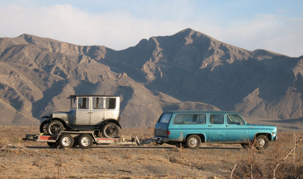

The Runabout photo above from the rear belonged to a friend of mine - I did a full chassis restoration on it years ago and THAT is the proper way to tie down in the rear ! I cross the front straps at the perches.

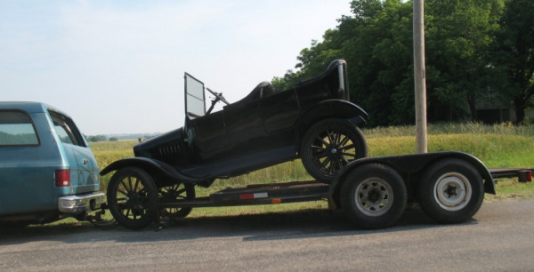

I towed my 18 centerdoor a little over 400 miles in 2014 when I moved. I put it on the trailer nose first but after the first rest stop I turned it around, facing backwards, since the floorboards flew up and created a huge pressure inside the cab. Make sure your hood is secured well but if not just put it in the back seat. I also towed the 12 towncar to and from Ray Wells in San Diego area, about 400 miles each way in the same way without any problems with the car. I did do something silly on the way back from San Diego with the towncar though, I put the car cover on the car and used a full roll of plastic wrap to keep it from flapping and two straps across the top to keep it from flopping. Well, the plastic moved all over the place on the freeway immediately and the constant stop to readjust every five miles did not make me happy. After a 100 miles the plastic was shredded and so was my expensive car over and by the time I got home it looked like I was dragging home a homeless camp. Best of luck with the tow, keep an eye on your rig behind you, and check your tie downs at each pe pee break. Just my experience. Frank

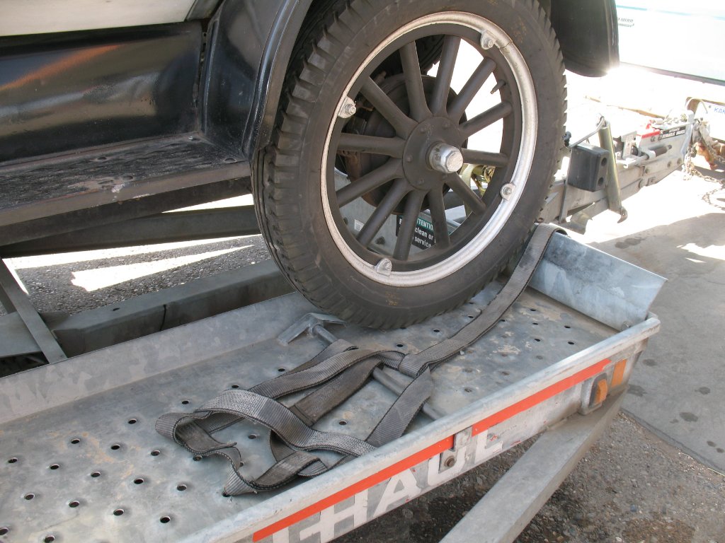

I rented a U-haul to bring this car home from the Phoenix area. It was fine except for the "wheel baskets", which would not stay on. Fortunately I had my own straps to keep the car in place. Caution: don't strap in the center of the axles, and don't pull forward on the front axle. I maintained a speed limit of 55 mph, as the Suburban is a voracious gas hog.
Every time I stopped, these were off.

My 2 cents--Steve Jeff was not pleased with the "wheel baskets" and I have gone to that type of hold down last year. The reason is the wheel basket secures the wheel tight to the trailer and does not pull the axle toward the front. Look at the T front axle and notice that the axle is held from pulling out by a ball that is about an inch in diameter and attached to the oil pan. By the way, in many cases the ball is loose from wear in the first place. Also, in many cases a person will attach the straps to the frame and avoid the issue above. This type of hold down does not allow the car to move up and down as it wants to do. This can cause the straps to loosen. The best wheel baskets attach front and rear of the wheel. I haul T's and a heavy Marmon using the basket type of hold down. Dick C.
