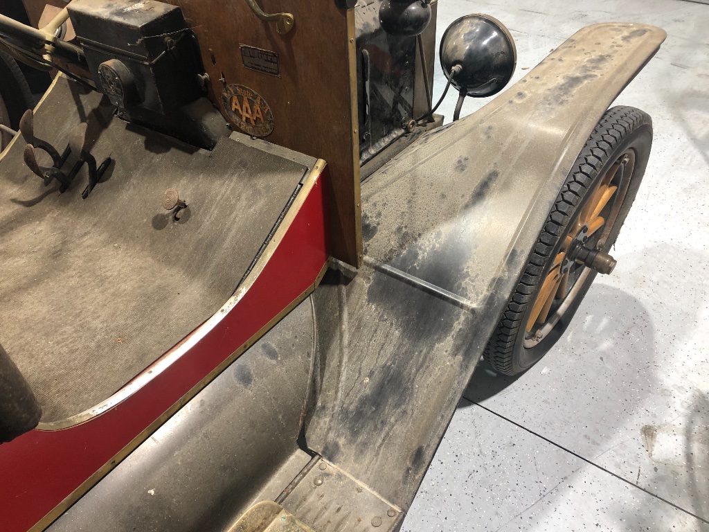

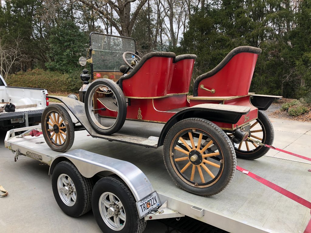

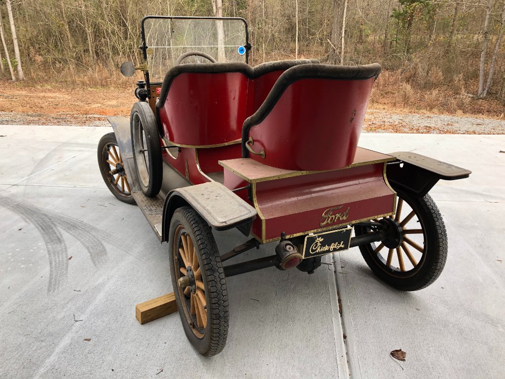

I just bought a model T and not sure what year it is or body style.
I think it is a 1915. I have more pictures I can send you if anyone can help me with this.

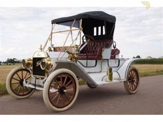

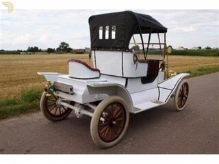

Outstanding little T! Looks like a 1911 or 1912 runabout or roadster with a mother in law seat. The two front seats should have a convertible top, but Mom’s seat was open to the elements. Sorry Mom. Seeing that it has carbide lights, It has to be pre 1915, as 1915 was the first year T’s came with electric lights. What is the engine number? Check out the link: Www.mtfca.com/encyclo/sernos.htm. Jim Patrick

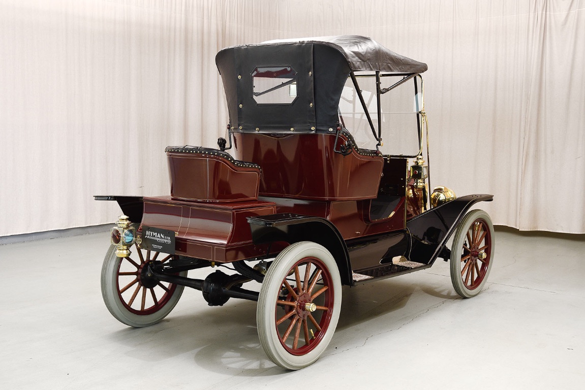

Here are a couple of pictures of a 1912 runabout/roadster that I found online. A real beauty!

I think that car is made to look like a very early car, however it is either a kit car or assembled from various year parts. The 1915 would not have the brass rods to support the windshield windshield. Looks more like a 1911. However the 11 would have had gas lights. The wheels are also after market off a later car. And a 15 would have a top. You can only tell what date an engine was manufactured by combination of casting dates on the block and engine number. There would be no way to trace the engine back to the original engine unless you have records from the time first sold to date. Many times engines were exchanged for new after market engines or different engines from other vehicles. The number was either ground off and re-stamped, or the registration was changed to reflect the new engine number. There are many other things to check to determine the year. A very good source is the book by Bruce McCalley "Model T Ford The car that changed the World.
Anyway the car is good looking and would attract a lot of attention and could even be "viewer's choice" in a car show, but would not win for best original car.

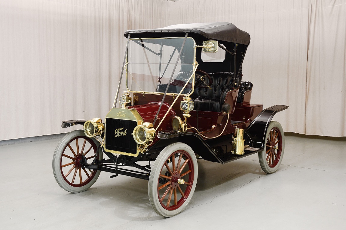

Sorry. I could have swore your T had gas lights, but I still feel yours is a 1911 or 1912 runabout aka roadster with the gaslights converted to electric, since that style with the Mother in law seat was one of the styles offered in 1911 and 1912. See:
www.mtfca.com/encyclo/1911.htm
www.mtfca.com/encyclo/1912.htm
Jim Patrick
1911 ad and photos of Model T Runabout/Roadster w/mother in law seat
Jim Patrick

- Posts: 6542
Re: Model T Year and body style?
The perches and wishbone are for a much later year - Suggest that you take some close up photos of the rear axle, hogs head, headlights etc - may be a T configured to an Owners desire

Parts salad. The body is similar to a 1911-12 runabout, but that extra tall firewall suggests aftermarket, probably (very nicely) home made. It has parts from various years. The hood is 15 or 16. The fenders are 1914 or earlier. The springs are 1917-18 or later. The headlights are 1915 or later (lenses 1921 or later). I can't see the coil box very well, but it appears to be wood — earlier than 1914. The front perches and wishbone are 1919 or later.The wheels are 1919 or later. The serial number (above the water inlet) will tell the date of engine assembly. The online version of the encylopedia will give you the month and year, or I can find the exact day for you.

Like Steve J says, a lot of bits and pieces put together.
The seats are not Ford, the lower body section may or may not be (most likely not). Some parts are probably from 1913 or 1914, many parts are after 1920.
Regardless, it could be a really fun beginning model T! Do some research, have some local T people that know the cars and parts look it over, just so you can know what you really have. Never know, could be some really valuable parts in there? (Value/worth of parts can vary greatly depending upon minor detail differences.) Do not believe wholeheartedly any one person! A lot of people make that mistake. They get told what someone else thinks it is and latch onto that and no matter how many people tell them it is wrong they continue to believe what the one person said.

Don’t be upset or discouraged that your T may have a compilation of parts from several years instead of being an original T with parts it originally left the factory with in 1911 or 1912. I think it is fantastic and with all the accoutrements of a 1912 runabout/roadster with a mother in law seat, such as carbide lights, white tires, a new top and a new paint job with pinstriping as well as gradually replacing non 1912 parts with1912 parts, you have a real treasure. Even if left the way it is, you can be comfortable with the philosophy that...”If it looks like a T, smells like a T, drives like a T and sounds like a T, it is T and you have a wonderfully impressive 1911 or 1912 Model T compilation that will bring smiles to everyone who sees it. I know it makes me smile just looking at it. I would love to have something like that. It would be so much fun. Jim Patrick

Cute, but a Franken-T.

It would really help document what you have if you took some more pictures. The original perches for this T were two holed so the correct wishbone would ride above the axle. What you have is a safer configuration with redesigned parts. Its one of those modifications being safe or being original. And there are others to be had.

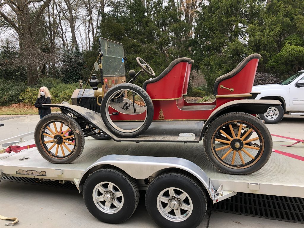

[image][/image][quote=jiminbartow post_id=140050 time=1610580237 user_id=476]
You can attach pictures to a thread and determine the year by checking the left side of the engine block (driver’s side in the U.S.) for a six or seven digit number (went over 1,000,000 in December, 1915) stamped into a smooth area of the block just above the water inlet. The year and day the car (or engine, if not original to the car) was manufactured can be determined from this number. Go to the old version of the encyclopedia in the research section of this site to the serial number lookup section. Jim Patrick
[/quote] Thanks Jim for your help. Trying to figure out what year to title this car and what to call it.

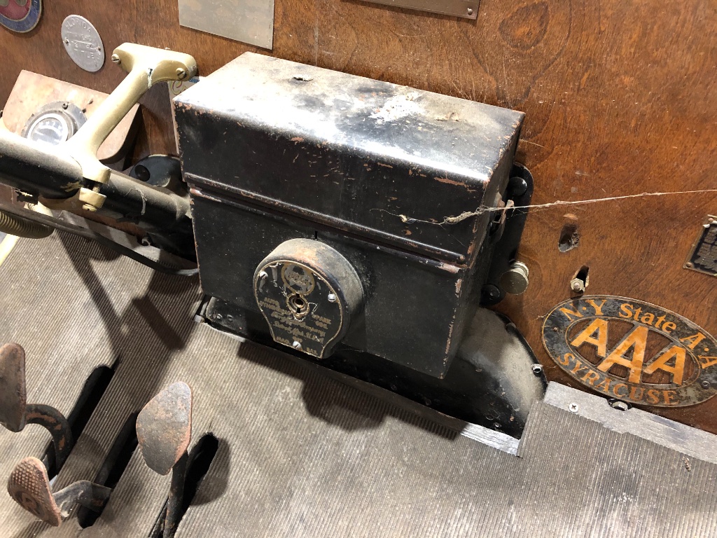

If you want to make it more "correct" there are plenty of things to change. Example: One of your pedals is 1914 or earlier; two are 1916 or later. The Model T Encyclopedia Jim posted is a big help in figuring out the years of various features. I have the book and I have it on disk. I prefer the disk version because of all the extras that come with it. There are other resources to help you get things right if you want to take that route. I've been going through my T's and replacing some things that are "incorrect", and as I want them to be drivers rather than show cars I'm keeping or adding some things that are "wrong".
