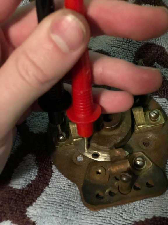

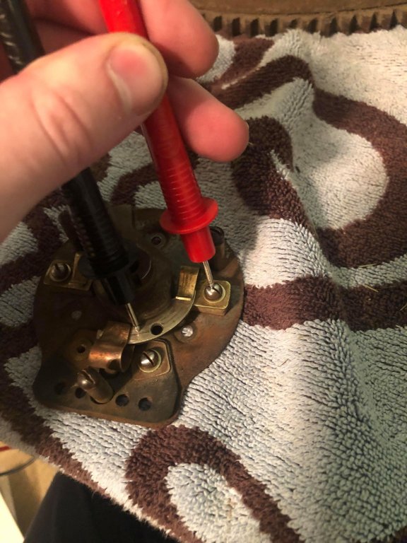

I then went ahead and cleaned up the contacts as much as I could in the switch as seen here:
I cleaned as much surface as possible without removing the rivets, including where the mag and bat terminals are, and the large switch contact. The place I couldn't get was under the contact with the terminal connecting to the bottom strip of the coil box. For fun, I tested the conductivity, and low and behold, I once again reached 0.3 ohms in this position.
To my surprise, in the opposite position, I actually reached 0 ohms (my meter goes to the tenth, so less than 0.05ohms).
Going all the way across to the last terminal however, it hovered around the 1.0 ohm range. This is likely due to the face that I can't get my emery cloth under the last contact.

Greg: Your measured value of 0.3 ohms is reasonable and I'd be comfortable using your switch. If you check the resistance by placing both probe tips on the polished blade portion of the switch (eg, place black probe tip next to red probe shown in second pic), what is the resistance reading? I doubt you will see exactly 0.0 Ohms even doing that. More and less pressure on the probe tips obviously gives different results and probe contact resistance can easily give values approaching what you are seeing.
Chris has the answer.
Greg is correct stating Ohm's law, but there are higher resistance components in series with the switch as Chris notes, making 0.3 Ohms a very small contribution to the over all circuit resistance. Applying 12V directly across the switch is essentially a welder circuit, you aren't restoring a welder here. Best, jb

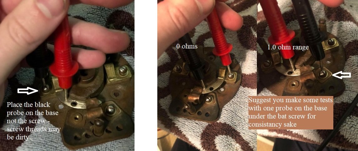

My point also. The most important reading you have shown was 1 ohm with a contact on the Bat screw and the other on the switch arm in one position. but not the other. You need to test the entire current path also. The pressure of the coiled contact on the switch arm may not be consistent

If you got 1 ohm as shown in the photo from the Mag side I would expect that you would get 1 ohm from the Bat position as well. If not then the contact to the switch arm should be checked.

I did as you suggested Frank, and yes. I got 1.3ohm for the mag and 1.2ohm for the battery. I think the difference of 0.1ohm is that the contact on the bat is slightly tighter than the mag one, perhaps due to more mag driving in its lifetime than bat. If this is normal I’m happy to proceed with the wiring.
