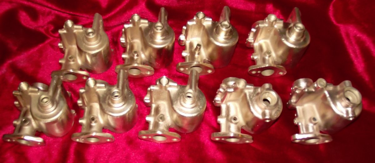

So I spent the day finishing two OF's and putting them in the mail. Should have taken a photo when I had 11 of them on the bench doing various machining processes to the mating surfaces on them. Had the other two in boxes before I thought to line them up and take pictures. So here are 9 Stromberg OF's that will be getting parts in and on them in the next few days. I've never had this many all at once before and probably never will again.
This is almost $6000 worth of old carburetors laid out on a red velvet background. With the other two it would have been about $7000 worth.

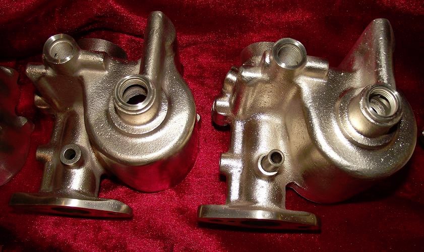

Note the machined surfaces. Every mating surface is machined flat and without chips or cracks to leak when assembled. Most of them get new plugs since the old ones are usually rounded off and ugleeeeeee. They will all get new throttle shafts, bushings and most will get new steel parts as most of the old ones are rusted and damaged so much it is easier to make new ones. They all will get my needle and seat conversion to a viton tipped needle and a replaceable seat.

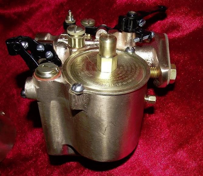

One last picture. This is the one that came in that was all full of black goop that has supposedly been rebuilt and test run. Hated to charge the guy to fix it but I can't warranty somebody else's work.
